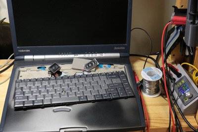

The ruined right speaker on my 2800-500 has been bothering me a bit since the sound is otherwise so good on this thing and was one of the main selling points of the Satellite 2800 series. Did you know it can operate as a CD player? While the laptop is off, moving that silver slider switch on the hinge-bar to the left will partially power up the laptop so that the CD drive can be opened. Put a disc in and while the laptop is 'off' it'll read the disc and music can be played and controlled with those play controls.
Very handy for speaker testing.
Also, since I don't see mention of it in this thread, the "BASS" button makes an enormous difference to the mixing of the subwoofer. When in the off state the subwoofer is barely used but turning it on really fills out the sound.

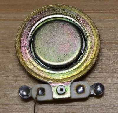

The right speaker crackles at higher volumes and when I've had the laptop apart pushing the cone you can feel it scratching. So I destroyed it 😀
570.62 KiB
1436 views
The neodymium magnet's coating has flaked off and that stops the coil moving properly causing the distortion. These are little 8ohm (measured) speakers with an unknown power output and physical dimensions of 20mm x 27mm and around 6.5mm thick.

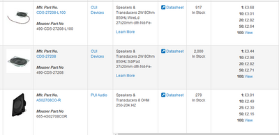

In my test setup, it seemed that a 2 watt speaker matched the original quite well for volume:
558.97 KiB
1436 views
I found some good matches on Mouser as the CDS-27208 & AS02708CO along with on Aliexpress. Gonna try them out to see which one works best.

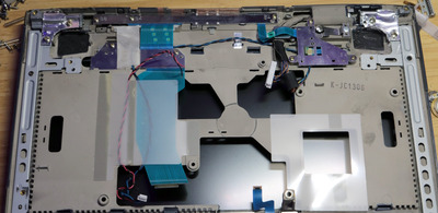

Since parts aren't easy to come across for the 2800 series now, here's how I fixed the hinges on my unit:
864.65 KiB
1436 views
Those bits of aluminium connect up the hinge metal parts to the top-case metal arms. On mine, the bottom of the hinge metal parts that connected to the top-case were snapped off, putting all of the stress on just the hinge area when opening which I think didn't help with opening it up.
The hinges themselves are the stuck ones that the laptop came with that I removed and freed up on a vice with some fresh oil, now if anything the hinges are a little weak but definitely still good enough for use.

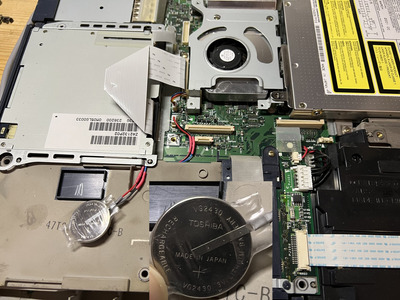

For the BIOS battery, I had a VG2430 cell from a dead T2130 mainboard which afaik is a Vanadium Lithium cell. The RTC charging / running voltage is 3.3v and I think this laptop had a 2.4v NIMH to start with but that was binned a long time ago. I might be wrong but from what I can tell, a Vanadium Lithium cell fits within the voltage range that this board is charging with and the CMOS settings are properly saved now so it should be okay? Not sure if it needs a smarter charging circuit but I think VL lithium cells can be okay with dumb/trickle charging?
The main benefit is that I now get to see the boot logo 😀

On some Toshibas like the Satellite 470CDT though, it's not safe since that particular series (440-490) and the Satellite 400-430 charge cells at 5 volts. In those ones it's better to just put in a CR2032 with a diode.
Now it's back together and I'm trying to set up a triple boot of Windows 98, the factory Windows Me and a Windows 2000 install, hopefully using NT's bootloader to manage it.

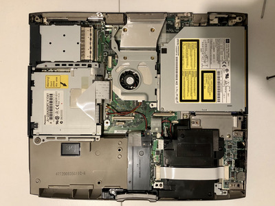

Reply 110 of 161, by vorob
You can check the model here, not the 402 but it’s the same gf2 version with higher cpu.
1.39 MiB
1357 views
