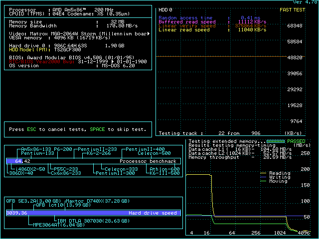

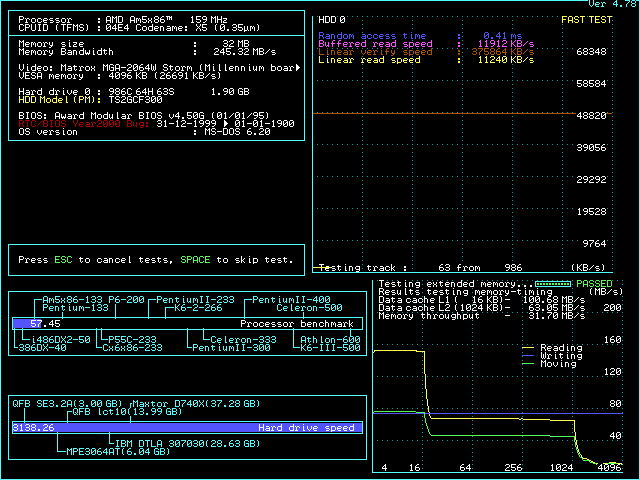

Reply 1842 of 2154, by feipoa
Since 256K generally works better at these high bus frequencies with tight timings, perhaps some of the once rejected boards will shine.
I modified my MS-4144 v2.1 board for the 30, 60, 66, 80 MHz bus options. Again, just one jumper added, with one lead at a convenient ground via and another to the S2 pin on the SC464 clock generator. This is the location I choose:
573.51 KiB
1816 views
Although I was able to find some reduced timings for the Chaintech 486SPM board to work with 1024K and 180 MHz, the MS-4144 would not cooperate. On the other hand, though, the 256K setting on the MS-4144 at 180 MHz showed improved results compared to the Chaintech 486SPM with 256K/180 MHz.
I did not shuffle around cache chips, nor do I have as good of L2 chips as Pshipkov for tight timings, but this is what I came up with for timings: 2-1-3, 2, 0, 1, 1, 2, slower.
Cachechk
L1: 186.0 MB/s
L2: 91.4
RAM read: 52.8
RAM write: 83.4
Quake: 19.0 fps
Better than the Chaintech, but not up to the UUD's speed of 19.4 fps in DOS Quake. And certainly behind the 20.2 fps of LSD. But with proper 256K modules, I suspect the MS-4144 can reach UUD speeds at 180 MHz.

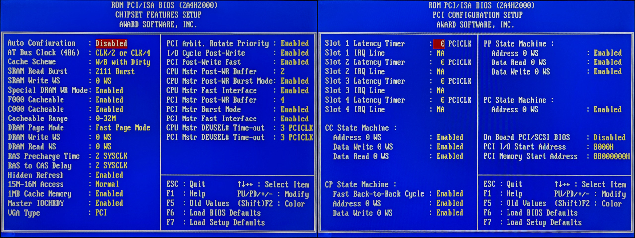

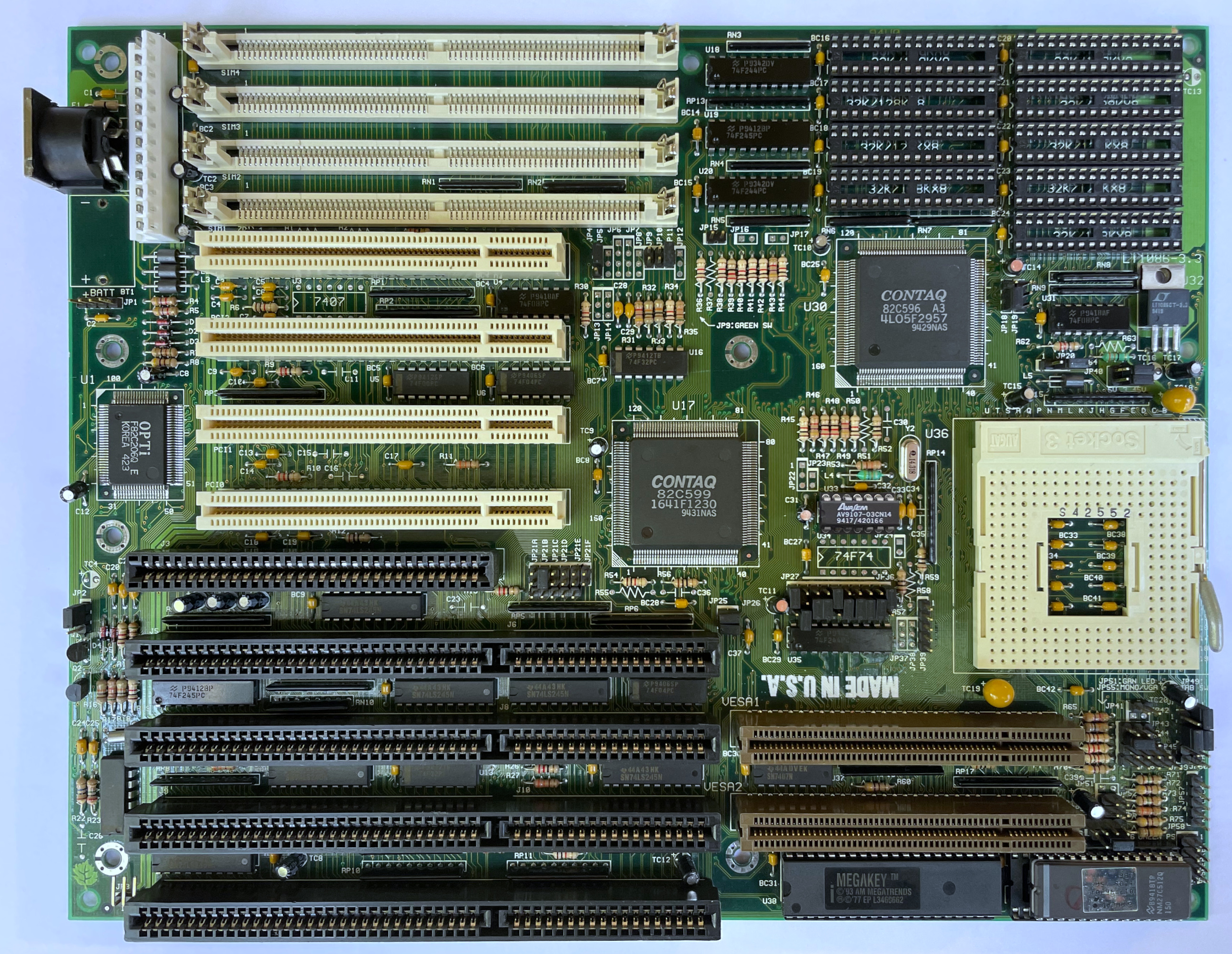

Alright, I pulled out my MS-3124 after storing it away for some time and decided to give it a go with a PGA132 SXL-40 for the heck of it. The board worked pretty well, all things told. I didn't notice any stability issues, although CTCM1.6n hung. CTCM1.5b seemed okay, which is generally a measure of stability in my book, as it tends to invalidate and flush caches, which can hang and thus immediately alert as to cache coherency problems. I guess I retract my prior statement about DLC/SXL parts. Furthermore, I used Cyrix.exe to set the CPU up, as follows:
Cyrix.exe -f -b- -m- -xA000,128 -xC000,256
This seemed to work just fine. The BIOS I have attached here is immediately aware of L1 cache, and is set via a hidden setting to enabled. This is probably not great, but it's what it is. I disabled it and then re-ran the above, but instead added the -e flag. Both cases still were stable.
I messed around with things a bit in AMISETUP v2.70 and discovered that there's all sorts of settings hidden away in this boards BIOS, including those related to Hidden Refresh and Slow Refresh, which are bound to help things a bit on a clock-for-clock basis. Additionally, I noticed a few interesting things about this board, at least with respect to mine relative to yours. Mine is a little older dated at 92, week 16 on the Contaq 592 IC and 92, week 20 on the Contaq 591. Yours possesses a Contaq 591 A, which I believe to be a slightly newer version, like how Contaq had a 596, 596 A, and even 596 A3. I doubt there's much difference there, but found it interesting nonetheless. Mine has a Chips & Technologies 206, but that's not really relevant to performance and rather just another observation.
I've attached my BIOS to this post. I am not certain if it's any different than yours.
As to the FPU situation, I am curious-have you any success on any board with a 55MHz FSB? I suspect that most of these 387s are 1.2 micron or thereabouts. The Chips J38700DX and ULSI DX/DLC supposedly are; that might be the explanation for why ~40-50MHz is about where they cap out. However, I am curious about FPU accuracy past, say, 40MHz. Have you-or has anyone-measured the actual accuracy of computations when FPUs are aggressively overclocked? I imagine that an IEEE conformance test is kind of useless in that regard, as they'll always be compliant, but there's something to be said about practicality in actual calculations past a certain limit. I guess the best way to approach that is by, perhaps, testing calculations and seeing if the proper values are being returned.

About this MSI MS-3124 guy.
I am going to walk back on my last statement about instabilities.
The next prerequisites are needed for a fully stable 110MHz system:
- good PSU with solid 5V line
- magical ULSI FPU (in addition to the magical already magical IBM BL3 CPU in use)
- selected 110MHz crystal oscillator (from tested 5-6 only 2 can do it, the rest made the system unstable, or no lights at all)
- this one is extra weird - RAM check during POST should not be interrupted, or the system gets flaky. 100% reproducible, but don't ask how that was determined.
So, i am back in business with this board after all, but things are on the edge. : )

After the unexpected outcome with MSI MS-3124 version 2.1 based on Contaq 82C591, 82C592 my interest in Contaq chipset piqued and wanted to see how their stuff does in the realm of 486.
Addtech Galaxy II 486 revision 1.0 based on Contaq 82C596 A3, 82C599.
The motherboard is in visually perfect condition.
Even the battery didn't leak after all the years, but removed it anyway.
Lots of slots - 4 PCI, 4 ISA 16-bit ISA, 1 8-bit ISA, 2 VLB slots.
Interesting clock generator that supports up to 100MHz frequencies.
Jumpers for 3.45V and 5V CPUs.
Lit-up right away, but the clock generator was stuck at 8MHz for some reason.
Quickly realized that there is an electrical issue with its control jumpers.
More information in this thread.
Won't go in details here. In short - socketed the clockgen chip and connected the FS1/2/3/4 pins to GND or +5V pins on the board for direct control.
With that out of the way the board was ready for testing.

--- Am5x86 at 160MHz (4x40)
All BIOS settings on max.
Everything just works.
Nothing more to say really.
Nice experience.
Btw, the BIOS contains interesting settings that i haven't seen in microcodes for other chipsets. Take a look:
Level 1 cache policy is stuck in WT mode. If force WB mode with an interposer, performance drops significantly.
benchmark results
Not a great performer overall - below the average in most tests.
--- Am5x86 at 200MHz (4x50)
All BIOS setting on max, except SRAM READ BURST = 3222.
Anything tighter than that and POST does not complete.
It is not the cache chips - they handle 2111 with other boards just fine.
Still, tried to find a combination of them that can eventually do it, but fairly convinced it is the motherboard itself.
benchmark results
Performance is much worse than 4x40MHz. Apparently the inflated L2 cache timings are taking their toll.
Disabling L2 cache entirely further degrades performance.

Reply 1857 of 2154, by feipoa
I haven't seen any other motherboard with 4 PCI + 2 VLB, let alone with a single 8-bit ISA slot. Interesting layout.
