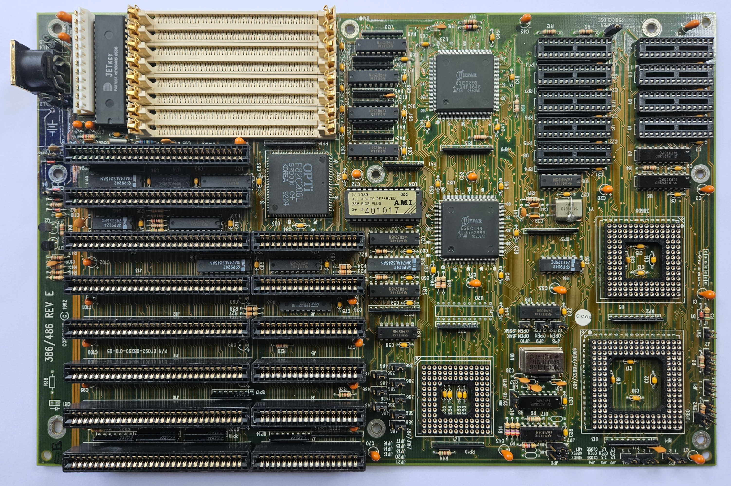

Didn't expect i will be making this post, but things turned better than anticipated, so here i am.
Caching Technology Corporation 386/486 revision E based on Efar EF8290WB - 82EC495, 82EC392 (which is supposed to be relabeled OPTi 82C392, 82C495B ?)
This motherboard came dead on arrival.
Big battery leak long time ago destroyed a lot of real estate in the upper left corner.
Weak repair attempt at the time was unsuccessful, so i left the board marinating in the graveyard pile.
Until recently.
The inspection of Matra 486SLC2 VESA revealed interesting characteristics of Efar EF8290WB.
At the same time that was an on-rails experience with the on-board soldered CPU/FPU.
That sparked my curiosity about how the chipset will handle wither range of CPUs/FPUs.
Spent the time for proper repair of the Caching Tech Corp motherboard.
Most of the traces were eaten up by the acid to a point that it was not possible to figure out what the connectivity was.
Managed to find few photos online that helped with that.
The fixing of the surface rails led to an interesting visual phenomena - somewhere in the inner layers a short circuit resulted in a "lighting within" - the translucent PCB was glowing in that area from inside.
Was not sure what to do about it.
Felt that i am loosing any chances of fixing the board.
Decided to dig to that layer without further plan.
Luckily the fact of digging and reaching that place was enough by itself to separate the touching rails.
Board came to life. For my great pleasure.
After that spent time to cleanup and apply multiple layers of conformal coating.
End result looks pretty decent.

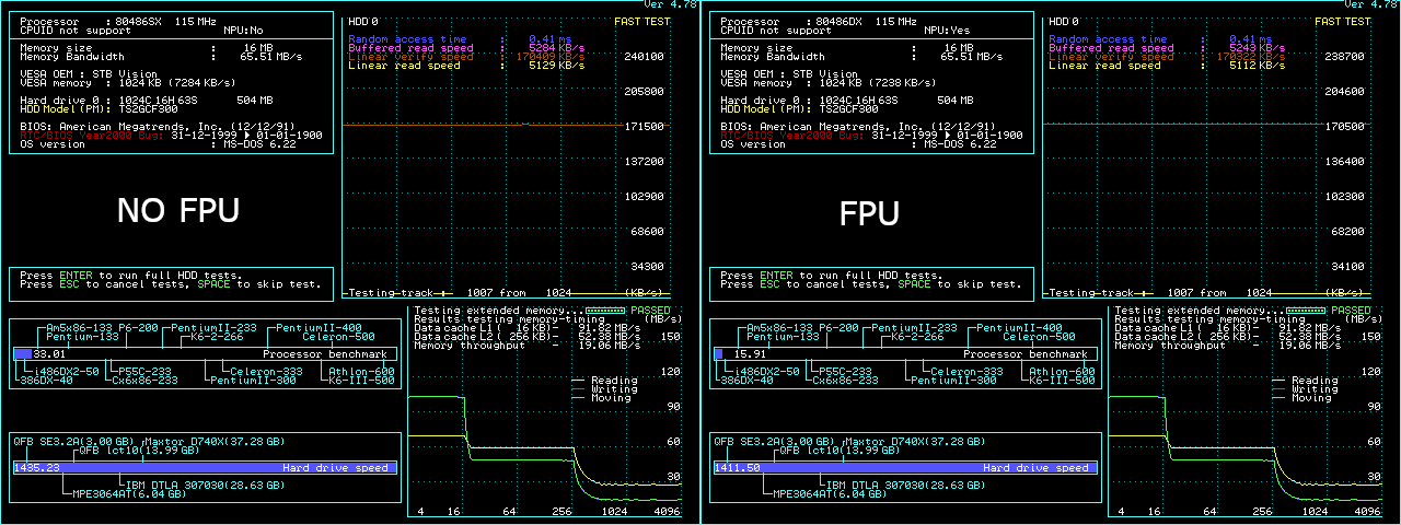

With the board seemingly working fine i moved onto testing it.
One thing that bugged me from the beginning was the 50MHz crystal oscillator.
Was it a sign of slow-system, assuming that's how the board left the production facility, or it was inserted there later based on some unknown circumstance.
(turned-out to be the first case)
Motherboard works at up to 45MHz FSB (90MHz oscillator). No lights past that.
Unstable past 35MHz (70MHz oscillator) if FPU is present. This was a real bummer.
Decided to perform partial testing at 40/45MHz without FPU instead of going down to 35MHz, which is too slow base frequency and not very interesting to start with.
For the tests i used STB Nitro ISA graphics card with 2Mb RAM (Cirrus Logic GD-5434), 256Kb level 2 cache, 16Mb 50ns RAM (4x4).
--- IBM BL3 at 90MHz (2x45), ISA bus at 11.25MHz
System is inherently unstable regardless of BIOS parameters.
Most tests never finish.
Frequent hangs in DOS.
Impossible to get into Windows.
--- IBM BL3 at 80MHz (2x40), ISA bus at 10MHz
System is fully stable (without FPU).
All BIOS settings on max, except:
DRAM WRITE WAIT STATE = 1 (best is 0)
DRAM WRITE READ STATE = 1 (best is 0)
AT BUS CLOCK SELECTION = CLKI/6 (best is /3)
Clock-to-clock performance is not bad, but at "mere" 40MHz FSB it is at the bottom of the charts.
--- TI 486SXL2 at 45MHz, ISA bus at 7.5MHz
Speedsys produces corrupted graphics with this processor, which is often the case on many motherboards.
Performance is not great. One of the slowest boards around.

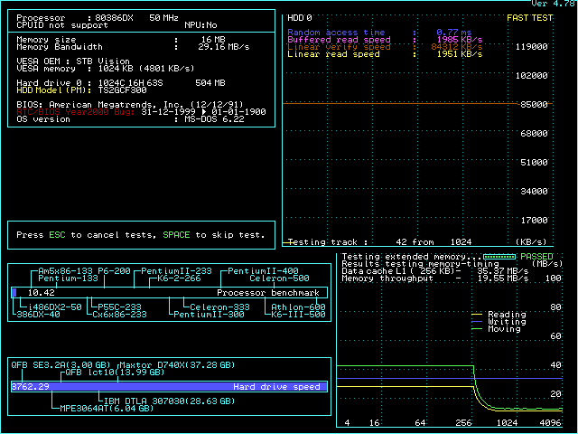

--- AMD 386DX at 45MHz, ISA bus at 7.5MHz
Again, very low to intermediate at best performance.
benchmark results
Look for CTC 386/486.
Kind of disappointing experience overall.
The system is clearly designed for lower frequencies and didn't cope well with the expected 40-45MHz.
Matra's board is a much better integrated assembly that makes the EFAR (OPTi) silicon look much better.

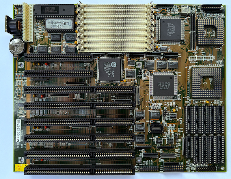

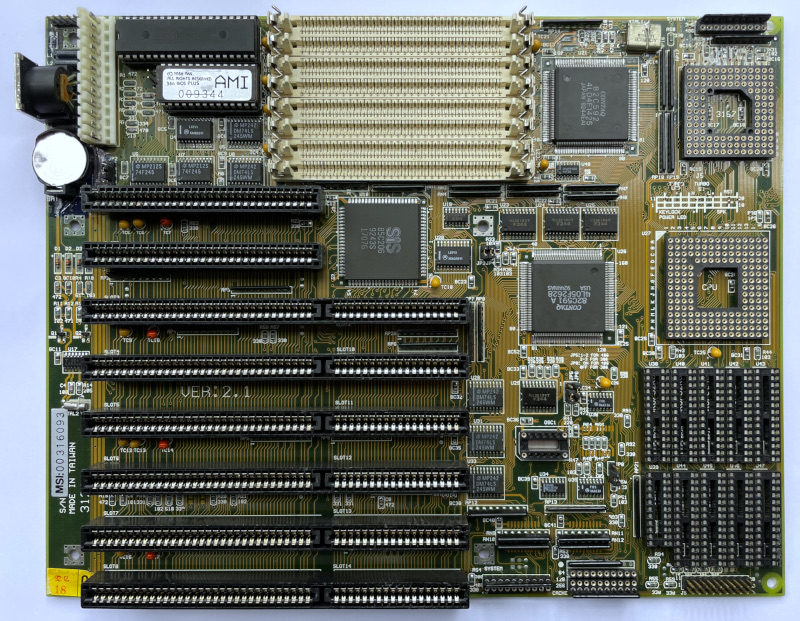

Reply 1829 of 2371, by pshipkov
Until now this post outlined the highest performance watermark for 386 class hardware, but nothing lasts forever.
MicroStar MS-3124 version 2.1 based on Contaq 82C591 A, 82C592
The fastest classic (ISA bus) 386 motherboard
... to date.
386 motherboards with this chipset are very rare.
Apart from two dysfunctional boards that i obtained in the past - the one showcased here and another one (no FPU socket), nothing else came up in the usual e-market places over the last several years.
But the recent success of resurrecting Caching Technology Corporation 386/486 revision E (few posts above) prompted me to give MS-3124 a proper try.
There was a lot of damage from a leaked battery.
Most traces in the area were destroyed completely, on both sides.
Close inspection revealed that inner layers are affected as well.
Chances were low, but inspiration was still high.
Was able to piece together the surface rails from couple of photos online.
A bit of guess work for rails under the power connector.
Work took multiple iterations and a serious effort.
This culminated in the system coming to life.
Except that the keyboard was not working.
After multiple rounds with the multimeter and comparison with other boards it was determined that 2-3 traces between the keyboard connector and controller were damaged somewhere in the inner layers.
Bodge wires on the back patched the issue.
I fixed many dead motherboards throughout the years and never thought much about it.
But fixing this and the mobo from few pages above (both rare earths) in a row made me feel like hundred dollars.
With things back online i moved to testing it.
Curiosity was high.
EDIT (several months later):
Sheer dumb luck guided me to another MS-3124 board - this one in perfect health. Both motherboards perform similarly.
It is worth mentioning the easy jumpers setup.
The MSI designers simplified it to 2 resistor arrays and one jumper.
Big +1.
AMISETUP reveals hidden BIOS parameters for ADAPTOR ROM SHADOW, DRAM HIDDEN REFRESH, DRAM SLOW REFRESH, CPU CACHE MODE (WB/WT).
The DRAM ones work at up to 50MHz base frequency and make the system unstable at 55MHz. The CPU CACHE MODE makes no difference with IBM BL3 chips - i think their level 1 cache is operating in write-through mode regardless of what the motherboard BIOS says.
Ok, back to testing.
Used STB Nitro 2Mb video card based on Cirrus Logic GD-5434, standard ISA IDE controller, 256Kb level 2 cache, 16Mb 50ns RAM.

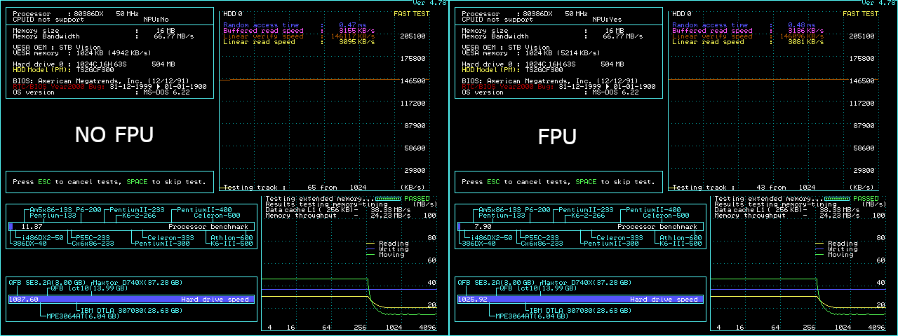

--- AMD 386DX at 50MHz, ISA bus at 12.5MHz
DRAM READ WAIT STATE = 1 (best is 0)
ISA bus divider = 8 (best is 4)
System is fully stable.
No problems at all entirely.
Feels great.
Intermediate performer.

System hangs during POST if level 2 cache is enabled.
Tried all sorts of settings and tricks, but there is some hard incompatibility.
This was unexpected and disappointing.
Tried the 486 BIOS from the other Contaq board i have, but microcodes are incompatible = no lights.
Decided not to test the no L2 cache configuration.
--- IBM BL3 at 110MHz (2x55), ISA bus at 27.5MHz
SRAM WRITE WAIT STATES = 1 (best is 0)
DRAM READ WAIT STATE = 2 (best is 0)
ISA bus divider = 4
System is completely stable. Very satisfying.
Nothing more to say really.

It is worth mentioning that SRAM WRITE WAIT STATES can be set to 0 for tiny bit of extra speed without observable side effects for games and casual tasks, but may affect complete stability under heavy load.
This configuration is reflected in the combined charts (linked at the bottom of this post) with gray bars as an indication for peak performance, but at potentially compromised stability.
And this is how we arrive at the fastest 386 motherboard to date.
Simple as that.
benchmark results
Not the fastest clock-to-clock assembly, but overclocks great and is solid.
Once i set the one-two BIOS parameters listed above - the thing just works.

Reply 1830 of 2371, by pshipkov
Realized that not all crystal oscillators work on all 386 motherboards.
This is especially true for those 100/110/120 MHz oscillators.
So, i had to go back and recheck all boards that could overclock to 50 or more MHz FSB. Luckily they are not that many and only 2 of them had to be retested.
As a result the above post for MSI MS-3124 motherboard was updated and now states "the fastest 386 motherboard" (to date).
(this may require CTRL+F5 content refresh in case some images are stale in your local web browser cache, which can lead to confusion - discrepancy between text and pics)
Updated the post for Asus ISA-386SIQ (SiS 85C461)
User @JakeThompson1 shared some utils for adjusting wait states, ISA bus and few other parameters of the assembly, because the BIOS does not offer any control over them.
This prompted me to do a search for alternative BIOS microcode.
Found one from Soyo SY-019 which worked pretty well and offered enough control.
Long story short: with tight wait-states performance increases by 30% on average which moves the board from very slow (at the bottom of the combined chart) to intermediate.
Not a mindblowing outcome, but at least it confirms that SIS460461 based boards are lacking.
Something that was not clear in the past because of the crippled BIOS.

Reply 1833 of 2371, by WJG6260
While I have a brief moment, I wanted to add something about the MS-3124. I’ve had this board for a while and I can indeed confirm the difficulties with SXL CPUs. DLC parts also do not work well, if at all.
However, this board is very strange insofar as it isn’t truly capable of taking a PGA168 CPU. I think the socket it has is actually PGA175. This is a 386/486 hybrid board, but the onboard CPU socket is designed such that it can accommodate the PGA144 Chips & Technologies J38605DX. I believe-but may be mistaken-that this is the only known board that can accommodate this odd CPU. Its main notable feature is the 512 bytes of instruction cache, which the PGA132 J38600DX otherwise lacks. I think that makes it kind of neat, but I’ve no idea what performance looks like. Supposedly the J38600DX is a little faster than Intel/AMD’s parts, and it was a clean-room design, but the 486DLC/SXL are in another league; of course, so is the IBM BL3.
The 486 side of things comes via a daughter card, referenced in the manual as the MS-4901. I don’t think I’ve ever seen one. Does anyone know what these daughter cards look like or how they connect?
I’ve attached a copy of the manual from TRW. The CPU information is derived from Section 2-2, or page 11 of the pdf.
-Live Long and Prosper-
Feel free to check out my YouTube and Twitter!

That MSI board is a weird beast for sure. It certainly is a hybrid system based on hybrid silicon. That does not bother me much. I am going for BL3 CPU to start with. Gone are the days where i was going for "pure" 386 class machine.
I also noticed the unusual CPU socket, but didn't bring it up, because was not able to find any relevant information, so it was not clear why it is like that.
@WJG6260 no idea where you found the manual, but sharing it here is well appreciated.
Appreciated are and the notes about C&T's CPU and MS-4901 adapter.
