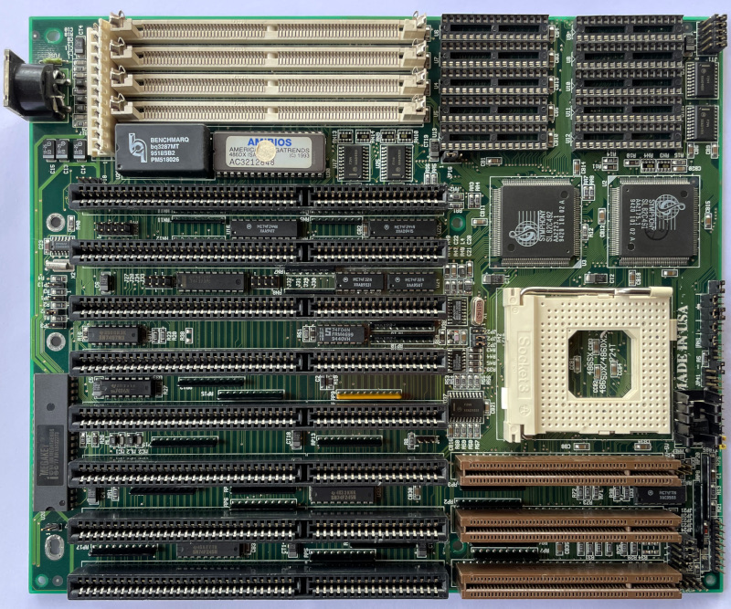

I think I got the same board now.
The attachment PXL_20240227_171732007.jpg is no longer available
A bit dirty, but otherwise in a very good condition.
It allows for 1MB L2 cache, the Dallas chip is socketed, there is even a mouse header (but I am a bit confused that it is 10pin).
Not tested yet, but I will do it soon.
EDIT: I will make a shoot-out against the SV2GX4. I guess the SV2GX4 will win, I really like the 159 in Wolf3D and the 66.7 in Doom 😁. On the other hand this board seems to support 128MB, which is somehow nerdy and I like it. We will see.

Any indications it was in a Dell? First half of 486es Dell seemed to like bus mice and some of the boards from them had onboard busmouse header.
Reply 2023 of 2513, by CoffeeOne
BitWrangler wrote on 2024-02-27, 18:17:
I have no clue about the origin.
So 10 pin is a bus mouse header? I guess will stick to a serial mouse then ....
Reply 2024 of 2513, by BitWrangler
It's a possibility to bear in mind, can't say for sure.

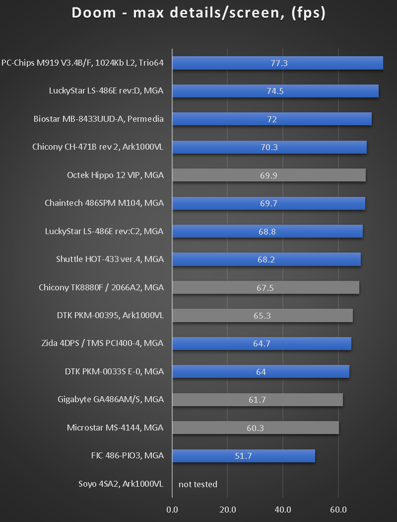

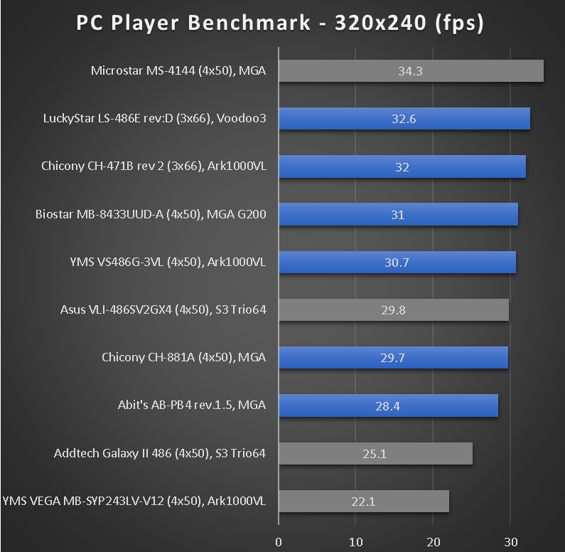

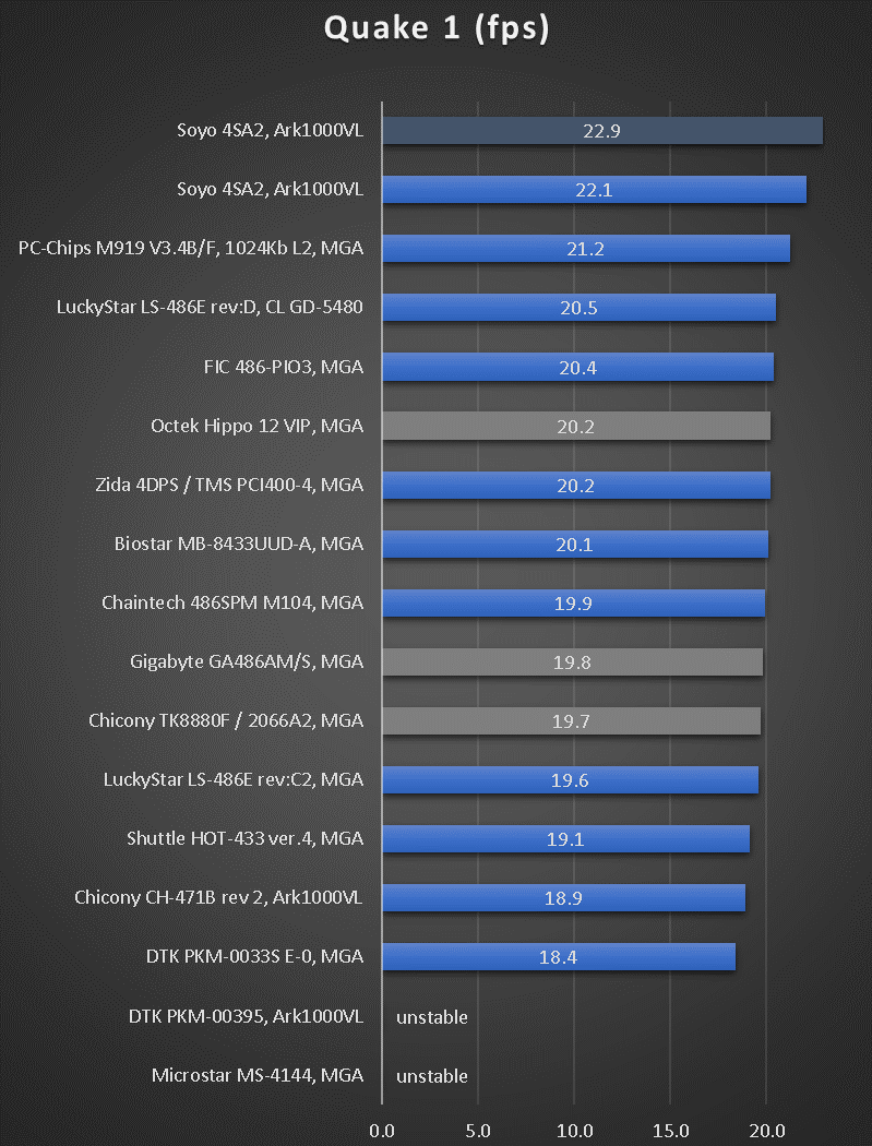

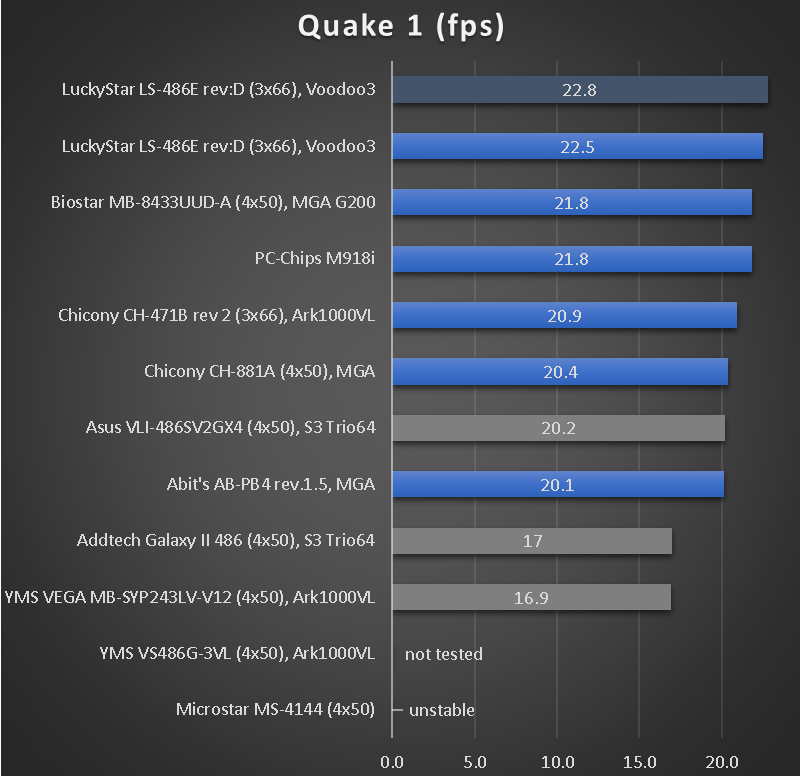

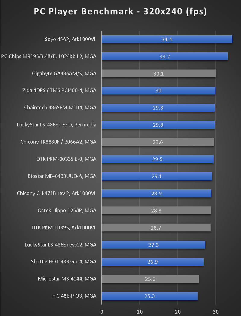

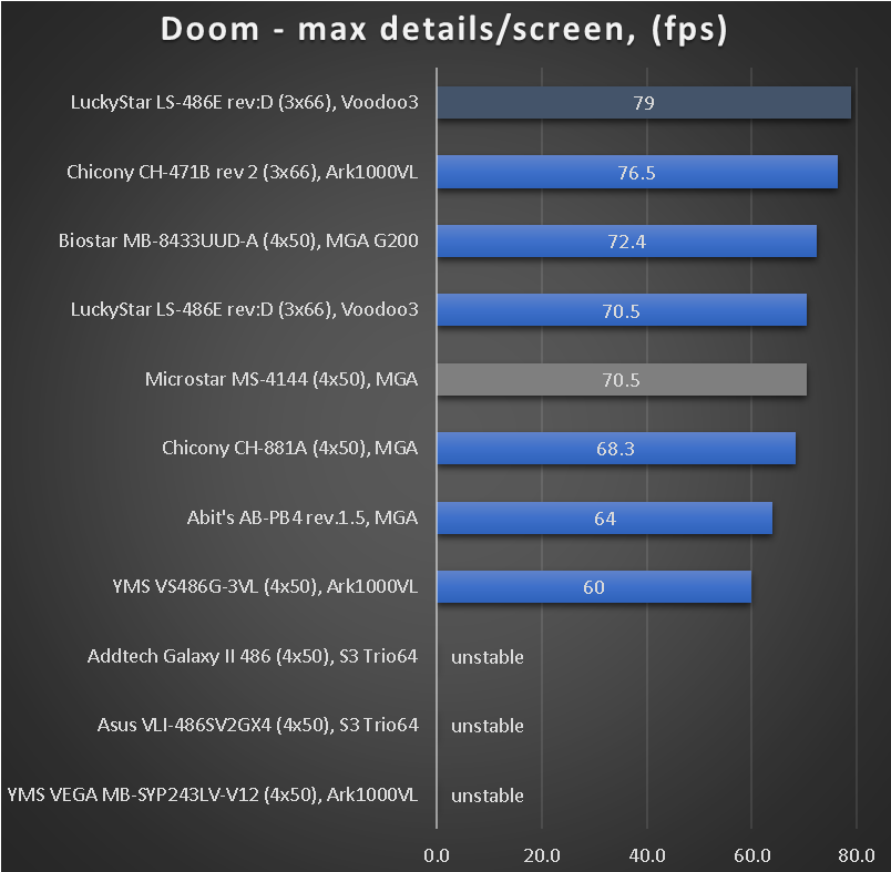

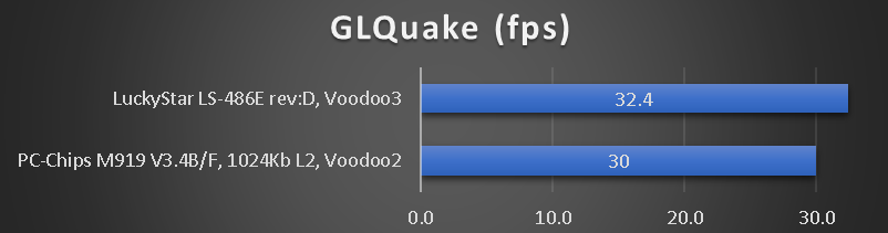

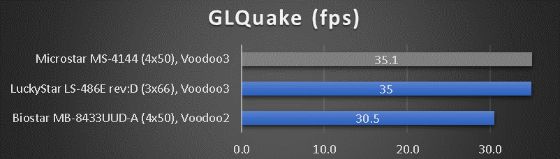

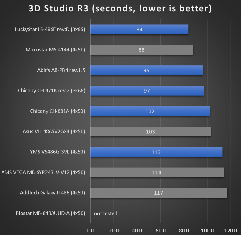

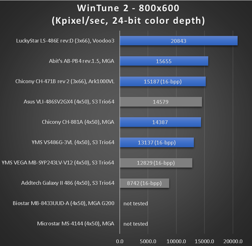

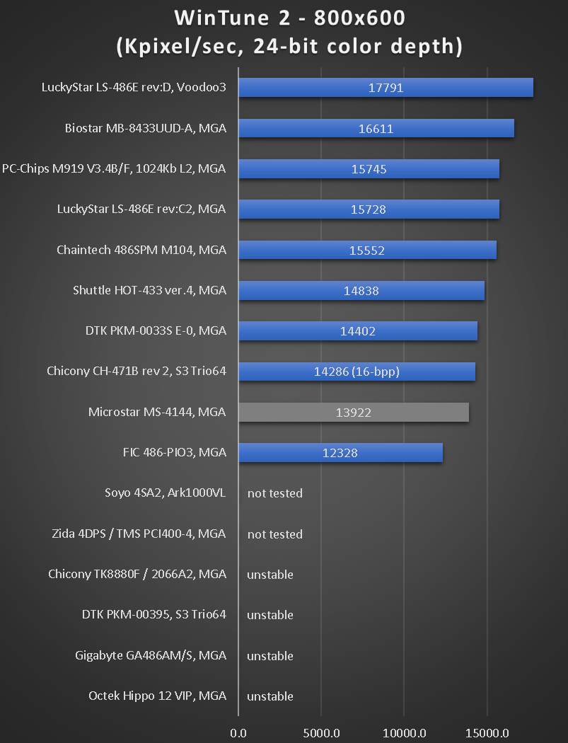

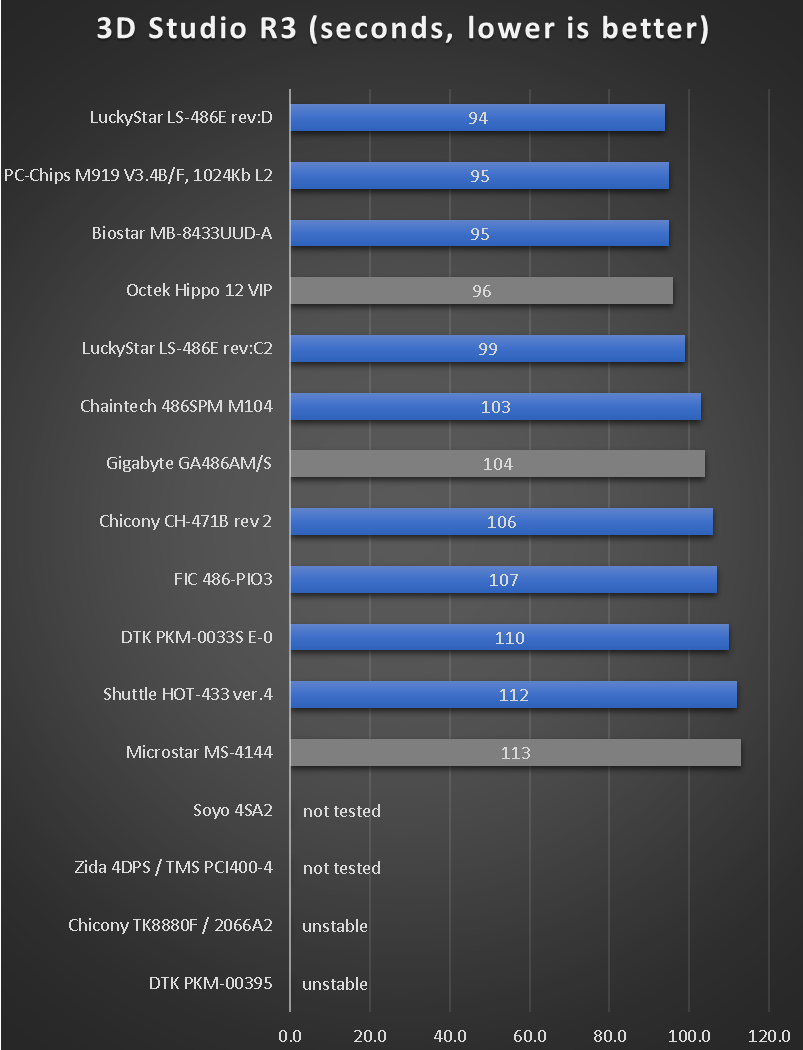

486 class motherboards with AMD Am5x86 processors running at 180 and 200 MHz
Numerous motherboards have undergone evaluation.
The charts present a select few from a larger list that demonstrate relative stability at 180/200MHz.
The gray bars represent those that haven't achieved full stability, having failed at least one test.
The blue bars denote motherboards that are completely stable. In other words - these are the most interesting ones.
Deep blue bars indicate peak performance of a fully stable system, but pushed to a maximum overclock that may compromise stability.
This data effectively highlights the top-performing motherboards in the 486 class.
(It looks like i lost data for Shuttle HOT-433 rev 4 and Pc-Chips M918i at 200MHz, will re-run and update later)
------------ 180MHz (3x60) ------------
------------ 200MHz (4x50, 3x66) ------------

I am happy that VL/I-486SV2GX4 @160MHz + Ark 1000 is still ahead in Wolf 3D, beating the fastest 200MHz machine. OK, it is only Wolf3D everywhere else clearly slower 😀

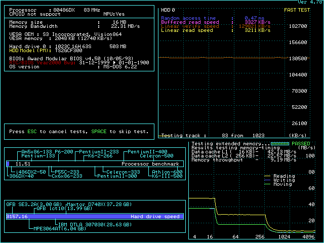

Re: Where to obtain 110 MHz RAMDAC for ARK1000VL graphics card?
Ark 1000 clocked to 80MHz (before it was 60MHz).
Values did not change much except Wolf 3D. Massive increase in speedsys video throughput.
I will make a new table of all Dos benchmarks for VLI 160, Ark1000 @ 80MHz here soon.
EDIT: Yes, fully stable. Windows 98SE approved.

Nice and fairly complete charts again. The first thing that will probably cross the minds of other's when viewing the charts, is 'how can i replicate this?' - e.g. was pshipkov only using 256K WB on that UUD, how much RAM, what CPU voltage, and was a peltier needed to be stable inside the case. It's probably too late now, but it would be helpful to include under each heading, in smaller font, something like (256k-i-wt, 2-1-1-1, 32M EDO, 1/0 ws, 4V, no peltier). I see you already have the video card listed on the chart, which is helpful.
Wouldn't the ARK1000VL be faster on the M919 compared to MGA? When looking at your scores, I get 77.3 fps in DOOM using ARK1000VL, while your tabulated score is only 75.4 fps.
Is the M918 run cacheless?
It would be nice if you were able to include more GLQuake scores for comparison. This means you'd need a Voodoo2, since this is more compatible across socket 3 motherboards compared to the Voodoo3. For reference, my M919-180 gets 30.0 fps in GLQuake.
What's the DOOM score for the Soyo 4SA2? The chart says not tested.
From the results, it looks like the M919 w/1024K is probably the best overall board for stable 180 MHz operation. I was able to run my M919 in a standard AT mini tower with air only cooling at 4 V. The challenge I ran into was finding memory modules stable enough to run at 2-1-1-1, 1/0 ws, yet while having more than 64 MB EDO DRAM. I eventually found stable modules in sizes 32 MB total, 48 MB total, 96 MB total, and 128 MB total. Do not use 64 MB total or you will have a performance hit, especially noticeable in Quake.

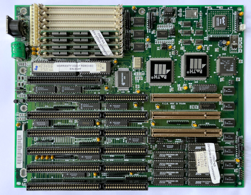

First in line is Matra 486SLC2 VESA based on EFAR Microsystems 82EC392, 82EC495 (relabeled OPTi 82C392, 82C495B) chipset, hidden under cool stickers with the word "PATH" written on them.
Still in great condition despite some scratches on the VLB and ISA slots which indicate some rough handling here and there.
Warranty labels still in place. Traces of small battery leak that was taken care of before causing real damage.
One day will spend the time to find what "PATH" stands for. Anyway.
The motherboard is interesting for several reasons.
The obvious ones - a mixture of rare IBM BL2 (SLC2) processor soldered on-board, 256Kb level 2 cache (unusual for 386SX class system), and a VLB interface.
EFAR chipsets are seen predominantly in cost reduced assemblies, or late hybrid 386/486/VLB ones.
The first type are perf and scalability crippled in various ways, the second type come with 25/33/40MHz clock generators instead of crystal oscillators which limits overclocking options.
This motherboard comes with up to 80MHz clock generator, but also has wiring for crystal oscillator which opens the path to overclocking and discovering where the performance peak really is.
Removed the clockgen from its socket. Soldered 4 pins. Ready to roll.
It will be great if one day i manage to obtain one of these late EFAR based mobos to test with BL3, SXL2 and standard 386DX processors. Ok, back to tpoic.
It was established in the past that the fastest 386SX class system is Alaris Leopard (OPTi 82C295) with the same IBM BL2 CPU, so i was really curious how the EFAR chipset will stack against it and handle the unusual combination of hardware this Matra motherboard is.
Only 25 and 33 MHz base frequencies are supported via jumpers, but i was able to find a 40MHz configuration. Unfortunately between warm resets the frequency drops down to 20MHz from time to time.
This was another incentive to move to crystal oscillator.
The system takes 80MHz crystal with easy, but struggled with 90MHz. No lights at 100MHz.
While my hopes for higher overclock faded quickly, at least 80MHz became reliable between resets.
All jumper configurations on max.
The AWARD 4.51 BIOS resembles 486 layout and type of options. There are quite a few timing settings.
All parameters on max except:
CACHE DATA BUFFER OUTPUT = DISABLED (best is ENABLED)
DRAM QUICK READ MODE = DISABLED (best is ENABLED)
DRAM QUICK WRITE MODE = DISABLED (best is ENABLED)
Similar to Alaris Leopard this motherboard was not happy with most VLB EIDE controllers - their DOS drivers hang during initialization.
DTC 2278E worked fine but had to be slowed down a lot which kind of defeated the point of using an EIDE controller. If nothing else it proved that 2278E is one of the most compatible guys around.
Ark1000VL works fine.
One unexpected outcome - the S3 Trio64 VLB driver hangs Windows. This is an omnipresent occurrence regardless of jumper/BIOS settings.
Happens even with the slowest possible base frequency and most conservative wait states.
Used Orchid Kelvin 64-VLB 2Mb (Cirrus Logic GD-5434) instead - slower than Trio64 in Windows, but still pretty good.
(Will double check that stuff at some point later)
benchmark results
Matra / EFAR 82EC392, 82EC495 is in the top performance tier for 386 class hardware and on par with Alaris Leopard / OPTi 82C295.
It is same or faster in some of the DOS interactive graphics tests, slightly slower in the FPU intensive ones.
Really liked this motherboard. Not an entirely trouble-free experience, but somehow it grew on me a lot.
Maybe because it is a great/better alternative than Alaris Leopard, which until now was in a class of its own in the area of all things 386SX.
Also, this was my first time with EFAR silicon that i really wanted be good, and it did.
Excited to say I found one of these today. Facebook find. Owner left it behind in a barn. The people who bought the property were selling off stuff. Found an Adam computer, and told them after buying that to keep an eye out for other computer stuff. A week or two later and this with one of those classic at cases. The kind that everybody goes Gaga over with the LEDs and chunky front switch on the mini tower. I had no idea what this IBM CPU was when I first popped a little cover off of it.
Reply 2036 of 2513, by pshipkov
@TimWolf
Good story.
Is the motherboard working ? These are quite rare. I have seen only 2 of them showing up online, mine including. Yours is the third one.
What else was in the PC case, since you mentioned it ?
@feipoa
Can add extra bits of info to the left-side descriptions - amount of L2 cache and RAM.
Not sure if adding there cache/ram timings will be useful - can get overcrowded, but will experiment with the formatting to see what can be done.
I rely extensively on the directory in the first post of this thread. So if i want to lookup one of the combined charts, i usually have 1-2 tabs open.
One for the chart and another for the post of the hardware in question.
In the individual posts i tried to establish some schema. For example, for 486 hardware you will see 4x40, 3x60, 4x50, 3x66, POD100 sections.
Timings and other details are listed there. Just the other day i was combing the UUD posts for more consistency.
But i understand that this is not straightforward. Fact is that this blog format does not fit the mechanics of a web forum.
Biostar 8433UUD 3.1, 200MHz (4x50), 256kb 12ns L2 cache, 32Mb, fastest timings, 1:1 CPU:PCI, 5V to CPU + air cooling
Biostar 8433UUD 3.1, 200MHz (3x60), 256kb 12ns L2 cache, 128Mb, fastest timings, 1:1 CPU:PCI, 3.45V to CPU air cooling
PC-Chips M918i
Running without L2 cache. Otherwise things get real slow, as we found out a while ago.
PC-Chips M919
I think you upgraded your RAM modules with 10 or 8 nanosecond chips which allows you to go slightly tighter on the wait states.
Can you list your results here, with details added ?
Would like to update the charts with them.
64Mb is no-no for this board. Weird stuff.
But you are right, this board with 1Mb L2 cache module is probably the nicest/easiest/fastest assembly for 3x60.
(Btw, i have to pick another top score from @CoffeeOne - Wolf3D with VLI+Ark1000VL @160MHz)
Soyo 4SA2 @180/200MHz was tested by @Chadti99.
I need to run the missing tests for it. That will be for later.
About more GLQuake tests.
Voodoo cards are not my thing, so i find it hard to motivate myself to deal with them.
UMC based boards being prickly about V3 and later models only makes it worse.
: P

Yeah I know, it can get messy, which is why I'd stick with the core hardware values and stick to a single line in small font. Any more and it would get cumbersome to read through.
The 8 and 10 ns SRAM modules did not improve wait states at 180 Mhz on the M919. Still can only do 2-1-1-1, 1/0ws w/EDO 32 MB or larger. I think 16 MB could do 0/0 ws, but this is also what you uncovered with the 12 ns modules. I was only intending to point out that your numbers could improve if you used the ARK1000VL on the M919. If you run MCLK on ARK1000VL at 80 MHz, you can further get some Wolfy3D improvement.
For my M919 v3.4BF, the details are:
Am5x86 QFP, 3x60, 4 V. no peltier
1x128 MB EDO, 1/0 ws
1024K double banked, WT, 2-1-1-1
ARK1000VL, 80 MHz MCLK
60 MHz FSB, 60 MHz to VL bus, 30 MHz to PCI bus
Start EDIT:
DOOM: 77.3 fps (fullscreen, but with utility bar)
DOOM: 75.22 fps (fullscreen, no utility bar)
Quake: 21.1 fps (previously I had 21.8 fps. I'm not sure what caused the drop in framerate)
GLQuake: 30.0 fps
PCPBench /VGAMODE (320x200): 32.0
WolfyD: 152.4 fps
WinTune 2.0 (Win95c):
12149 Kpix/s at 1280x1024x256c, 60 Hz
9644 Kpix/s at 800x600x65k, 60 Hz
3272 Kpix/s at 800x600x16M, 60 Hz
When did everyone start benching Doom without the utility bar? Is it just phispkov, or was it due to Phil's Bench Pack?
End EDIT

<Chart> GLQuake (fps) […]
<Chart>
GLQuake (fps)
Microstar MS-4144 (4x50), MGA = 35.1
Luckystar LS-486E rev:D (3x66), Voodoo3 = 35
Biostar MB-8433UUD-A (4x50), MGA G200 = 30.5
<Chart>
At what resolution is the Matrox G200 running GLQuake and with which driver revision? 35.1 fps seems way too fast for a Matrox, especially with the Voodoo3 at 35 fps.
