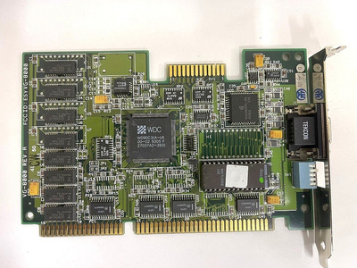

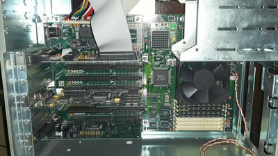

Here is a picture of my current 'best' ISA video card, and a picture of the system. I'm still doing some repairs on the front panel plastics and the LED speed readout, so I don't have the system fully completed yet.

Reply 1982 of 2457, by pshipkov
that is very interesting indeed, about the WDC VGA card.
i have wd90c30 isa and wd90c33-z vlb models and as you said, they are excellent dos blasters, but slightly slower than et4000ax.

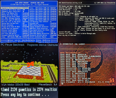

Reply 1985 of 2457, by 386DX40
pshipkov wrote on 2023-11-24, 21:46:
that is very interesting indeed, about the WDC VGA card. i have wd90c30 isa and wd90c33-z vlb models and as you said, they are e […]
i still have this motherboard.
if you confirm that the numbers you posted are the best you were able to achieve with the vga in question, i can match the config but strap an et4k ax card to see what comes out of it on my end.
it will be cool if we have some sort of revelation here. : )
The two ET4000AX cards ISA cards I originally tested with many months ago when I first got this system going may not be the best of the best. One was an Everex Viewpoint NI with only 512kb of 80ns memory maximum, and the other was marked "super VGA" and it too only had 512kb of 80ns memory with 4 open slots for upgrade chips. And I no longer have either card. So if you have a high end ET4000AX it would be interesting for you to try your board and see how we can compare performances.

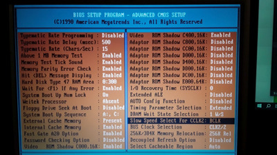

Here is a picture of my AMI BIOS setup screen showing the settings I have found to work best for maximum stability and performance at 16.5MHz ISA. I'm using the AMI BIOS core version 070791 originally and kindly provided to me by Vogons user 'Anonymous Coward' which is now available on the retroweb. Anonymous Coward suggested trying the 'Mr. Bios' Haydn BIOS, but I haven't gotten around to flashing it yet so it's possible that there may be more performance available? There are several settings in the AMI BIOS that can't be set for supposedly maximum performance as they cause boot failure even at 8MHz ISA speeds.
Am also wondering what are the experiences here on Vogons with overclocking the various Kingston/Evergreen etc 5x86 upgrade CPUs that have a 5volt regulator onboard? I have heard in the past that the upgrade CPUs don't like being overclocked. Thusly if I tracked down an oscillator for 40MHz I'd probably have to move the jumper on the Evergreen from clock quadrupling to clock tripling which would result in a 40MHz bus and 120MHz CPU speed so may not be worth it really. I also wonder how ISA overclocking on this board would be affected by a 40MHz or 50MHz bus speed? Oh and the L1 and L2 caches only work in write-through mode.

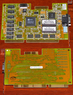

Also here is what my other Paradise branded WD90C31 ISA card looks exactly like. It has a different RAMDAC onboard and doesn't have quite as nice of an image on LCD that the DFI card does with it's Samsung RAMDAC. That card like I mentioned previously is ever so slightly slower than my DFI branded one. This image was borrowed from https://computer-retro.de/Grafikkarten.html
Intel D845PT - Pentium 4 2.2 - 512MB - Geforce FX5200 128MB - SoundBlaster Live - 80GB HDD - Win98SE
DTK PKM-3331Y - Evergreen 5x86 133 - 16MB - WD90C31A 1MB ISA - ESS 1869 ISA - 2.5GB HDD - MS-DOS 6.22

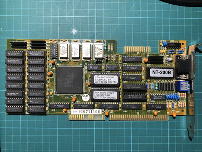

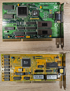

Here is what i see with the same motherboard, same BIOS version + settings, DOS 6.22, Am5x86 CPU 4x33MHz, ...
The attachment 20231125_152227.jpg is no longer available
... using 2 different ET4000AX ISA cards. A very late one (top) and an early one (bottom, that is going to be butchered soon for a higher cause).
The attachment 20231125_153147.jpg is no longer available
If we are not missing something, the ET4000AX card seems to be doing better in these DOS tests.

Reply 1987 of 2457, by 386DX40
Wow, thanks for the results pshipkov! That top card is a very nice ET4000AX, Micro-Labs as I recall? I guess I will have to track down a high end ET4000AX card for this system after all, as your results definitely back up that the ET4000AX is still basically the 'king' for ISA speed! The WD holds it own though!
