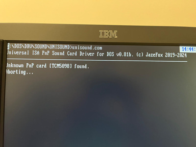

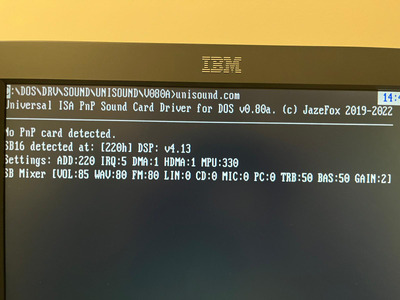

I found a bug in Unisound v0.81b, I have an SB 16 sound card.
Version Unisound v0.81b show error msg "Unknown PnP card TCM5098 found."
file.php?mode=view&id=199974
Version Unisound v0.80a.. ok everything works.
file.php?mode=view&id=199975

Retromachines wrote on 2024-08-25, 08:29:
I found a bug in Unisound v0.81b, I have an SB 16 sound card. […]
Try to run unisound with the /CS (or /NOPNP) parameter. What is happening is that you have another non-soundcard PnP card in your system, and this is confusing unisound.
I've had the same issue, and this solved it for me.

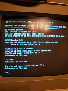

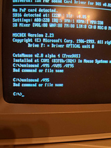

scroeffie wrote on 2024-10-13, 16:56:
does unisound have mixer settings i can acces ?
   /Vnn   Set Master Volume level to 'nn' % (00-99)
/VWnn Set Wave Volume level to 'nn' % (00-99)
/VFnn Set FM/Synth/WT Volume level to 'nn' % (00-99)
/VLnn Set Line-in Volume level to 'nn' % (00-99)
/VCnn Set CD Volume level to 'nn' (00-99)
/VMnn Set Mic Volume level to 'nn' (00-99)
/VPnn Set PC Speaker-in Volume level to 'nn' (00-99) (Creative)
/VTnn Set Treble level to 'nn' (00-99) (Compatible cards)
/VBnn Set Bass level to 'nn' (00-99) (Compatible cards)
/VRnn Set FM Reverb amount (00-99) (SB AWE only)
/VUnn Set FM Chorus amount (00-99) (SB AWE only)
Kiełbasa smakuje najlepiej, gdy przysmażysz ją laserem!
Reply 675 of 764, by scroeffie
what do i type in if i want louder music ? not clear to me
Reply 676 of 764, by Grzyb
scroeffie wrote on 2024-10-13, 17:14:
What do you mean?
If you want louder FM synth music, but no volume change for PCM effects:
unisound /VF99
Reply 678 of 764, by Grzyb
scroeffie wrote on 2024-10-13, 17:28:
vol wav and fm on 99% because iam testing a vu led meter mod i hooked up to my soundblaster 16 card its working but the settings are to low
