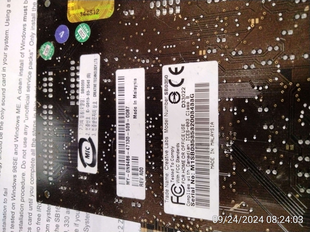

Reply 292 of 569, by stamasd
The guide doesn't work for me. Specifically the installation breaks down around step 3.5. I reboot after running the driver installation, Win98SE detects the Audigy card and installs drivers, reboots again, then after coming up once more the card does show up in hardware manager but with a yellow mark saying it has a hardware conflict. Looking at the resource tab, it's set as configuration 0, using IRQ0 (WTF} and I/O 4000-4003. It's the only configuration available, and you cannot manually change the settings.
I tried using various PCI slots and get the exact same result.
The card is a SB0350 (Audigy 2 ZS) on an Intel D815EEA2 https://theretroweb.com/motherboards/s/intel- … 15eea2-easton-2 using a P3-1000, 256MB RAM and a Radeon 9200 card. There is no other PCI hardware in the system. I have disabled in BIOS as much as I could of the integrated peripherals - except for COM1, which cannot be disabled on this motherboard. There are enough resources free, in particular IRQ5 and 7 are free.
The card of course doesn't work with these settings and I cannot continue with the further steps.

Reply 293 of 569, by Joseph_Joestar
stamasd wrote on 2024-09-24, 12:20:
Very strange, especially since there seem to be plenty of resources free.
Does that Audigy 2 ZS work correctly in some other system? Judging by those odd values, it might possibly be a hardware error of some sort. Alternatively, try installing WinXP on that PC and see if the card works under that OS using the stock driver CD.
Reply 294 of 569, by stamasd
Yeah it works fine in other systems.
It's a retail card too based on the label on the back.
(edit) I did manage to make it work eventually by shuffling it again and again in various PCI slots. It works in one of the PCI slots only (slot 4)
Installing the DOS emulation has led to the error mentioned that should occur only for SB0240 cards. I did what was mentioned to get over the error in steps 5.7-5.9 and the DOS emulation installed, but not the gameport and joystick emulation. I tried to install those manually, but only the joystick emulation installed, not the gameport. The card seems to work in Windows now, haven't tested in DOS yet. It has picked IRQ5 for the Audigy and IRQ7 for the DOS emulation. I cannot change the Audigy's IRQ manually.

Reply 295 of 569, by Joseph_Joestar
stamasd wrote on 2024-09-24, 13:21:
Actually, it might be a Dell OEM part, based on the SB0358 in the serial number (largest sticker) and the presence of three white stickers on the back.
As mentioned in the first post of this thread, those OEM cards might not work correctly with this guide.
Reply 296 of 569, by stamasd
Joseph_Joestar wrote on 2024-09-24, 13:32:
Actually I can't tell if that is SB0358 or SB0353. The 8s and the 3s are printed very weirdly on that sticker and are basically identical even with magnification
Anyway, I get sound in Windows now and hopefully in DOS too

Reply 297 of 569, by Joseph_Joestar
stamasd wrote on 2024-09-24, 13:35:
Retail cards from Creative have just a SB0350 in the serial number. OEM cards from Dell have SB0358 instead, while OEM cards from HP have SB0359.

Reply 298 of 569, by GeorgeMan
Joseph_Joestar wrote on 2024-09-24, 13:39:
To my knowledge, there are no other variations of the serial number.
Yeap, my SB350 card definitely doesn't have those stickers and it works with this guide.

Reply 299 of 569, by stamasd
Well, I thank you for the guide. Even if I only get sound in Windows only, Windows games are my main goal for that system and it is achieved.
Anyway, there _may_ be ways to convert OEM cards to retail, since I suspect in typical Creative manner, the type of card is set by its PCI ID stored in a small EEPROM on the card. Modifying the PCI ID in that EEPROM will switch the type of card. I have done that successfully for Live cards and for X-Fi cards (but not for Audigy cards so far). Needs more investigation. 😀
