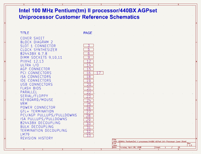

Me: Here's a kicad duplicate of the intel 440bx reference schematic!
On the up side, I'm now fairly proficient in Kicad. I was a total noob.
There will be errors.
It's a big document and it took quite a while.
If you google it, you'll find the original that was copied from.
It still needs a bunch of work on footprints, finding appropriate parts, blah blah.
I'm not sure when I'll look at it again. I'm tired.
Do what you will...
Report mistakes if you see them too!
Rasz_pl put it on github.
https://github.com/raszpl/440BX
Caveat is you must use the kicad nightly build, but my understanding is that it is improved

Ok so I've had a sleep.
Here's the rough thoughts I have.
Since it's a 99% faithful replica of the original design (I left out some pointless bits and made a couple of minor changes) it can be forked as it were.
I should note I know barely above zero about the following:
1) A lot of the parts were specific to this design. If you look at other boardviews over the bx/815 era they used different equivalent chips. Finding actually available ICs will be the first step.
(ideally find a combination that a real motherboard uses so that an existing bios will work)
2) Modern 12v pwm vrms using bog standard qfn mosfets and drivers.
2a) The CPU vrm should theoretically be able to supply 1.5ish to 3.4ish volts. That would enable pentium pro to tualatins. I think 25a would be enough but I haven't checked. Possibly using the extra 4pin atx 12v plug. Necroware's pentium vrm should work in theory with mods.
2b) vtt (signalling) of ~1.2 or 1.5v. Tualatins need ~1.2v. See specs.
2c) sdram selectable voltages 3.3v +/- a bit.
2d) agp 1.5/3.3v and maybe universal socket
2e) pci 5v/3.3v maybe
2f) -5v possibly for rare isa?
3) find actually available superio chips. Eg winbond/ite.
4) find an actually available hardware monitor chip.
5) Add possible integration. Sound? Sata? Adapter ICs like JMH330/JMH330s. M.2 sata? Hidman?
6) it looks like it's impossible to use a modern Soic8 bios, but the plcc32 should be fine.
Then... Board layout. Which I know approximately zero about.
Then finally an actual prototype.
If anyone actually makes it this far 🤣

Reply 3 of 102, by rasz_pl
Im of course loving this! 😀
We all were!
The way kicad manages libraries you need a sym-lib-table to link P2-3_era.kicad_sym to project https://docs.kicad.org/7.0/en/eeschema/eesche … _libraries.html
>The project specific symbol library table contains the list of libraries that are available specifically for the currently loaded project. If there are any project-specific symbol libraries, the table is saved in the file sym-lib-table in the project folder.
(sym_lib_table
(version 7)
(lib (name "P2-3_era")(type "KiCad")(uri "${KIPRJMOD}/P2-3_era.kicad_sym")(options "")(descr ""))
same goes for custom footprints, fp-lib-table
(fp_lib_table
(version 7)
(lib (name "P2-3_ERA")(type "KiCad")(uri "${KIPRJMOD}/P2-3_ERA.pretty")(options "")(descr ""))
Slot1 B14 B15 is EDIT: thermocouple output diode junction in reference design, but I havent seen this supported in any of Asus boards. I remember plenty of boards with discrete thermistor on a Kapton ribbon or even plugged in on a cable either under SLOT1 or inside Socket370, like here JP4 https://theretroweb.com/motherboards/s/lucky- … -6abx2v-ver-1-2 Is this like with AMD SocketA where some early CPUs didnt have thermocouple/thermistor on die? or did mobo manufacturers ignore it because thermocouple reading is difficult compared to thermistors?
myne wrote on 2024-11-23, 01:48:
need is a strong word 😀 they work fine at standard AGTL+ 1.5V on socket modded boards. AGTL is 1.25 V in theory, in practice everyone did 1.5V, even Powerleap Tualatin socket. I think it does clamp bus with SN74TVC16222a tho to be extra safe.
https://tipperlinne.com/s370-dl.htm https://tipperlinne.com/p2b-dsvtt.htm
>The absolute maximum overshoot voltage for AGTL is specified at 1.78v
only 3.3V possible on BX
Lets start with basics. How many layers on contemporary boards? Abit BH-6 I have on hand looks like 4 layer.
4 layer jlcpcb 300 × 244 mm is ~$70 + $20 shipping which got very bad recently. I can no longer get $3-5 shipping to Europe 😐 6-layer adds only ~$10 at jlcpcb at the moment.
https://cart.jlcpcb.com/quote?orderType=1&ste … encilLength=244
~$10 per board doing microATX.
PCBway is hilarious ~$190, no wonder they shower youtubers with ads 😀
Its crazy, but modern motherboards can go down to 6 layers with DDR5/PCIE4 https://www.msi.com/Motherboard/MAG-Z790-TOMAHAWK-WIFI while highest grade wank overclocker editions go up to 14.
I would not be comfortable routing this out without FEM simulations (power/singal integrity, crosstalk, EMF etc). Afaik Kicad doesnt support it yet, need Altium with expensive plugins.
Are you planning on throwing this on some project sharing site like github?
Reply 4 of 102, by myne
rasz_pl wrote on 2024-11-23, 02:29:
Are you saying I need to upload my libraries too?
Slot1 B14 B15 is thermocouple output in reference design, but I havent seen this supported in any of Asus boards. I remember plenty of boards with discrete thermistor on a Kapton ribbon or even plugged in on a cable either under SLOT1 or inside Socket370, like here JP4 https://theretroweb.com/motherboards/s/lucky- … -6abx2v-ver-1-2 Is this like with AMD SocketA where some early CPUs didnt have thermocouple/thermistor on die? or did mobo manufacturers ignore it because thermocouple reading is difficult compared to thermistors?
Is that those 2 reserved pins that go to the MAX whatever?
Fairynuff. worth noting for reference .
Anyone actually tested it? Given VTT runs at 1.5 maybe it'll be fine, or some close to spec number like 1.8 might work.
Someone might want to try it.
Hmmmmm...
More accounts.
I suppose I should...

Uploaded to https://github.com/raszpl/440BX, preliminarily fixed up cover sheet, now looks like this:

Second page done. I managed to import BLOCK DIAGRAM from PDF thru SVG conversion, still required tons of manual text input but hey, industrial grade autism helped me do it while watching some amateur racing. Page numbers are clickable and link to sheets.
