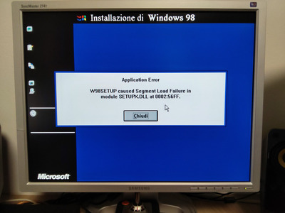

Reply 15 of 16, by biessea
Hey, someone of you could please help me?
After I updated the last bios,
I installed the AMD K6-2, put two sticks of 128mb of RAM for a total of 256mb, and beginning installation of Windows 98SE.
When I use the floppy to start the machine and FDISK the hard drive all gone right.
Then I start the computer with the cd-rom of Windows 98SE but when it enters on the GUI of installation I immediately have this error. How could I resolve it? Someone of you knows what the problem could be?

Reply 16 of 16, by biessea
Update: I put another K6-2 (this one is 500mhz and 2,2v.) and it works now perfect.
Probably a bad CPU then, or overheating problems. I don't think it's a RAM problems cause I made a full round of 45minutes of Memtest86 and no errors.
