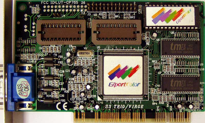

#1: ExpertColor CP775 (S3 Trio64V2/DX, 86C775), PCI, 2 MB
I don't have a nice photo at this moment but it looks just like this:
97.26 KiB
687 views
LunarG had already tested its predecessor, the Trio64V+ (86C765).

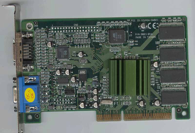

#2: Gainword CARDEXpert SG4 Pro (S3 Savage4 Pro, 86C397), PCI, 16 MB
333.06 KiB
687 views
Worked in DOS, Win31, Win98SE

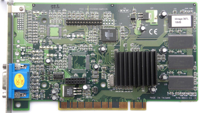

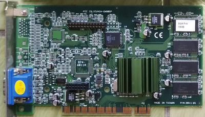

The PCB was quite different from the AGP version but almost identical to Mirage 397L.
65.05 KiB
687 views
617.92 KiB
687 views
I couldn't remember the exact reason why I bought it; all I knew was that I needed a replacement for the Number Nine 9FX Motion 771 that came with my Dell Dimension (430FX chipset), and it took me a while to find an acceptable PCI card (AGP was already mainstream in year 2000).
Speed wise, Savage4 performed poorly with late 1990 3D games. And despite of being beautiful, not many games supported S3TC. Its best merit was compatibility, which serves retro gaming nowadays really well.
