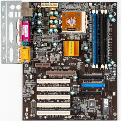

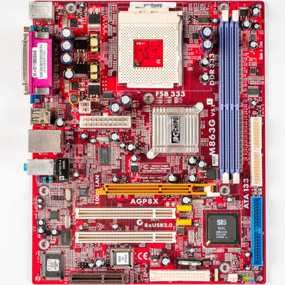

Well, I've come across some "decent" deals for a Win98SE build. Or, so I think.
Motherboard Options: (Socket 462) All free shipping and returns. All Tested / Working under Win98SE by seller.
PCChips M863G V5.1 - $49.00
MSI KM2M Combo - $54.00
ECS K7S5A(V3.1) - $62.00
Video Card: PNY Verto GeForce4 64MB DDR MX440 - $29.99 ($11.99 Shipping)
Opinions? 😀

Reply 23 of 66, by ciornyi
I would get PCChips M863G as more new chipset. However PCChips budged brand which might cause unexpected issues .

Reply 24 of 66, by chinny22
I'm not that familiar with S42 chipsets and the pros and cons so more general observations.
How many PCI slots will you need? at least one for your SoundBlaster, onboard network is probably enough but maybe run into trouble if you want a 3dfx or SATA cards as an example.
Retroweb says the ECS board is vulnerable to the cap plague, but can imagine these apples to the others as well?
https://theretroweb.com/motherboards/s/ecs-k7s5a

That ECS board is the most expensive, and does not come with a CPU. They used that same Retroweb image on their auction, but state it's board only. Though, I don't need one. Going to use the Sempron 2500+ until I find a Athlon 3000+ reasonably priced.
Kinda leaning toward the MSI KM2M. VIA chipset. The PC Chips is a nice board it seems, but yeah, not much experience with SiS in general. All of them have drives on Retroweb.

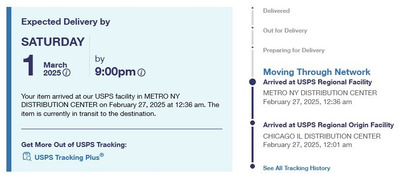

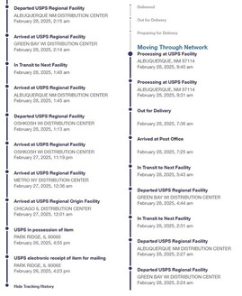

Reply 36 of 66, by StriderTR
It's all out for delivery a day early! I hope...
The MX440 seems to be stuck in a wormhole and keeps popping up all over the place, or, it's hopping between parallel universes. Or, it's just a system glitch, but what fun is that!
This is the goofiest tracking I've seen on a package in a long time. 😜

Reliability-wise, in terms of capacitors, I think I'll (surprisingly) rate the PCchips on top here. It appears to use OST RLX and RLP... which are actually pretty mediocre for reliability. But even these will likely do better long-term of over the brown KZG caps on the MSI board. Otherwise, I would have said put the MSI board on top without a doubt, as it has good Japanese caps everywhere else. It's also a VIA chipset, which can either be a really nice thing for a 98 build or not at all.
The K7S5A is regarded by many as a "classic" s462 board, but I've always hated and seen nothing but trouble from those green G-Luxon caps. Also, depending on which version you got (seems like this is a later one, as it's v3.1) you may get either a really well-behaving board or not at all. In my case, I don't remember which K7S5A I have (possibly and early 1.x), but it's an incredibly picky board - won't accept any of my DDR RAM (tried everything from low capacity PC2100 to high capacity PC3200), and forgot what other bugginess it had. So for reliability, I'd rate that one at the bottom. The only nice thing it has going for it is the universal AGP slot. The other two boards are AGP 3.0 spec, so cannot do AGP 1.0 (3.3V) cards in there.

StriderTR wrote on 2025-02-28, 19:12:
You don't say! 🤣
Something similar happened to me last year with an eBay package, except I was the seller. It was an old board for an arcade machine. It kept bouncing between two different depots in FL and lots of package "in transit to next facility" without any additional information. After a week of this crap, I messaged the buyer, apologizing for the delay and showing them the goofines I was seeing on my end. Luckily for me, the buyer wasn't that worried about it, but thanked me anyways for letting him/her know. Then in like 2 days, the package was somehow magically marked as "Delivered". I asked the buyer to verify, and the package did actually arrive - all in once piece too! 🤣
So yeah... USPS can get "tacky" at times. But at least they have the transparency to show it. Nothing like UPS, where I ordered an "express" delivery from them from Digikey, and it actually took longer than it normally would if I had the shipping with just regular USPS ground. No info on the tracking whatsoever.

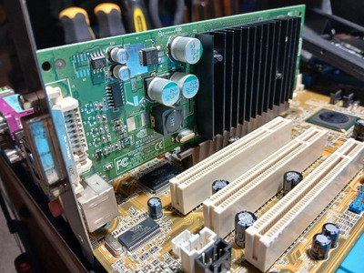

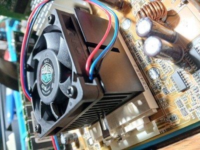

Reply 38 of 66, by StriderTR
Well, I got it all, and verified everything works! The alternate MX440 I got for $11 seems good. Won't know for sure until I can play some games.
However ... I won't be going any further until I get a new heatsink. The dinky little piece of junk I have for this socket can't handle the 2500+, let alone anything higher. Idle in BIOS at 67C with MX4 on it. Sadly, I don't seem to have any others on hand.
Currently looking at two of them, only ones with copper I can find.
https://www.amazon.com/Ajigo-MF035-032- ... 04GWO3PG/ and https://www.amazon.com/BigFoot-Networks-Subze … /dp/B00066J018/
Don't want to spend that much, but the pickings are slim for 462/A/370 when looking for copper. Mainly looking at eBay and Amazon. Wish I could find an affordable Zalman.

StriderTR wrote on 2025-03-01, 01:57:
Yeah, that's a standard and OK cooler for socket 370. But I'm not surprised it's not handling the 2500+, as that's a 60W TDP CPU (54W idle, 68W load) - almost twice as much as any P3.
I don't think it's necessary to have a copper bottom to have good temperatures. Aluminum coolers will do too, if they have thick enough base. I remember these were quite popular back in the day:
https://www.ebay.com/itm/326287609084
They weren't stellar for cooling, but could hold the late Bartons around the mid-50's Celsius under load, IIRC.
Alternatively, there's this one:
https://www.ebay.com/itm/234803482778
I'm not sure how well this one will do, but it does appear to have pretty thick aluminum base. So might yield similar performance to the previous one I linked to above.
All in all, socket 462 CPUs are pretty demanding, given their core is rather small considering the TDP.
If you're not afraid of cobbling something together DIY style (like many people did back in the day 😉 ), a thick copper heat spreader + thermal epoxy (to glue the head spreader onto the CPU) + any large Pentium 4 or full-size s775 heatsink will likely handle that CPU nicely. The tricky part is the mounting.
