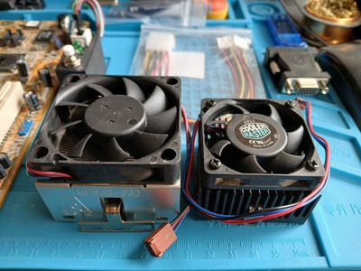

Reply 40 of 66, by StriderTR
momaka wrote on 2025-03-01, 16:48:
Yeah, that's a standard and OK cooler for socket 370. But I'm not surprised it's not handling the 2500+, as that's a 60W TDP CPU […]
Yeah, that's a standard and OK cooler for socket 370. But I'm not surprised it's not handling the 2500+, as that's a 60W TDP CPU (54W idle, 68W load) - almost twice as much as any P3.
All in all, socket 462 CPUs are pretty demanding, given their core is rather small considering the TDP.
If you're not afraid of cobbling something together DIY style (like many people did back in the day 😉 ), a thick copper heat spreader + thermal epoxy (to glue the head spreader onto the CPU) + any large Pentium 4 or full-size s775 heatsink will likely handle that CPU nicely. The tricky part is the mounting.
Heh, who would've thunk these would be in demand again and have such good resale value. 😁

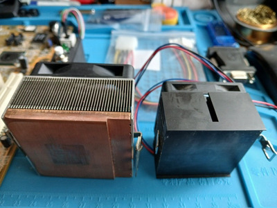

Yeah, I just completely overlooked checking to see if I actually had a good cooler on hand. That was my bad. I was hoping this dinky thing could keep it cool enough to get it all setup, but nope.

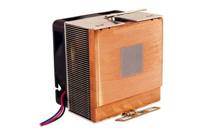

I'm actually picking up one of these: https://www.cwc-group.com/mf035032.html for $23 shipped. I don't "need" copper, it's just a preference. I've used ones similar to this and they worked well. To think, all the coolers I tossed over the years... haha
I seriously considered seeing if I could adapt something more modern, but, I just don't have time to work out the mounting. Would be cool though. 😀

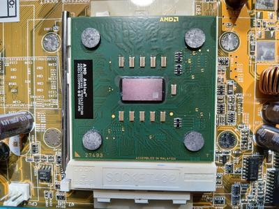

On a side note, I picked up a Athlon XP 3000+ for $15, shipped! With 30 day money back! Ran across it over on Amazon Marketplace. Most go for $35 or more over on eBay. It's the KV4E 2100MHz version, not the KV4D with the slightly faster 2167 MHz. clock, but for $15 I can't complain. It's better than the Sempron 2500+ I have now, and I get that 512K L2 vs 256K. Thankfully this MB supports 400MHz FSB since that's what the KV4E needs, the KV4D was 67MHz faster but uses a 333MHz FSB.
Either way, it's coming together. Slower than I wanted, but it is what it is.
I think I'm just going to use this case: https://www.amazon.com/dp/B0CHPRKW18?
I already own one, it houses my home "server". Nice cheap case and I can maybe dress it up with some case stickers/badges to show off it's retro contents. 😜

Reply 41 of 66, by momaka
StriderTR wrote on 2025-03-01, 20:41:

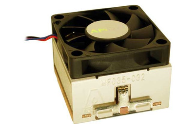

Hey that's a pretty good cooler and decently priced too (for online stuff, anyways.)
I'm most impressed by the noise figure, though - the manufacturer claims *only* 28 dB, which is pretty impressive for a socket 462 cooler. Then again, the fan is stated to run at *only* 3600 RPM, so it makes sense.
Considering most coolers used 5k RPM fans and made around 40-50 dB of noise... man, how did we stand those noisy things back in the day?! 🤣

My Athlon XP 3000+ KV4E model order was cancelled buy the seller. No reason, just cancelled and refunded. Probably realized they were underselling it for $15.
So, I said to heck with it and picked a KV4D model over on eBay for $36 shipped, also 30 day returns. The KV4D is the model I wanted anyway, an extra 67MHz isn't much, but since both models sell for about the same, why not get it. It will likely not arrive before my next day off, Thursday, but I still have the 2500+ here and can at least use that to setup the system. Hopefully.

Well, my "new" heatsink arrived. Yeah, I think it's going to be much better suited to these processors. It's amazing what having the correct parts can do for you. 😜
The small guy will go into my bin and wait for something more suitable, should that day ever come.

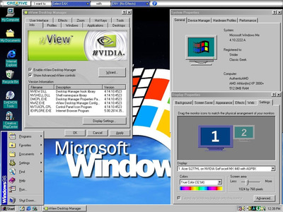

Also, does 98SE always identify as ME? I never remember seeing this.

It's because of NUSB 3.6.
Don't use that version, stick with 3.3 instead.

To get usb work as 2.0 might need to change values in bios. I had issue with usb 2.0 on asus i865g motherboard there was high speed and full speed option in bios . I chose full speed and it was 12 mbps or usb 1.1 .

I ended up reinstalling W98 several times chasing down issues. Switched to 3.3. Thanks for that!

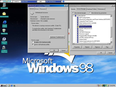

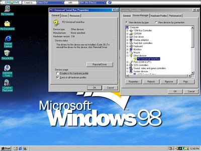

So, as mentioned above, did several re-installs. Kept running into stability issues. In the end, think it was the PSU I was using. 12V rail was at 11.2'ish, needs a recap, it's an old FSP supply I had on hand. Dug out a modern Corsair 450, that seemed to stop most of my stability issues. Had some of the same issues as this guy...
Motherboard Resources conflict in Device Manager (Windows 98 SE)
MB resources is still like that, but everything else is working. So, I don't think I'm going to worry about it.
Also, unofficial service packs, nope... kills the system every time. So, not going to use those. One of my re-installs was just to fix the issues it caused. Don't need it.

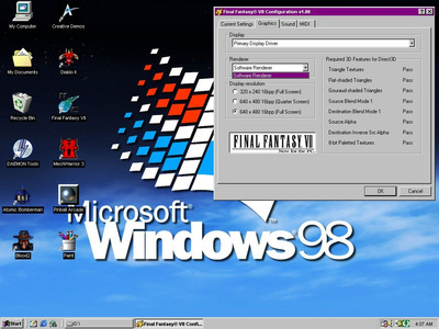

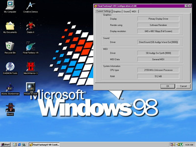

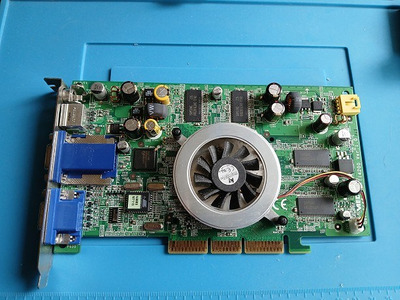

Just got around to testing FF7.... seems it's stuck on software rendering for some reason....
Pretty sure D3D Rendering should be working on this MX440. Using 45.23 drivers, perhaps not the correct one?

You need to install the official patch 1.02.

Well....I completely forgot about that.... I was working on that system until 4AM'ish and once I got to FF7, I felt like I was forgetting something. I haven't played FF7 outside of 7th Heaven for a very long time.
Thanks for pointing out my bad memory and why I shouldn't be working on anything at 4AM. 😜

Just got my hands on a free MSI GeForce4 Ti 4200 128MB card, thinking of using this in place of the MX440. Would be a nice boost in performance.
