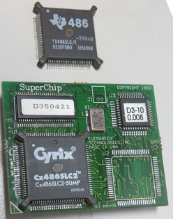

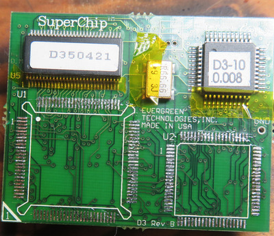

Does anyone have one of these 1993 updated Evergreen 486 SuperChips? The previous 286-to-486 Evergreen SuperChip I worked on was an earlier version from 1992. It came with DIP switches, shown here:
download/file.php?id=129731&mode=view
download/file.php?id=125621&mode=view
In that other thread, I also added a Cyrix Cx87SLC-33QP and the FPU worked just fine.
As with my 1992 edition, on the 1993 edition, I also swapped the TX486SLC-33 in favour of the Cx486SLC2-50MP. Unfortunately, the FPU is not functioning on the 1993 version. Landmark Speed test shows 0. For the photos below, I had already removed the 87SLC-33, so that I may solder on another chip:
463.9 KiB
334 views
543.83 KiB
334 views
566.94 KiB
334 views

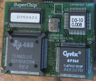

The DIP switches on the previous 1992 version did not control the FPU in any way, so I figured the same would be true of the 1993 model. Does anyone see anything in the photos which may control/enable the FPU?
Some observations:
1) R22, R32, and R31 are not populated. Could they enable FPU? Do I need to remove other resistors as well? There's also resistors under the PLCC connector. However, on the 1992 version, there weren't any unpopulated resistor pads.
2) J1 on the PCB is not populated. Presumable it connects to a jumper? Or for debugging?
3) I traced out the J1 pins. The left-most pin traces to 87SLC pin 23, or BUSY#. The right-most pin traces to 87SLC pin 20, or ERROR#. Anyone have the 87SLC datasheet?
4) R22 pads: one pad goes to 87SLC pin 20 (ERROR#), the other pad goes to Cx486SLC pin 36 (ERROR#)
5) R32 pads: one pad goes to GND, the other pad goes to the QFP chip with the D3-10 0.008 sticker (bottom pin, 3rd over from the right edge)
6) R31 pads: one pad goes to Vcc, the other pad goes to the QFP chip with the D3-10 0.008 sticker (bottom pin, 3rd over from the right edge)
7) There are SMD components under the PLCC socket. Maybe there are some FPU enable pad under it.
Any ideas? Thanks!

I soldered on a second Cx87SLC-33QP, but the results were the same. The FPU does not register in Landmark Speedtest v6. v6 shows N/A for the FPU result, while v2 shows <3.45, which is probably the CPU's FPU emulation speed. The Landmark v2 FPU score should be around 40. Refer to this previous post: Re: Evergreen 486 SuperChip - settings for DIP switch?
I am guessing that I need to play around with the missing SMD resistors, but why would the 1993 version require changing the config resistors, whereas the older 1992 version did not? According to the SMD markings, the resistor values tend to be from 33 ohms, 2K, and 20K.
Should I try shorting J1?
Does anybody have one of these upgrades with a factory FPU installed? Does the FPU work? If yes, could you provided a photo of the underside? Thanks a lot.

I figured out the probable pins for the 87SLC by looking at how an 87DLC QFP is wired on a PGA interposer and looking at the FasMath 83D87 datasheet.
I took a shot in the dark to solder 10K resistors to R22, R31, and R32. I tried all combinations except for the case in which R31 and R32 both have resistors. That was 5 iterations, but it did not result in the FPU working.
I don't know what else to test for. The situation I did not test for was running the Tx486SLC along with the 87SLC. All FPU testing was done with the Cx486SLC2-50MP installed. The SLC2 is stuck on 2x mode, whereas the Tx486SLC runs in 1x mode. I don't see why this would matter. The 1992 Evergreen interposer had a working FPU with the Tx486SLC and the Cx486SLC2 installed.
Is it possible that two 87SLC chips were bad? Yes, but not likely. I do have a 3rd NOS 87SLC, but I give it a 0.1% chance of being the issue.
I'm considering removing the Cx486SLC2 and trying a SXLC2-50 part. I was unable to get the L1 working on the 1992 Evergreen interposer with the SXLC2 installed.
Crazy ideas to get the FPU working are being accepted.
EDIT1: I forgot to point out that even with the Cyrix 87SLC removed and a DIP40 287 FPU installed w/Evergreen 1993 SuperChip, the system will hang when it tries to run floating point operations. If I have a 286 CPU and 287 FPU installed, the FPU works fine. When using the 1992 version of the Evergreen SuperChip, I was able to use external 287 FPUs when 87SLC was not installed. Something fishy with the 1993 Evergreen.
EDIT2: I probed J1, and R31/R32 with the system booting.
J1: 87SLC pin 23 (BUSY#)
this pin stays at 5 V pre-POST, post-POST, and post DOS bootup
J1: 87SLC pin 20 (ERROR#)
this pin is 0V before POST, then 5V after POST, then 0V when loading some DOS drivers, then 5V once all DOS drivers are loaded
R31 and R32 share a connection which goes to D3-10 0.008 (probably a PAL). This pin stays 0V at all times.

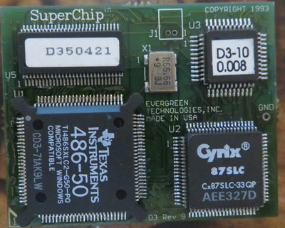

Soldered on an SXLC2, but as with the 1992 version, enabling L1 hung the system:
667.78 KiB
176 views
Next, I soldering on a Tx486SLC, which is the same model as the original chip, but a different chip:
654.27 KiB
176 views
The Tx486SLC is in 1x mode only (Cx486SLC2 is always 2x), but the FPU still didn't function. I'm at a loss here. This upgrade adaptor is not of any interest to me if I cannot use the 87SLC FPU. As such, I will not be soldering the Cx486SLC2 back on.
I'm going to set this aside now. Looking forward to some suggestions within the next few years...

I see the 287 socket so we should not have to worry about motherboard not having x87 support in BIOS, but do you also have to set FPU present board jumper?
Looks like the kind of board that a harris CPU gets to stretch it's legs on, but is the upgrade counting on it being a slow and nasty board, i.e. does it work if you stick a low speed crystal in it and turn on a bunch of wait states?
I dunno just crossing "i"s and dotting "t"s here I guess.
This is the motherboard I'm using for testing:
https://theretroweb.com/motherboards/s/leadma … ectron-lm-103fs
https://www.petershipkov.com/temp/retro_pc_im … _ht12p-16_a.jpg
There is only one jumper on the motherboard and I don't know what it does. With the jumper in either position, it does not help the FPU situation. I tried the Evergreen 1993 module in another board and the FPU still doesn't work. I tried the 1992 Evergreen module in both computers, and FPU works fine. Thus, the issue is with the 1993 Evergreen module itself.
There are no options to set wait states. In terms of slowing it down, I have tried a 20 MHz crystal oscillator, which is 10 MHz FSB. ALU works, but not FPU. I tried a 12 MHz crystal oscillator, but no lights. I tried a 33 MHz crystal oscillator, but the system will hang up with the Evergreen is installed. This is a bit strange since the module is designed to work with a 16.0 MHz FSB. The fastest crystal oscillator I can use with the Evergreen upgade installed is 30 MHz, for a FSB of 15 MHz. On the other hand, I can use a 50 MHz crystal oscillator with a Harris-25 installed.
The limit on the crystal oscillator speed is due to the combination of the Evergreen upgrade and this particular motherboard. On another motherboard, I can run with 16.67 MHz FSB.

Jp1 on the motherboard controls sync/async fpu.
Either the 1993 of the module is damaged in some way, something you mentioned in DM that you cannot test easily because you dont have other 286 mobos readily available for that, or there is some specific incompatibility between exactly this mobo and exactly this cpu module.

I would guess that the jumper position 2-4 would be ASYN, but pin 4 isn't soldered on, and neither is the ASYNC crystal oscillator. This leaves pin position 1-2 and 2-3. I don't know what these two positions do. Having the pin in either position (without ASYNC crystal), doesn't affect the FPU results when a 287 FPU is installed with a Harris 286.
The issue is likely not an incompatibility between just this Headland MB and the Evergreen 1993. I say this because I tested the Evergreen 1993 module in a VLSI MB and the FPU also doesn't work there. When using the Evergreen 1992 module, the FPU works in, both, the Headland MB and the VLSI MB. These are my only 286 motherboards. The VLSI is in a case.
It is possible that some logic on the PALs are bad, if they are in fact PALs. I don't want to remove the stickers to find out. I feel that the most likely issue is related to some mis-configuration of the onboard resistors. There are a lot of 0603 resistors on this module, more than the 1992 version. There's also a bunch more resistors under the PLCC socket. Maybe someone with a working 1993 module will share an image of the bottom of their module.
