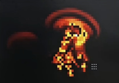

I ended up getting a bit carried away the other day while running some performance tests on that Alaris Cougar system I wrote about in the previous page.
Couple of custom tests targeted at specific CPU/FPU/VGA workloads escalated on the spot into a 2D fluid solver thing.
I thought I'd share as it is a bit comical - CFDs are one of the worst possible applications for vintage computers - intense floating point calculations, memory hungry algorithms, and in-memory data sets that grow rapidly - basically everything these old machines struggle with most.
I find this impractical aspect so amusing. Anyhow.
Navier-Stokes 2D fluid solver based on Jos Stam's "Stable Fluids" paper.
Linear solve, velocity and density grids only with handling of boundary conditions.
Mouse-controlled emitter - inject density into the grid at location.
Turbo-C 3.x compatible. No dependencies. Single C script with ~400 lines (can be ~300 if compacted).
16-bit (real) DOS mode.
Double buffered rendering in VGA 13h mode.
Command line arguments for setting various parameters (explained in the included source).
Average framerate is reported upon exit.
A run captured on video. Sped it up 4 times as the poor PC is on its knees and everything takes a while despite the very humble 40x25 (first solve) and 80×50 (second solve) grid resolution.
Archive includes source code and compiled executable.

Reply 2368 of 2482, by feipoa
Maybe you could also run the code on a system like an Am5x86-180 to offer more perspective. From slowest 486 to fastest 486, here's how much you gain...
Reply 2369 of 2482, by pshipkov
Good idea.
Here:
486DX5 200MHz
Pentium 3 Tualatin-S @1575MHz
The P3 machine is a dual CPUs rig. The second CPU can make a big impact on performance as the code is very multithreading friendly. Simple omp parallel for would fit right in but this kind of stuff is a different toolchain entirely.
retro bits and bytes | DOS media library
Reply 2370 of 2482, by feipoa
It is hard to visualise as the BL3 is sped up 4x and, I think, the Am5x86 is not sped up? So it just boils down to the numbers, assuming both are at the same resolution, then:
BL3-100/2x : 1.36 fps
Am5x86-200 : 5.76 fps
dual Tualatin 1.6 GHz: 70 fps
What do that '2' and '3' signify in the command line when running this simulation?
Reply 2371 of 2482, by pshipkov
Yes, you gathered the results correctly.
The first argument sets the grid resolution.
0 is 10x10=100 voxels.
1 (default, if no argument) is 40x25=1,000
2 is 80x50=4,000
3 is 160x100=16,000
The 200mhz 486 cpu is 4.235 times faster than the 100mhz bl3 one, or on a clock to clock basis 486 is 2 times more efficient than 386/387.
The 1575mhz p3 is 51.4 times faster than the 100mhz bl3, or in other words p3 is 1.5 times more efficient than 386/387.
I guess with simd and 2 threads the dual p3 system will outperform both 386 and 486 by large extent. Current code is dos/386 centric and does not take advantage of newer tech.
