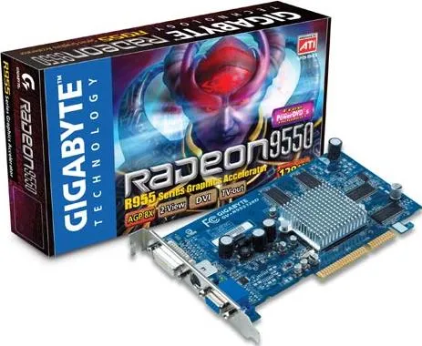

after my motherboard was toasted, I got a new motherboard (p4s800d-x) and 2 new gpus that I could find
one of them is mx 440 64 bit 64 mb
other one is radeon 9550 256mb ( I'm not sure about the bit)
I don't have any friends or a good community to help me with retro rigs in my country, I often try to get recommendations from the chatgpt. I don't trust that sonuvabich but sometimes it can bring me some good info.
So when I asked which gpu to choose, it recommended me the mx 440. I got suspicious but it kept on recommending that. So, what is your take on this? And which directx version do you recommend? Should I stick to dx7 or switch to 8.1?
The games I want to play :
diablo 2, fallout 2, heroes of might and magic 3, fallout tactics, descent 3, half life, quake 3, the sims, icewind dale 2, blood 2 chosen, delta force 2, outcast, nox, arcanum, the settlers 4, turok 2, heretic 2, thief 2
Thanks in advance!

I think Thief II would probably look better on the MX 440, but the 64-bit version is not really desirable. But since you have it, you may as well test it to see if it performs well enough for you. Its a directx 7 card, so I think no point installing directx 8.1 with it.
I haven't used Radeon 9550 so can't really comment on performance, but I know Radeons are less compatible than Geforce when it comes to older Win9x games.
Reply 2 of 19, by leonardo
You list at least one game that uses the paletted fog feature (Thief 2), which will for that reason look better on the MX440. The MX440 despite being only DX7 compatible in hardware would have shipped with drivers that were already built and tested against DX8 at least, so no reason to hold back there.
For any games built with DX9 in mind, the Radeon would be better - and it should be waay faster than the MX. Hard to say for sure with all the nonsense going on at the time (128- vs 64-bit bus, SE vs non-SE, etc.)...

The MX460 is guaranteed 128 bit, and sometimes comes up for a reasonable price. I got mine for £25 not long ago.

Yeah, the 9550 is faster than any Geforce MX given it's 128bit. The 128bit MX440 is also a solid choice for Windows 98. However the 64bit version is awful. The best use case for it if it's bottlenecked by the CPU so much that the anemic bandwidth doesn't matter. Ir in cases like Fallout 2 which is a 2D game locked to something like 11fps.
PS: I have decent memories with the MX200, which is also 64 bit and generally considered crap. It's still an upgrade compared to any 90s graphics card maybe aside of the highest of high end. Cards like this imho have their place, but for a main retro rig, you'll need something with more muscle.
I'd look for a Geforce3 Ti200 or Geforce4 Ti4200. But a 128bit MX440 is a good placeholder until you find one within your budget.

I have p4 2.6ghz northwood but the thing is; it is very hard to find a solid gpu in my country. There is a listing for a 128bit mx440 in one of the second hand apps but the seller doesn't respond to my questions so I'm waiting for him to answer.
My concerns with the 9550 is the compatibility issues. Does it run well with win98se and the games I mentioned? I have p4s800d-x motherboard and I had issues with the sound card (creative sound blaster 0060 when I try to install drivers it froze the system every while installing sb16 emulation drivers) so I'm scared of formatting the computer again. I put the sound card into a different pci slot and installed only the bare minimum drivers for the sound card. But every minute I'm more convinced that I should switch to 9550. It is a sapphire 256mb 9550.
I'm not looking for an overkill. Some of the animations are acting weird like super fast animations. Maybe it is because of the cpu. Should I look for a lower capacity cpu?

It's a good card for Win9x gaming.
If you're specifically worried about games which use table fog such as Thief 2, you can always dual boot Win9x and WinXP, and install Catalyst 7.11 drivers on the latter. Those drivers provide perfect table fog emulation, so you can play any problematic games under WinXP.

Radeon 9550 is always DDR. Never saw SDRAM versions. 256Mb version is most likely 128-bit, so drastically better than 440MX 64-bit.

not any 9550, the crappy 256mb models come with slower ram
a model very popular here in Argentina was the GV-R955128D
800
guaranteed 9600pro overclock and sometimes came very close of the 9600XT

Here is my card-- https://theretroweb.com/expansioncards/s/powercolor-r96-lc3
HWInfo v7.03 reports SDRAM, but the chips are Infineon hyb250256163ce-5 , so I'd say you are right, the chips are DDR.
If your CPU is => 700 Mhz and you like playing direct X 9 games, then a 128 bit Radeon 9550 is drastically better than a 440MX 64-bit.
If you already own a 440MX 64-bit card and your CPU is < 700 Mhz or you only want to play games from the quake 2 or direct X 7 families, then spending $40 for a Radeon 9550 might not make as much sense
(Curiously, looks like the card has options for low cost 64 and 32 bit memory builds, but this one is 128bit.)
