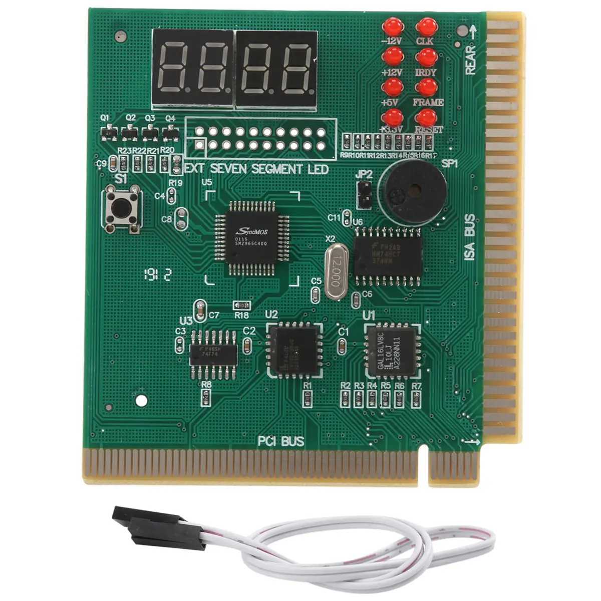

POST cards are great to have in general, but I don't think in this situation they are going to detect anything. i.e. the problems happen after it's gone past the basics. POST is over when you see the "POST" screen, any recoverable errors it reports (key stuck, CMOS check) and any non-recoverable is where it sticks and the POST card gives you a clue.
Edit: Okay reread, you have some occasions of not making it to the POST screen? Sorry, I may have confused your "not booting" statements with seeing POST screen and then doing nothing. or having the storage interface problems. So yeah if you are looking at a blank screen, maybe a blinking cursor, then the POST card should say something.
When it doesn't BOOT, it doesn't POST.

The BIOS's updates at least done, but the machine is still having issues with the POST. (So I've at least eliminated the possibility of there being a corrupted BIOS)
The next move I'm going to have to make is to wait for my PCI/ISA Diagnostic card as well as some DeoxIT to arrive, so that I can clean all of the contacts as well as the CPU sockets and then check to see where it's hanging up during the POST.
