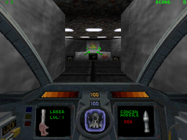

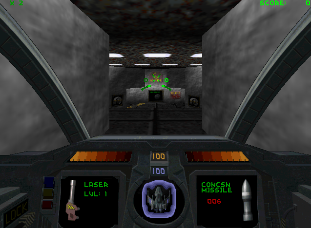

Reply 13 of 17, by vetz
Thanks again for feedback. Everything have been fixed in the new build, but I'm currently hunting down a crash bug in 640x400 mode and I'm still working to optimize frame drops in Glide, but I hope to release during the weekend.
Analysing the code it's quite obvious why there is no cockpit in the Glide renderer of Descent 2 (and probably why the Windows version never bothered). There is just not enough texture memory for the cockpit and the world and not run into the problems I currently have. There are so many individual sprite variances (especially explosions) that there isn't enough memory to cache them all on the card. When the cache miss and evict then happens it causes very noticeable frame drops on the Voodoo Graphics which has only 2MB texture memory . It's alot better on Voodoo2 and Voodo3+. Current plan is to downscale the 256x256 sprites to 128x128 for the Voodoo 1 and keep them original for Voodoo2+
Mac cockpit assets now in the DOS build. See A/B (Glide renderer).
DOS upscaled (from 320x200)
