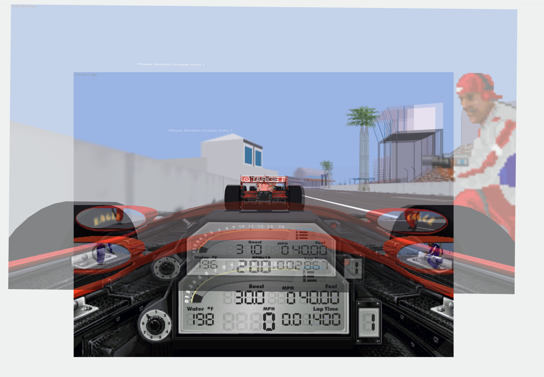

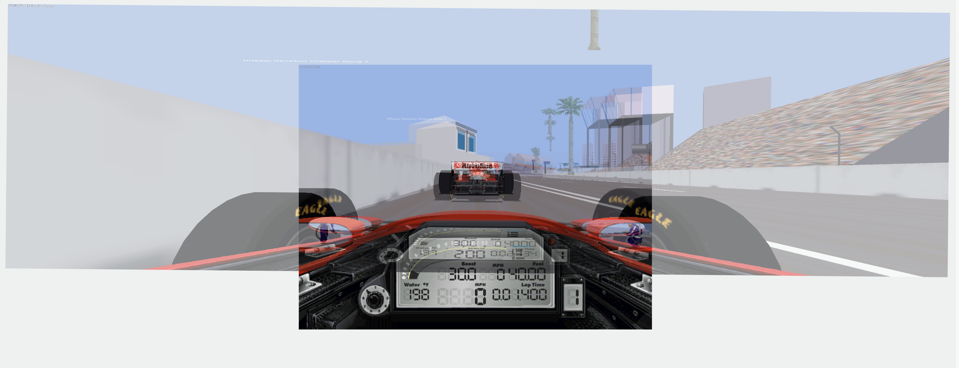

Reply 3454 of 3457, by sharangad
ICR2 widescreen again (32:9). This time the aspect ratio is totally correct. There're problems with the sprites and I need to fix that:
https://youtu.be/4MZZO4lctnI
Also available on my Patreon:
https://www.patreon.com/Rready/posts/indycar- … ntent=join_link
A comparison of the 4:3 standard image and 32:9 is available here:
Developer of RReady - Rendition Verité Wrapper.
