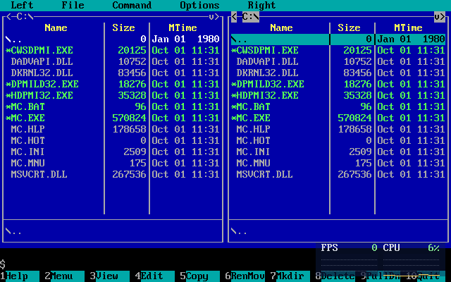

Dividebysandwich wrote on Today, 09:35:
I am on a different PC atm and downloaded the DLLs from somewhere else and here it also doesn't run. So you really HAVE to use the DLLs from dosbox-x or it won't work!
Then just run "HDPMI32.EXE", and then run "DPMILD32.EXE MC.EXE"
For the record I got MC running, both the versions, albeit the mc_95_nt-4.1.36 requires additionally msvcrt.dll (used one from NT4, but I guess the one from Win9x works as well)
I used the HX libraries I had which were OK, I just tried to use HXLDR32.EXE, which worked elsewhere, instead of DPMILD32.EXE, and HDPMI32.EXE isn't actually needed (frankly the whole matter is a bit of a mess)
The attachment mc.PNG is no longer available
I have no functional mouse anyway, not sure if I have to install ctmouse or similar driver, I'll experiment later on this detail.

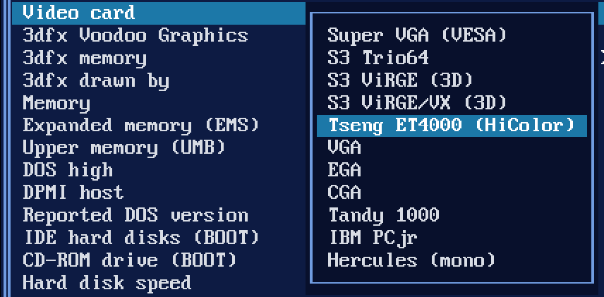

TsengLabs ET4000 support
`machine=svga_et4000` is now a real Tseng ET4000AX with 1 MB and a Sierra HiColor DAC

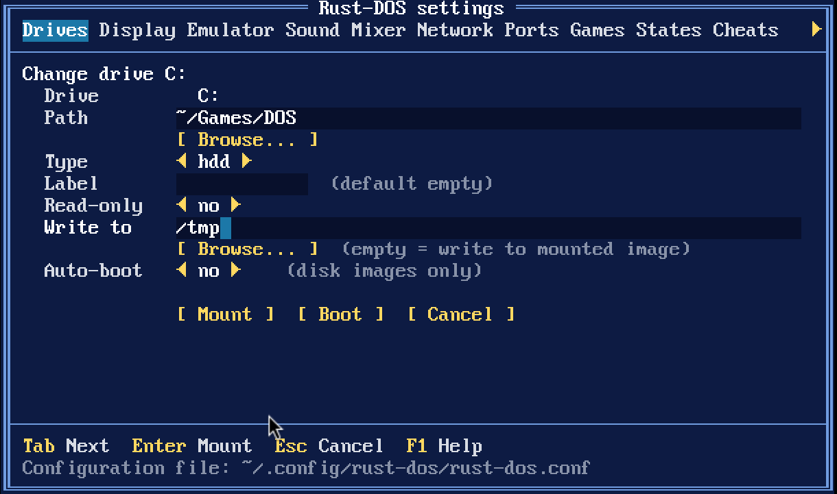

Write overlay
* Any folder drive can take `-overlay DIR`, and DOSBox's `MOUNT C DIR -t overlay` works too. Imported DOSBox profiles keep their overlay folder.
* Files are copied into the overlay folder when first written. Deleted files are listed in `.rust-dos-deleted` inside it.
* Booted Windows 3.x/95 shared disks write their changes into the overlay as well.
* New and imported profiles get `overlay=true`, so changes go to `saves/<profile>/<drive letter>` next to the games folder. Existing profiles are unchanged until you add `overlay=true`.
* **R** on the Games page asks first, then deletes that folder, taking the game back to its install state.
ZIP/7z as drives
* ZIP, 7z and DOSBox Pure `.dosz` archives mount as drives. Stored zip files are read in place; compressed files are decompressed in memory on first open.
* An archive whose files are all in one folder uses that folder as the drive's root.
* An archive holding just a disk or CD image mounts the image.
* A `.dosz` stacks over the parent archive it names.
* Without an overlay an archive drive is read-only; game profiles always give their archives one.
* Dropping or loading an archive now creates a profile that plays it in place, instead of unpacking it. Games unpacked before keep their folders.
* The RetroAchievements hashing and the drives now share one zip reader. Hashing now reads through the libretro VFS too, so it also works for Android `saf://` content.

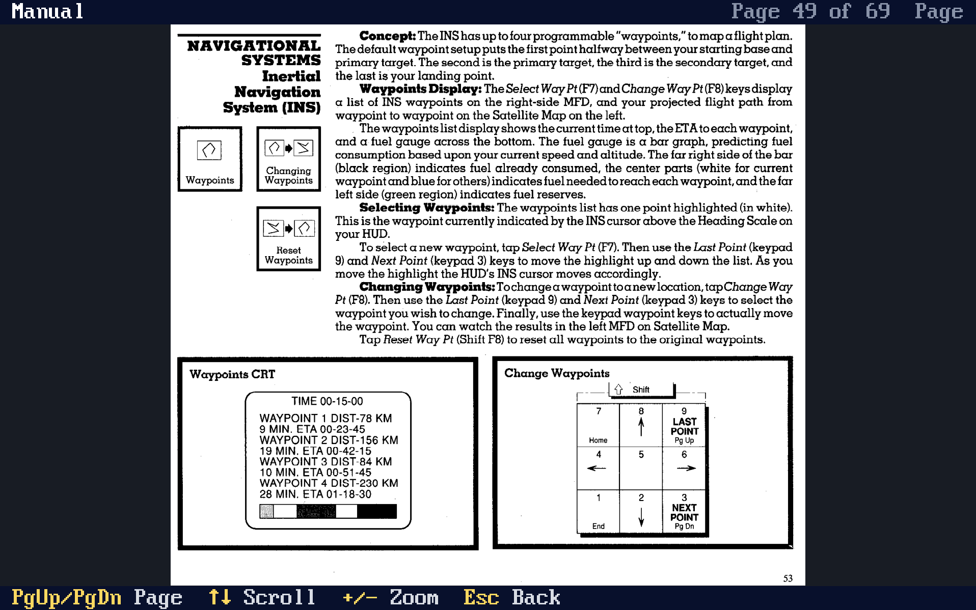

Manuals and extras viewer
* With a game's profile defined, it is possible to set `[game] manual=path|Title` to specify the manual. Any files in `games/<profile>.extras`, are also used as manual, for example PDFs or PNG/JPEG/GIF pictures.
* **Ctrl+Shift+M** opens the running game's manuals; **M** on the Games page opens any game's. The game pauses while one is open.
* Keys: PgUp/PgDn turn pages, the arrows scroll, `+`/`-` zoom (whole page, width, 150%, 200%), Esc goes back. **Ins** in the list adds a file to the profile.
* The position in the manual is remembered during play so you can get back to the same page immediately.
* On desktop the page is drawn at the window's own resolution, so small print stays readable. In the libretro core it is drawn into the game's picture, with the same aspect correction.
* The browser build has no manuals: it has no host files to read them from.
* GAME-PACKAGES.md contains instructions on how to include manuals with your game.
