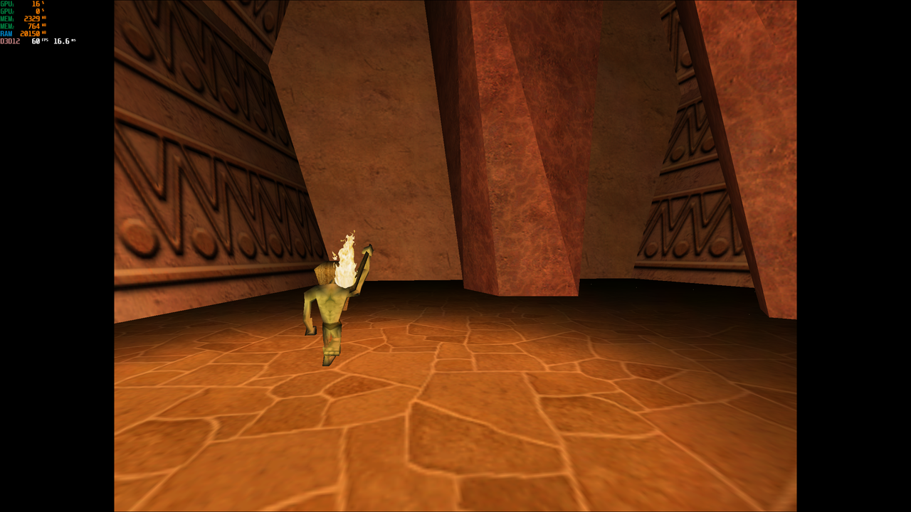

From what I've seen, Fullscreen + Fake for some reason loses VRR (G-sync), while Windowed will work, tho I'm forcing G-sync on Windowed apps, for testing I disabled it on Windowed apps and yeah it's gone too with Windowed + Fullscreen Size + Borderless, still doesn't explain why Fake wouldn't work with VRR if I'm forcing G-sync on Windowed apps. [see posts below for this issue, related to PresentMode]
There is Fullscreen with "Fake" and without "Fake", times "Centered, keep aspect ratio" and "Stretched, keep aspect ratio", times "Unforced" and "Max" and "1920x1080, 240" number of combinations.
Unless there is a golden combination to make DX/VGA version actually use increased resolution, whilst Glide seems to always uses higher resolution (which was common with glide) if you go above "Unforced", it boils down to these 4 scenarios:
DX/VGA will look like this with "Max" and below is with "1920x1080, 240", and always one of the "keep aspect ratio" non-CRT option:

3Dfx/Glide will look like this with "Max" and below is with "1920x1080, 240", and always one of the "keep aspect ratio" non-CRT option:
The attachment 3DfxGlide Max, 240 keep aspect ratio.png is no longer available
The attachment 3DfxGlide 1920x1080, 240 keep aspect ratio.png is no longer available
0. I just noticed that restarting first level doesn't always land you in the same exact spot for some reason, even at 60fps limit 😀
1. DX/VGA is obviously 800x600 by the look of the jaggies (look at the yellow crystal), 3Dfx/Glide is much less aliased.
2. As you can see, "Max" in my case is some unknown (probably 4:3) resolution which is I presume unrelated to me using "Centered/Stretched keep aspect ratio" - how can I know the render resolution?
2a. When "1920x1080, 240" the render resolution is probably that same "Max" (4:3) resolution, but it's stretched, which I can't make sense of, why isn't it rendering at 16:9 due to "1920x1080, 240" OR enforcing a 4:3 resolution with "Centered, keep aspect ratio"?
2b. You could maybe make a case that it's not stretched, but that FoV isn't adjusted, but yeah, 3D stuff looks stretched, and 2D stuff like menus definitely are stretched to 16:9, so I dunno if it's just FoV issue...
3. I noticed that "resolution, refreshrate" is NOT saving them at all anywhere - I even launched the dgVoodoo Control Panel with admin rights - which probably means why I can not force Glide version above 60Hz since it doesn't apply/save it, and note that I'm talking 60Hz refresh rate, if you disable Vsync with Glide and have no FPS limit the game will render mad fast, but the screen will be locked to 60Hz, and I mean 60hz mode, not "VRR is going down to 60Hz".
3a. Glide's (at stock settings) forced 60Hz is also unexpected behavior, because DX version doesn't change the monitor's refresh rate, yet Glide version will, why?
3b. "Enumerate refresh rates" actually works as expected, tho it reports 239 as max refresh rate - I did try 1920x1080, 120 in my testing related to 3 and 3a and it didn't work, so it's not just a "you put in an impossible refresh rate".
4. I tried "Max, 22" and "1920x1080, 38" and results are inconsistent - since I'm using G-sync, DX/VGA version seem to be LFC'd to 60 and 120Hz (which makes little sense since 22*3 or 22*4 isn't exact 60 nor 120hz, and I know this panel can handle 22fps LFC to 66Hz for example, yet here screen OSD shows 60/120hz changing, but maybe it's flipping so rapidly between these two and it doesn't show instantaneous VRR Hz changes and/or the VRR logic is a bit "less flexible" to wild FPS changes), Glide version OTOH switches the panel to 60hz and it doesn't change, probably due to fact that Glide version actually switches the screen into 60hz mode because of 3 and 3a problem.
