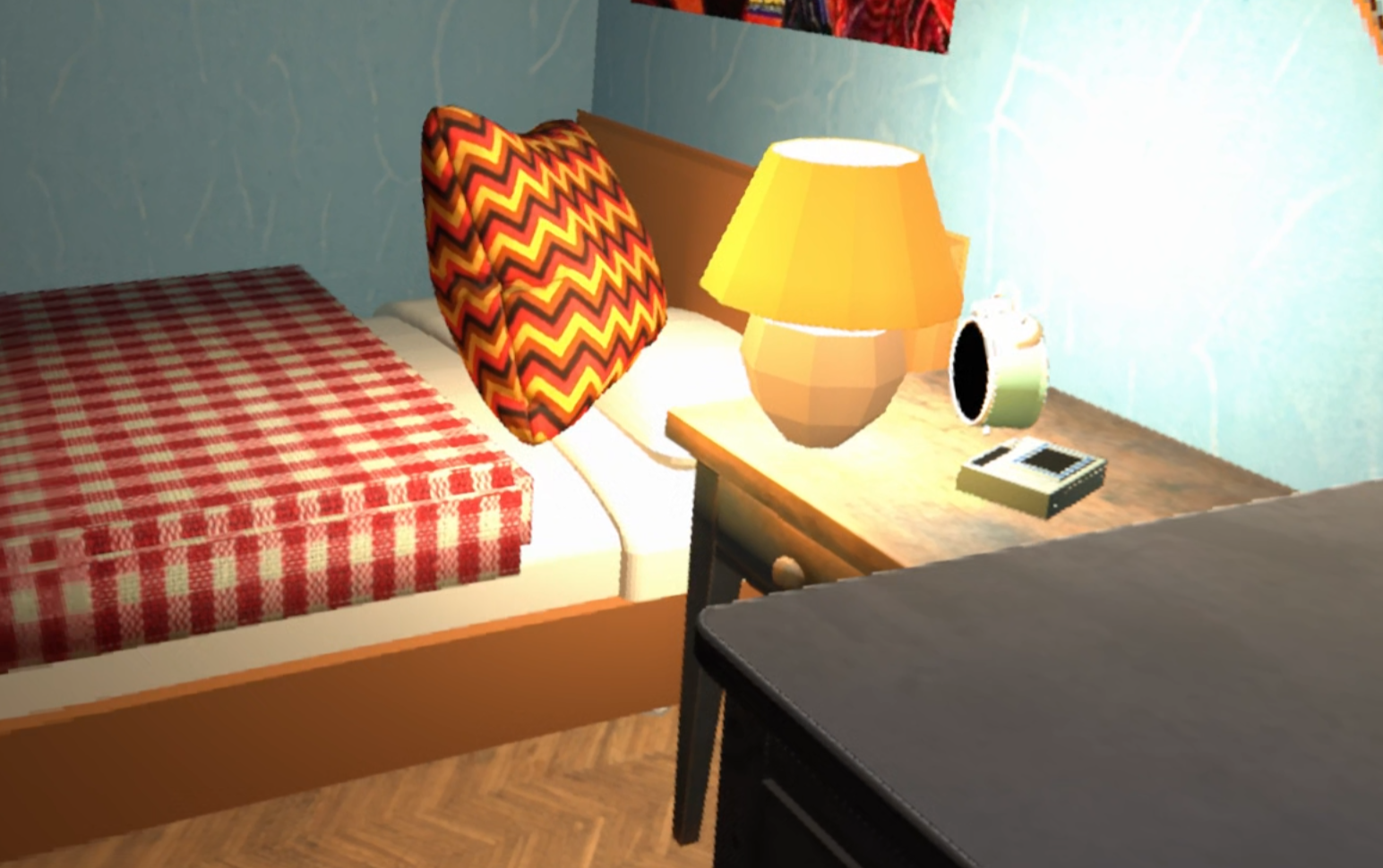

Game manual and virtual joystick on the VR desk
The 3D scene now has things on the desk to pick up with a VR controller's grip button:
* The manual of the game that runs (from its profile's manuals and extras) lies on the desk as a booklet. Pick it up and turn its pages with the thumbstick of the hand holding it; with several manuals, **A/X** picks the next. Put it down and it settles on what is below it.
* A joystick: hold it by its stick and the stick follows your hand as the game port's joystick, with the trigger and A/X as its buttons. Hold it by its base to move it somewhere else on the desk.
Scenes of your own place the manual with an empty named `manual`, or bring their own booklet model with `manual_page_left` and `manual_page_right` pages (see `docs/vr.md`). A scene without one gets the manual anyway.

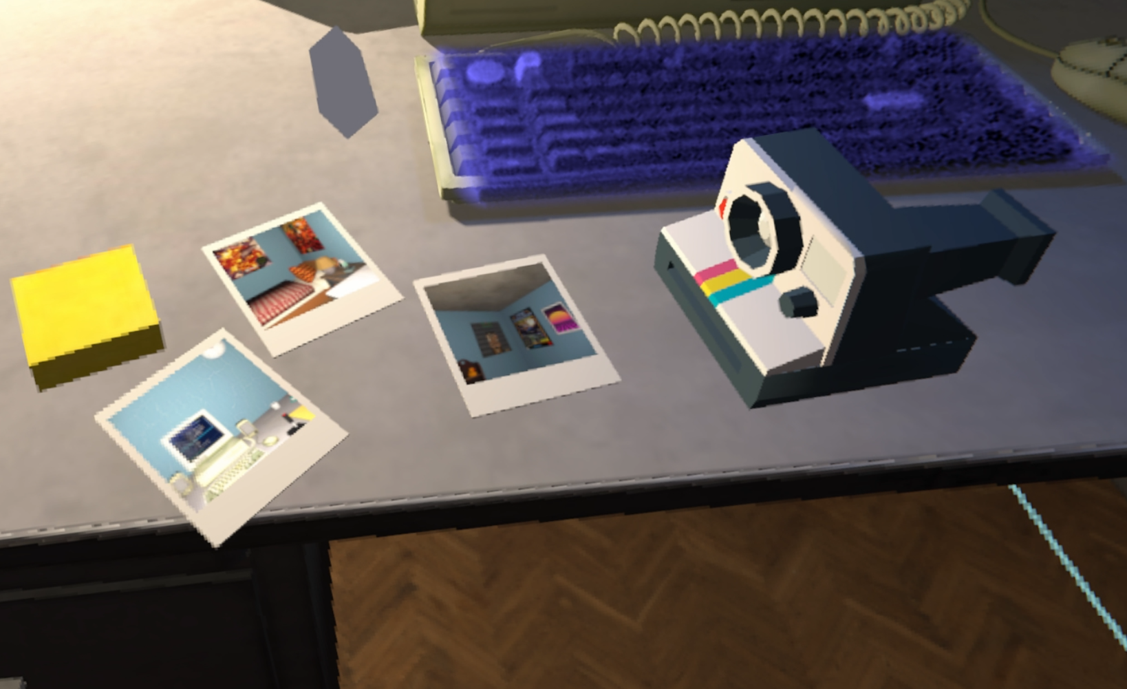

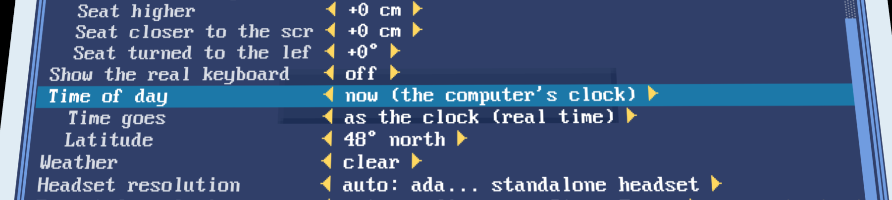

Physical keyboard visible in VR
The new `keyboard` setting in `[vr]` shows your real keyboard, and your hands on it, through the scene with the headset's cameras, in a soft-edged window on the desk:
* `auto` puts it below the screen, then learns where it is from where your fingers press keys while the hands are tracked.
* `marked` puts it where you marked it with a controller, from the settings window's VR page
To manually mark the keyboard position, first select the bottom left corner of your keyboard, then pull a line to the bottom right corner.
Then just drag the square upwards to encompass the entire keyboard.
This feature requires passthrough support. This includes the Steam Frame running Rust-DOS itself, Varjo XR headsets, or a Quest through Link. Note that this hasn't been tested on every headset yet, so reports are welcome.
One more small improvement: The controller's tip can now pick up the manual and the joystick too, not only its grip.
