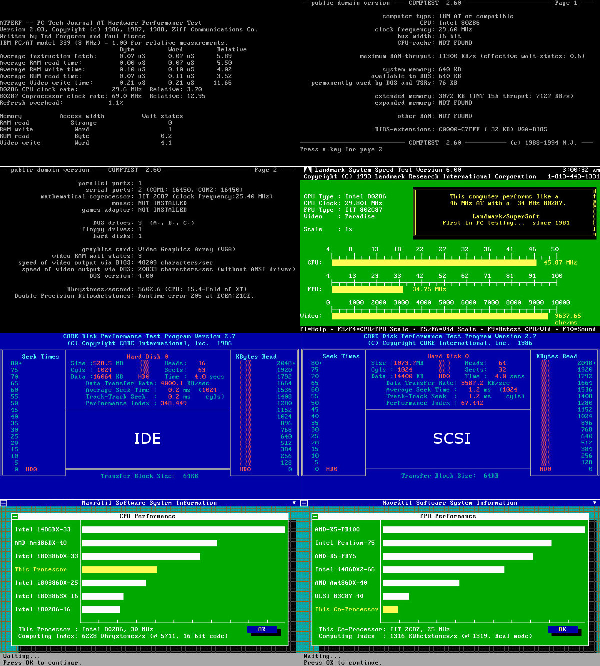

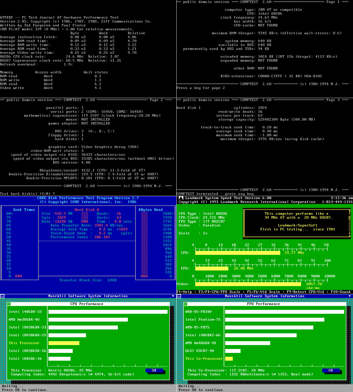

Ilon USA M216A rev 1.2
CPU: Intersil CS80C286-25
FPU: IIT 2C87-12
RAM: 4Mb 60ns parity FPM
VGA: Tseng Labs ET4000AX 1Mb
IDE: Chips F82C712
SCSI: Adaptec AHA-1520A
The motherboard is actually not that bad - handles IDE and FPU really well, but hates video cards - slows them down to a crawl.
Coretest for SCSI freaks-out when the CPU runs at 25MHz, but in general IDE is much faster than SCSI for 20 or higher MHz 286 machines.
--- 25MHz
Wolf3D: 12.5 fps
Superscape: 6.9 fps
F1 Grand Prix: 151% (CPU utilization, lower is better)
F1 Grand Prix 2: 475% (CPU utilization, lower is better)
Autodesk Chaos, 2D Mandelbrot set: 4296 seconds (lower is better)
--- 30MHz
Wolf3D: crash
Superscape: 10.7 fps
F1 Grand Prix: 97% (CPU utilization, lower is better)
F1 Grand Prix 2: 308% (CPU utilization, lower is better)
Autodesk Chaos, 2D Mandelbrot set: crash
All in all - really slow motherboard.

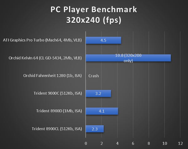

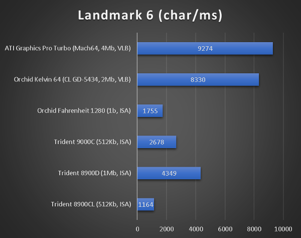

I decided to test my ISA / VLB kit. This is all on a 486 DX2/66 motherboard with VLB, using Landmark 6.0 (char/ms), PC Player Benchmark (fps), and 3DBench2 (fps). I bring you, the ISA Trident trio, ISA and VLB Orchids, and ATI Mach64 VLB:
Trident 8900CL (512K) - LM: 1164 chr/ms; PCP: 2.3fps; 3DB2: 16.4fps
Trident 8900D (1M) - LM: 4349 chr/ms; PCP: 4.1fps; 3DB2: 32.8fps
Trident 9000C (512K) - LM: 2678 chr/ms; PCP: 3.2fps; 3DB2: 26.4fps
Orchid Fahrenheit 1280 (1M) - LM: 1755 chr/ms; PCP: wouldn't run; 3DB2: 16.3fps
Orchid Kelvin 64 VLB (Cirrus GD-5434, 2MB I believe) - LM: 8330 chr/ms; PCP: only runs in 320x200 (10.8fps); 3DB2: 44.7fps
Tseng ET4000/w32i VLB (2M) - forfeit on account of not working anymore, apparently. suck.
ATI Graphics Pro Turbo VLB (Mach64, 4MB) - LM: 9274 chr/ms; PCP: 4.5fps; 3DB2: 45.7fps
Most surprising to me is, again, how fast that 8900D really is. What a sleeper. Who knew? The PCPlayer benchmark is clearly CPU limited, but you do get to see where the cards hold back performance a little. VLB is faster (around 2x in this case), but not 4x despite the 8MHz to 33MHz bus clock speed jump. Interesting.
I'm rather happy with these results, as it turns out the builds I wanted for nostalgic reasons turned out to be the best performers. Nice!

Put your numbers in charts for better readability. Thanks for making the effort. It will be awesome if we see some doom stuff as well.
Btw, what is the mobo you tested on ? Brand, model, chipset, etc.
I will try to test all the isa, vlb and pci cards on my asus pvi-486sp3 mobo and merge your results as well.

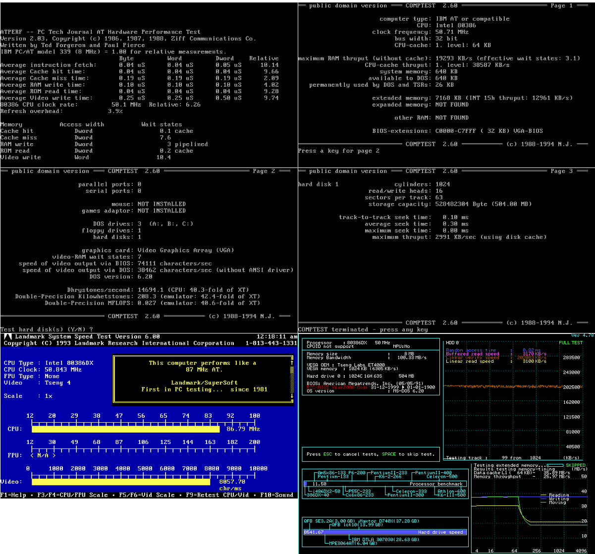

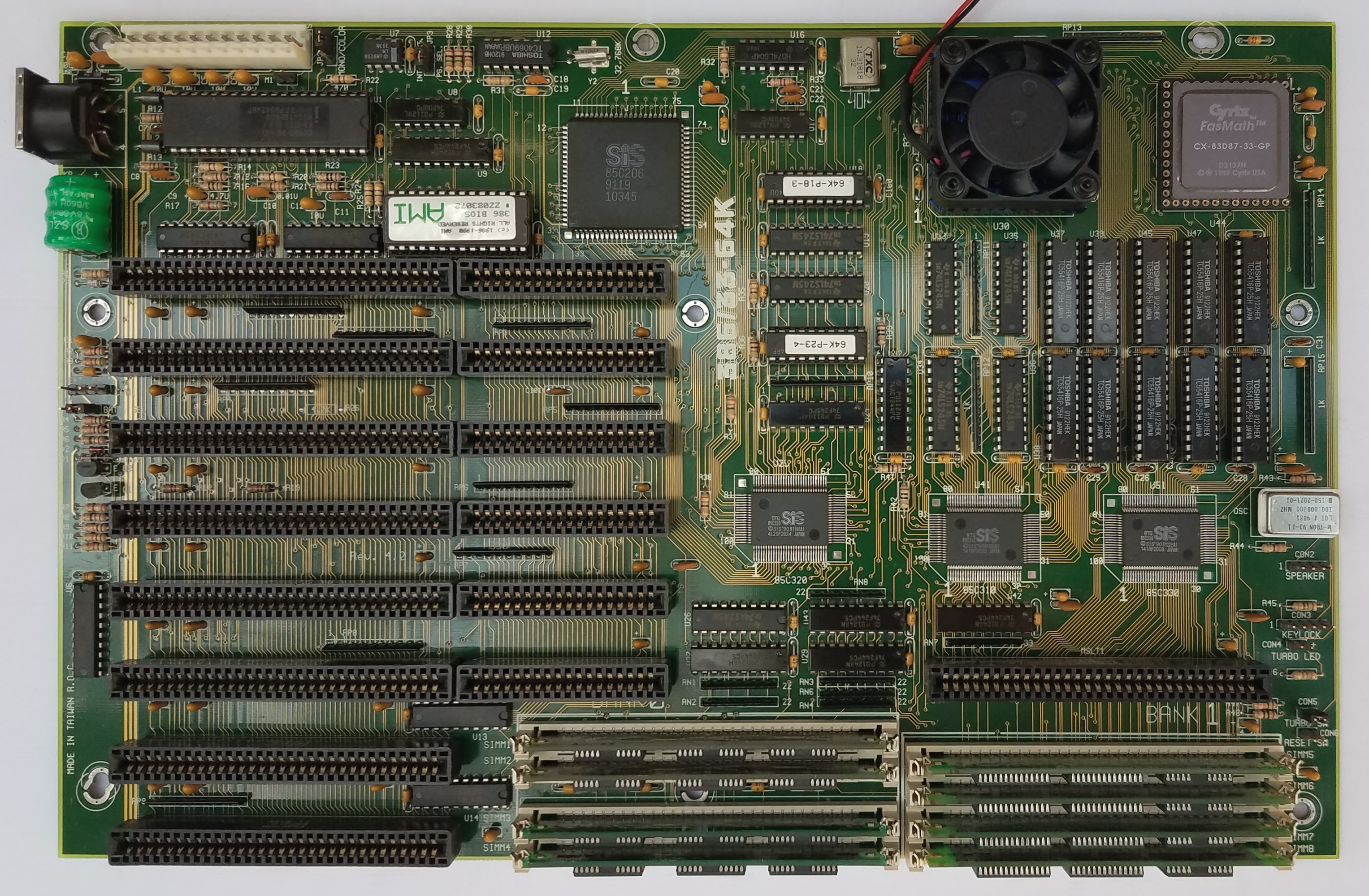

ASUS 386/33-64k based on SiS 85C310/320/330 "Rabbit"
The hardcoded 64Kb of DIP22 SRAM, max 8Mb of RAM and barebone BIOS (no timings, etc.) hint at an early stage 386 hardware, offering somewhat subpar performance.
UPDATE: After stumbling upon some random information online, i just realized that this motherboard is a later model of what Asus started their business with back in 1989 - the one they developed "blindly" without having access to an Intel's 386 CPU prototype. Or, at least that's what the legend says.
I was annoyed by the lack of options in the BIOS, so tried bunch of other ones that are rich on cache/ram timings.
Results were not great - performance was same or worse, compared to the default BIOS.
Okay, fine. Lets see if it overclocks then.
I didn't expect much, given the already low entry point, but for my surprise this boy turned out to be unexpectedly capable in that department.
It works completelly reliably in DOS and Windows 3.1 at 50MHz. Well, with one exception - it failed all 3D rendering tests. None of the 3DCC apps can get to UI, let alone render something - a big red-flag in my books.
There was a bit of complication with finding the right video card for the 50MHz FSB. After combing through bunch of them, it was an ET4000AX from 1998 that did the job. The rest were unstable, or didn't light up at all.
I started with 60ns RAM, but noticed that 70ns is fine too.
Ok, what about 55MHz ?
The motherboard takes it with ease (along with the CPU and VGA), but the IDE controller gives up.
Tried bunch of other IDE/SCSI adapters - they all hang during their turn at the end of POST.
Too bad ...
Screen does not light-up at 60MHz.
https://www.petershipkov.com/temp/retro_pc_im … motherboard.jpg
https://www.petershipkov.com/temp/retro_pc_im … _2_et4000ax.jpg
For some reason i was not able to capture screenshots of NSSI.
benchmark results
The motherboard running at 50MHz overcomes its inherent slowness and positions itself near the top.
8MB RAM limit won't be a problem for games and casual computing, but is a factor.
Failures with offline graphics tests hint at stability issues.

I came late and saw a topic. I liked it very much 😀
can you take a photo of your memory? brand and how many nanoseconds? which is located on 286-VLSI
you also disabled "parity error check" ? turn it on - failed?
