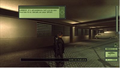

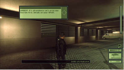

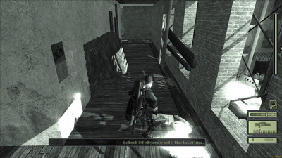

For SC 1 (640x 480 no MSAA or reslution forcing) we have(game bugs): 1.Shiny texture bug Bug https://i.imgur.com/c1G3fAZ.png Nor […]
1.Shiny texture bug
Bug
Normal
2.Shadows and light appear/disappear based on mouse movement or distance.
3.Missing shadows compared to the XBOX version.
Advices:
1.Play game without resoultion forcing or MSAA to avoid artifacts.(ex: water oil rafinery, begining of CIA level, etc )
2.To force resolution use games config.
3.Use 4800 preset for classic light(2.54)
Use DgVoodoo-5700 Ultra for soft light
Notes:
1.Game is dependent on the monitor refresh rate. 30 fps is the original. Going higher will cause some elements to 'move' too fast(light beams)

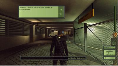

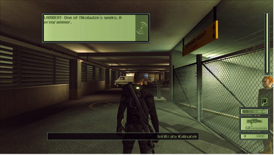

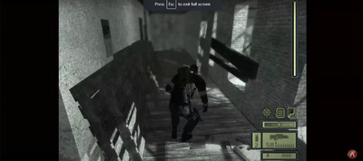

For SC 2 we have:
1.Color of the light is wrong.
2. Crosshair in the middle of the screen, flashing. (Fix: alt tab out the game and go back in, or user bordeless gaming app, remove cursor option)
3.There should be a light coming out of the door but is not, as per Hishamerrish . This is definitely an wrapper issue:
Here how it should look:
To play the game with all the effects: use 2.54 version with a resolution which doesnt pixelate the bloom,480p-1080p resolution with full 8x MSAA.(might generate other issues)
--to be updated

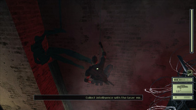

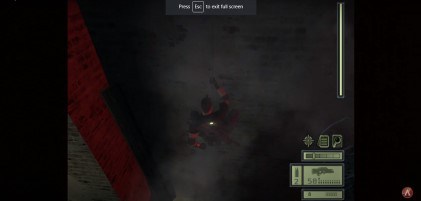

Game Bugs:
1.Heat haze is resolution dependent.
Here's how it looks on 640x480(distorted image of the wood in the background). On higher res the effect will be less/small visible. The higher the res the less/small intense the effect will be. The heat haze on higher res will be at the bottom where the fire can barely be visible.
2.Missing bloom and flickering of the corona of lights..(windows,exterior button lights of elevator/lift, candles in the first level, etc)
Because of the high resolution some effects are small. Use 480p or a litlle higher with MSAA to have them all visible and rendered ok.
Forcing the game witth DgVooDoo latest(2.7x) ,to a higher resolution 'fixes'(wrapper might ignore something and game thinks is still renders the heat haze in 480p) the heat haze but breaks the bloom(it becomes pixelated and shifted to the right a bit).
For 2.54 seems it is better:(fixes the flickering because of the higher res, no matter the the version)
--to be updated

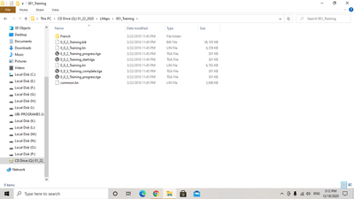

i have downloaded the xbox original iso the texture file is not there ...there is a folder name Lmaps and the files are not utx they are TGA and lin ... maybe if you grab the right file and replace it that will fix the problem
i am sorry .. i am good at finding issue but can not solve any
thank you guys

Reply 155 of 234, by hishamerrish
For me the original some how is better the HD texture not that good
some shadows are missing
    200.21 KiB
    1849 views
    ORIGINAL
    186.89 KiB
    1849 views
    HD
Reply 157 of 234, by daniel_u
hishamerrish wrote on 2020-12-24, 03:34:
Oh man, you are right. HD textures is messing up the shadows. 🙁
I wonder what is the difference.
I will need to redo the CIA file and defence_ministry reflection removal.
EDIT:
This also shows the difference between PC and xbox . The picture you posted is from xbox because on PC there are less shadows from the fence on PC.(guess performance reasons)
@hishamerrish Did you replaced ETexRenderer for SC1 with the one from SCPT?

and here whene i use the ETexSFX from the SCPT on SC1 ... THE RAIN RENDERING OUT THE WINDOS .. but corrupt the water in other places
    164.67 KiB
    1805 views
    ETexSFX from SCPT
    165.52 KiB
    1805 views
    ETexSFX DEFAULT
Reply 159 of 234, by hishamerrish
Here are some clear differences between PC and Xbox in rendering shadowPC ... the pc render shadow that the xbox do not ...in the other side the xbox has more environment object
