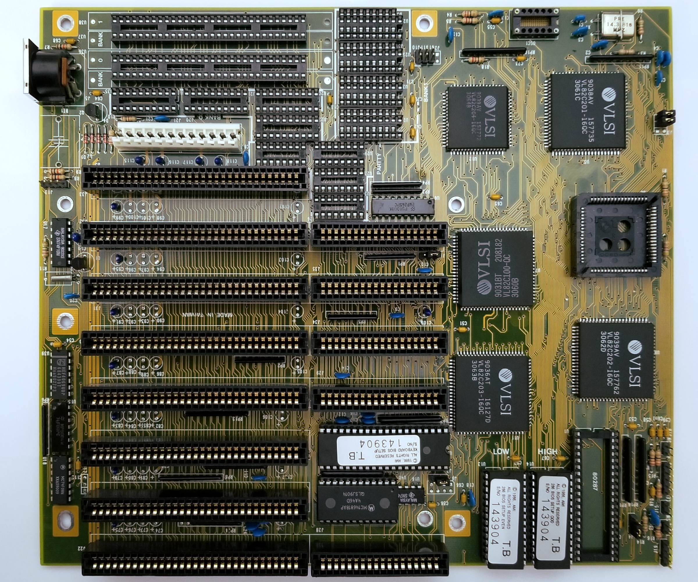

Reply 223 of 2521, by pshipkov
Stumbled upon another 286 motherboard from Amptron based on the very fast VLSI 20#-16 chipset.
New old stock. Crisp in the antistatic bag.
Soldered crystal oscillator socket. Inserted SIMM slots in the SIPPs for testing.
Works as expected. Gets to 25MHz easily. Didn't check if it can do more.
Basically - similar characteristics as the other ones showcased in previous posts.
Came with 4x1Mb 80ns SIPP RAM modules that don't work reliably beyond 16-20MHz.
There was a 16MHz rated Siemens 286 CPU in the socket. While it worked well at 16MHz, the heat dissipation was extreme. Haven't seen this kind of stuff before.
25MHz Harris or Intersil ones running at 25MHz or higher get warm, but nothing like this.
Here is the guy:
Kind of nothing new to see at this point, except ...

Reply 228 of 2521, by maxtherabbit
pshipkov wrote on 2021-04-24, 22:14:
Stumbled upon another 286 motherboard based on the very fast VLSI 20#-16 chipset. New old stock. Crisp in the antistatic bag. So […]
Here is the guy:
... the box it was in:
The name on the box gives partial answer to the question "Who made these motherboards back in late 1980, early 1990 ?".
Amptron International Inc. was one of the manufacturers.
Very nice. I assume 25MHz was with 1-wait? Or did you find some SIPs that are fast enough to handle 0-wait?
Reply 229 of 2521, by pshipkov
I insert SIMM slots into the SIPP ones. They fit well and contraption is pretty solid.
Then roll with trusted simmsticks = 0 waits.
retro bits and bytes | DOS media library

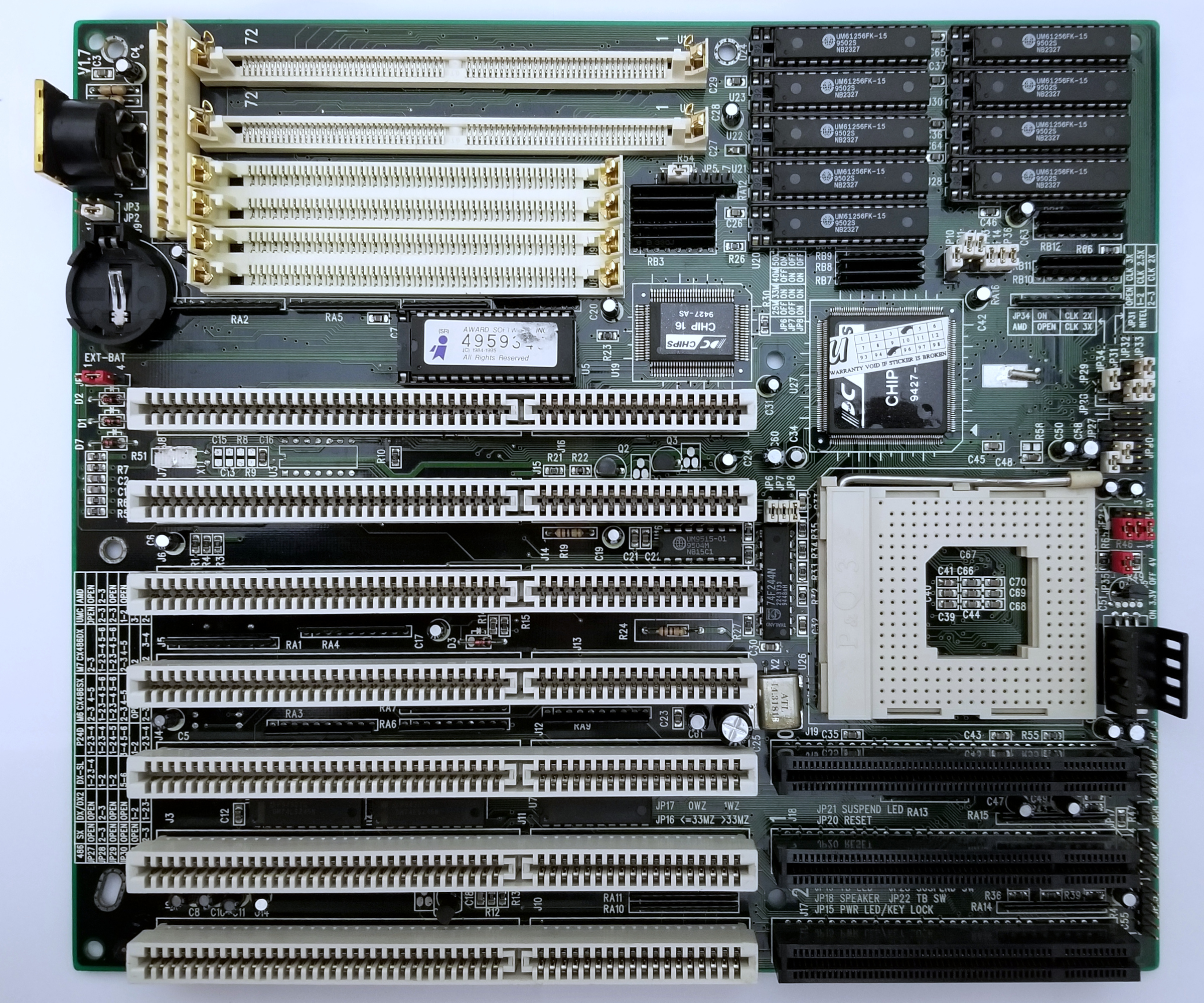

Reply 231 of 2521, by pshipkov
It is a nice trick that many use.

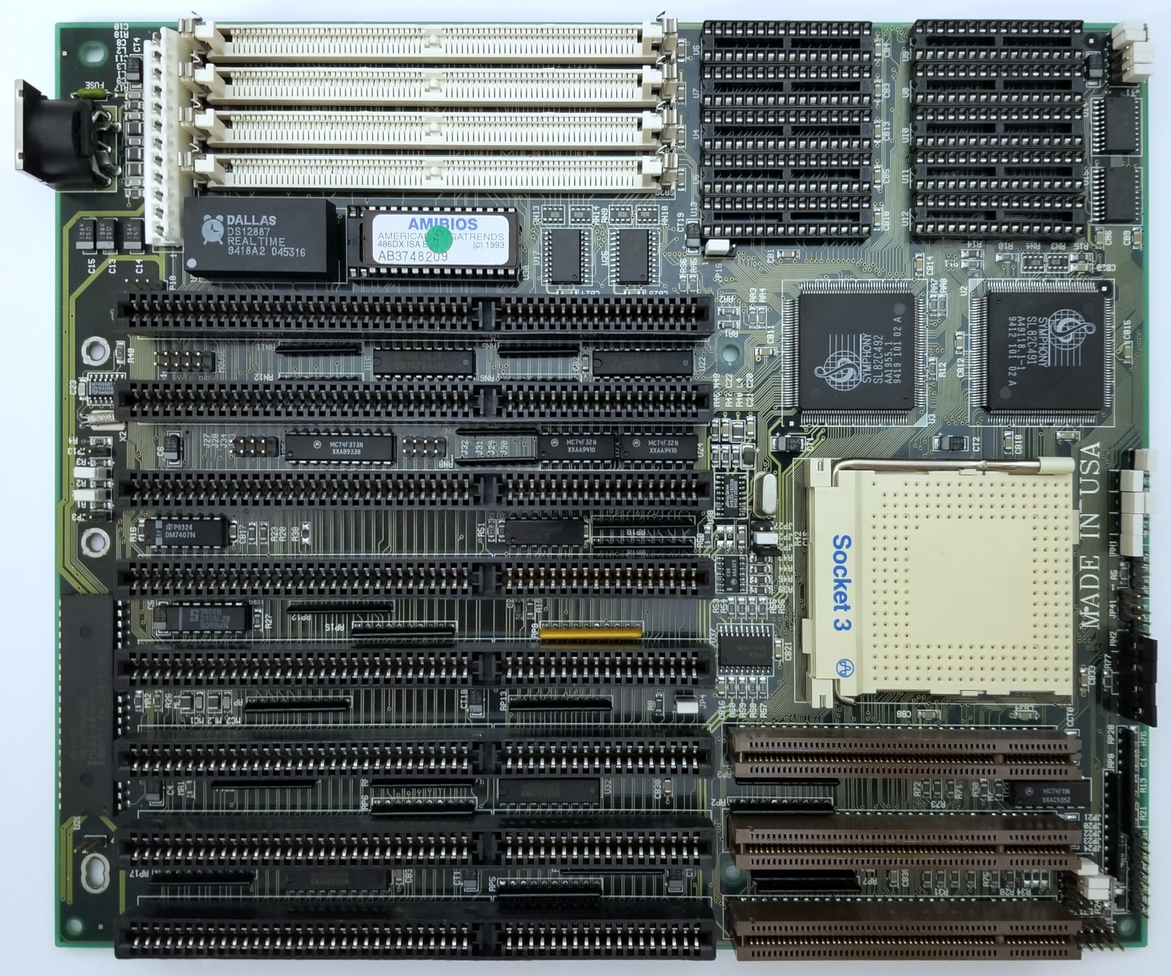

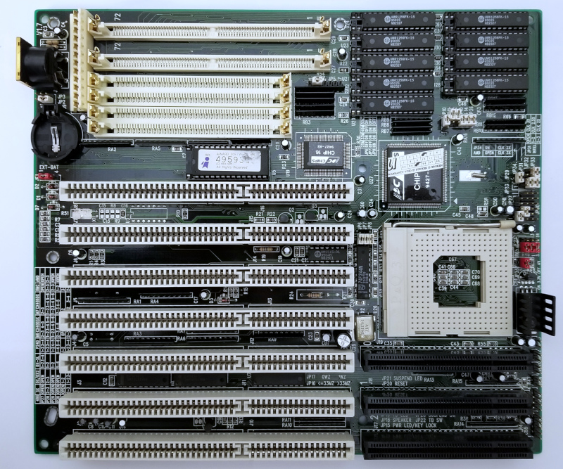

Last weekend i went through bunch of AMD 486 DX5 CPUs as part of a slowly evolving operation aiming to clean house from hw i dont need.
PC-Chips M912 v1.7 motherboard happened to be on top of the retro hardware pile and was already configured for DX5 processors from previous tests where it behaved itself pretty well, so it was used as a test bed.
First CPU in. Run a mandatory DOOM test ... and the recorded path of the player was so incorrect that seconds after start the action was in a completely different area of the level.
Problems like that are usually attributed to tight bios timings and/or flaky L2 cache and/or flaky RAM.
This was unexpected because never had problems with this motherboard and the usual set of components i use for testing.
Spent good amount of time swapping different sets of trusted sram/ram but no luck for the day.
Next day.
Same board, same components. Plugged one of the DX5 CPUs - everything works. Hmm ...
Can this be a CPU related issue ?
Quickly went through the processors one by one and indeed - an AM486 FX5-133WBGC model (notice the W letter) didn't behave properly.
Tried it on another motherboard - all was good.
This piqued my interest.
Searched online for related info.
apparently m912 is a well known board. Several vogons threads touch on jumper settings and models with fake L2 cache.
No perf data available. No word about CPU specific issues.
Decided to examine it more thoroughly.
It is a new old stock - squeaky clean, no wear.
Despite the ugly Pc-Chips stickers hiding an UMC chipset, i like it a lot.
Late ISA/VLB model.
Supports wide range of CPUs.
72 and 30 pin SIMM slots, maximum of 128mb RAM.
Up to 1024Kb L2 cache.
Great PCB layout. All sorts of info is printed on it, but the DX5 CPU settings are wrong incorrect.
As far as i remember the original BIOS was from year 1994, stored in 256Kb EEPROM from Philips.
Replaced by 1995X code burned on 512Kb chip.

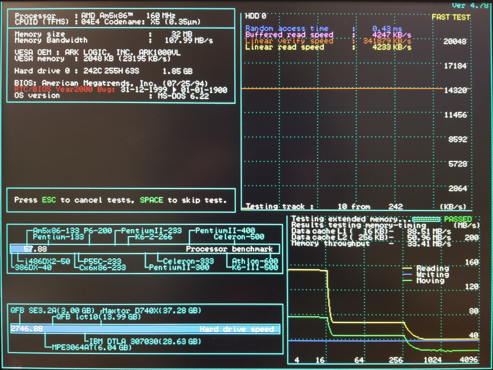

Base metrics in SpeedSys, using an ISA IDE controller.
With VLB EIDE disk i/o is in the range of 10Mb/s.
Perf testing started on a high note - all jumpers and BIOS settings on max for best performance.
Results from interactive DOS graphics benchmarks were not bad with the Ark1000VL video adapter.
Not the best out there, but pretty ok indeed.
Next up - stability/performance in complex computations and Windows.
That didn't go well.
Had to significantly increase wait states for the 3D rendering tests to complete.
Performance dropped to a point where i just lost interest in further testing.
So sharing the DOS graphics results only.
benchmark results
No issues with any of the other AMD DX5 CPU models - ADZ, ADW, VBGC.
Certainly liked the board more before examining it.

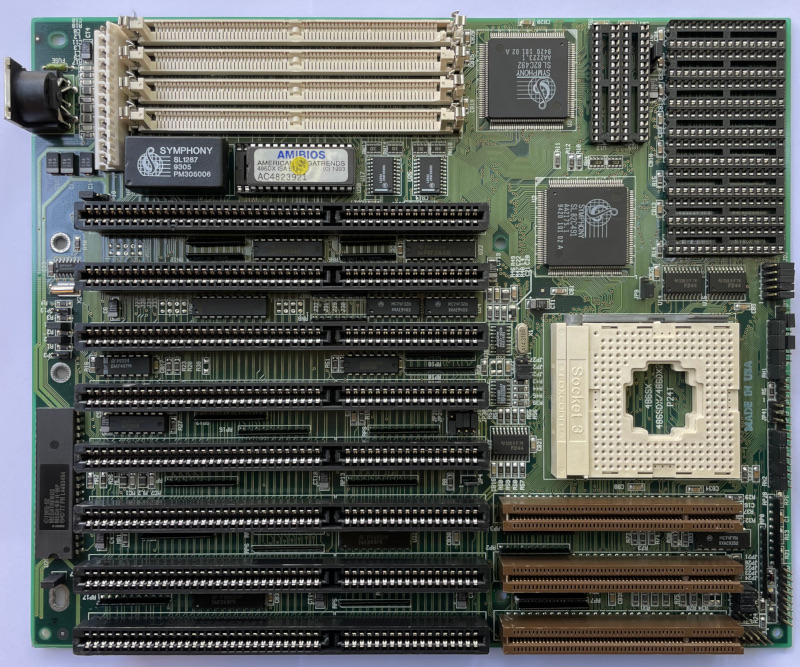

Reply 232 of 2521, by pshipkov

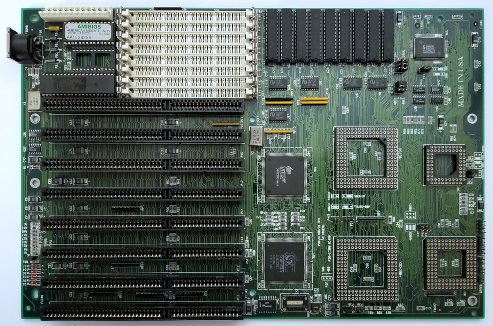

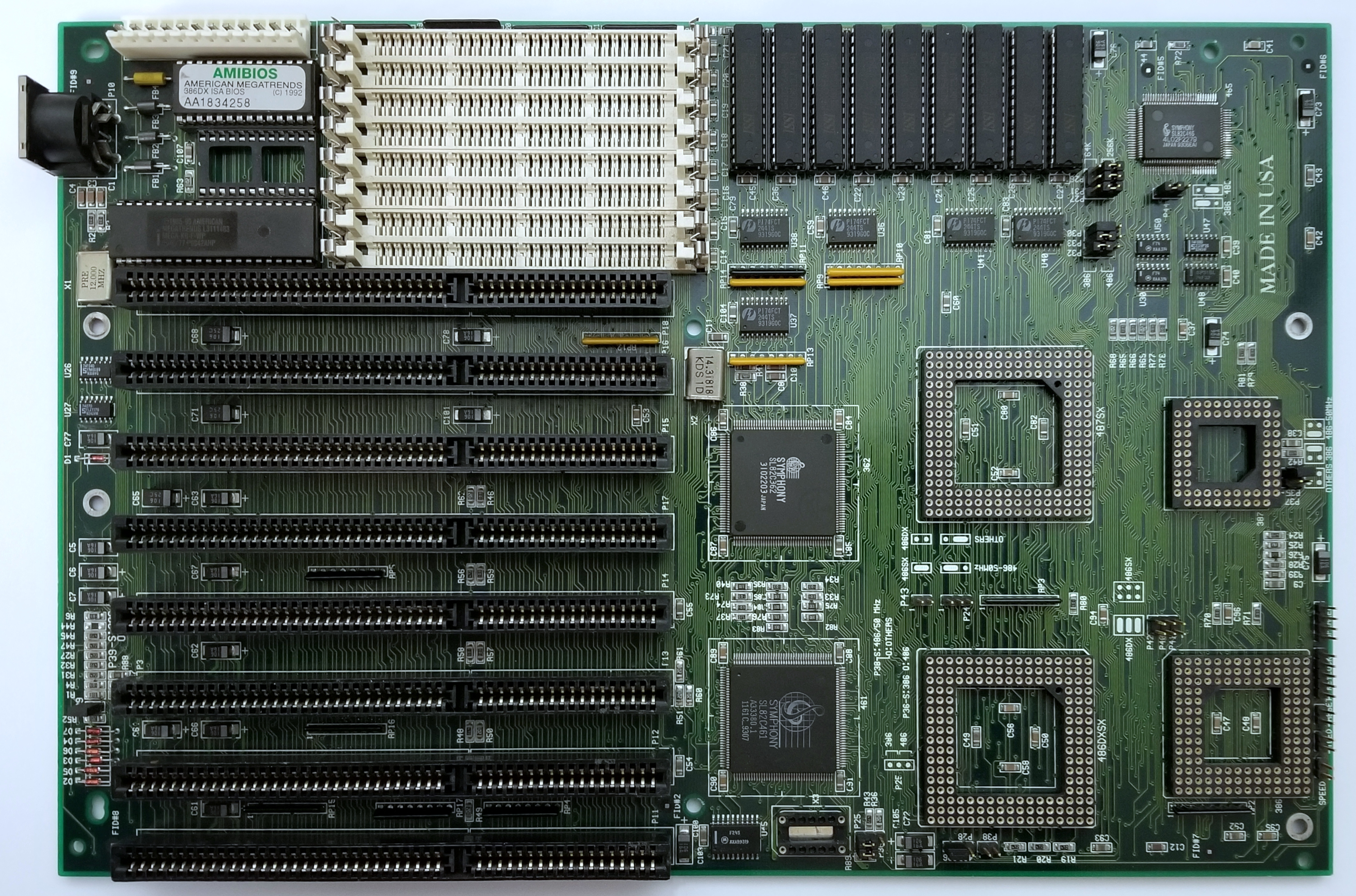

Just when i thought that my 386 curiosity was mostly satisfied i had to stumble upon what appears to be Young Micro Systems VEGA 3-486 CACHE hybrid motherboard. It looked very promising, which made me wonder if it can bring a surprise.
The "Made in USA" stamp on it made me smile initially.
My presumption was that the only thing made in USA from this motherboard was the stamp itself, but search of "Young Micro" returned what appears to be a small California based company in the early 90ies, which increases the possibility of the stamp telling the truth.
The board itself was in really good condition, but when i turned it on weird things started happening.
It would lock or go dark unexpectedly. After some time it became clear that this is not an electrical problem, but a physical one.
Applied the trusted bend+twist scientific approach. Things got much better, but after a while i got few more blackouts.
Second session of applied science fixed it for good. Ticking solid now.
Briefly about the implementation:
Symphony Haydn chipset. This is the "old" revision consisting of 3 chips (there is a later variant with 2 chips only).
386 and 486 CPU sockets.
486SX support of up to 50MHz <- this frequency is what sparked my interest
maximum of 32Mb RAM
256Kb L2 cache

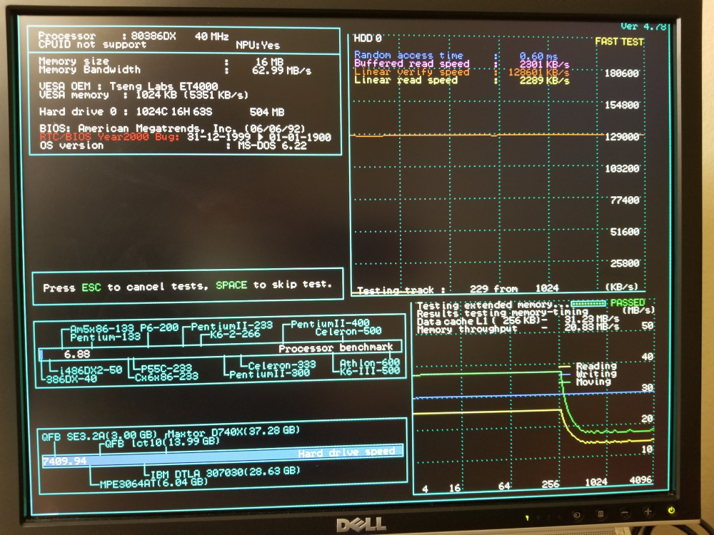

With the initial instability out of the way, i moved onto testing its 386 implementation. Didn't bother to check the 486 side.
When on 386 path the board can hit maximum of 45MHz , but is not stable.
RAM, SRAM, VGA and IDE components that i test with can operate at 55MHz no problem.
Limitation is the motherboard itself.
Stepped down to 40.
Also, it does not like SXL2 and DLC CPUs. Tested with 386DX.
Finally, DRAM wait states had to be set to 1 (up from 0).
Here is what SpeedSys says:
At 40Mhz we don't get a performance beast, but things are pretty up there on a clock-to-clock basis.
Compared it to PC-Chips M321, which is another one of those great boards that just don't scale well past the 40ies.
Added and the common by now 50MHz DTK system to indicate peak perf.
Didn't bother with 3D rendering tests. They take forever on a config like this and won't reveal anything shocking.
So, going with lightweight interactive DOS graphics only.
benchmark results
Overall pretty good retro hardware.
It is 50MHz rated for 486SX CPUs, but the 386 path seems to be on a different opinion - too bad.

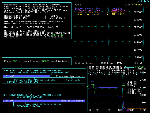

Reply 234 of 2521, by pshipkov
Several pages ago (around the beginning of this year) i went through bunch of dual Slot1/2 (Pentium III) motherboards in attempt to identify the best ones and build a badass graphics / software_development workstation.
This initiative is reflected in the next posts:
Supermicro S2DGE, Tyan Tiger-133, Asus P2B-D
OR840 (IBM Intellistation M Pro, Type 6868)
OR820 (Dell Optiplex G300)
(there were 2 more BX440 boards from Gigabyte and Soyo that were discarded early on)
The last one from the OR800 series was an interesting case and took longer, because i put quite a bit of effort to work around some issues with it.
Asus P3C-D (rev. 1.13-A06) / HP Kayak XM600 - a bitter-sweet experience.

Here is what speedsys says:
Looks good overall. Disk i/o is not that great.

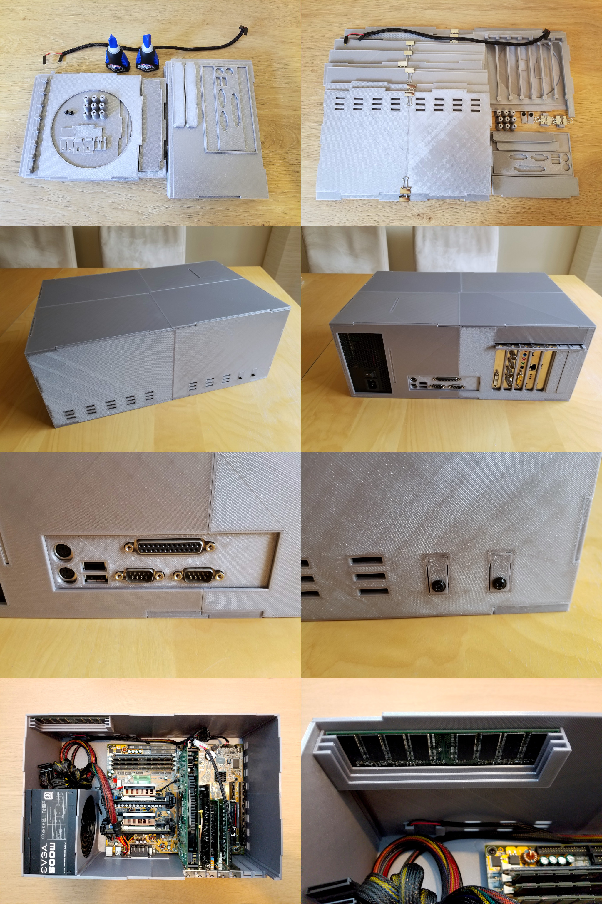

Custom 3D printed ATX PC case - exactly to my liking. Spent the time to make it real tight and sturdy.
DIMM holders. I often switch between different FSB speeds to test things. This requires adding/removing sticks to the DIMM slots. Figured i need a place to keep them when not in use. Added one more holder after taking the pictures.
The shown here video card is dead now. Replaced with another Quadro FX4000, non-SDI version, but dual head one.
Photos show the initial cable management which was not bad, but further improved it recently for better optics.
And that's it.

Recently stumbled upon very promising looking motherboard from Young Micro Systems, model mb-sw486g-3vl-v11, based on the latest incarnation of the Symphony Haydn SL82C491/2 chipset.
I had great experience with other boards based on this chipset, so decided to spend the time to examine how this one behaves.
PCB is in great condition.
It has 5V only socket. No voltage regulator on board.
(It looks like there was another version with VRM.)
Because of that decided to test with POD100 first, then checked with Am486DX5 CPU sitting on a 5V-3.3V adapter.
AMI BIOS with the clunky windows UI.
All settings on max.
Requires 15ns or lower latency L2 cache for 1-1-1 burst read/write cycles.
Very picky about L2 cache chips but was able to find a set for 1Mb buffer.
Handles well P24T (POD100) L1 cache in in WB mode. Something that is not always the case with other boards.
System is not completely stable past the 40MHz base frequency with 486DX5 cpu. Tried hard but no luck.
Happen to have a second motherboard like this. Somewhat different version, but cannot find any details about it.
Performance and overall behavior is identical for both.
For complete stability at 40MHz FSB 2 BIOS settings had to be set below their optimal values:
BURST READ CYCLES 2:4 = X-2-2-2 (best is X-1-1-1)
BURST READ CYCLE 1 = 3-X-X-X (best is 2-X-X-X)
Also, BURST CACHE FILL must be set to DISABLED for improved performance.
Used Holtek EIDE controller which delivers 10mb/s disk i/o with the VLI board.
Ark1000VL was used for the DOS tests.
S3 Trio64 VLB for Windows GUI tests.
--- AMD Am5x86 at 160MHz
benchmark results
--- Intel Pentium Overdrive P24T at 100MHz (POD100)
Speedsys:
benchmark results
At 16-bit colors the system gets very unstable. Considered that as a failure instead of searching for other VLB cards that may potentially work.
Not the best performer, but overall pretty ok.
Coincidentally, not far ago i checked another Symphony motherboard from Young Micro Systems here.
While both boards are actually pretty good they don't take the most out of the otherwise very potent chipset.
The difference is stark when compared to Symphony Haydn systems from DTK (here and here).
