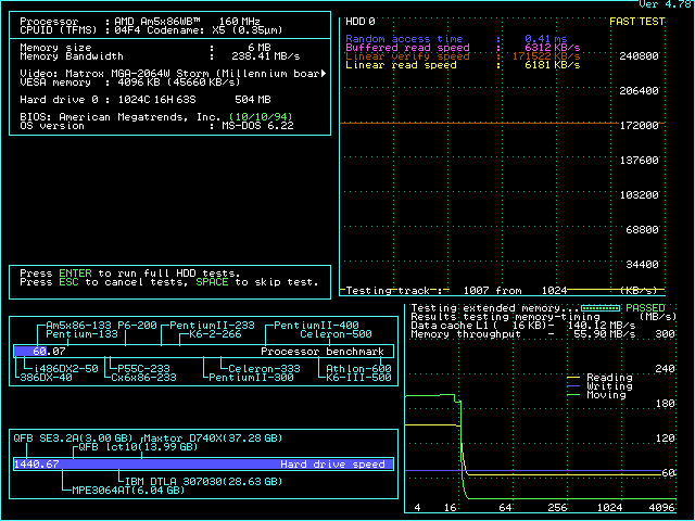

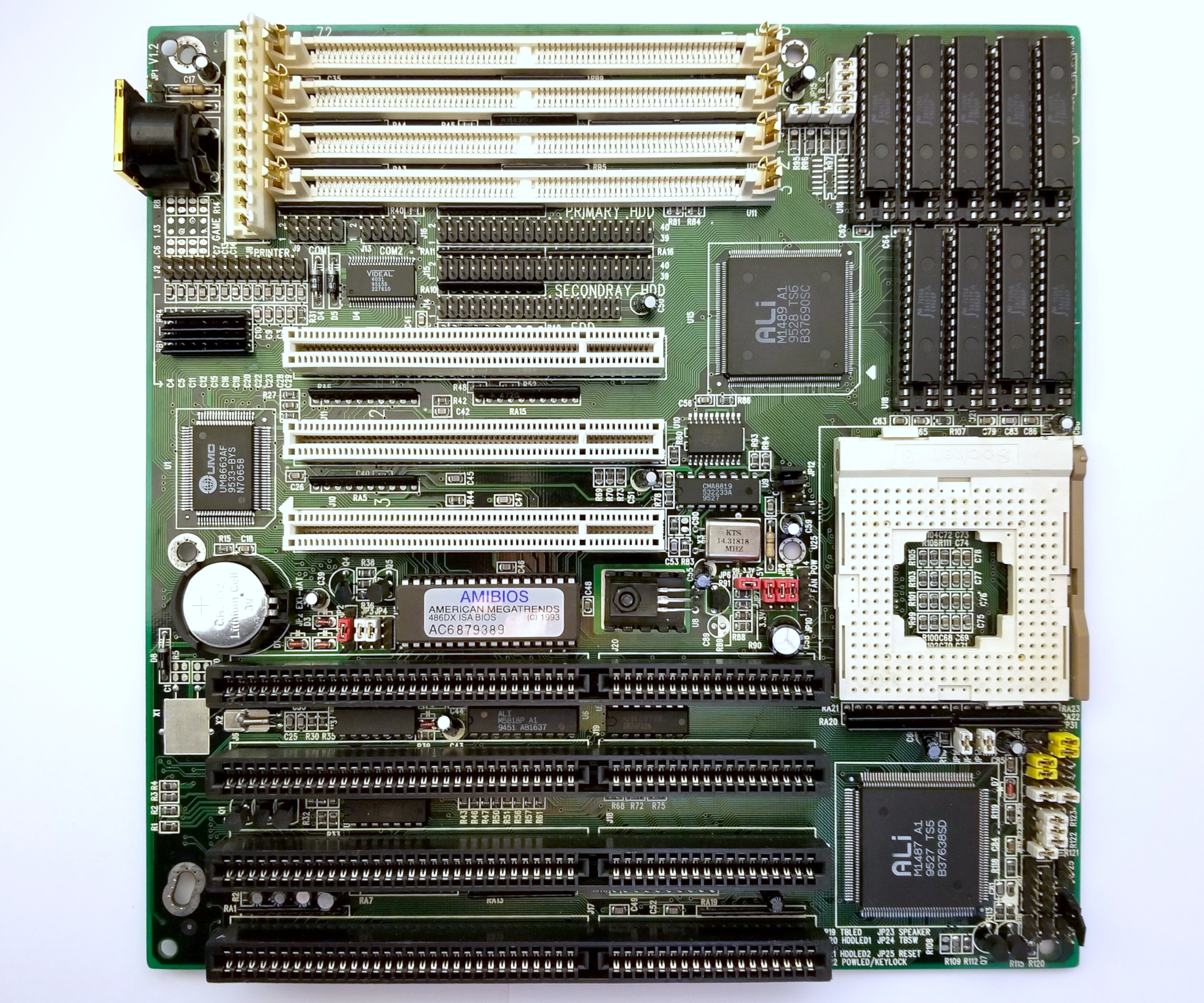

Picking up where i left the 486 at 180MHz - an exercise in practicality several posts ago.
This time with PC-Chips M918i revision 1.2.
It was not clear if the on-board clock generator actually supports frequencies above 50MHz.
First i thought that the clockgen is relabeled component, but there are online stores still selling it, so it is legitimate after all.
At the same time, there is no trace about its datasheet online.
Had to verifying carefully if it can do 60/66MHz using trial and error.
Speed selection is a bit weird - 4 jumpers. That's quite a few configurations which suggests wide range of supported frequencies.
Tested multiple times with trusted components - 60ns FPM and 50ns EDO memory, 3 sets of L2 cache chips - 256Kb/512Kb/1024Kb configurations, ADZ/ADW CPUs that handle 200Mhz just fine.
Intention was to minimize the chance of missing the desired frequency because one of the components failed at it and the system didn't lit up.
Unfortunately the only supported configurations are 25, 33, 40, 50.
No 180MHz for this board. Too bad.
To compensate for my disappointment decided to check how it does at 160MHz (4x40) and 200MHz (4x50).
Replaced the flaky L2 cache the board came with (pictured above) with trusted ones.
At 160MHz 1024Kb is achievable.
EDIT: At 200MHz the best i could do was 512Kb single banked, but still interleaved (?). <- Cache is not interleaved. Confirmed in following posts.
There is something really strange about this chipset.
Its direct memory access is very fast. In fact it is so good that L2 cache can easily be slower than that. Can this be some in-chispet caching mechanism ?!
Additional details here.
Board likes EDO memory better than FPM. Performance noticeably improves with EDO.
If more than 32Mb RAM installed - performance tanks.
Tried to figure out why, but couldn't - feels like it is related to whatever internal caching is going on - probably limited cache size.
I saw similar issues in M919 and some other M boards.
It is weird. Any hints ?!
LBA mode has to be turned off, or the board cannot boot from some CF cards.
BIOS shows only up to 256Kb L2 cache in the boot screen.
Also, when running 4x50 it shows 150MHz.
--- 160MHz:
I usually start testing with interactive DOS graphics. They go quick and are great for coarse perf tuning.
With all BIOS settings on max the system could cycle in Quake, Doom, Check-It, etc., forever and ever.
Same for the round of Windows tests.
Great !
Then onto 3D rendering test. Very sensitive - great for fine perf tuning.
Instacrash.
Had to relax some of the BIOS settings to pass that stage:
DRAM WRITE TIMING = FASTER (best is FASTEST)
SRAM READ TIMING = 3-2-2-2 (best is 2-1-1-1) <- ugh, the used L2 chips can do 2-1-1-1 in other boards, this is a M918i specific issue
SRAM WRITE TIMING = 1 (best is 0)
As a result performance went down quite a bit.
benchmark results
--- 200MHz
I will be checking the 200MHz more thoroughly at some point later, so won't go into details here.
Already shared some early findings in this post.
The highest Quake 1 score so far.
There is implicit bus divider that kicks-in at 50MHz, but the system can take 1:1 no problem - just boot with turbo off, then turn it back on.
In general, things felt stable, but will see what this really means given the 160MHz experience.
Something curious:
Despite 12V Peltier in use to freeze the processor:
M918i refuses to boot with ADW CPUs that are perfectly capable of 200MHz, regardless of what the voltage is.
At the same time ADZ CPUs happily run at 4V on it.
Go figure.
EDIT: 64Mb RAM with less 512Kb L2 cache is unstable requires DRAM WRITE TIMING set to FASTER, which affects performance.
The simple cure is to step down to 32Mb.
I don't know if the above notes convey it, but this motherboard is one big contradiction.
It has its nice sides, but not enough to outweigh all the bad baggage.
Some 486 era PC-Chips experience at play.

Reply 454 of 2513, by feipoa
I'm a little confused by these statements, which on the surface seem contradictory.
"Double banked, interleaved L2 cache running at optimal BIOS settings only appears to match direct RAM access in SpeedSys (picture below in this post), but actually has positive performance impact."
then in the reference link you posted
"Direct RAM access is actually pretty good. Single banked L2 cache at 2-1-1-1 only matches it, while 3-1-1-1 for double banked has negative performance net effect."
In the first sentance, you said that double-banked can run at optimal BIOS settings (presumabley 2-1-1-1), but in the other link, you say it runs at 3-1-1-1. Could you clarify this?
Yes, past reports with the FinALi show it having noticably better EDO performance, more so than other PCI 486 boards.
When I tested the m918 many years ago I also noticed the very fast RAM performance and that L2 couldn't increase upon it. The only way I could determine that L2 was actually working was to add many wait states to the memory, then I'd see the expected drops in Speedsys.
Does LBA mode still need to be disabled with certain CF cards, if for example, you set mode PIO-3 ?
How does performance tank with more than 32 MB RAM? Are you implying that you have to increase memory wait states to make it stable, or some funny kind of memory-not-cached thing going on? Or some automatic wait states being added to read/write? What are the metrics on the decrease in performance, e.g. using Quake 1.06 and cachechk memory/L2 read times? Is there an L2: WB/WT mode you can set? What if you physically remove L2 entirely, does the performance still dive after 32 MB is installed? Do you have other FinALi boards you can contrast this phenomenum with?
The FinALi M1487/M1489 chipset brief shows it suppors 128 MB EDO, up to 1M SRAM, 8bit tag, always dirty, or 7 tag bits, 1 dirty.
I checked my notes and I don't have any FSB specs noted above 50 Mhz.
FYI, from what I can recall, these boards often came with fake cache chips or no cache chips.
That's a neat trick to get 50 MHz in the PCI bus. Any idea if that also works with the m919? In the past I've wired the FSB jumpers up to the turbo to switch from 33 Mhz to 40 Mhz once it booted. This would get my PCI back to 40 MHz, but if your trick works, that is even better.
You can't boot ADW CPUs? What voltage is the board outputting on its 3.3/3.45 V setting? I've seen a board or two want 3.6V for Am5x86 CPUs.
Have you tried a Gigabyte GA-5486AL? It is another FinALi board I have, but it only takes single-banked SRAM. However, if I have interpretted your notes corectly, single-banked on this board can work with faster timings?
EDIT: My understanding is that what matters is cache interleaving, but not the number of banks filled. Incorrect. L2 cache interleaving requires 2 banks.

So this GA motherboard may be a better implementation of the ALI chipset.
I have Abit PB4 which works pretty well at 160MHz, but was not able to run it at 200MHz, despite its clock gen supports that. Wanted to give it one more try before give up.

M918i and RAM amount. Verified very carefully.
160MHz with all BIOS settings on max, as described in the post above.
Here is what is going on:
Performance is consistent with 8, 16, 32 and 64 and 128 Mb. Didn't bother with 256Mb.
Results match the SpeedSys screenshot i posted above. Memory speed varies slightly between different runs - in the range of 237.5-239.5 Mb/s.
When 64Mb or more system memory installed - DRAM WRITE TIMING must be set to FASTER (best is FASTEST), or the system gets very unstable - often cannot complete POST.
This is a motherboard issue. The used 50ns EDO memory modules can handle much more extreme conditions.
Under 64Mb memory - DRAM WRITE TIMING parameter can be set to FASTEST.
The system is stable in DOS interactive graphics and the plethora of simple DOS testing utilities.
Stable in Windows as well.
Cannot pass the more sensitive tests, as described in the above post.
L2 cache. Verified very carefully.
160Mhz, all BIOS timings on max, as described in the post above.
L2 cache is not fake.
Board does not like every L2 chip to post properly, but is not too picky. Still, the set of chips has to be curated.
Changing the L2 cache settings in BIOS has impact on stability. That's for sure.
256Kb in 2 banks is slower than direct memory access.
Double checked it by enabling/disabling EXTERNAL CACHE in BIOS = performance metrics change.
Faster when EXTERNAL CACHE is OFF, slower when ON.
Remember the inverted SpeedSys L2 graph from this post.
512Kb in 1 bank is on par with direct memory access.
Enabling/disabling EXTERNAL CACHE in BIOS results in no change in performance.
1024Kb in 2 banks is slightly faster than direct memory access.
Enabling/disabling EXTERNAL CACHE in BIOS results in minor performance changes.

So, Feipoa, can you give the Gigabyte ALI board a spin ?
It will be interesting to see what it shows, assuming the vastly different implementations of the ALI chipset in PC-Chips M981i and Abit PB4.
