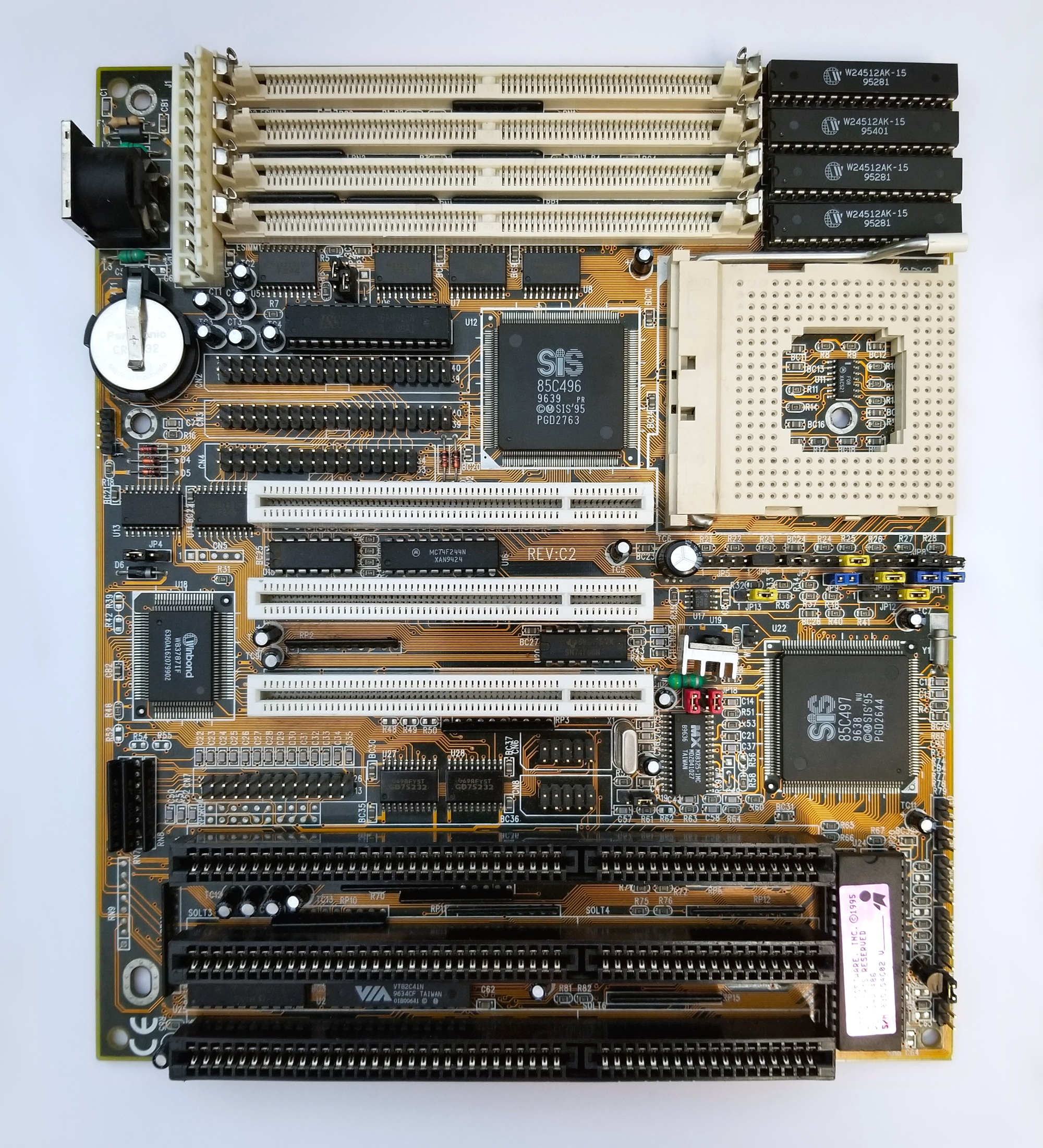

LuckyStar LS-486E revision C2 based on SiS 85C496, 85C497

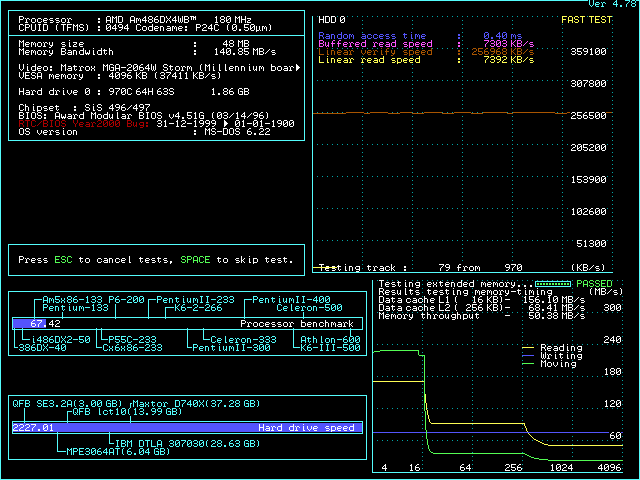

--- Am5x86 at 180MHz (3x60)
Mandatory 4V to the CPU is required. Tried with multiple CPUs - the rule held true for all of them.
Default BIOS does not support EDO RAM. Tried revision D BIOS, but the system was more stable with the original BIOS and FPM memory. Didn't expect that.
The picture above shows 256Kb 15ns WinBond branded L2 cache chips, but complete stability was achieved with 12ns ISSI tag and a mixture of 15ns UMC and WinBond chips.
Tried 10ns ISSI 1024k ones as well. They didn't get recognized, whjch was expected, but wanted to check - just in case ...
Also, tried 128Kb 12ns ISSI chips - didn't make a noticeable difference in stability at lower wait states compared to the 15ns ones, so went with the bigger cache size.

Great Doom score - easily the best at 180MHz from everything i have seen around so far, but at the cost of compromised system stability.
The board can be pushed quite a bit around, but i think revision D is the higher place overall, if we consider complete stability.
Still, some good "medals" awarded here.
