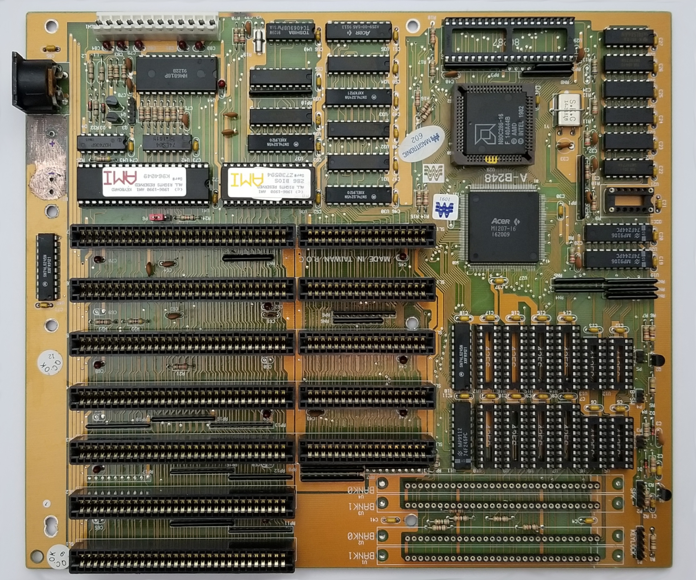

Will share information about few more XT/286/386/486 motherboards.
First in line is Micronics A-B248 assembly based on Aladin's A1207-16 chipset.
PCB is in great condition and of great quality with two exceptions:
1. There was corrosion from leaked battery.
Acid went under the coating and didn't look bad at all but had to scraped-off otherwise would damage the layers underneath.
The fix affected looks but better that over damaged board.
2. After installing a crystal oscillator socket i somehow shorted a 12V line (really silly oversight).
Dense smoke came from the very top rail when turned the power on.
Notice the darkened area next to the power connector. There is more darkening on the back.
Affects optics a little but no functional damage.
Despite the good looks this motherboard does not perform well at all.
The assembly is rated for 16MHz and does not overclock a Hertz further. Tried hard.
In addition to that its clock-to-clock performance is mediocre at best.
Lost interest quickly after started testing it and didn't capture any performance metrics to present here, so you will have to take my word on it.

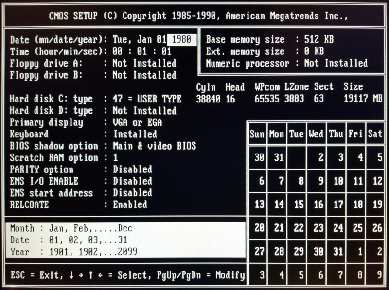

BIOS has nice options for 286 class hardware.
Everything works well with 0 wait states.
Nothing more to add really - somewhat unexciting 286 class hardware.
