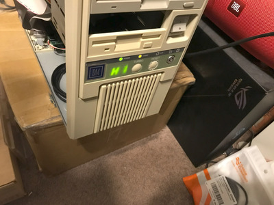

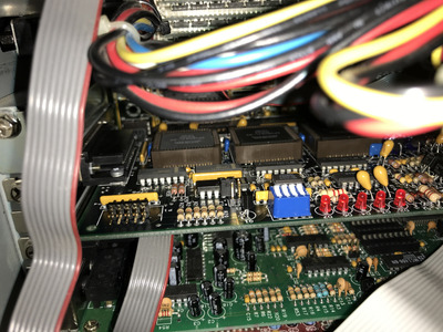

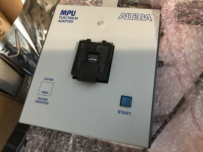

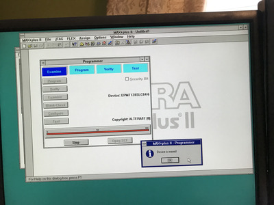

Greetings,
ALTERA LP6 and 386 with NT 3.51 and MAX+PLUS II 9.32
I've found an Altera LP6 ISA device, some MAX5000 and MAX7000 series programming modules. I installed some software and the main point is the hardware. If anyone needs help in programming some old Altera devices, I may have what is required. Letting the community know, and there is still someone around who can perform the task. The pictures limit what I have acquired. I've installed NT 3.51 with a 386 machine and all is working well.
Sincerely,
William

The adapters I've acquired, which can help the community include the following:
PLED910 PLEJ464 PLED503A PLED5032A PLEG5130A PLED5016A PLED5016A PLEJ810 PLMJ5192 PLMJ7000-84 PLMJ7032 (good for 64, too) PLE3-12A EP600 EP900 PLED448 PLMJ1213
If need anything examined, cleared, checked whatever, or if you find an adapter, send my way to help the community.
