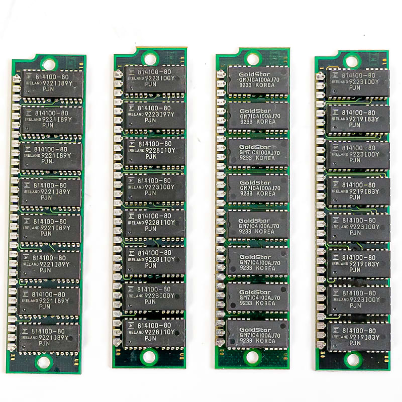

Check the number of chips on the module.
at least for FP memory layouts, nonparity modules will have 8 chips, and parity ones will have 9.

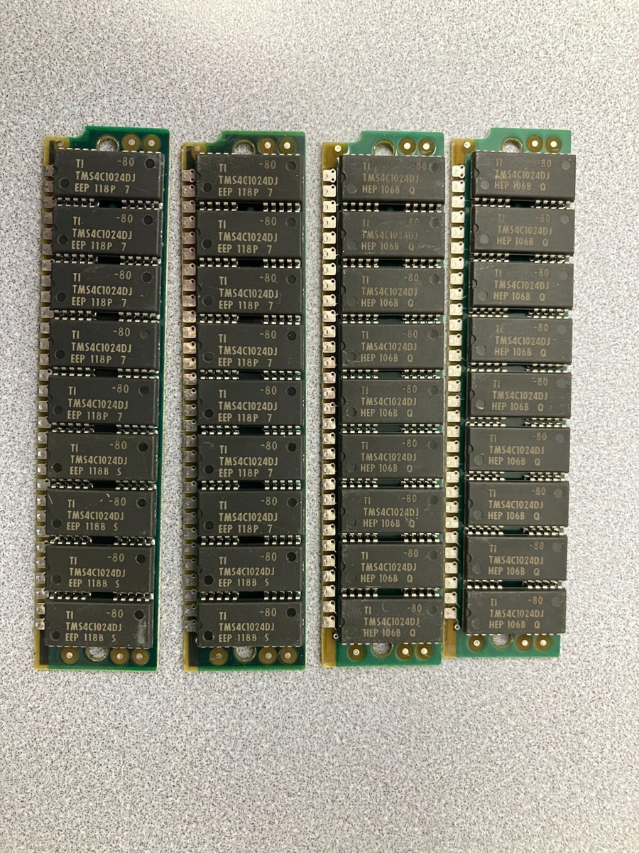

See for instance, these nonparity FP simms
And these parity ones.

I'd suggest getting parity memory that's 9chip config.
1mb modules. I doubt 4mb modules will be tolerated.
If you feel extra cautious, 512k modules.
