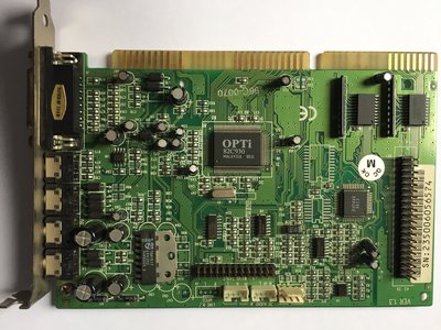

Hi there, long time lurker, first time poster here! A while ago, I came across Phil's Computer Lab youtube channel and it got me all fired up for some DOS retro gaming. So I dusted off my old PC and installed DOS 6.22 on it, but soon realized that it came with an SB128 PCI card which has some truly awful FM synth emulation. After a quick search in my local classifieds, I found a couple of ISA sound cards that seemed perfect for my needs, one of which was this OPTi 82C930. I have been using this card for several months now and was quite impressed by what it had to offer.
1.57 MiB
9902 views
OPTi 82C930
Pros
  • Good compatibility in SBPro mode
  • Delivers crystal clear 16-bit sound in Windows Sound System mode
  • Has a 1:1 pin-compatible OPL3 copy on board, providing excellent FM synthesis
  • Has ADPCM support, so games like Duke Nukem 2 work fine
  • Has a proper low pass filter in SBPro mode
  • Not plug and play (this actually makes configuring easier)
  • Has WSS compatible drivers for Windows 3.1
  • Has a dedicated Line Out port
  • Does not suffer from any bugs which are present on Creative cards
Cons
  • Somewhat noisy. It's not really perceptible while gaming, but you may notice it when recording gameplay audio
  • A couple of games needed patching/workarounds in order to get the highest quality sound
  • Stereo is reversed in some games (e.g. Doom and Quake)
  • Windows 98 drivers are pretty bare bones, with very few options to select

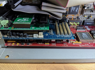

I discovered something new about this card. Apparently, it takes up the A220 I5 D1 resources even if it isn't initialized by its drivers. Normally, this wouldn't be a problem, as the OPTi card switches to whatever resources are set up in SOUND16.CFG the moment its drivers are loaded. However, if you're using a second sound card at the same time and want it to use A220 I5 D1, then you must initialize the OPTi card before loading the drivers of your second sound card. I found out about this the hard way while trying to use both an OPTi 82C930 and an AWE64 Value (CT4520) in this build.
For testing purposes, I configured the OPTi card at A240 I7 D3 and the AWE64 at A220 I5 D1 H5. However, if the AWE64 drivers were loaded before the OPTi drivers, then the AWE64 would not produce sound effects or music, despite the two cards not sharing any resources. Loading the OPTi drivers before the AWE drivers resolves this issue.
Also, the OPTi card must be initialized in SBPro mode for this to work. If you initialize it in WSS mode instead, then A220 I5 D1 will somehow still be used by it and become unavailable for any other sound card.

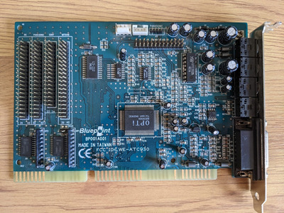

I picked up this Bluepoint BP001A001 recently. Not gonna lie, I bought it because it was blue.
552.22 KiB
7003 views
For the install I went with these DOS drivers which are an older version than the ones already linked in the thread. The reason: INSTALL.COM from the other pack insisted on being run from a floppy, which was a pain. So I grabbed the pack that would fit on a single disk. But as it happens, the smaller pack doesn't have an INSTALL.COM anyway. So I just copied the folder over - but this process required some manual effort to get working.

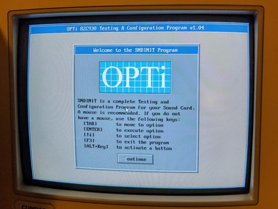

SNDINIT.EXE requires the SOUND16 variable to be set before it will run. So you need to run these commands:
SET SOUND16=C:\OPTI930
SNDINIT.EXE
You get a nice little GUI:
126.52 KiB
7003 views
From the readme, these are the lines you then need in your autoexec. But SNDINIT only added SET BLASTER for me, and I had to enter the rest manually:
PATH=C:\OPTI930 (appended)
C:\OPTI930\SNDINIT /B
SET BLASTER=A220 I5 D1 T4
I had to tweak the wonky default mixer levels too (SNDINIT /V) and everything was good. I have another card with the LS-212 chip like this one, which is a great OPL3 clone.
The next challenge was dropping in a GUS Classic alongside. I'll spare you the full saga of resource wrangling and swearing. But Joseph's post above, had I read it beforehand, might have steered me to the solution faster. In the end my problem was a dumb one: Despite using I5 for the Opti in autoexec, I still had it at I7 in SNDINIT. But before I discovered this, I did suspect that the order of initialisation was a factor, and did much experimentation swapping things around in autoexec. Sometimes only part of one card would work, sometimes part of the other. I couldn't make sense of it.
Long story short, with the address error fixed and the correct order set in autoexec (SET BLASTER, initialise Opti, initialise Ultrasound) everything came good.
And that's how I invented RGB Sound.

I picked up this Bluepoint BP001A001 recently. Not gonna lie, I bought it because it was blue. […]
SNDINIT.EXE
Interesting card. I don't believe I own, or even saw, a 930 card with an onboard (clone) OPL3 before; this chip has its own OptiFM hardware implementation of OPL3 AFAIR so that is a pretty nifty card to have.
EDIT: Ok, wait, I think I'm wrong? 931 is the one that has the OptiFM synth integrated, not 930?
EDIT2: Can someone more knowledgable state the differences between Opti 929 (MAD) and 930 chipsets. It seems I have 3 929 cards in my collection (some with ADI some with Crystal codecs) and none of 930. I believe 930 is an advaced 929 with the codec integrated?
Reply 19 of 31, by Joseph_Joestar
appiah4 wrote on 2021-11-12, 05:11:
The 930 was the last OPTi card that used either genuine OPL3 or a 1:1 clone. From 931 and onward they started using OPTi FM.
Pretty much. Everything is in a single chip on the 930. Functionally, it appears to be identical to the 929 card with an Analog Devices chip, meaning that WSS compatibility is superb.
