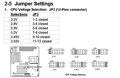

PS Found documented settings for another Jetway board that I once had or researched.

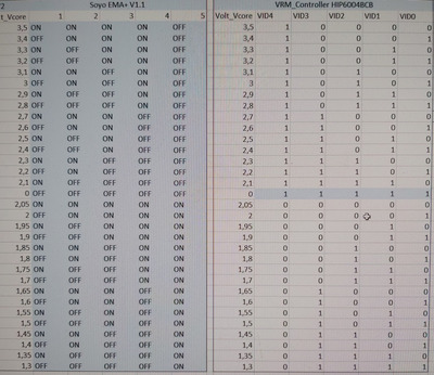

This is for the voltage regulator on my soyo 5EMA+ that has a HIP6004BCB controller. The right side is from the controller manual. The left side is mirrored for the actual jumper settings. Make sure, that applies to your board as well!

The boards discussed earlier in this thread have 2x4 jumpers and are limited to 16 selection combinations.
The layout you posted does not apply because it is for the SOYO 5EMA+ which has 2x5 jumpers and therefore 32 selection combinations.
Reply 9 of 12, by Williwinner
True. I thought the layout mentioned in this threat was only used for 5EMA (non+) but his SY-5EMA+ is indeed very different to my SY-5EMA+ (v1.1).
Thank you for making that clear!
