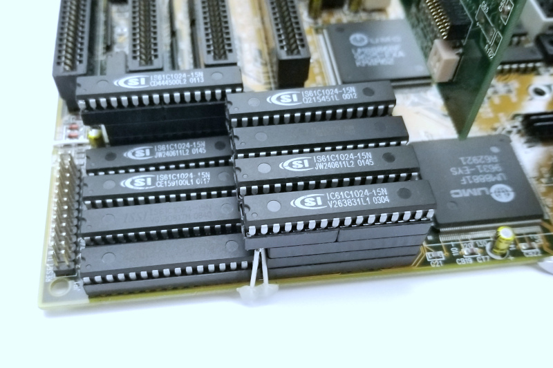

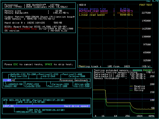

Applied Feipoa's 1024Kb L2 cache mod to one of the Biostar MB-8433UUD-A version 2 motherboards.
It is straightforward to do, does not take much time, so it made sense to give it a try.
That was the easy part.
Finding the right L2 cache chips was a nasty experience, especially if tightest BIOS timings are a requirement.
At the end a combination of ISSI 10/15ns rated chips did the job. Well, at 160MHz at least.
Here is how the final assembly looks like.
Tripple-decker to give space for the chips in bank 0 to be handled easily.

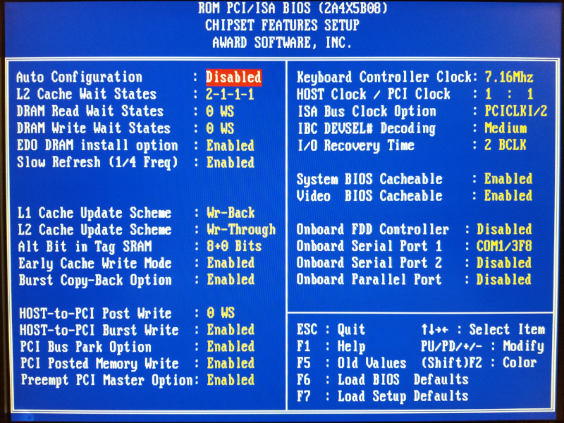

--- 160MHz
1024Kb L2 cache running with the tightest BIOS timings:
System is very stable. Passed everything i threw at it (and i don't hold back).
Very satisfying.

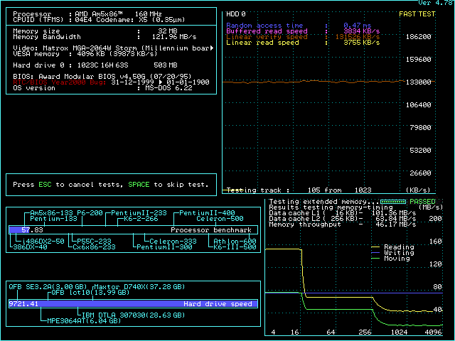

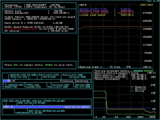

Here is what SpeedSys says.
Notice the 256Mb (50ns EDO) RAM.
The UMC IDE driver was difficult as usual. Refuses to cooperate when BIOS settings are on max.
Have to lower its disk speed argument value to 9-10 otherwise it hangs. At that point performance is lower than no driver.
Additional L2 cache improves performance. Chart below shows this mobo's best scores with 256Kb and 1024Kb L2 cache, as well as the best scores from everything else i have seen so far - for reference.
Notice the Quake 1 result - finally a system that outdoes in some way Asus VLI at its game - 8-bit pixel pushing.

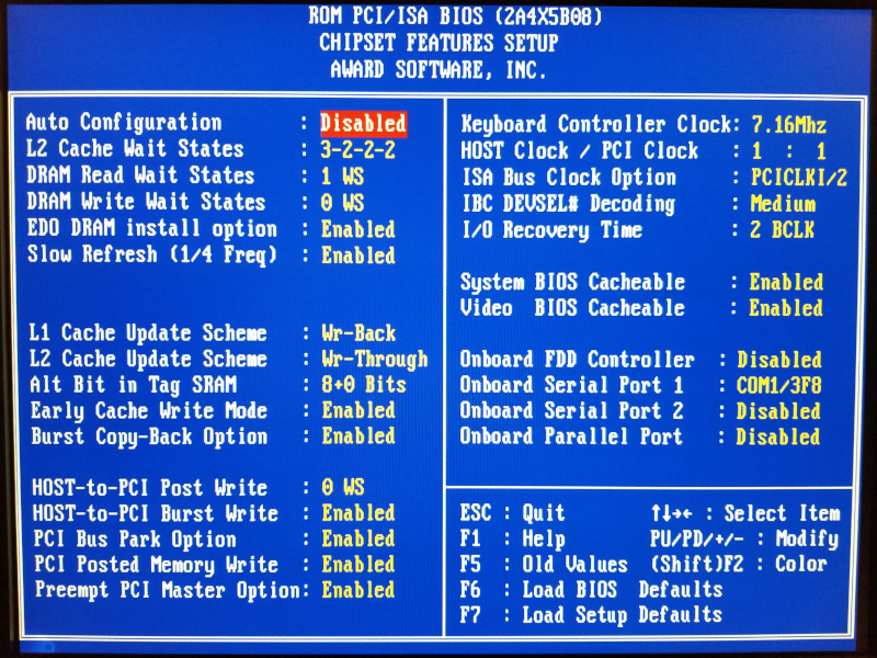

--- 180MHz
Things didn't work that well at this frequency.
There seems to be a limitation on the motherboard side. It refuses to boot if L2 CACHE WAIT STATES is not 3-2-2-2 (slowest) and DRAM WAIT STATES lower than 1.
What makes me think it is the mobo ?
Usually when trying to find the right combination of L2 chips there are sets that result in at least partially stable system - some apps/games/tests work, others don't.
This is a good indication that the limitations are on the cache chips side.
In this case anything faster than 3-2-2-2/1 results in hard hang during post, regardless of what cache chips are being used at the moment.
Tried hard to overcome that, but the board refuses to cooperate. Even at 3-2-2-2/1 the system is not fully stable - things are ok with interactive DOS graphics, but Windows and the more challenging tests are unpredictable.
Also, over 64Mb of system RAM further worsens stability.
Disappointing.
Still, here is how the BIOS looks like:
What SpeedSys says:
And some performance metrics:
                      UUD/1024Kb      UUD/256Kb       other
wolf3d (fps): 148.7 153.8 153.8 (UUD/256k)
pc player (fps): 29.3 29.1 29.6 (LuckyStar D)
doom (fps): 70.5 72.0 74.5 (LuckyStar D)
quake 1 (fps): 20.0 20.1 20.4 (LuckyStar D)
While the extra L2 cache offsets to a point the inflated BIOS timings, it is still not enough to outdo 256Kb at full speed.
If at least the system was fully stable, the extra cache could be a nice option for fully covered 256Mb of system memory.
I was hoping for a better outcome at 180MHz, but that didn't happen.

I also noticed that with 66 MHz, I must limit the system to 3-2-2-2 and DRAM read at 1WS. It looks like 60 MHz is no exception. But what about 50 MHz and 1024K? However, unlike you, the IBM 5x86c-133/2x is perfectly stable in Windows, at least mine is. What CPU voltage are you running? When I was doing tests with 66Mhz, 3-2-2-2/1ws, and 128 MB, I found that increasing the CPU voltage helped, which is curious, because I didn't have to do this with 64 MB.

feipoa wrote on 2021-09-27, 07:44:
How long did it take you to find the right combination of SRAM modules to work at 1024K, 160 MHz, and 2-1-1-1 timings? And does that particular order of modules matter? I assume it does. Unfortunately, I don't have a lot of different brands of 128kx8 modules to try out like you. I have dozens of the Chinese fakes and only 4 pieces of original 128kx8 modules from the 90's.
This last time it took few hours, but was doing other things as well.
Order matters. Swapping chip in slot 0 with chip in slot 1 can be the difference between fully stable and flaky.
I don't have that many 128kx8 chips. Once i got into the retro optimize and overclock thing, i had to scrub some of the motherboards i have here from their chips.
The 10ns "fake" ones are good in my opinion.
This is interesting, since you went triple decker, you don't have to lift up the DIP sockets that overhang the left-most bank? Doesn't the pin header get in the way though? I normally remove all SRAM modules from the right-most side of the dips on this motherboard because of the header.
The space is just enough to allow chips to be inserted easily without lifting the sockets. In a moment of wisdom the simple idea came to me.
Was thanking myself multiple times during the hours of chips curation. 😉

Thanks for the 3-2-2-2 clarification.
Framerate difference: The first table is for 160MHz the second one is for 180MHz.
Or i don't understand your question.

--- 160MHz
Very stable overall.
All BIOS settings on max.
SpeedSys
benchmark results
Good board, very easy to setup and run. Obviously not a the best performer out there.
--- 180MHz
3.45V to CPU or no boot.
DRAM WAIT STATES = 1
VLB video cards don't light-up at 60MHz base frequency.
Initially i had a lot of stability issues at 180MHz - couldn't complete POST.
At some point i disconnected by accident one of the Peltier wires during POST and suddenly the system was in DOS prompt.
Light bulb flashed. Until then i used 300W PSU. Swapped with 450W - all good from there on.
This is the first motherboard that exhibits such a problem, but is indication that using Peltier elements with underpowered PSUs can be too close to the electric stability threshold of some hardware configurations.
Speedsys:
Benchmarks, compared to Biostar UUD and LuckyStar D as the highest watermark.
At this frequency the motherboard does just fine in DOS, but is unstable in Windows and some of the more complex tests.
Tried hard to overcome that. Long story short - limitation is in the board itself.
Performance scales well - considering how much behind the 160MHz results were it closes the gap at 180MHz.
Still, the shown instabilities make it unsuitable for OC past 160.
--- 200MHz
No lights.

Reply 614 of 2521, by Chadti99
pshipkov wrote on 2021-09-24, 07:49:
Applied Feipoa's 1024Kb L2 cache mod to one of the Biostar MB-8433UUD-A version 2 motherboards. It is straightforward to do, doe […]
