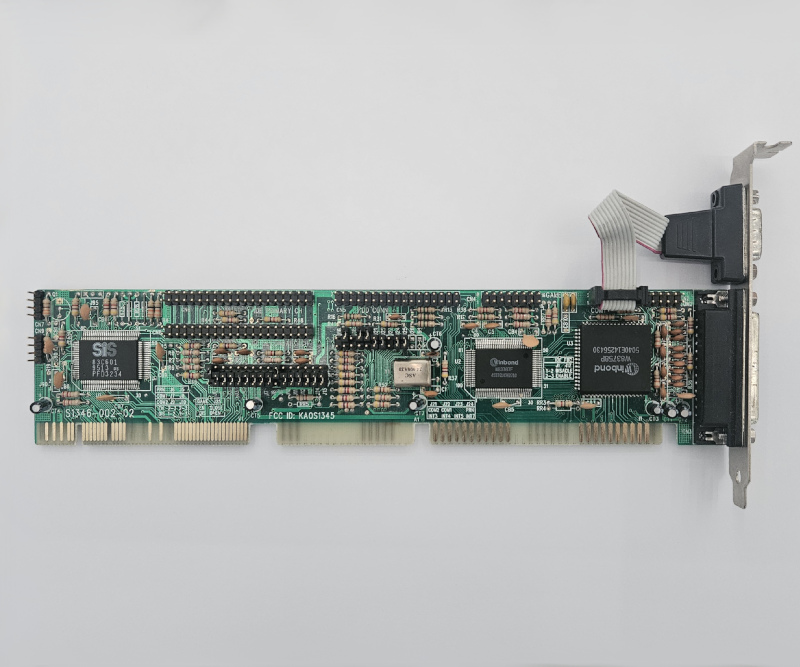

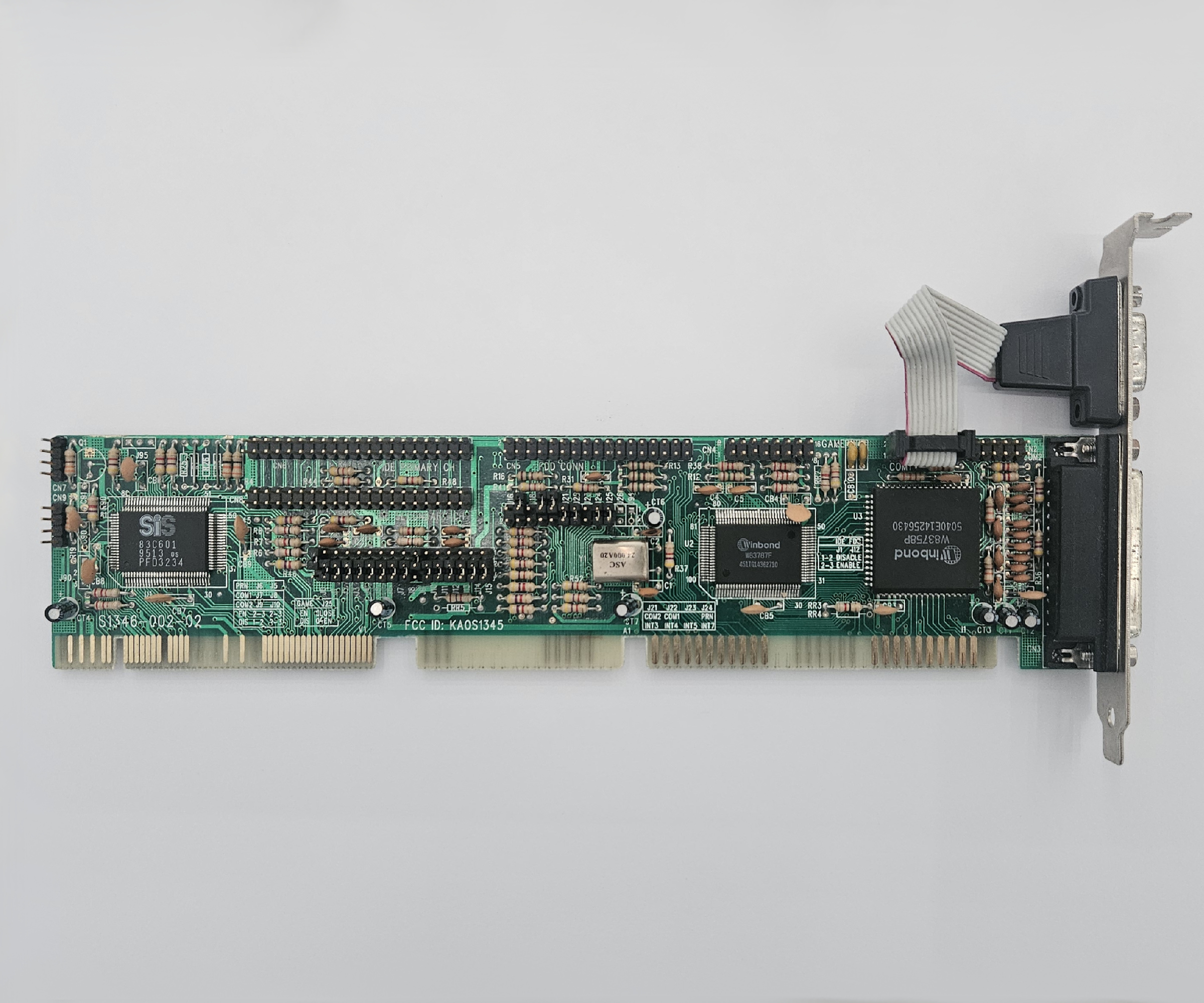

(SiS 83C611) Tyan S1342/1344-005

When not using the software driver for the SIS controller, both buffered and linear read speeds are at ~4100 Kb/s. When use the driver, the buffered read goes through the roof, but the liner speed increased only by 700Kb/s = ~4800 Kb/s.
