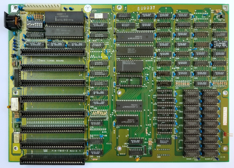

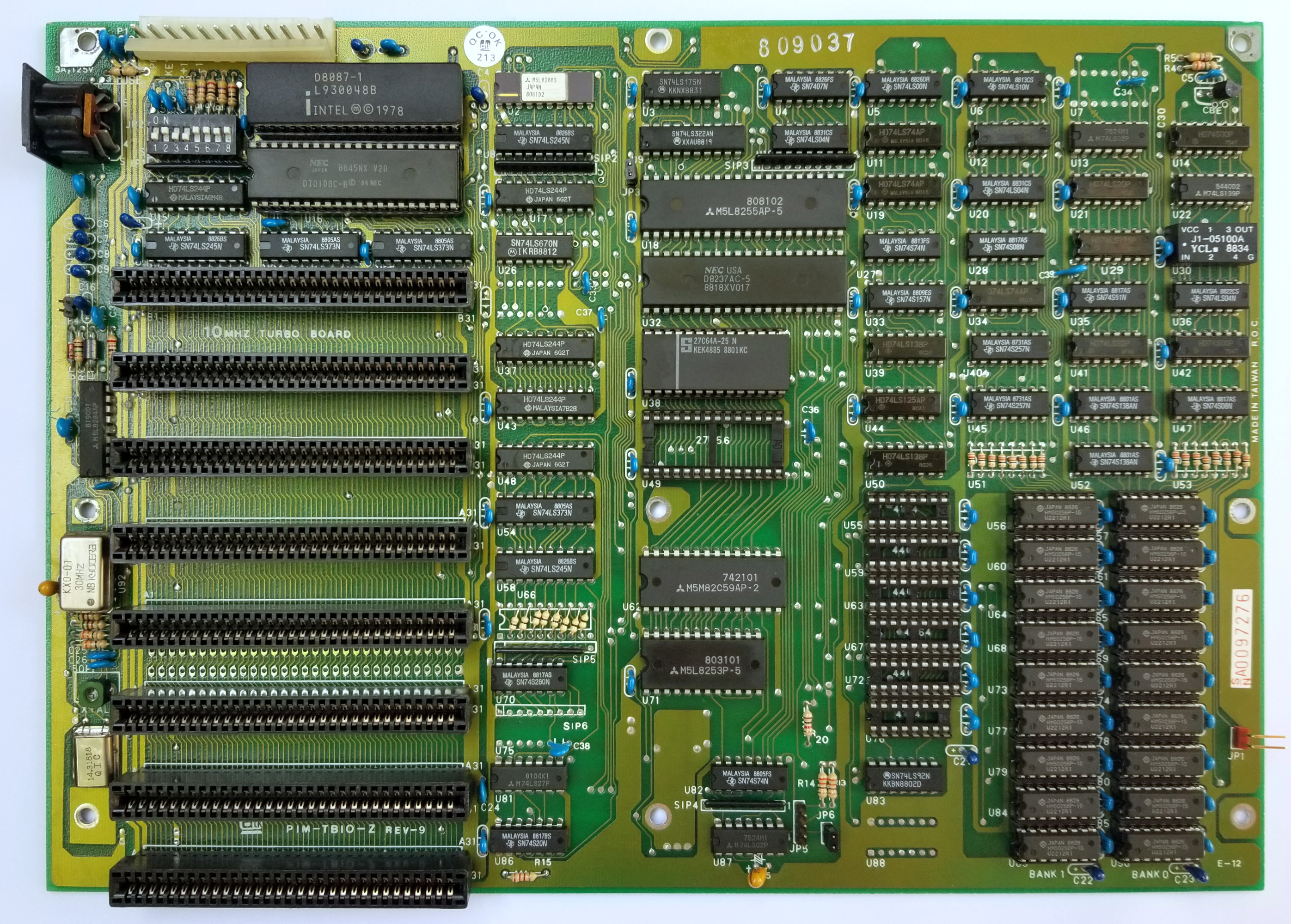

First in line is DTK PIM-TB10-Z revision 9 (most recent model of the series).
Utilizes smaller number of higher density RAM chips compared to early variants.
This is important factor since overclocking of XT and 286 hardware is predominantly limited by the quality of the installed RAM.
More chips = bigger chance for some of them to be flaky. Memories from that time were much more fragile than later generations.
Ok, back to the mobo - not exactly a very late XT model given the relatively big amount of logic components on it, but close enough.
PCB is still in great condition. Very sturdy and well built. Also, it just works, after all these years. No effort whatsoever.
Default frequency is 10MHz.
Came with 640Kb 150ns rated RAM chips and 10MHz rated 8088 Jujitsu CPU.
After the initial round of tests, where everything checked right away, it became clear that this is a fast assembly.
Decided to see how well it overclocks and how far it can go on the performance scale.
Inserted a NEC V20 CPU and 10MHz rated 8087 FPU.
Swapped the 150ns RAM chips with 80ns ones.
Soldered a crystal oscillator socket.
Started with 36MHz oscillator for 12MHz base frequency.
The very short POST process never reaches a point to start testing the installed memory.
Stepped down to 33 and then 32 MHz oscillators - 10.3MHz.
Again - POST does not start testing RAM.
Ok, this was the fastest overclock failure i had so far.
Tried hard to get it to do anything above the base 10MHz but failed.
There is something in the motherboard that is really not having it with "higher" frequencies.
Still, it was worth giving it a try. Not disappointed really - the board is great as it is at its 10MHz.

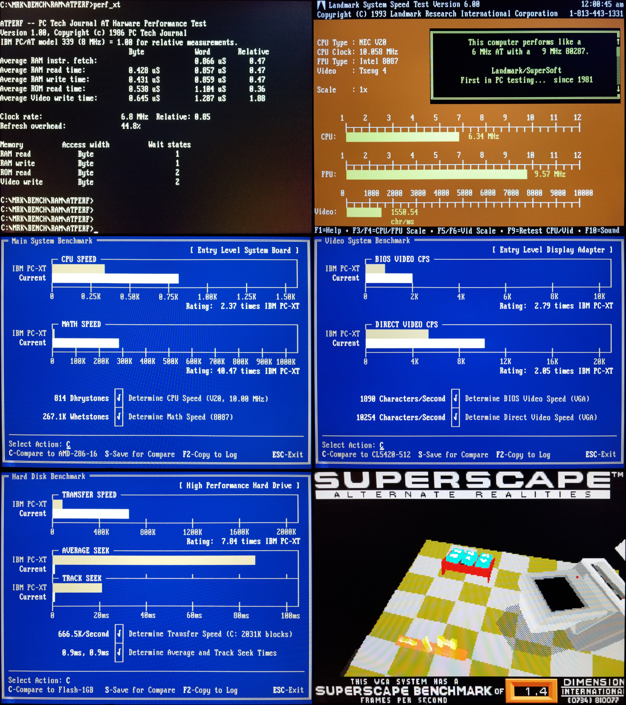

There are not a lot of good benchmarks that cover XT hardware well enough.
So going with AT Perf, CheckIt, SuperScape, LandMark to measure and compare performance.
Here is what they say for this motherboard. Used XT-IDE adapter and ET4000AX video card.
An interesting observation about video cards.
On the Tandy 1000SL ET4000AX was slightly behind compared to some earlier video adapters, but no such difference was observed with the DTK board.
benchmark results
Performance is not bad at all, but the system does not overclock very well.

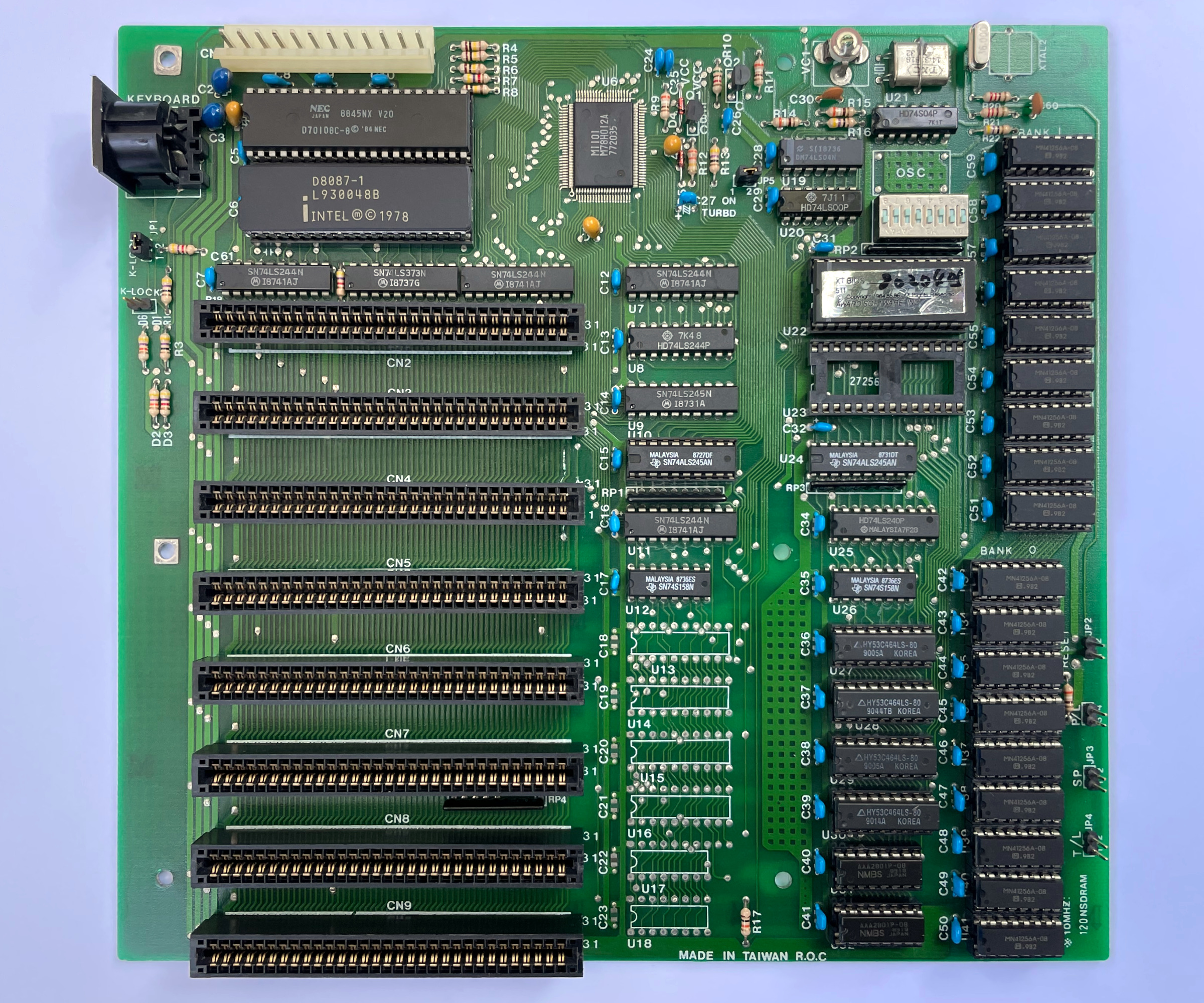

Superwave Super-10b.
Late 8088 Turbo XT motherboard.
Very high level of integration. Basically a single M1101 chip which i believe is Acer Labs (ALI) silicon.
PCB is in great condition. Came with standard Intel CPU and no FPU. 30MHz oscillator for 10MHz system.
Mix of 120 and 150 ns chips for 640Kb RAM.
Everything worked right away as advertised.
Upgrades:
Replaced the CPU with NEC V20.
Added Intel FPU.
Swapped the RAM chips with 80ns ones.
Made a 2-pin crystal oscillator socket using legs from 4-pin crystal oscillator socket. Soldered them directly in the through-holes. (upper right corner with inserted oscillator in them).
This allowed smooth overclock to 12MHz.
Board keeps lighting up all the way to 16MHz but after the 12MHz mark POST never completes.
Tried hard with trusted components - different CPUs, minimal RAM, etc. Didn't help. The limitation seems to be in the motherboard itself.
As mentioned in the previous post - there are no great benchmarking programs for XT class hardware so going with some synthetic tests.
Default 10MHz:
Maximum possible overclock 12MHz:
Some graphics corruption in the Superscape test. No such issues in games and other VGA graphics. Just this one.
benchmark results
Few things to notice:
1. DTK PIM is slightly clock-to-clock faster than this motherboard, but with +2MHz overclock Superwave comes on top.
2. The 12MHz 8088 based Superwave is slower than the 8086 based Tandy 1000 running at 10MHz.
Didn't know what to expect from this board.
Turned-out great. One of the best i have tried.
Enjoyed many hours messing around with it.
During the testing phase i accidentally shortened two pins of the third ISA slot. This resulted in the corresponding lines to burn out.
Didn't notice it initially, but the no lights on power was very noticeable. Close inspection revealed the damage.
Was so bummed by "running" the pristine PCB condition.
My solder work is visible on the right hand side under that ISA slot.

That Superwave board is very nice; seems to be a great quality assembly.
Had high hopes for the ALi chipset; good to see that it isn't too bad and can take 12MHz.
Bad news is that it's clock-for-clock behind the DTK board.
That DTK board is a great one-a shame it struggles past 10MHz.
I can't believe the 32MHz oscillator was still too much for it!
