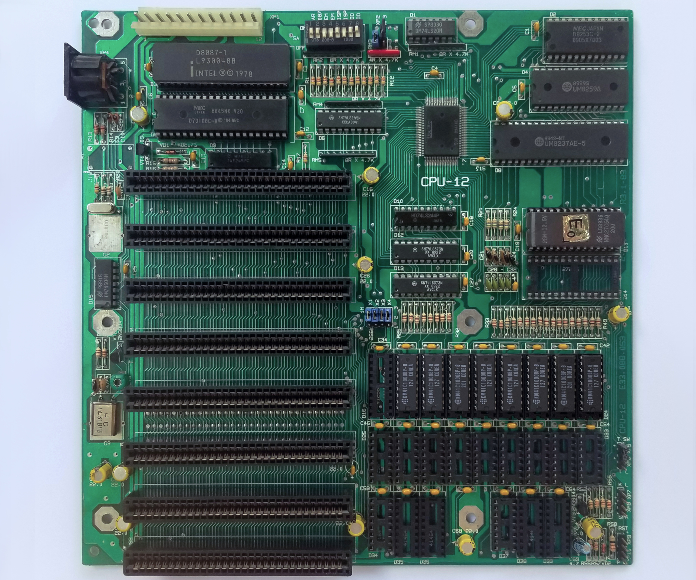

Pravetz CPU-12 also know as Juko ST (super turbo) - an 8088 Turbo XT motherboard based on Acer M1101 chipset.
It actually goes by several other names but CPU-12 is written on the silk screen of the one here so i go by that.
Apparently a popular hardware back in its day since it still shows-up frequently on ebay.
There are at least 2 or 3 models with different RAM sockets (types, placement, amount).
The one presented here should be the latest model of the series.
Installed 640Kb RAM, 80ns rated chips and an improvised crystal oscillator socket assembled from 2 female pints (the ones commonly used in machined 386 CPU sockets - not sure if they have specific name).

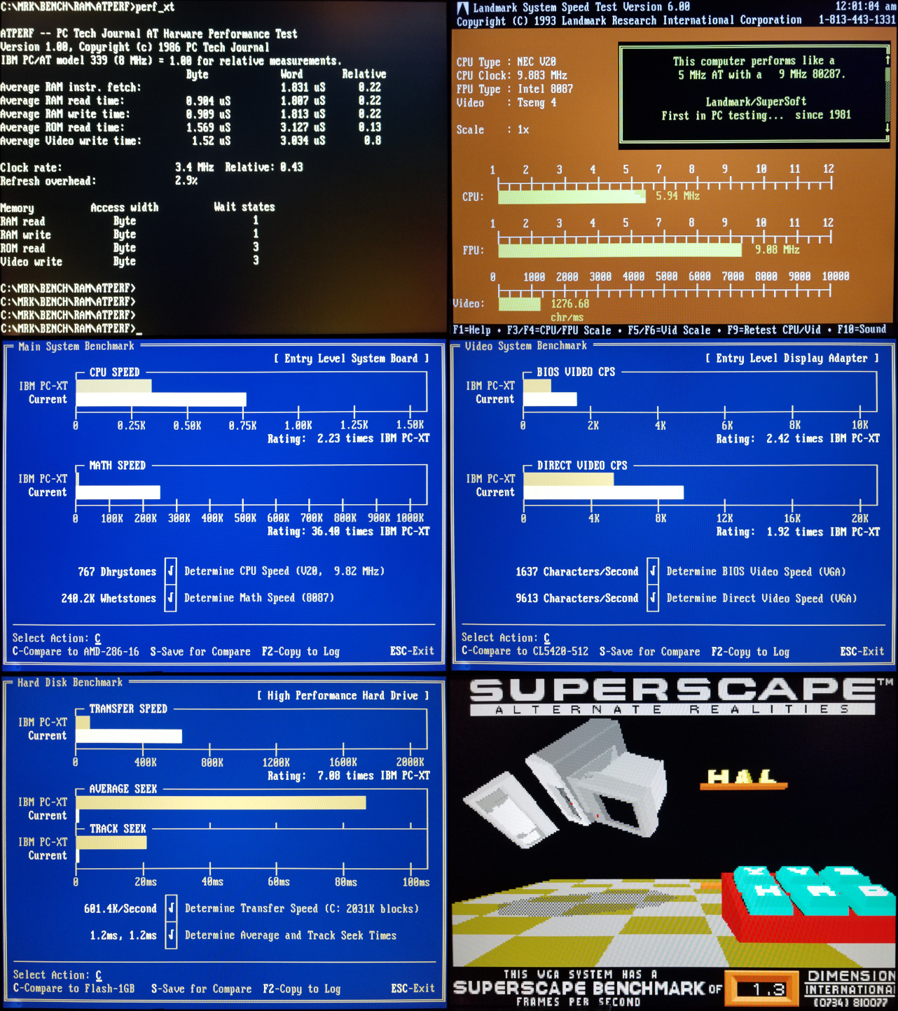

System works flawlessly at the default 10Mhz. Nothing much to add really.
Couple of screenshots from some of the tests with NEC V20 processor:

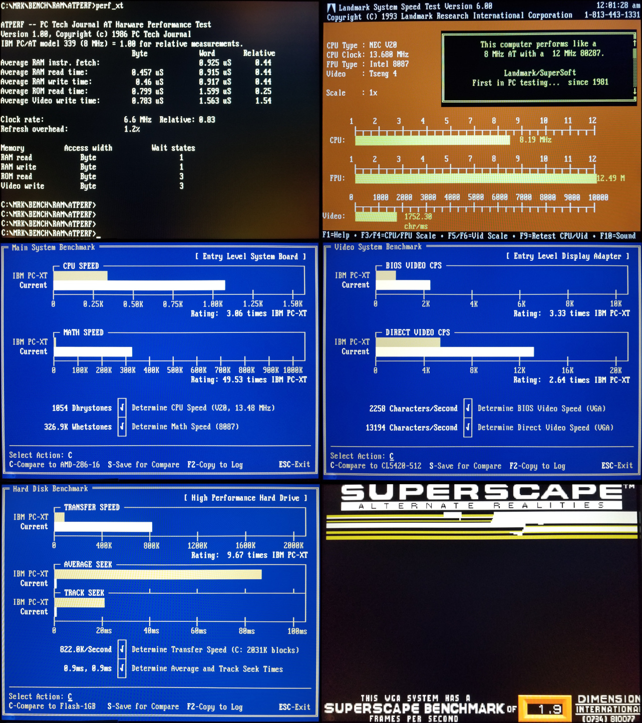

Overclocks pretty well to 13.5MHz with 16MHz rated NEC V20 CPU.
Can reach 15MHz without FPU but the system is not fully stable and of no interest for further testing.
Couple more screenshots with some of the test:
Notice the Superscape screen corruption.
No other apps/games exhibited such problems.
Past the 13.5MHz mark POST does not complete.
Around 15MHz frequency - no lights.

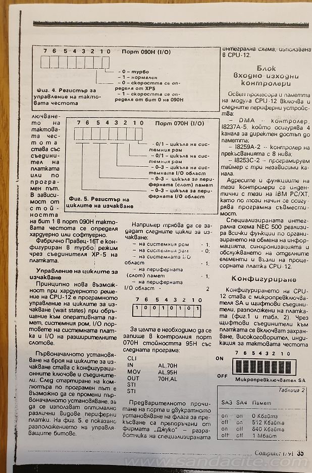

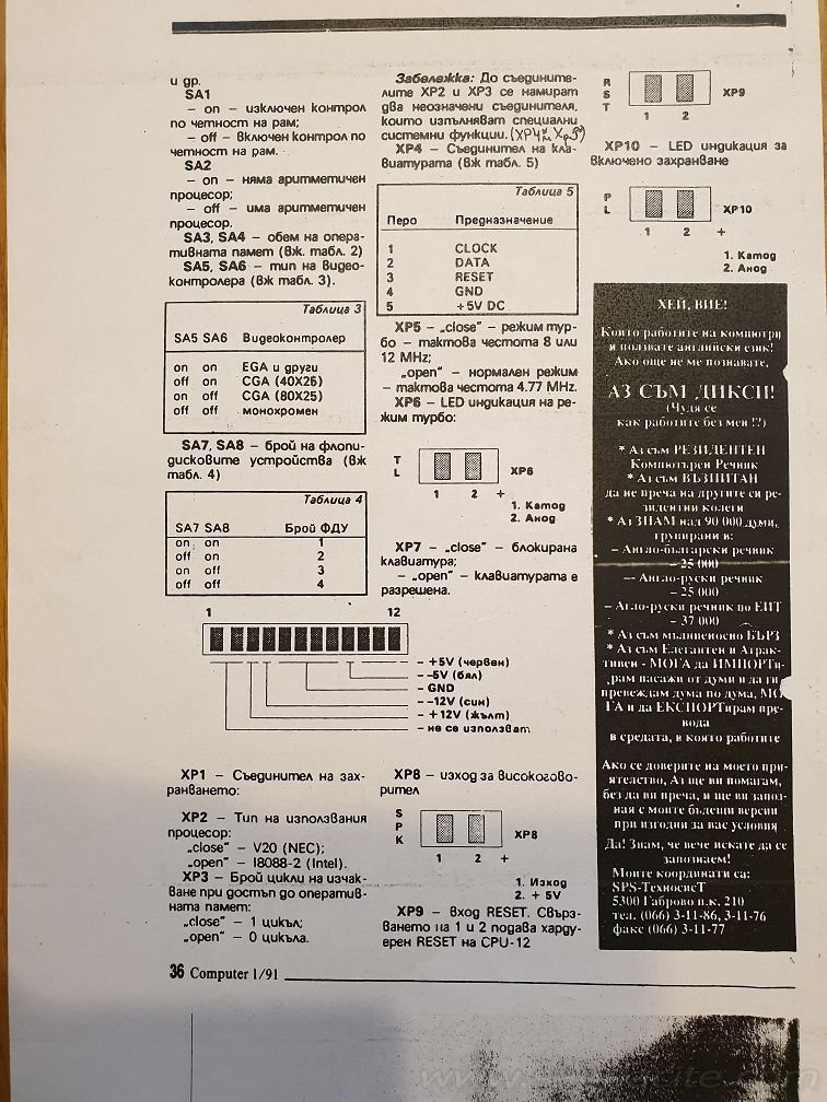

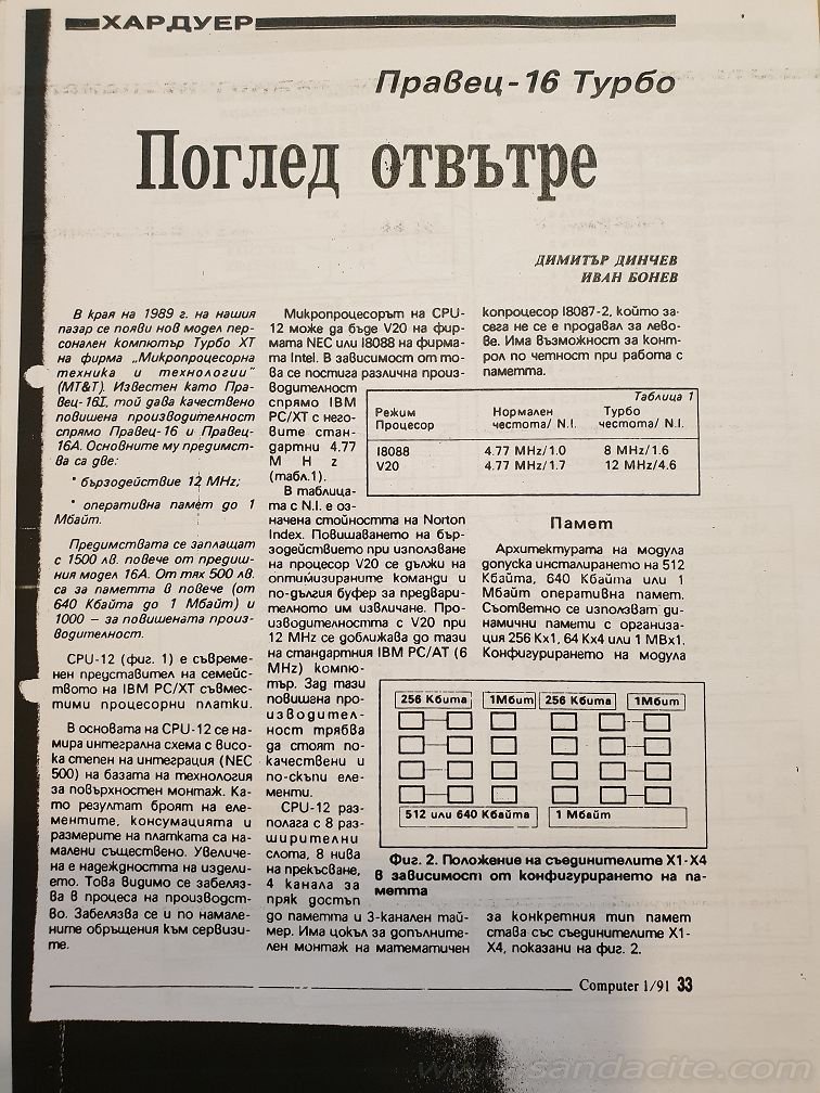

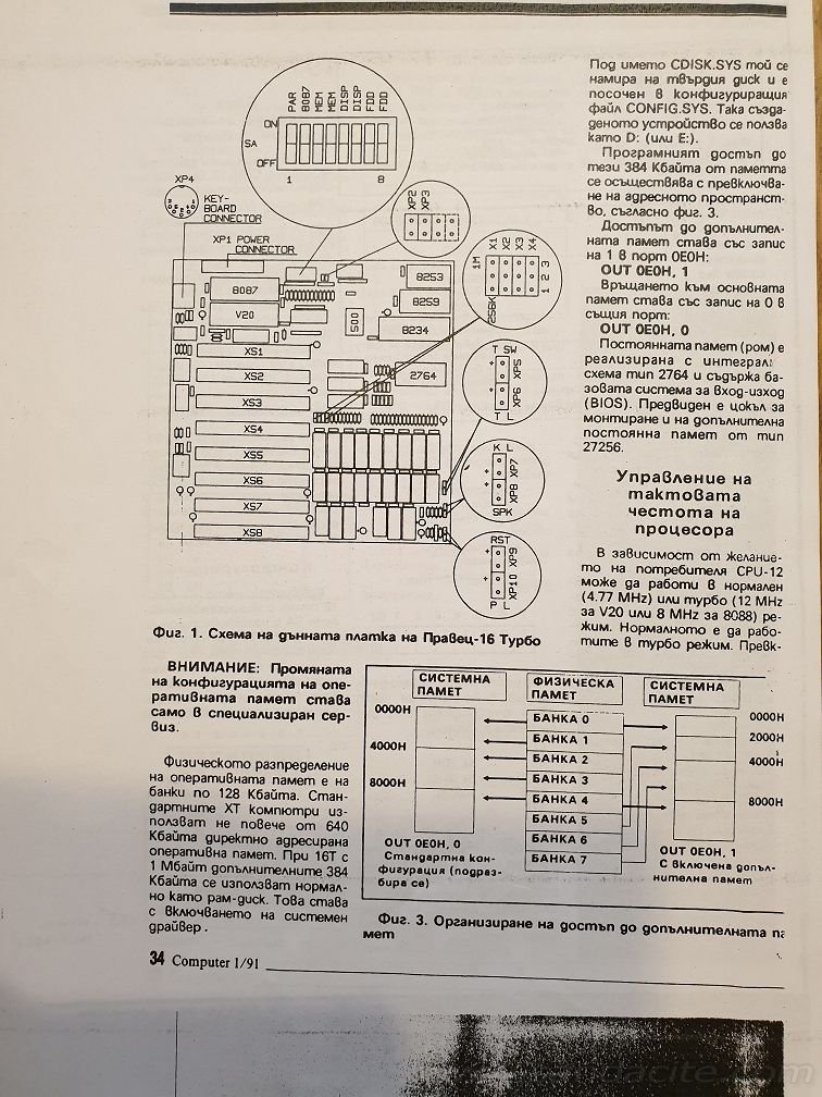

Somebody made a contribution in private related to this post.
Apparently these Juko ST boards were used in Bulgarian XT clonings in the 80ies and 90ies.
Some pages from the manual in native language:
Notes:
Normal/Turbo modes:
i8088: 4.77MHz / 8MHz
V20: 4.77MHz / 12MHz
RAM configurations:
Supports 256k x 1, 64k x 4, 1Mb x 1.
The diagram on page 1 shows the supported combinations.
Control switches:
SW1 - parity check on/off
SW2 - 8087 on/off
SW3/4 - on/on:0Kb, off/on:512Kb, on/off:640Kb, off/off:1Mb
SW5/6 - on/on:EGA, off/on:CGA(40x26), on/off:CGA(80:25), off/off:monochrome
SW7/8 - on/on:1, off/on:2, on/off:3, off/off:4
Jumpers:
XP2 - processor type - closed:V20, open:i8088-2
XP3 - RAM wait-states - closed:1, open:0
XP5 - turbo - closed:on, open:off
XP7 - keyboard - closed:locked, open:unlocked

Really liking the XT post here. These Juko boards are very nice. Neat and clean.
Although clock-for-clock not that impressive, it seems to turn up the heat at 13.5MHz. Pretty nice.
SuperScape seems really sensitive with regards to ISA timings and bus clock.

Unlike the NEST version the ISA bus is synchronous in Juko CPU-12 / ST, unfortunately.

Ah, I see! 13.5MHz ISA is impressive, to say the least. Can see why the NEST is a bit more “desirable” with respect to OC, but seems like the Juko and its 8088 can manage just fine.
