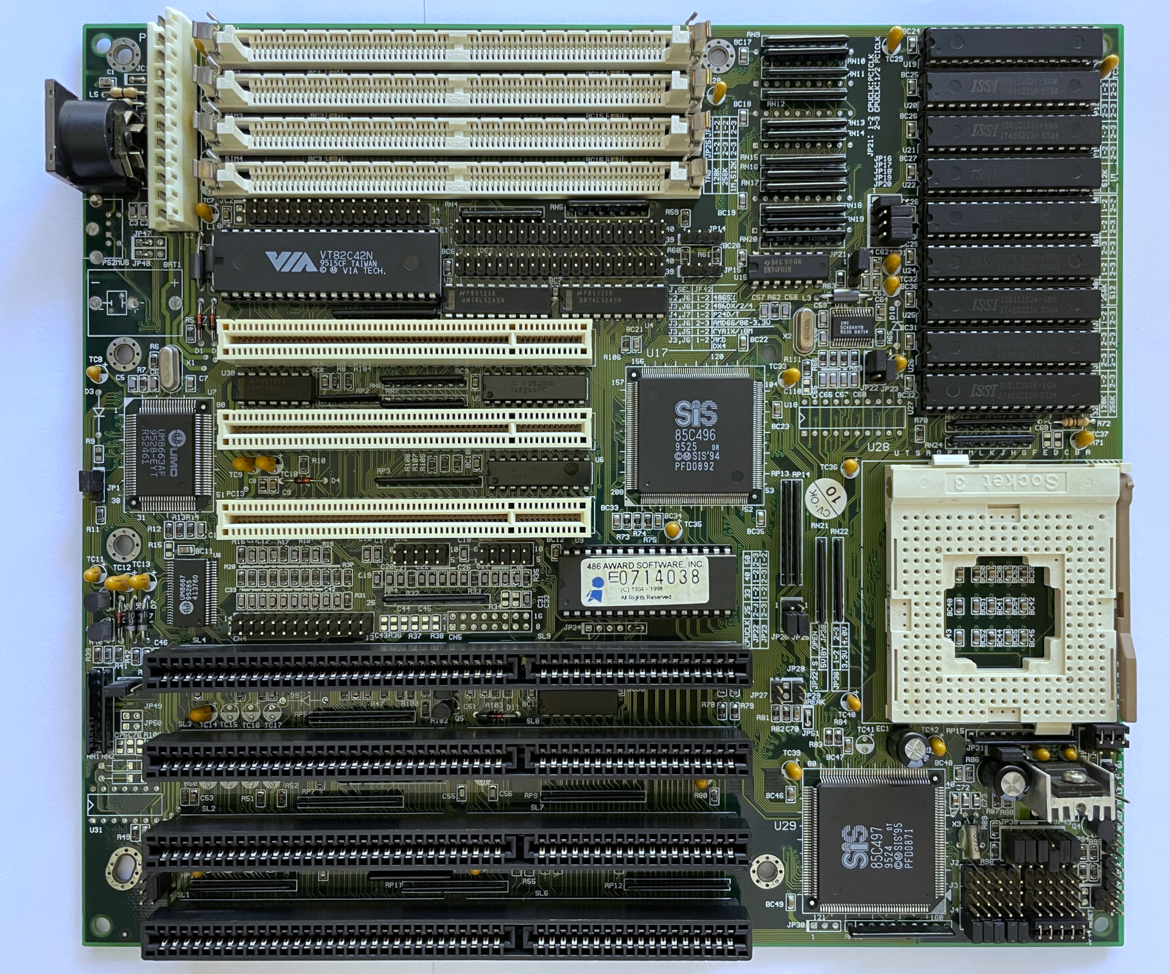

Chaintech 486SPM M104 (seems to be the latest revision), based on SiS 85C496, 85C497.
In crisp condition. Really well preserved.
Feels like slightly early design compared to the very late 486 motherboards.
No support for EDO RAM.
No 3.45V to CPU option.
Very easy to setup jumpers. Very nice.
There is not much more to add - very straightforward assembly.

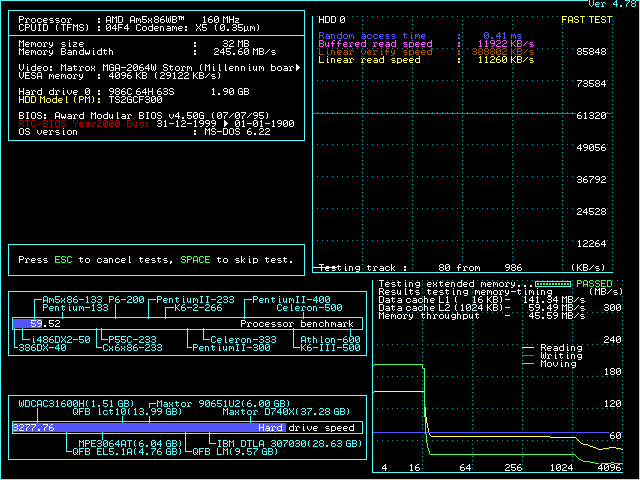

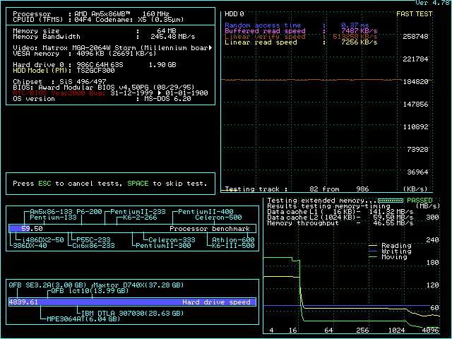

--- Am5x86 at 160MHz (4x40)

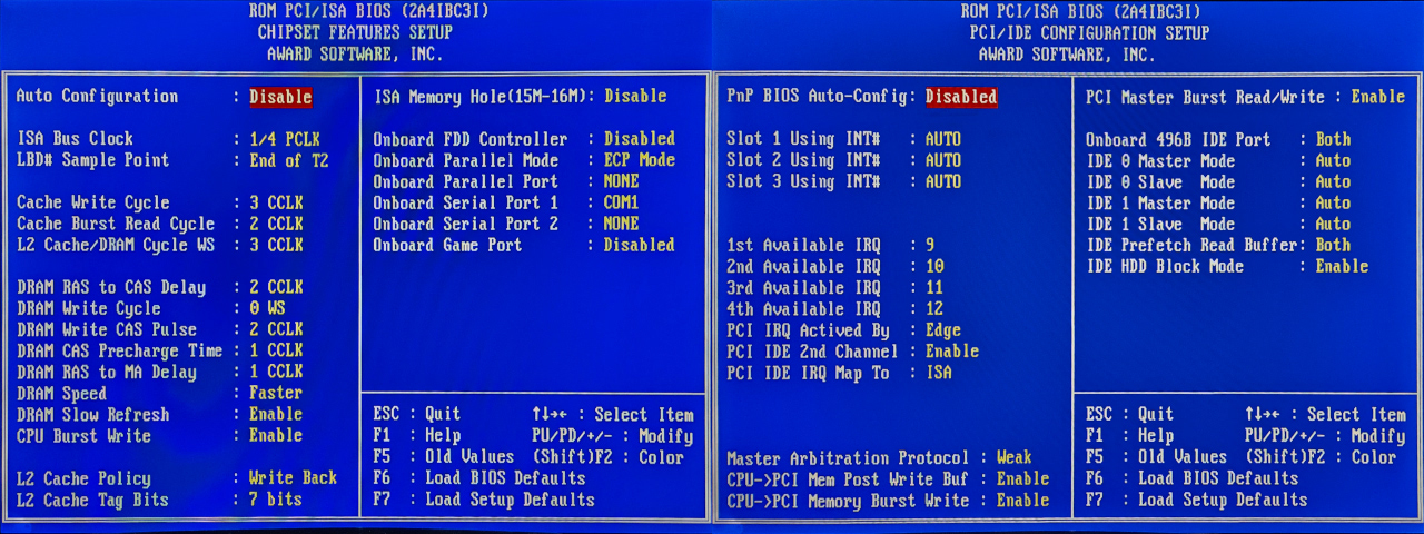

All BIOS settings on max.
PnP BIOS auto-config can hang the system during POST. Requires BIOS reset to resolve it.
Turning that parameter off resolves the problem entirely.

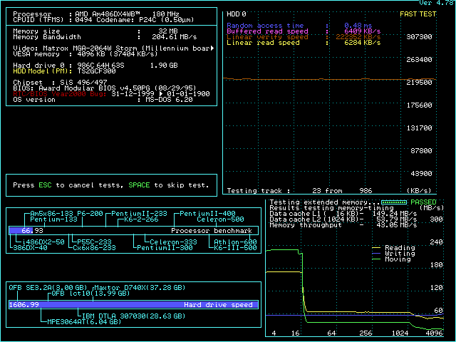

SpeedSys:
benchmark results
Not the fastest motherboard, but not bad either.

Different tests pass with arbitrary tighter BIOS settings and performance is really good, but had to slow things down for a fully stable system:
CACHE WRITE CYCLE = 3 CCLK (best is 2)
CACHE BURST READ CYCLE = 2 CCLK (best is 1)
DRAM WRITE CAS PULSE = 2 CCLK (best is 1)
DRAM SPEED = FASTER (best is FASTEST)
ISA BUS CLOCK = 1/4 PCLK (best is 1/3), the 1/3 option works, but not every key stroke is captured and processed, which is annoying
Speedsys numbers look nice.

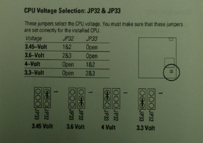

Asus VLI Revision 2.1 of the board offers jumpers for 3.3, 3.45, 3.6, 4, 5 volts.
With one of the CPUs i can get to 200 even at 3.3V but needs 5V Peltier.
The system can get in weird state no matter CPU voltages.
Didnt push Soyo 4SA2 at 200MHz past the brief confirmation that it works since you went over it.
I you feel there is a potential - we can give it a second chance.

Chicony CH-881A ver:1.0, based on UM8886F / UM8881F chipset.
Still in great condition:
Convoluted jumpers setup.
Was not able to find which jumper forces WB mode for Am5x86 processors.
Used the simple adapter from this post to enforce it.
BIOS offers settings for L1/L2 cache modes, but the L1 one does nothing.
Not pretentious about level 2 cache chips.
Supports EDO RAM.
Very picky about memory modules for tightest BIOS timings.
Using 2x16Mb selected sticks in slots 3 and 4.
Unstable with bigger amount of RAM (considering tightest BIOS timings).
Used Promise EIDE2300 PLUS VLB adapter.
Voodoo 3 graphics cards don't work with this board.
--- Am5x86 @160MHz (4x40)
Ark1000VL requires 1WS for stable system.
SpeedSys:
benchmark results
Not bad, but not great either.
--- Am5x86 @180MHz (3x60) and $200MHz (3x66)
Cannot complete POST no matter how hard i tried.
Disappointing.
--- Am5x86 @200MHz (4x50)
For DOS all BIOS settings can be on max, but for Windows and some of the more complex offline computation tests the next settings must be adjusted:
ISA BUS CLOCK OPTION = PCICLK/4 (best is PCICLK/2 )
L2 CACHE WAIT STATES = 3-2-2-2 (best is 2-1-1-1)
DRAM READ WAIT STATES = 1 (best is 0)
DRAM WRITE WAIT STATES = 1 (best is 0)
HOST TO PCI WRITE = 1WS (best is 0WS)
PCI BUS DIVIDER = 1:1/2 (best is 1:1)
benchmark results
Again, not the best results out there, but not too bad really.

Asus VLI Revision 2.1 of the board offers jumpers for 3.3, 3.45, 3.6, 4, 5 volts. With one of the CPUs i can get to 200 even at […]
Hi,
I only have a VLI Revision 2.0, but still .....
Where do you have a jumper for 5 volts???
Reply 1619 of 2381, by pshipkov
Revision 2.0 of of the Asus VLI motherboard does not have these jumpers. Only 2.1.
