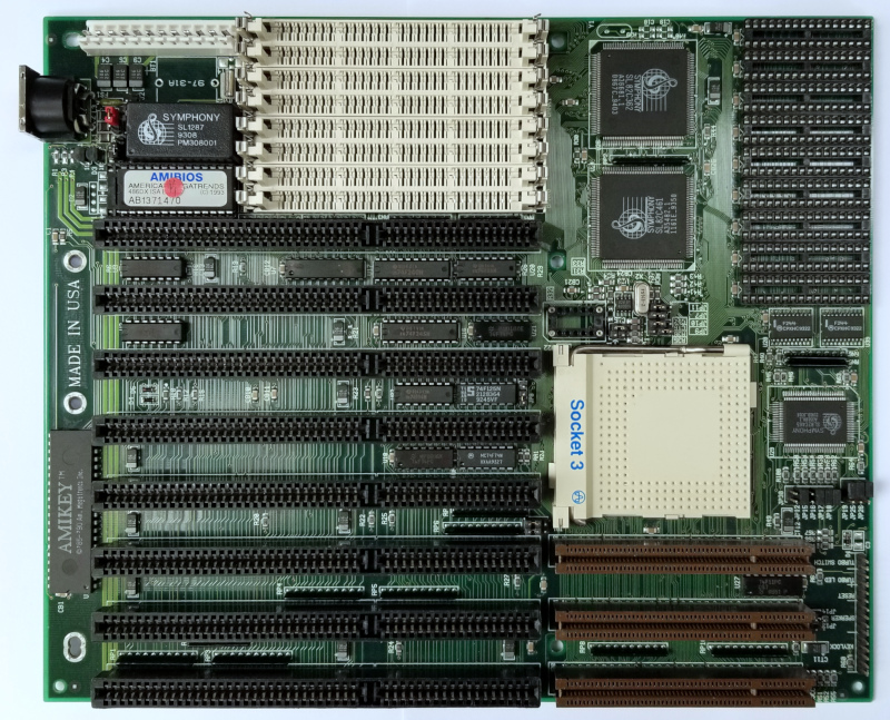

The last of the planned 1Mb level 2 cache 486 motherboards.
Young Micro Systems VEGA MB-SYP243LV-V12 based on Symphony Labs Haydn II chipset (SL82C632, SL82C461, SL82C465).
There was great level of interest around this motherboard for several reasons:
- Haydn II (SL82C460) is the fastest chipset for 386 class processors. By far.
- It is also the fastest chipset for early 486 ISA motherboards - better than anything SiS, UMC, VIA, OPTi were able to put at the time.
- But the next variant - Wagner 82C490 was nothing to brag about, especially when it comes down to VLB support. Offerings from SiS (such as 471) and UMC were much better.
So i wondered if the 460 variant coupled with VLB support will be a silver bullet for 486 VLB systems ?
Looking up the motherboard's manual was not inspirational.
Support only 25/33/50 MHz base frequencies (with the craziest jumper setup i have seen so far to switch between them).
No voltage regulator on board, so 5V only to CPU.
No mention of later 486 CPUs and Overdrives.
30-pin SIMM memory modules only.
Also, few more motherboards from Young Micro Systems passed through here already and none of them were good.
There are crystal oscillators sockets next to the clock generator which made me wonder if i can augment the frequencies through them. Small chance, but worth the try.
Turned-out unsuccessful. Oscillators in the range of 14.xxx to 30 MHz are handled in the same way producing the predefined 25/33/50 MHz frequencies. Input signal above 30MHz results in no lights.
That is with the 2-pin passive oscillator.
There is a 4-pin full can socket as well but oscillators plugged into it appear to do nothing.
Didn't spend much more time to figure it out since the outcome from the 2-pin oscillators already proved unsuccessful at tampering the base frequencies.
BIOS is very basic. 2 parameters only for tweaking performance- ISA bus clock divider and DRAM wait states.
Both set to their optimum values.
Tried with microcodes from DTK PEM-4036Y BIOS - no observable difference in behavior.
Wagner 82C490 BIOSes don't work with this board.
L1 cache for Am5x86 processors is set to WT by default. No jumper to control that. Used interposer to adjust it. Performance improves with that.
Not picky at all about level 2 cache chips. Which is great.
Perhaps the biggest bummer - no VLB EISA controllers work with the motherboard/chipset. Fell-back on ISA IDE.

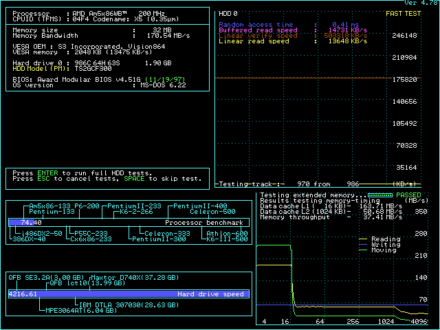

Ok, spent today some time to give the Asus VLI-486SX2GX4 motherboard a real good try at 200MHz (4x50).
Achieved stable system. Captured a video with some of the test. It is kind of long.
Ark1000VL is unstable in this configuration. Used S3 Trio64 instead.
Had to lower 3 BIOS parameters for completely stable system:
DRAM SPEED = SLOWER (best is FASTEST)
CACHE READ CYCLE = 2T (best is 1T)
LOCAL BUS READY = SYNCHRONIZE (best is ASYNCHRONOUS)
Speedsys:
The usual tests, with two failing.
Doom technically works, but player does not follow the expected path.
LightWave3D crashes hard and often takes Windows down.
benchmark results
Did a much broader test range with other apps, C compilers, etc. The system feels very stable despite the two failing tests.
But fails are fails = hard to say it is stable-stable at this point.
Can run with DRAM SPEED = FASTEST, but stability is badly compromised.
In a successful run, Quake 1 test produces 21.5 fps.

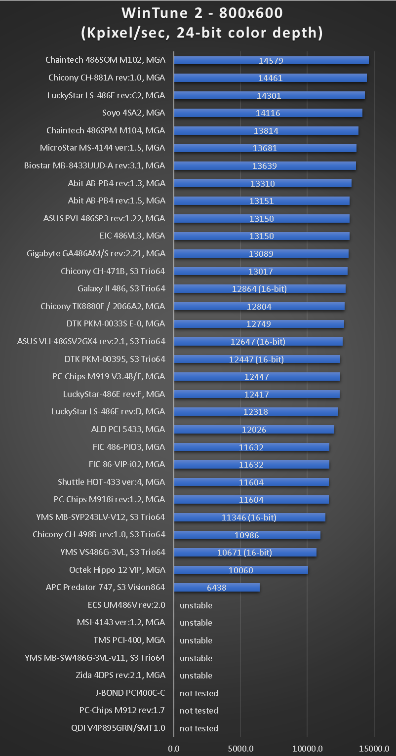

Reply 1634 of 2351, by CoffeeOne
pshipkov wrote on 2023-01-16, 08:12:
Ok, spent today some time to give the Asus VLI-486SX2GX4 motherboard a real good try at 200MHz (4x50). Achieved fully stable sys […]
Achieved fully stable system. Captured a video with some of the test. It is kind of long.
Speedsys:
The usual tests:
Wolf3D: 138 fps
PC Player: 29.8 fps
Quake 1: 20.2 fps
3D Studio: 103 sec (1:43)
WinTune 2: 14579 KPixels/sec
Can run the system with DRAM SPEED = FASTEST, but stability is compromised.

Decided to consolidate the captured performance metrics for all tested motherboards.
Goal is to improve consistency and readability.
Data will be split in few separate posts based on hardware class - 286, 386, 486 (160/180/200MHz).
The original posts will be edited accordingly.
Starting with 486 class motherboards at 160MHz.
(charts will be updated if new items get examined later)
486 class motherboards with AMD Am5x86 processor running at 160MHz (4x40)
retro bits and bytes
