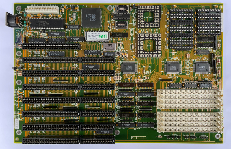

ABit AB-FS3 based on SiS Rabbit - 85C310/320/330
On multiple occasions Feipoa spoke highly of his Chaintech 340SC motherboard in combination with IBM BL3 and TI 486SXL2 processors, so i wanted to give that stuff a try.
I actually checked long time ago another board based on the same chipset - Asus 386/33-64k, but it was limited to 64Kb level 2 cache, 8Mb RAM and rudimentary BIOS. Also, at that time AMD 386DX-40 was the best processor i had.
The Asus board was not that bad really, but nothing to brag about.
A better assembly was needed.
Battery leak destroyed several traces in the upper left corner.
Previous owner did some repairs, but also caused additional damage.
Improved on that.
Two clock oscillator sockets. One for FSB another for async Intel 387 FPU. Not applicable for my use case - Cyrix FasMath, ULSI DX/DLC at max frequency.
No lights past 50MHz FSB (100MHz oscillator).
BIOS has few options only.
Used Chaintech 340SC BIOS from Feipoa.

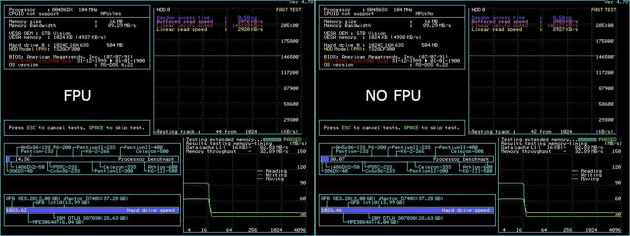

Used STB Nitro video card based on Cirrus Logic GD-5434, 2Mb.
--- IBM BL3 at 90MHz (2x45), ISA bus at 12.5 MHz
System cannot be fully stable at 50MHz FSB.
Stepped down to 45MHz for complete stability.
All BIOS settings on max, except:
BUS CLOCK SELECT = SCLK/8 (best is /3)
EXTERNAL CACHE = DISABLED
Encountered 1-2 sporadic disk write access issues, which hint at potential problem, but inconclusive.
Most of the time finding the right IDE controller solves this. So, i am willing to conclude complete stability.
Despite level 2 cache is disabled, performance is still great.
SpeedSys confirms pretty good system memory access times, which explains it.
ULSI DX/DLC is faster than Cyrix in Quake 1.
FasMath hangs in the LightWave3D test, used the ULSI FPU.
FasMath used for PC Player Benchmark and 3D Studio R3.
Number 2 in PC Player benchmark, that is at 90MHz.
Sharing the first spot with DTK PEM-4036Y in Quake 1. <- !!!
Number 3 in the complex offline graphics tests.
On the slow side in the rest of the tests.
--- TI 486SXL2 at 80MHz (2x40), ISA at 13.33MHz
I am still fresh with the SXL2 adapter stuff.
My only SXL2-66 CPU does not scale past 80MHz.
System is not stable - it is the CPU itself.
SpeedSys hangs, which is often the case with SXL2 chips.
Few numbers for reference:
Wolf3D: 42 fps
Superscape: 33.2 fps
PC Player: 10.5 fps
Doom: 16.4 fps
The rest of the tests don't complete.

--- AMD 386DX at 50MHz, ISA at 12.5MHz
All BIOS settings on max.
System is completely stable.
Nothing more to add really.
Below average performance.
benchmark results
Great potential in this assembly.
Unfortunately there is this trouble with level 1/2 caches for BL3/SXL2 processors when FPU is present.
If i set C000-DFFF memory range to not cacheable then all is good, but performance drops a lot in this case which defeats the purpose.
There is a dedicated option in the BIOS for that.
Any ideas ?

Were you able to get 80 MHz stable? If so, at what minimal voltage?
pshipkov wrote on 2023-03-25, 21:46:
If i turn-off C000-DFFF are is not cacheable all is good, but performance drops a lot in this case which defeats the purpose.
Typo to the extent that I don't understand what is being conveyed. This looks like a range in RAM to, for example, shadow your SCSI card's BIOS.
Reply 1747 of 2513, by pshipkov
Fixed the 2x45 and the sentences at the end about non-cached memory range.
SXL2 at 2x40 is stable at max voltage and with at least 5V Peltier.
Even with 12V Peltier the system is unstable.
Tried other motherboards - same result.

Isn't C000-DFFF the reserved region of memory for expansion ROMs and if so, why would not caching this region kill performance? When I run an SXL, for example, I usually set the 640-1024K as non-cacheable (via cyrix.exe) to avoid trouble in Windows.
Too bad about your sole SXL2 being a lemon. I guess you should have grabbed one or two from CPUshack. Are you able to at least run 75 MHz at 4 V?
Reply 1749 of 2513, by pshipkov
This address space is shadow memory.
C000-C800 is usually VGA BIOS, but the 16Kb segments are chipset dependent, to a point at least.
Don't understand why this was a problem for L1/L2 caches to work simultaneously.
SiS Rabbit chipset needs memory interleave for extra performance, you are using 4x4MB modules for total of 16MB, is this correct?
Then otherwise try 8x 1MB for 8MB or 8x 4MB for 32MB and retest the performance, in other words fill all the memory module slots.

Was not aware about that.
Where did you learn it ?
I suppose this will help SXL2 and 386DX chips.
BL3 can cache 16Mb only. Bigger buffer than that and perf drops massively.
8Mb is not interesting. Omitting it right away.
I have the board back on the test bench.
First thing will be to check one 2 ram banks.

Spent more time today with the ABit Ab-FS3 (SiS Rabbit) motherboard from few posts above.
Single vs double banked RAM - similar to what Feipoa said above, there is no performance difference between the two. Checked graphics, offline compute, local storage i/o. DOS and WIN.
Level 2 cache instabilities:
Cycled quite a bit on that.
Initially i thought it is related to FPUs, but it is the assembly itself. It cannot handle level 2 cache at 50MHz FSB. Even with most conservative timings.
It is not the cache chips. They are curated set for 60/66MHz + tightest timings. I use them for 486 overclocking activities.
Apparently Chaintech's assembly based on this chipset is much more successful.

pshipkov wrote on 2023-03-27, 06:25:
Does everything work just fine at 45 Mhz or less FSB? If so, it might be best to start testing with lower clocked crystals oscillators, then up the frequency once a slow base frequency is working well.
Reply 1756 of 2513, by pshipkov
That was quantified carefully.
Level 2 cache works well at 40 and 45 mhz, but 45mhz + level cache is slower than 50mhz without level 2 cache.
Apparently ram access is pretty good.
Also, the level 1 cache of bl3 and sxl2 help a lot to mitigate the issue.
This is evident by the shared top Quake 1 score.

It is slower because you have to add some wait states to make the system stable or slower because the board or BIOS is doing something wonky?
Reply 1758 of 2513, by pshipkov
Both 45 and 50 MHz run with all BIOS settings on max, but without level 2 cache.
The extra 5MHz is enough to outrun the 40MHz + level 2 cache.
50MHz is unstable no matter what.
