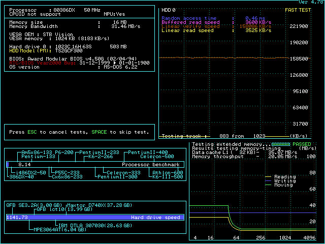

1st micro optimization: Get maximum of free dos memory (without using EMM386.EXE!), I can write an extra thread about that. BUT: Zero consequences for Doom and Wolf3D (so having 580000 bytes free or 590000 or 620000 is the same).
2nd micro optimization, but his one had an effect: Believe it or not, somehow diskspeed plays a tiny role. I know have a QD6580W controller with a speedup given by XTIDE Rom. XTIDE natively supportd QD6500 and 6580.
With my other UMC controller I had like ~4000 kBytes/s buffered read and linear read, now it is ~7000/6000. Then also smartdrv plays a role. For my setup (which is QD6580 controller + XTIDE ROM + Transcend compact flash card) smartdrv made it slower 😁 But all in all the effect of the diskspeed is like one fps only.
Having that written, I am quite sure, you know all that already.
The disk performance should be optimal for you already, because I remember you get something like 10000kBytes/sec or more.

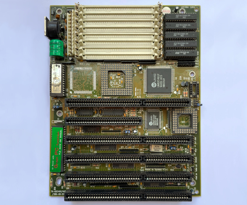

OK, so additional to the changed JP16:
You have here JP27 different (wrong), should be 2-3 for 1MB cache, on the picture it is 1-2.
And HW trap:
JP5, JP6 should be 1-2, 1-2 for Am5x86, but on the picture there is 2-3, 1-2 which means old Cyrix.
So three deviations: JP16, JP27 and JP5.
Reply 1788 of 2154, by pshipkov
Notice that the first picture shows revision 2.1 of the board with 1Mb L2 cache size, so JP27 is in position 2-3, while the second picture shows revision 2.0 of the board with only 256Kb L2 cache size, so JP27 is in position 1-2.
About hardware trap - the most recent manual lists 5x86 as JP5 2-3 and JP6 1-2, unless i don't understand well the messy abbreviations of the CPUs and the 5x86 is not referred to Am5x86 but for Cyrix 5x86. Thinking about it now - that's probably it.
But also, i remember trying different configurations of these two jumpers without obvious difference.
Do you see a difference on your side ?
retro bits and bytes
Reply 1789 of 2154, by CoffeeOne
pshipkov wrote on 2023-04-14, 06:45:
Notice that the first picture shows revision 2.1 of the board with 1Mb L2 cache size, so JP27 is in position 2-3, while the seco […]
Hello,
I believe that all jumpers are identically between 2.0 and 2.1 (only the voltage selection is different at the 2.1: The 2.0 only has 3.45V and 3.6V, the 2.1 has 3.3, 3.45, 3.6, 4.0).
93.04 KiB
1584 views
Why do you think JP27 should be on position 1.2?
About the hardware trap: I never used 2-3 and 1-2, because it is only for (non Intel S compatible) Cyrix. And for the non Intel S compatible AMD.
I don't have such CPUs.
Both Cyrix 5x86 and Am5x86 should use 1-2, 1-2. As far as I understood, it is about telling the mainboard which CPU type it is. which is important for working L1 write back cache.
Cyrix (old type) L1 WB can be controlled by Bios. Intel and AMD L1 write back cache cannot be controlled by Bios / software. Both Am5x86 and Cyrix 5x86 use the "new intel way".
Ok, but obviously the write back cache works also with the other setting. Maybe I should try it 😁
Reply 1790 of 2154, by pshipkov
J27
because one of the pcitures shows 256Kb level 2 cache configuration.
check the first sentence in my previous post.
Btw, i checked the HW trap and in reality jumpers are set properly to 1-2 position.
Not sure why they were off when snapped the photos back then.

Several years ago i examined Migitronics TK-82C491/386-4N-D02C, based on the highly integrated UMC UM82C491F chipset.
Back then the best 386 CPU i had was AMD 386DX-40. Also, even the board had wiring for crystal oscillators, it didn't cross my mind to remove the 80MHz limited clock generator and see where the overclocking limit is.
So, i have been curious since then how UM82C491F does with SXL2 / BL3 processors and if it does better than UM82C481/482 based boards.
Not far ago i stumbled upon ABit AB-AK3 rev.0.2 which is very similar to the Magitroncs one, but it died shortly after i started testing it with the more advanced CPUs.
Notes in the same thread linked above.
Finally obtained a working board that allowed me to answer these questions.
Magitronics TK-82C491/386-4N-D04
It is a slightly newer version of the 386-4N-D02C model - UM82C493F replaces bunch of individual ICs.
Very cool green sticker with broken English.
Minor battery leak that was taken care of immediately.
Removed the 80MHz limited clock generator, soldered crystal oscillator socket.
Removed the surface mounted AMD 386DX-40 CPU, installed PGA-132 socket.
Upper overclock limit is 45MHz. No lights past that.
Very stable at up to 45MHz, with one strange exception.
For some reason Windows often hangs with fast graphics cards such as STB Nitro or ET4000/W32i and installed driver with resolution above 640x480 + high/true color depths.
Especially with SXL2 and BL3 CPUs in clock-doubled mode.
Tried hard to figure out what is causing it, but without success.
I have to slow the system down to 33MHz FSB and 640x480 screen resolution for things to be stable.
I didn't have these problems with the 386-4N-D02C version of the board.
It is worth noting that in my brief testing ABit AB-AK3 rev.0.2 was able to go up to 55MHz, but anything above 40MHz was highly unstable.
So, it looks like integration makes quite a difference for these late compact assemblies, even they are based on the same chipset and have almost identical layout.
The AWARD BIOS is 486-like.
Lots of options.
It is faster than the Mr.BIOS microcodes for this chipset.
For the tests used trusted 128Kb 12ns rated ISSI level 2 cache chips and 50ns rated 16Mb RAM modules (4x4Mb). Funnily enough the board didn't like another set of trusted L2 cache chips from UMC.
Used STB Nitro video card with 2Mb RAM (Cirrus Logic GD-5434).
--- AMD 386DX at 45MHz, ISA bus at 11.25MHz
All BIOS settings on max, except:
AT BUS CLOCK = CLK/4 (best is /2)
Speedsys screen with FPU.
Very stable in DOS, unstable in Windows with driver with resolution above 640x480 + high/true color depths.
Intermediate performance.
Nothing more to add really.
