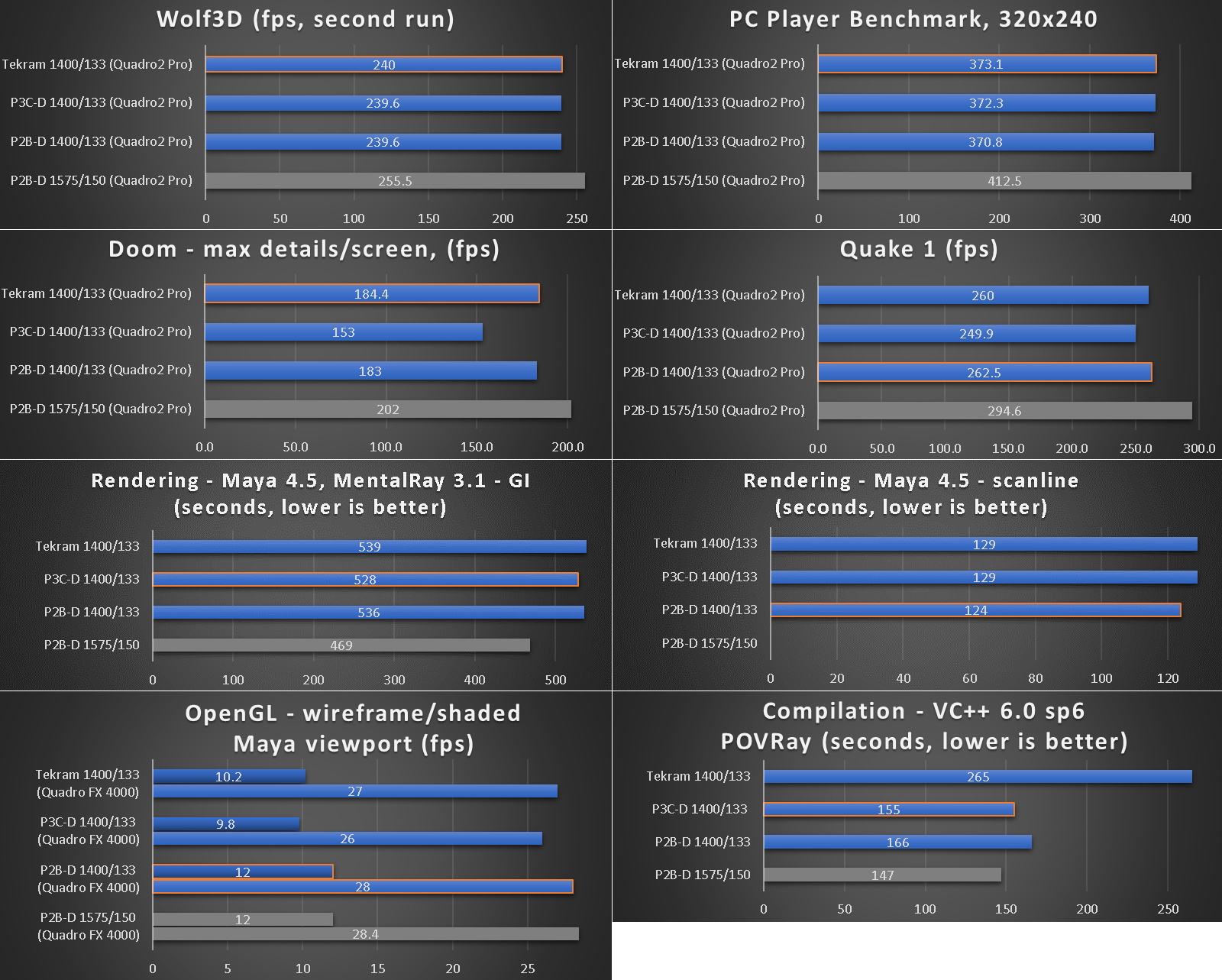

Tekram P6B40D-A5 based on Intel 440BX chipset.
Early in the thread i went through multiple dual slot 1 and 2 motherboards while on a mission to build an early Y2K workstation.
Most boards got rejected early in the process because straightforward reasons like no Tualatin-S support and/or limited clock generators without options for modding.
But the one in question here was left unsolved.
Great looking motherboard.
Clock generator can provide up to 83/133MHz . Adjustable through BIOS (options for 100, 103, 112, 133 MHz), which is nice.
Latest available BIOS is already in place.
Initially the board didn't light with Tualatin-S CPUs.
At some point i realized that it was the on-board clock multiplier jumpers.
They were set for 8x.
Once i set them to some lower multiplier vlaue, everything started working.
This is unusual, since on all other boards when CPUs with locked multipliers are inserted the on-board jumpers get ignored.
Had to curate the RAM modules quite a bit to reach tightest BIOS timings.
When using 133 MHz FSB the board may not light-up after reset. Requires power off/on.
Things were fine in DOS and Windows 95, but NT4 was tripping when additional PCI extension cards were present.
In those cases the video cards may not get recognized. Stepping down to 112MHz FSB fixed the problems.
Finally, after quite a bit of effort i was able to make it work at 133MHz FSB.
While everything functioned properly i have this lingering feeling that the system is not fully stable.
Tested with dual Tualatin-S 1400/133 CPUs, 768Mb RAM, Quadro2 Pro for DOS and Quadro FX 4000 for Windows, CF card.
All BIOS settings on max, except:
VIDEO RAM CACHEABLE = DISABLED, otherwise POST never completes.
On par with P2B-D and P3C-D, but much more fussy at 1400/133 compared to them.

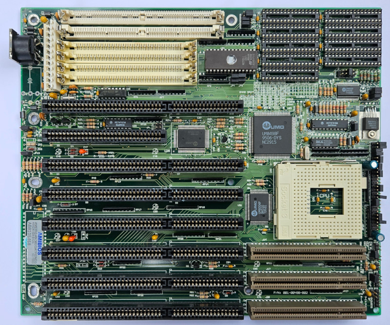

After the impressive outcome with Chicony CH-471B, the very good overall characteristics of CH-881A, and the not too shabby TK8880F / 2066A2 at 160MHz, the brand name caught my attention.
Wanted to check more of their classic ISA/VLB motherboards, preferably ones based on UMC chipsets. So, here we go ...
Chicony CH-498B revision 3.0 based UMC's UM8498F
Still in perfect condition.
Supports up to 1Mb level 2 cache and at least 64Mb FPM RAM.
Tried with 2x32Mb 72-pin modules. Worked right away.
I don't have bigger than 32Mb FPM modules. Didn't fill the 32-pin slots in addition to that. Potential limit is probably 80Mb (64+16).
Clock generator supports 60/66MHz.
There is wiring for 3 and 5 volts to CPU only.
Windowed AMI BIOS. Meh.
Couldn't find any reference to this model online. This was concerning initially because the board refused to complete POST with Am5x86 CPUs.
But that first test was late on the day of arrival. On the next morning - no problem. Another case of stale ancient electronics at play.
L2 cache and clockgen tables are printed on the silkscreen. Quickly figured out the VLB wait-state jumpers, but the rest of the jumpers next to the CPU socket are a mystery. They don't seem to do anything. Blindly changing some of them results in no observable difference.
Tested with 32Mb FPM RAM (EDO is not supported).
1Mb level 2 cache. Board is not very picky, so i was able to quickly find a good set of chips.

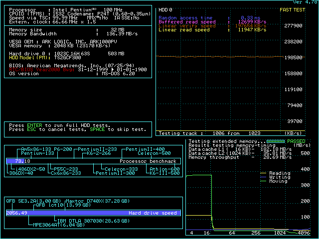

This didn't go well.
System is very unstable no matter what.
Was able to capture a SpeedSys screen at least.
Location of CPU socket is right next to the VLB slots which is a problem for Peltier + big fan for active cooling. Used standard ISA IDE controller.
--- Am5x86 at 200MHz (3x60)
No lights entirely.
--- Intel P24T (2.5x40) (POD100)
System is unstable no matter what, but works just fine at 2.5x33MHz (POD83) which is not interesting for me to test.
All in all, not a bad motherboard.
Mediocre at 160MHz.
Great at 180MHz - getting close to PC-Chips M919 v3.4B/F, which the highest mark in this category.
Unfortunately the assembly does not scale well and caps at 3x60. This was disappointing.
Even more disappointing is its instability with POD100.

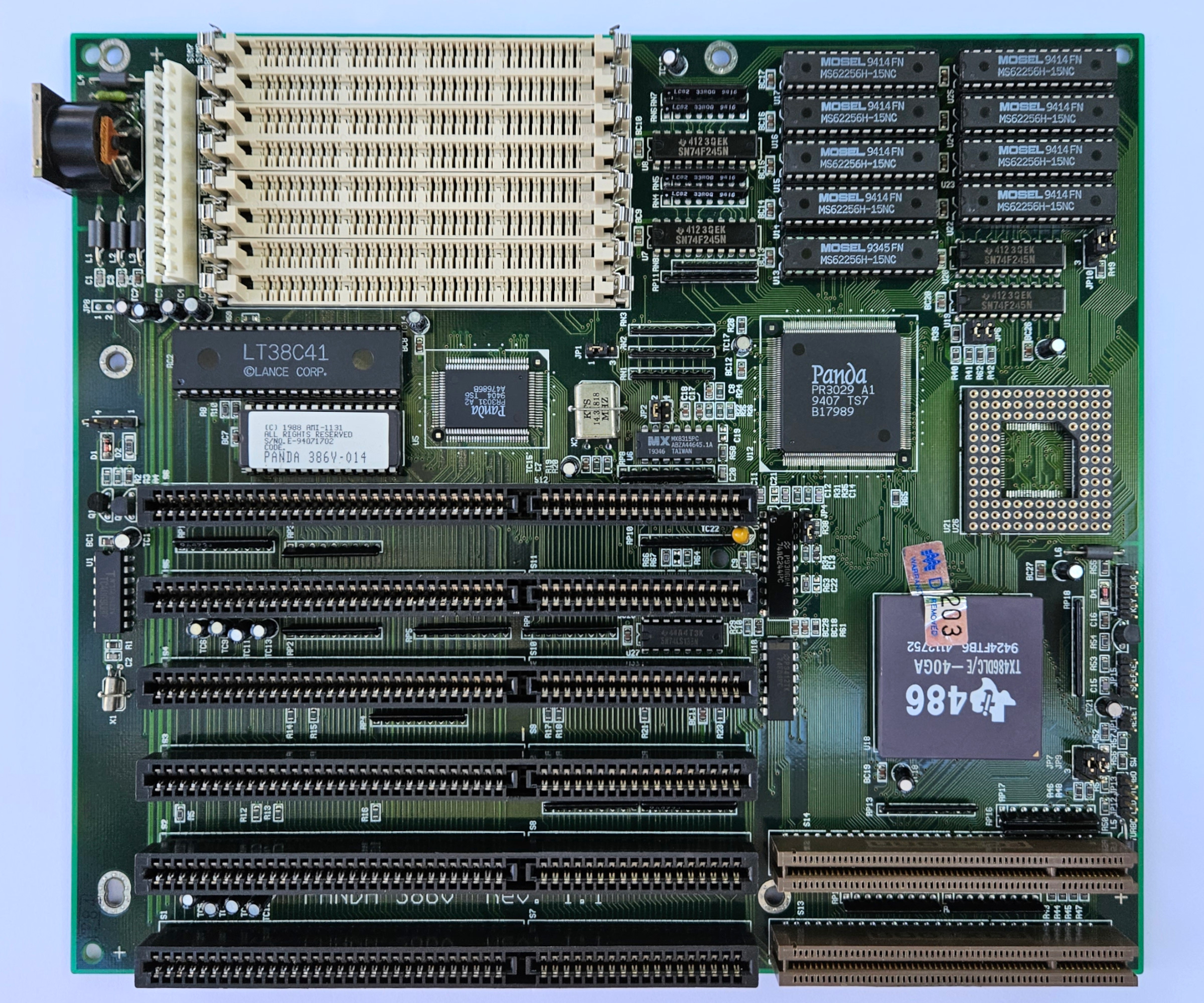

ECS Panda 386V rev 1.1 (also known as Daewoo AL486V-D) based on ALi M1429 A1, M1432 A2, relabeled to Panda PR3029 A1, PR3031 A2.
Clearly a new old stock.
I felt guilty removing the CPU with that sticker on it, but was very careful, so after completed the examination and testing the CPU went back in and the sticker looked like it was never touched.
Jumper setup is very straightforward.
There are dedicated jumpers for several different CPU types, but as far as i can tell they don't make any difference.
Clock generator goes up to 40MHz only.

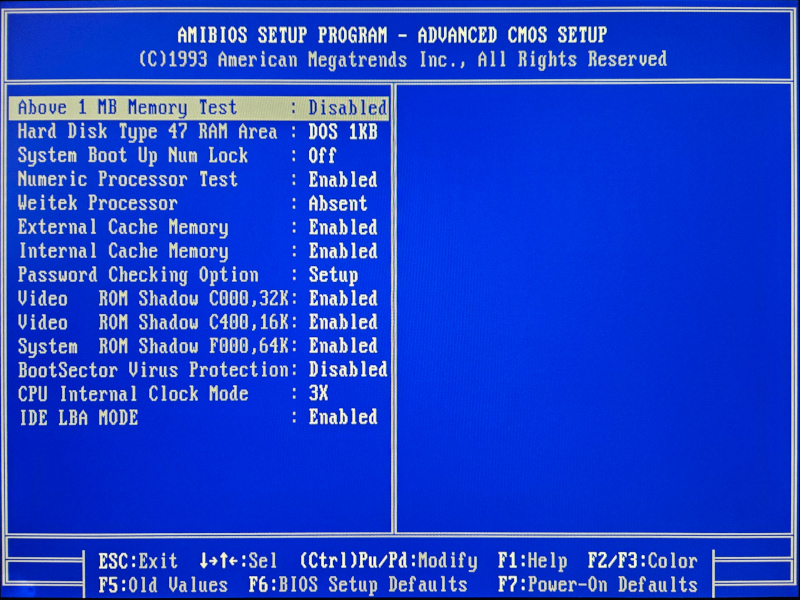

Default BIOS offers plenty of options, but locks the frequency multiplier for IBM BL3 processors to 3x.
Feipoa provided a BIOS that he and Jakethompson extended with bunch of additional options, including multipliers for SXL2 and BL3 CPUs.
Ark1000VL video cards don't agree on complete stability with this motherboard. Require increased wait states, which lowers overall performance.
Used S3 Trio64 instead. Works great with tightest BIOS settings.
Promise EIDE-2300Plus worked great as well. Used Transcend 2Gb CF card for local storage.
256Kb of 15ns level 2 cache.
16Mb of 60ns RAM. BL3 processors cannot cache more than that, or things get slow.
Some of the offline graphics tests can benefit from more memory, but didn't run them for 386DX and SXL2 processors. Notes below.
ULSI FPUs can cause hangs upon reset. Needs power off/on.
Used such CPU for the Quake 1 test. Quake really likes ULSI - performance is higher than with FasMath chips.
For everything else - 33MHz rated FasMath (gray top - slightly faster than the black top one).

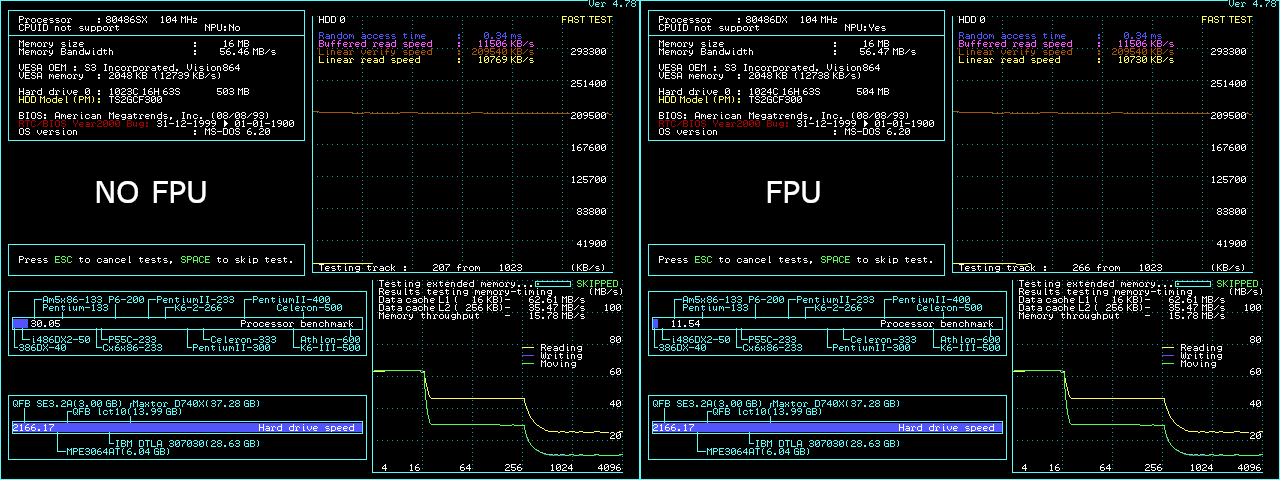

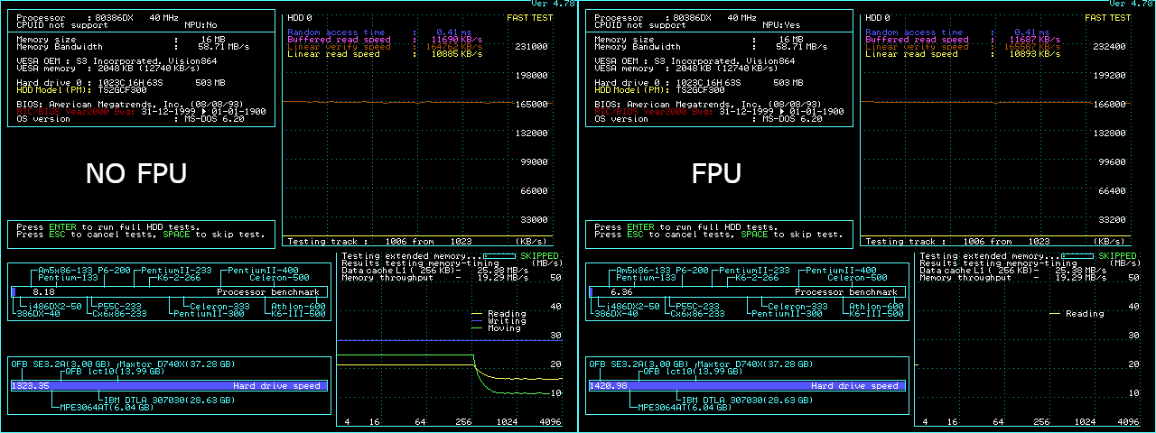

--- 386DX at 40MHz, ISA bus at 20MHz

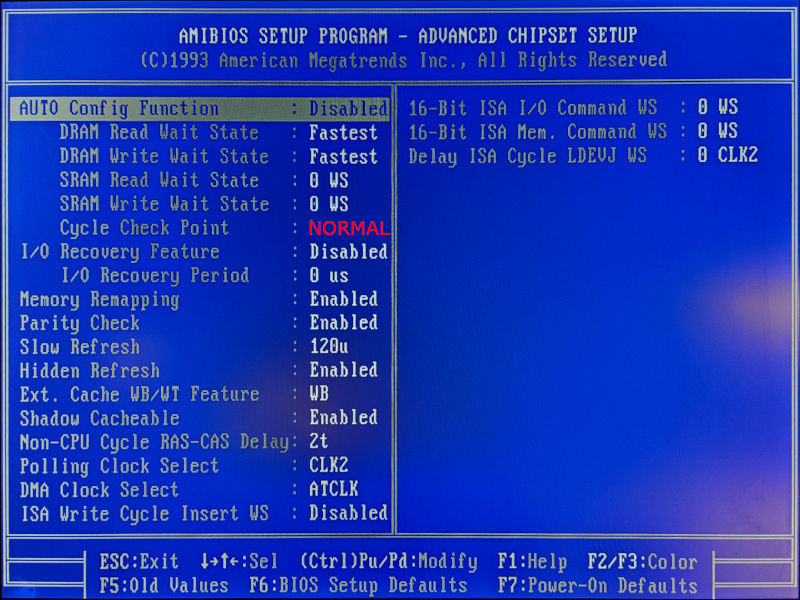

CYCLE CHECK POINT = NORMAL (best is FAST)
System is completely stable.
That's pretty much it - things just work.
Used the standard BIOS.
One of the slowest boards overall, except for Windows accelerated graphics - number two so far.
Didn't bother with complex offline graphics tests. They would take forever to complete.
--- TI 486SXL2-50 at 40MHz, ISA bus at 20MHz

--- IBM BL3 at 100MHz (3x33), ISA bus at 16.6MHz
CYCLE CHECK POINT = NORMAL (best is FAST). Most of the time is ok with FAST, but eventually will run cause problems.
System is completely stable. Felt great.

I think it would help a lot of people to include photos of the BIOS screens for your final, most optimal settings.
For my Daewoo AL486V-D system with modified BIOS, I have arrived at these settings:
168.22 KiB
1170 views
221.42 KiB
1170 views
At the first few glance, it appeared as if the 16-bit ISA I/O Command WS, Memory Command WS, and LDEVJ WS were perfectly stable at 0 WS and 0 CLK2, but over the course of years having this system setup, I've arrived at the more conservative and stable values shown above. I generally run a lot more hardware in my system compared to pshipkov, though.
Nonetheless, using:
Diamond S3 968 + MVP mpeg decoder card, and
Promise EIDE2300plus
my DOOM score is 26.4 fps when using an IBM BL3 at 3x33 MHz. Was your score 26.6 fps?
I think CLK2 is 2xFSB, so 2x33.3 / 8 = 8.33 MHz ISA. I normally run the ISA at around 10-11 MHz, so I'd have to check my notes for why I'm running it so slow.
Are you able to enable the Flash ROM function on your setup? I thought this was similar to shadowing a memory range for I/O cards (the Promise EIDE2300plus), but when I enable it, the system doesn't work.
Reply 1938 of 2154, by pshipkov
Fixed it - 2x40.
This board sat on the test bench for over 2 weeks. Pushed it around quite a bit.
SB16 and ASS1869 audio cards work just fine with the listed above BIOS timings.
Didn't test network cards. The presence of CF cards reduces the need for network connectivity for such old machines.
First BIOS page here is the same as what you posted.
The second is all on max except the listed items.
AT BUS CLOCK = CLK2 / 4. This can be derived from the listed ISA bus speed in each section.
I think you punish this 386 class rust with Win95 if i am not mistaken. I stay on DOS and Win3.1 only. Win95 is much more fussy. Maybe that's the reason you have the BIOS timings so inflated.
Yes, 26.6 fps in Doom. But i have you listed as 26.7 in the charts - remember that i picked it from conversation early in the thread. Not that 0.3 fps matters. Just pointing out.
FLASH ROM FUNCTION was enabled at some point but there was no observable difference in behavior and performance.
CYCLE CHECK POINT can be set to FAST, but at the expense of increasing other wait states. Keeping it at NORMAL allows for decreasing these other guys and achieving better overall performance.
May post BIOS screens, but have now Asus P3C-D board on the bench, so that will have to wait.
