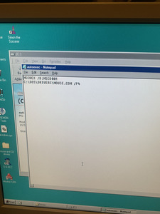

Okay, thanks. 😀 I might be onto something anyway. I accidentally left my boot disk in on restart and let it go through the procedure and it mentioned that the CD drive letter is F: I *think* it may have configured the drive and the mouse for DOS, but I need to check.

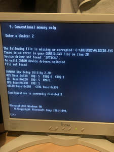

Reply 42 of 125, by DustyShinigami
It worked! The boot disk configured the CD drive! It recognises E:!
Now to try and install/play Simon 1 in DOS! 😀

Step one, boot your computer on that floppy disk and see if your CD drive is initialized and works properly. A boot disk is a disk you're meant to boot from, bypassing any OS or specific configuration you currently have. If your CD drive works after booting from the boot disk, you'll have made a huge troubleshooting step confirming everything is right with your hardware and you can focus on properly configuring your "main" DOS/Win98 environment. But that's step two. Focus on step one for now.
EDIT: there you go. I love that you "accidentally" left the boot disk in when that was exactly what I was asking you to do xD
your boot disk will not initialize your soundcard and other stuff. It's a basic setup, but it includes CD rom initialization so that was a good test for you. Now you should see how autoexec.bat and config.sys are done on the boot disk in regards to CD initialization and you can reproduce it in your main HDD files so you don't need the bootdisk anymore (It needs two things - The DEVICE declaration in config.sys then calling MSCDEX in autoexec.bat)

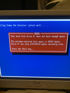

Okay, next set of problems…
Firstly, it won’t let me install to the D drive and says this:
1.19 MiB
533 views
GPL-2.0-or-later
It installs to the C drive though.

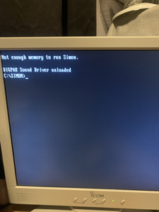

Second - every time I try to load the game, it says this:

don't try to run it from the win98 bootdisk...as said it's a minimal environment, the sole purpose of that test was to confirm there was nothing wrong with your CD drive under DOS.
Check this and watch the video: https://www.philscomputerlab.com/ms-dos-mode-super-easy.html

Reply 52 of 125, by Boohyaka
Mmmh you are still missing very basic puzzle pieces of understanding what you are currently doing...but no problem, learning is fun. I would still recommend watching Phil's video, that may help you figure out some of the stuff.
The boot disk boots in DOS, but a DOS configured from the floppy and its config.sys and autoexec.bat, bypassing whatever is on your hard-drive. That's all it does. As said by sfryers the true purpose of the bootdisk is to boot a minimal DOS environment that initializes your CD drive so you could run the Win98 official setup that was provided on a CD. Think about a brand new computer and blank HDD you just purchased from the computer store and assembled yourself, the Win98 bootdisk would allow you to run the installer because otherwise there would natively be nothing to let you boot off the CD directly back in those days.
I asked you to test the bootdisk, again, just to rule out any hardware problem and confirming your CD drive is fine. The test is successful, so you can now focus on properly configuring your environment off your C: drive. I never meant for you to try and run Simon off the boot disk, that was just a troubleshooting step.
EDIT: What's your motherboard and onboard sound? It's very, very probable that you won't be able to get sound in true DOS from it.

Reply 55 of 125, by eddman
DustyShinigami wrote on 2024-11-16, 18:47:
Maybe it doesn't recognize HDDs larger than 2 GB.

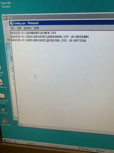

I suppose the drivers use too much base memory and leave not enough for the game. You'd probably have to use EMM386 then.
[config.sys]
DOS=HIGH,UMB
DEVICE=C:\WINDOWS\HIMEM.SYS /TESTMEM:OFF
DEVICE=C:\WINDOWS\EMM386.EXE RAM
DEVICEHIGH=C:\DOS2\VIDECDD.SYS /D:OPTICAL
[autoexec.bat]
LH MSCDEX /D:OPTICAL
LH C:\DOS2\MOUSE.COM /p4

It recognises my C drive though and that has 30GB on it. The D drive is 10GB.
But it could need more memory. I'll try re-enabling EMM386 and try adding that code you suggested a bit later. 😀

Reply 58 of 125, by DustyShinigami
Not sure if it’s a false alarm, but after re-enabling EMM386, the Win95/98 version of Simon won’t load. The CD doesn’t boot the game up, running the executable doesn’t do anything, but Runit95 is in the Task Manager, and it causes the whole machine to act up. It struggles to even restart/shutdown the PC. I’ve had to force it to restart.
Second time trying it, it was perfectly fine. So possibly related to something else.

Nope. Still no luck. 🙁 The CD drive works with this setup, but I think turning EMM386 back on is preventing it from working even more. I get the same error with both HDD now, C and D.

Before I changed the config and autoexec, this is what they were like. Some elements had been added automatically that weren't there before, possibly due to that boot disk...?

But I have changed those to what you suggested now.
Also, the DOS setup I downloaded from Phil doesn't work as I need to re-modify the config and autoexec again. I got this when I tried it:
