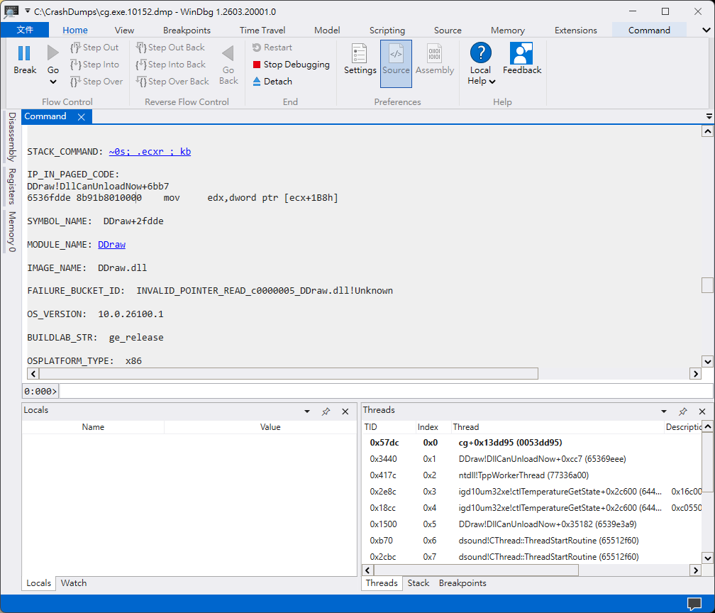

I'd like to report a reproducible crash that only occurs when using dgVoodoo2 with the **Taiwan version of Cross Gate (cg.exe)**, an old 32-bit DirectDraw game.
### Environment
* Game: Cross Gate (Taiwan version, cg.exe)
* OS: Windows 11 24H2 (Build 26100)
* dgVoodoo: 2.87.3
* DDraw.dll version: 4.7.1.3000
### Problem
The game works normally, but after running for approximately **6-12 hours** (usually while the character is idle running a player shop), it crashes to desktop.
I don't remember this happening before I started using dgVoodoo2.
I first noticed the problem with 2.87.2 and it still occurs with 2.87.3.
I also tested with **Fast video memory access disabled**, but the crash still occurs.
### Event Viewer
Faulting module:
DDRAW.dll
Exception code:
0xC0000005
Fault offset:
0x0002FDDE
### WinDbg
I enabled Windows LocalDumps and analyzed the crash dump.
The crash always occurs at:
DDraw+0x2FDDE
Instruction:
mov edx, dword ptr [ecx+1B8h]
Register state:
ECX = 00000000
The instruction dereferences a NULL pointer, resulting in an access violation.
Call stack:
DDraw
DDraw
DDraw
cg.exe
DDraw
Unfortunately, there are no public symbols available, so WinDbg cannot resolve the internal function names.
### Additional Information
I have collected:
* Full crash dump (~1.45 GB)
* WER report
* Event Viewer logs
* WinDbg analysis
I'd be happy to upload the dump or test any debug build if it would help investigate the issue.
Thank you very much for your time.
Reply 1 of 14, by Dege
Hi,
Thx for the report!
The crash point is an internal function called when a new DD surface is being created. The this pointer is NULL which is weird, the only thing that I can think of is that there is a resource leak and the 2GB address space is slowly eaten up by a lot of leaked DD(?) objects.
1) Could you check out the virtual size of the process when it crashes (e.g. in Process Explorer)?
2) Or check out if the virtual size is slowly growing as the game is being run?
3) And trying to run the game on a GPU from a different vendor? Because unfortunately I myself had cases when I got memory leaks from an Intel driver (integrated).
