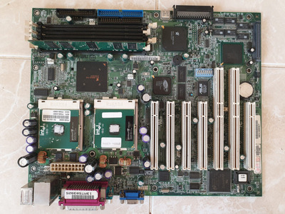

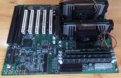

Hypothetical question: ASUS CUR-DLS vs EPOX KP6-BS

Reply 1 of 37, by weedeewee
Why not both ? 🤣
anyway, I'd prefer the Epox since it has AGP and ISA slots.

Reply 3 of 37, by paradigital
For me, dual s370 but with AGP, I’ve got two of those, one running dual 1GHz PIIIs and one modded to take dual 1.13GHz Tualatins.

Reply 4 of 37, by mR_Slug
The lack of AGP on the Asus, suggests the Epox is more useful, as there are a lot of people who use this stuff for gaming. Though the lack of 64-bit PCI/PCIX on the Epox does limit SCSI expansion in say a server. I like old server stuff but i would say i'm in a minority compared to those into gaming. Has the Epox got a BX or GX chipset?
Though obviously dual and gaming usefulness, is limited based on the OS choice.

Reply 7 of 37, by dionb
ISA is hardly relevant with dual CPU builds: you want ISA for DOS, and DOS doesn't do SMP. SMP-aware OSs like WinNT, 2k, XP (and various Unixen and more exotic options) are all perfectly happy with PCI (sound) cards.
AGP is another matter though. The issue here isn't So370 vs Slot1, but a workstation board like the KP6-BS vs a server board like the CUR-DLS. There are perfectly good dual So370 workstation boards out there with AGP (Asus' CUV4X-D for example, or if you want to go seriously high-end the Tyan S2567)

Reply 9 of 37, by pshipkov
The clock generator on the Asus board goes to 180mhz.
You can have extra fun pushing it around.
There are better options out there, if you are looking to spend on dual p3 hardware.
retro bits and bytes
Reply 11 of 37, by dionb
Miphee wrote on 2021-06-05, 20:42:
Are there decent PCI video cards available for gaming?
Hardly. The one that springs to mind is the Matrox Parhelia, but the 64b PCI version was even slower than the AGP one. That CUR-DLS simply isn't a gaming board.
