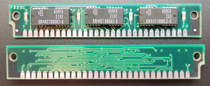

4x1Mb Samsung 60ns parity FPM 30 pin SIMMs
Had to pick and choose from a bunch to find the right ones. As far as i remember 2 more memory sticks with LG chips on them worked fine too, but used the 4 Samsung ones for uniformity.
The BIOS does not offer option to toggle parity checking, but these memory sticks have been battle tested on multiple motherboards for all sort of things - they are solid.
EDIT:
Just remembered something - there is a similarly looking type of SIMMs with KM41C1000CJ-6 labeled Samsung chips on them, they gave me quite a bit of trouble. They are a bit taller and have wider resistors. There is a "SAMSUNG Korea" label in the upper left corner.
But maybe it is just a coincidence that mine are not great and i am only spreading rumors here.
So i leave it to you to decide what is what. 😀

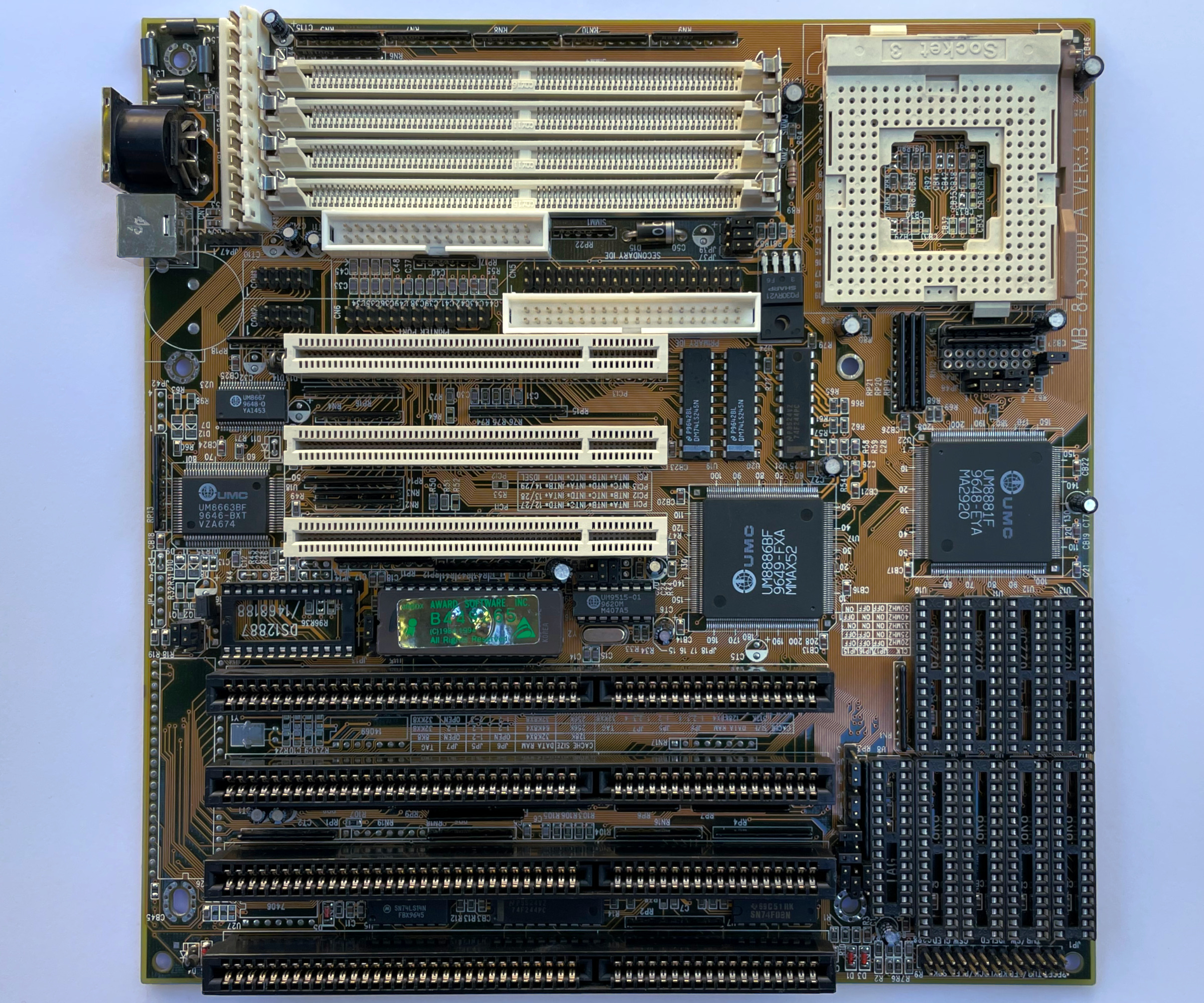

if I'm not mistaken, then "Parity error check" is it J18, you need to install a jumper 1-2.
2-3 - OFF parity error check.
I see chips "Parity Error Check" are also high speed 60ns 😀

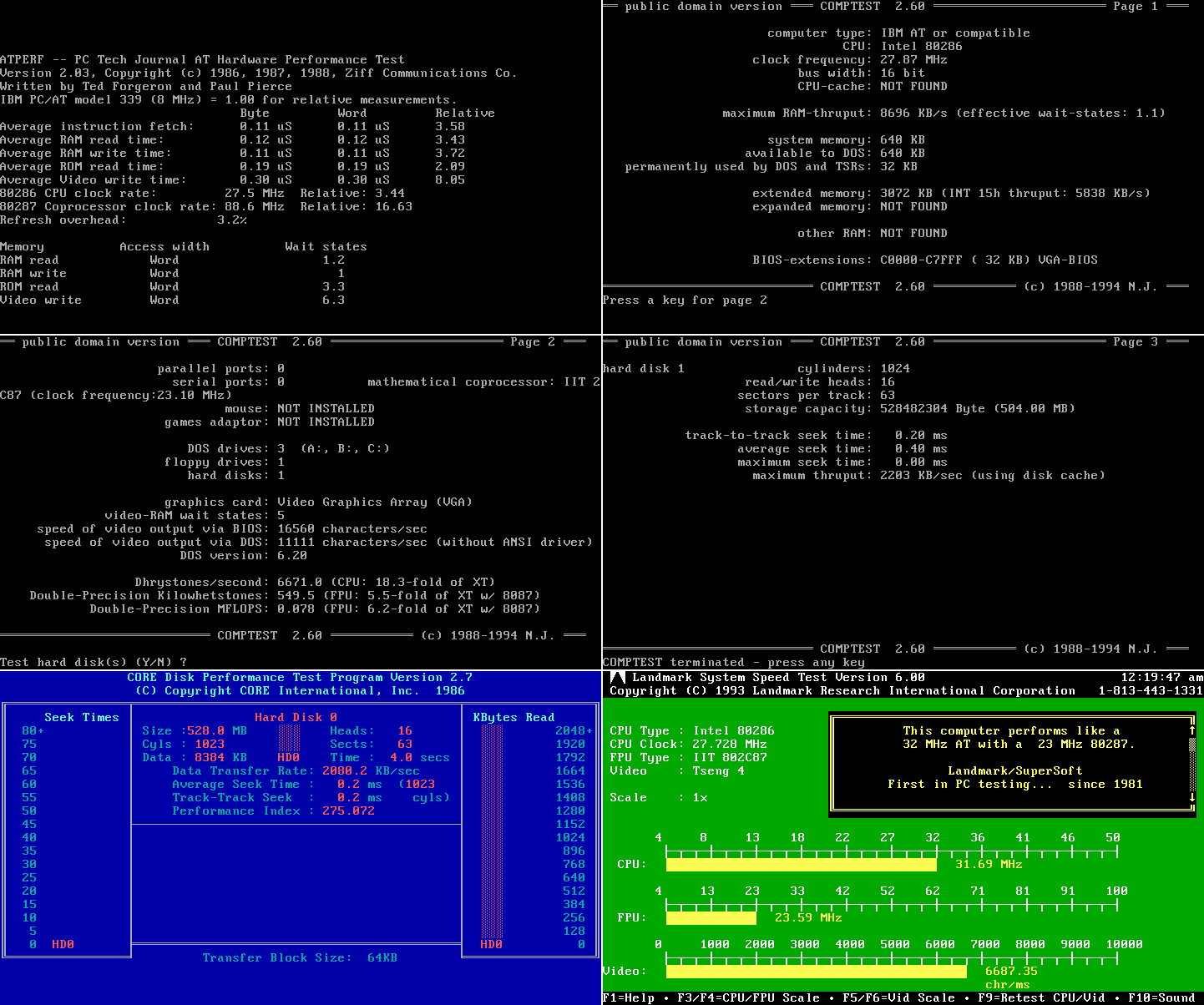

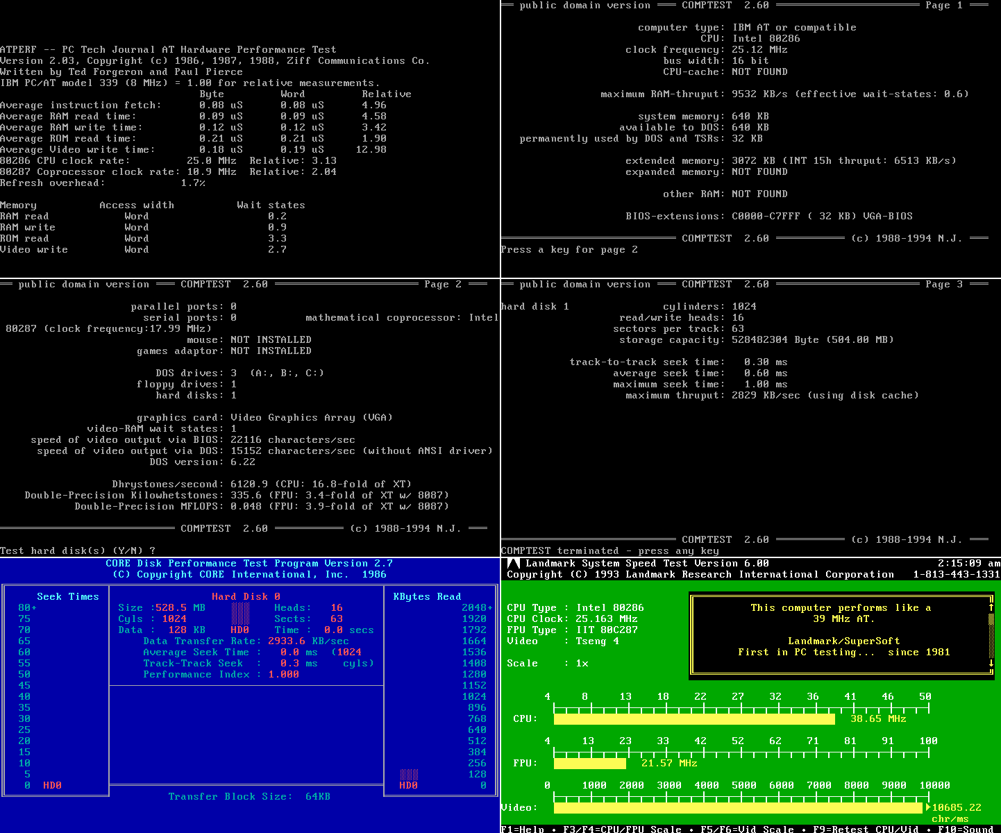

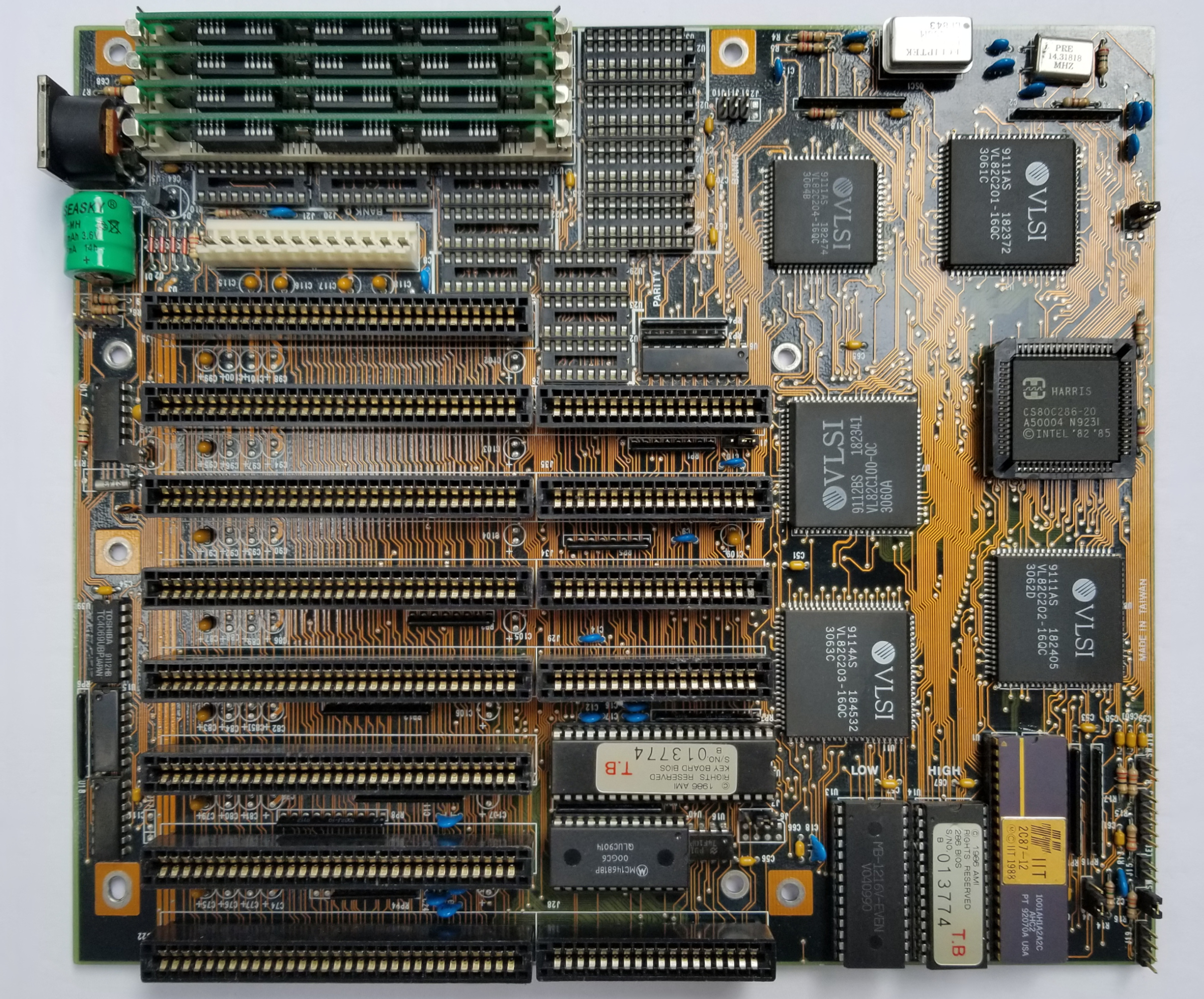

Tried the same memory sticks in two other motherboards - 286 and 386 - parity check went just fine.
Given the fact that the VLSI system is very stable, i am wondering if its parity checking is just being funky ?

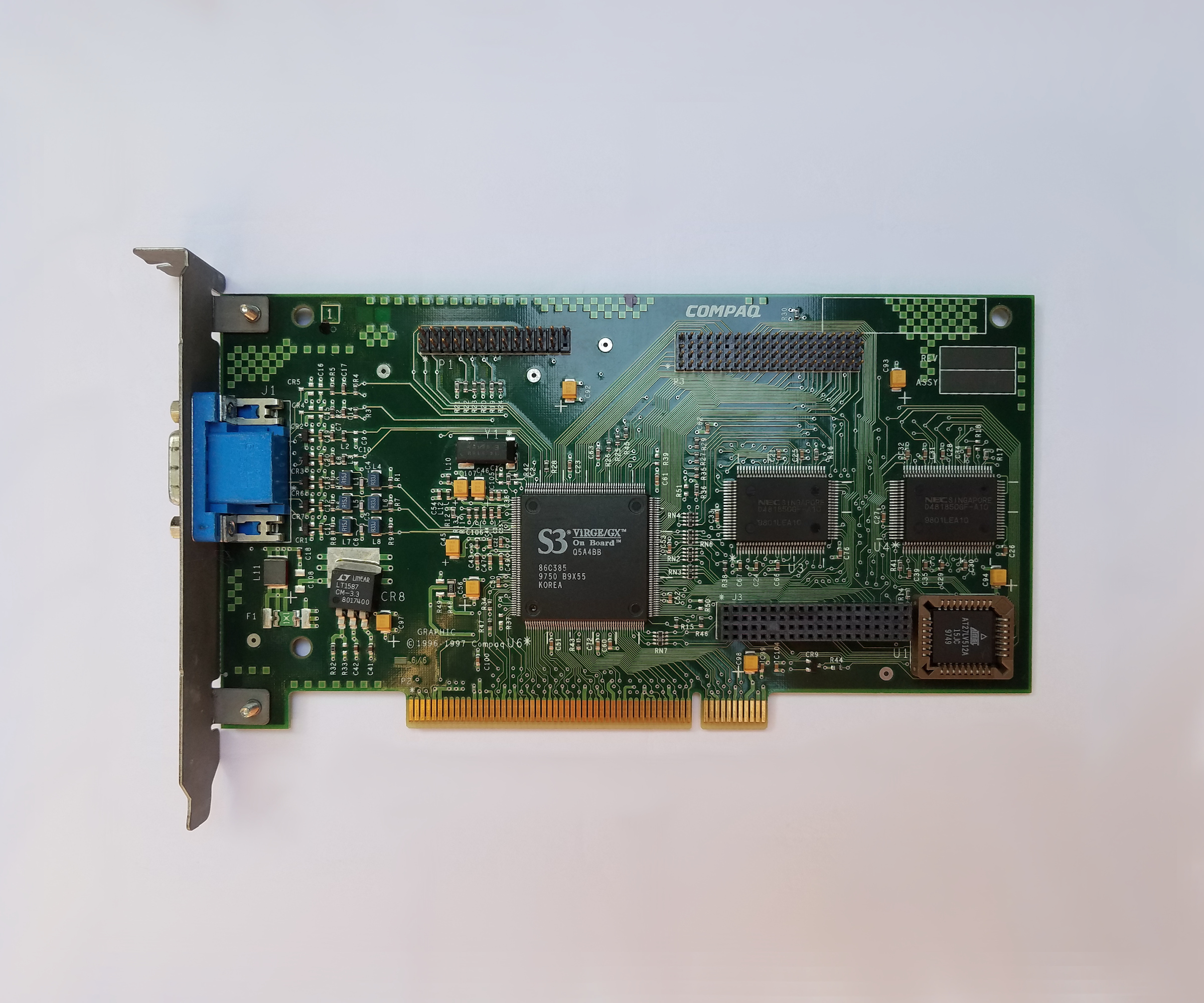

Back in the day there were plenty of S3 Virge based video cards.
Spent a moment today to check the unaccelerated DOS and accelerated Windows GUI performance of 3 Virge generations (capped at 1996).
Added an S3 Trio for reference.
Used the ASUS PVI-486SP3 motherboard.
System's performance will be hard CPU limited, but still, let's see what comes out of it.
S3 Virge/GX 2Mb (Compaq)
S3 Virge/DX 4Mb (forgot to put the second 2Mb of memory for the photo session)
S3 Virge/VX 8Mb (STB Velocity 3D)
S3 Trio64V2/DX 2Mb
As expected, DOS results are even, a bit of a difference in Windows GUI. Same old, same old.

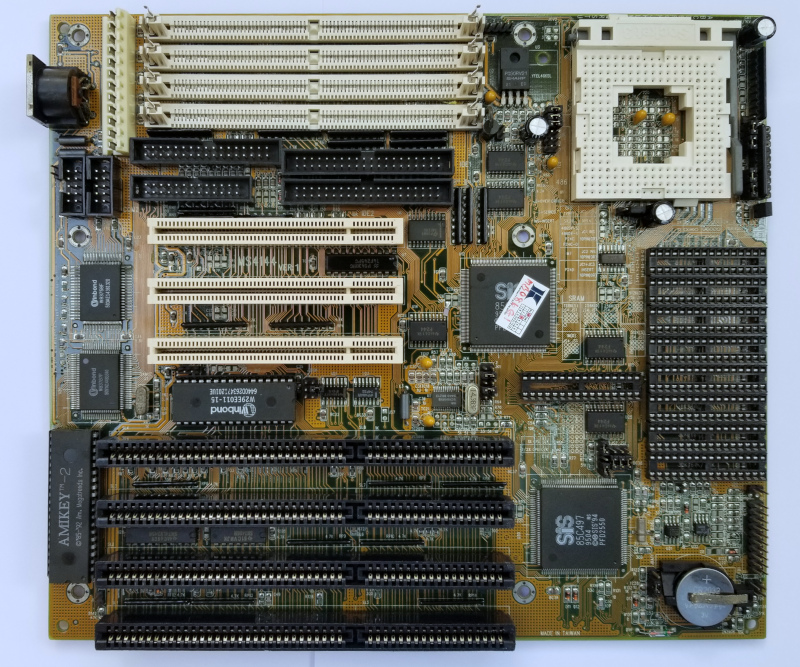

A special guest on this weekend's matinee was Microstar MS-4144.
I happen to have a ver:1.0 of the same motherboard. There are also versions 1.4 and 2.1 out there.
There are some differences between them.
Most notably later versions have many components omitted compared to version 1.
Not sure what to make out of it. The two motherboards here have exactly the same behavior and characteristics.
Jumpers are a bit all over the place. Took a moment to figure them out.

--- AMD Am5x86 at 160MHz (4x40)
Without further ado - i expected a lot from this motherboard based on its impressive specs (256Mb RAM, 1024Kb SRAM), but got disappointed. The system is unstable when timings are too tight. Increasing them to keep things stable leads to worsened performance. Tried different sets of RAM and SRAM chips to eliminate the chance of incompatibility, but the problem seems to be the mobo itself. It is kind of strange, because the same SIS chipset works much better in other boards. Used the same Matrox Millennium PCI video card for the tests below.
My initial tests were incorrect. The 1024Kb L2 cache was not actually working, so i drew the wrong conclusions from there. Also, i was using the default AMI BIOS which turned-out to have significant performance issues.
With these issues correct i ended up with working 1024Kb L2 cache, all BIOS settings on max, except DRAM RAS TO CAS DELAY = 3 (best is 2).
Motherboard is fast and stable.
Not picky about L2 cache chips which is rare.
Things just work.
The last tests were done with version 1.0 PCB, where the L1 cache is automatically put in WT mode. The SpeedSys screenshot from it.
benchmark results

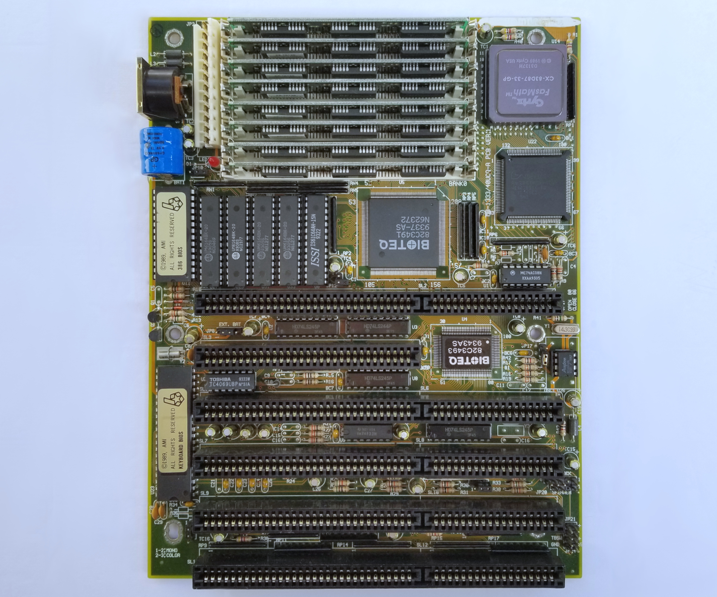

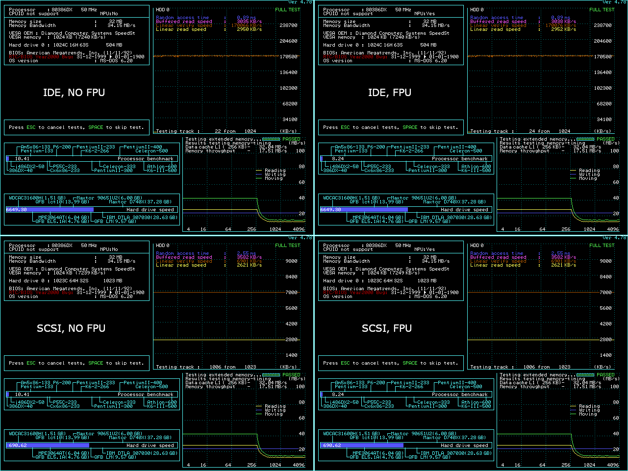

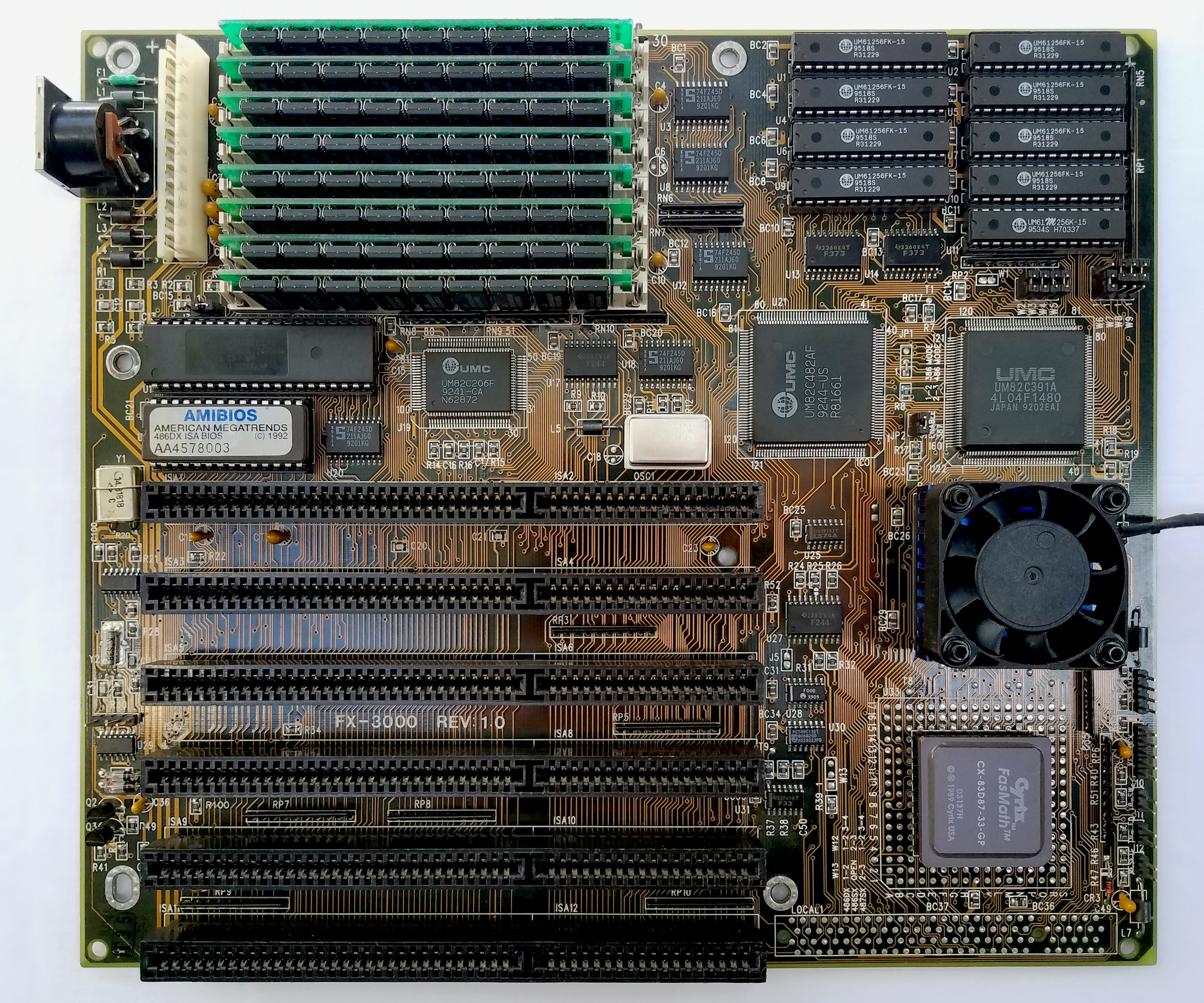

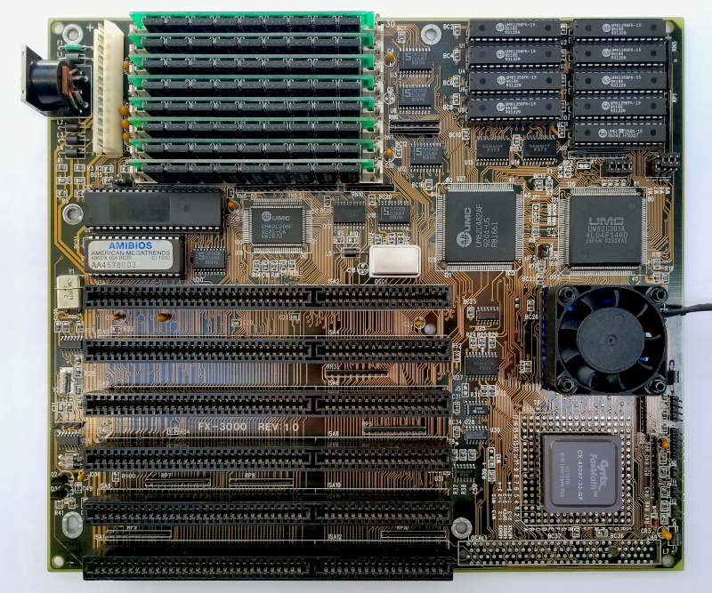

Another weekend - another motherboard examined - Elitegroup US 3486, although FX-3000 rev 1.0 is printed on the PCB.
Actually the examination happened a while ago, only sharing the findings today.
Motherboard is fully stable at 45MHz with all system timings at their lowest (fastest) available values. Also, fully maxed out system - 32Mb RAM, 256Mb SRAM, etc.
The mobo is fully stable at 50MHz with lowest timings, but without FPU. If FPU is present (a 40MHz rated FasMath, for example) some compromises need to be made for things to stay stable - relaxing some timings and enable caching for the first 16Mb RAM only. Obviously this is a no-go for me, so i don't consider it as an option.
The board works at 55Mhz as well, but timings have to be relaxed which leads to lower performance than 50MHz and even 45MHz.
Surprisingly at 50MHz the Adaptec AHA-1542CF SCSI controller can operate at 10Mb/s which is a real boost for the disk performance. You really feel the 5Mb/s read speed ...
At 45MHz i can get it to work at 6.7Mb/s max.
FX-3000 didn't like 12ns ISSI SRAM chips. Not sure why, because they work just fine in other systems, so i went with 15ns UMC ones, which nicely match the chipset brand of the board.
All tests were performed with the same Genoa CirrusLogic GD-5426 video card with latest (for 1993) Diamond BIOS (great performance), that i use in my main 386 build.
AMD 386DX at 45MHz
AMD 386DX at 50MHz
benchmark results
Not the fastest clock-to-clock chipset and assembly, but very steady beyond the standard 40MHz.
For stable 50MHz ULSI or black-top FasMath FPUs are required.

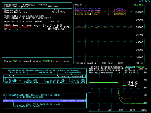

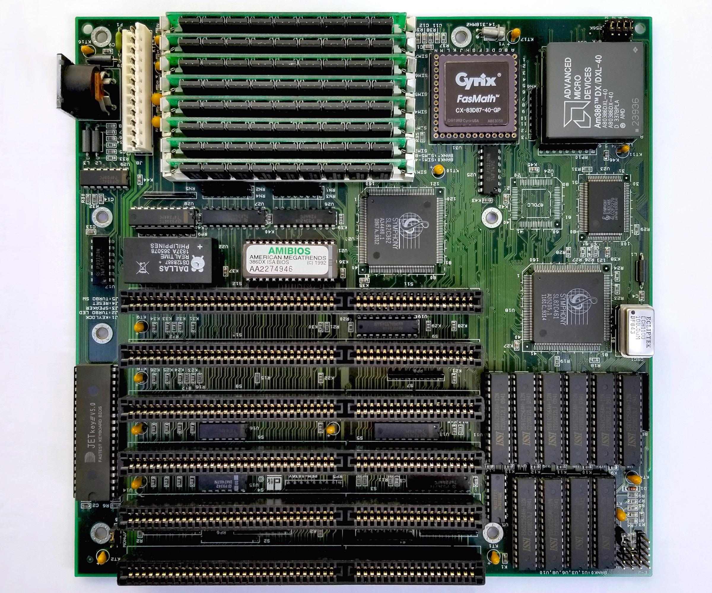

Reply 52 of 2161, by pshipkov
Finally got some time to get back to the retro hobby.

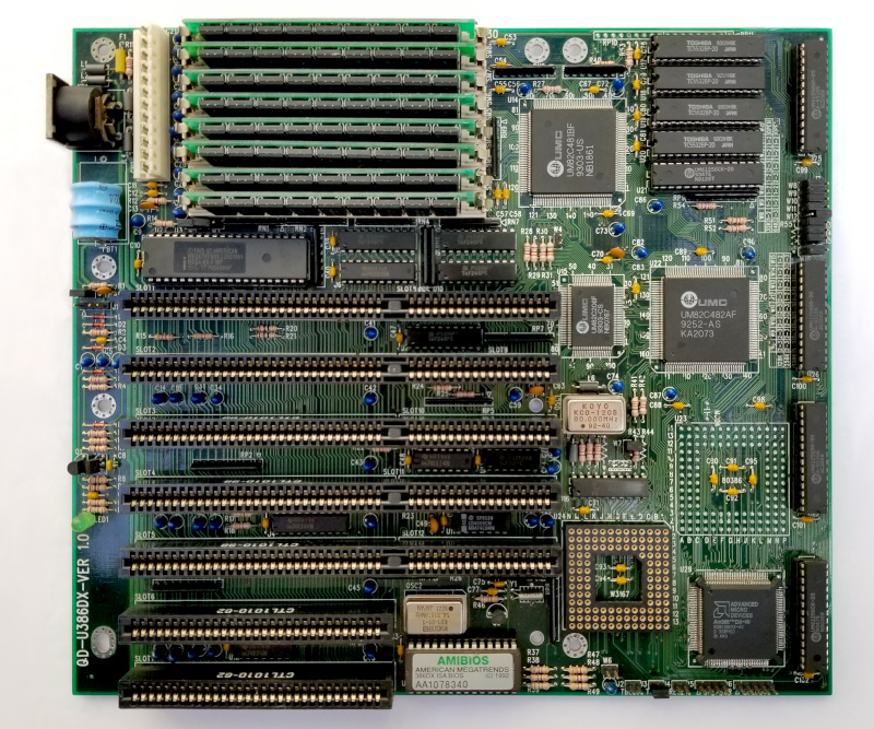

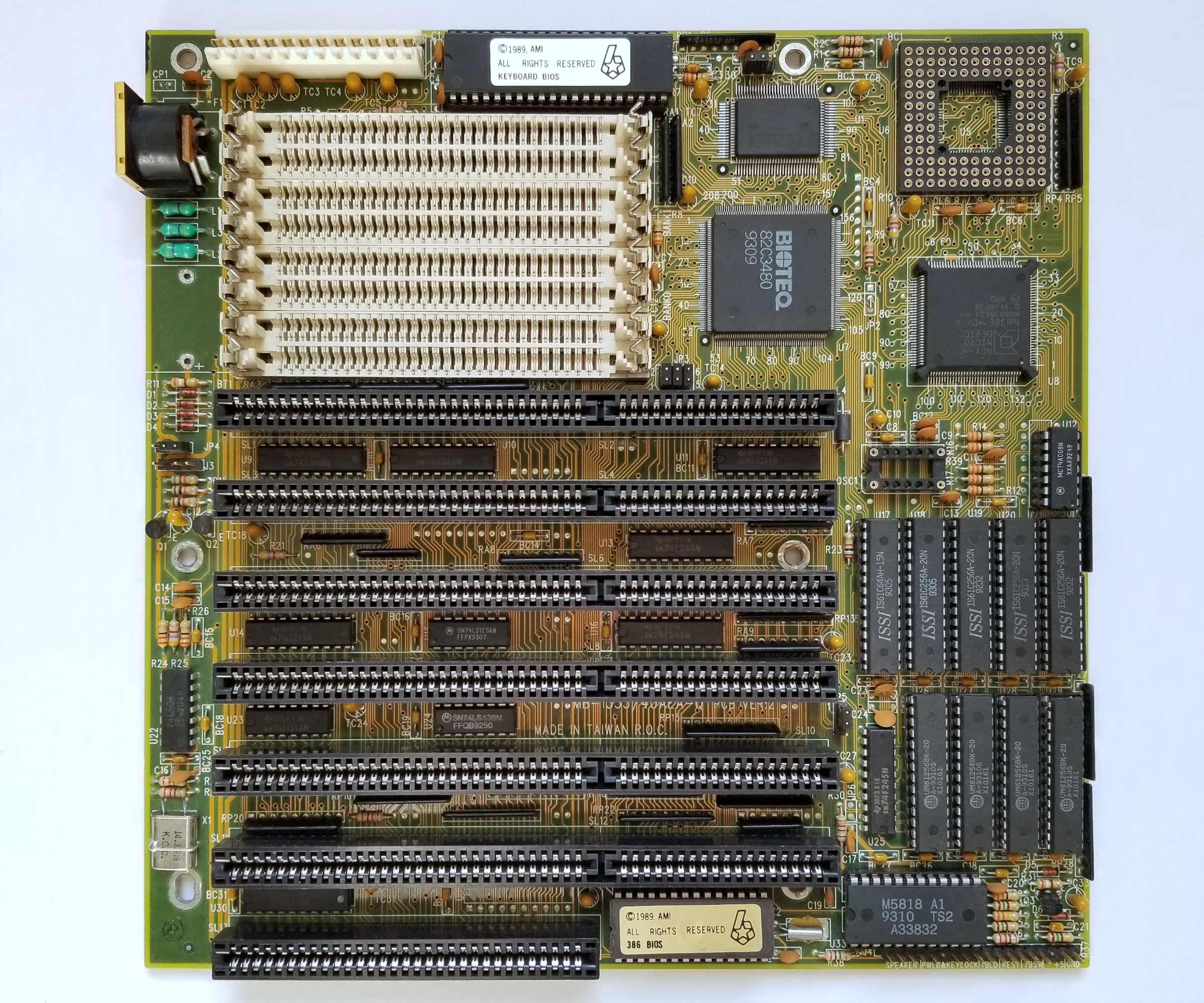

Played a bit with this Magitronics QD-U386DX ver.1 motherboard based on UM82C482AF/UM82C481BF chipset.
https://www.petershipkov.com/temp/retro_pc_im … motherboard.jpg
The mobo looked very promising at first with its clean and well organized layout, but then came the disappointments.
It was very picky about the SRAM chips. Took me a while to get it to 256Kb.
Very slow local storage I/O and below average VGA performance.
The board does not overclock at all.

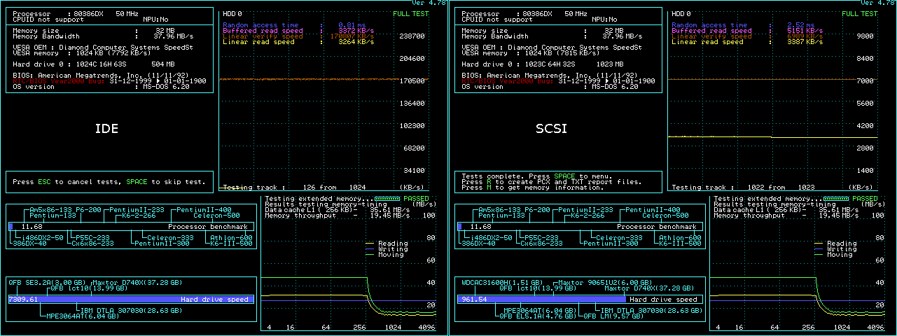

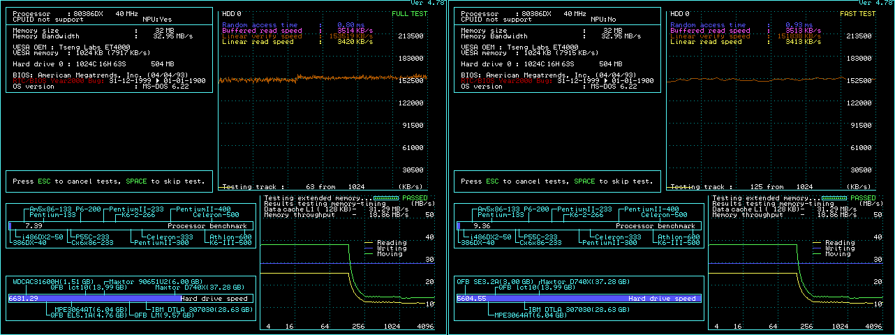

Here is what SpeedSys says for 40MHz:
Without FPU 45MHz is possible.
Unstable in Windows 3.11. Couldn't complete the WinTune2 tests.
Numbers are actually pretty ok for what they are, but still one of the slowest 386 motherboards around.
benchmark results

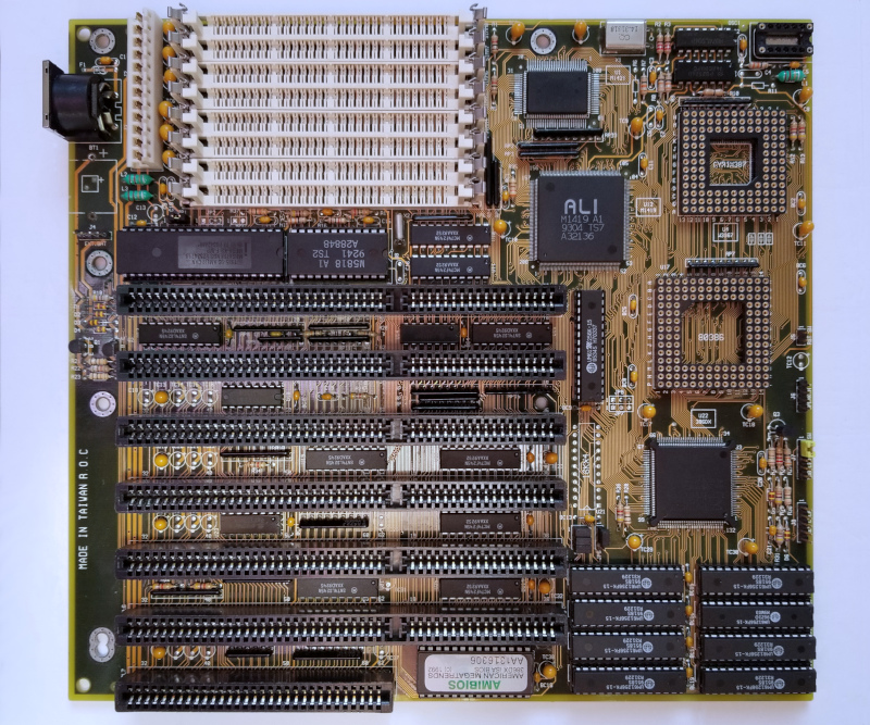

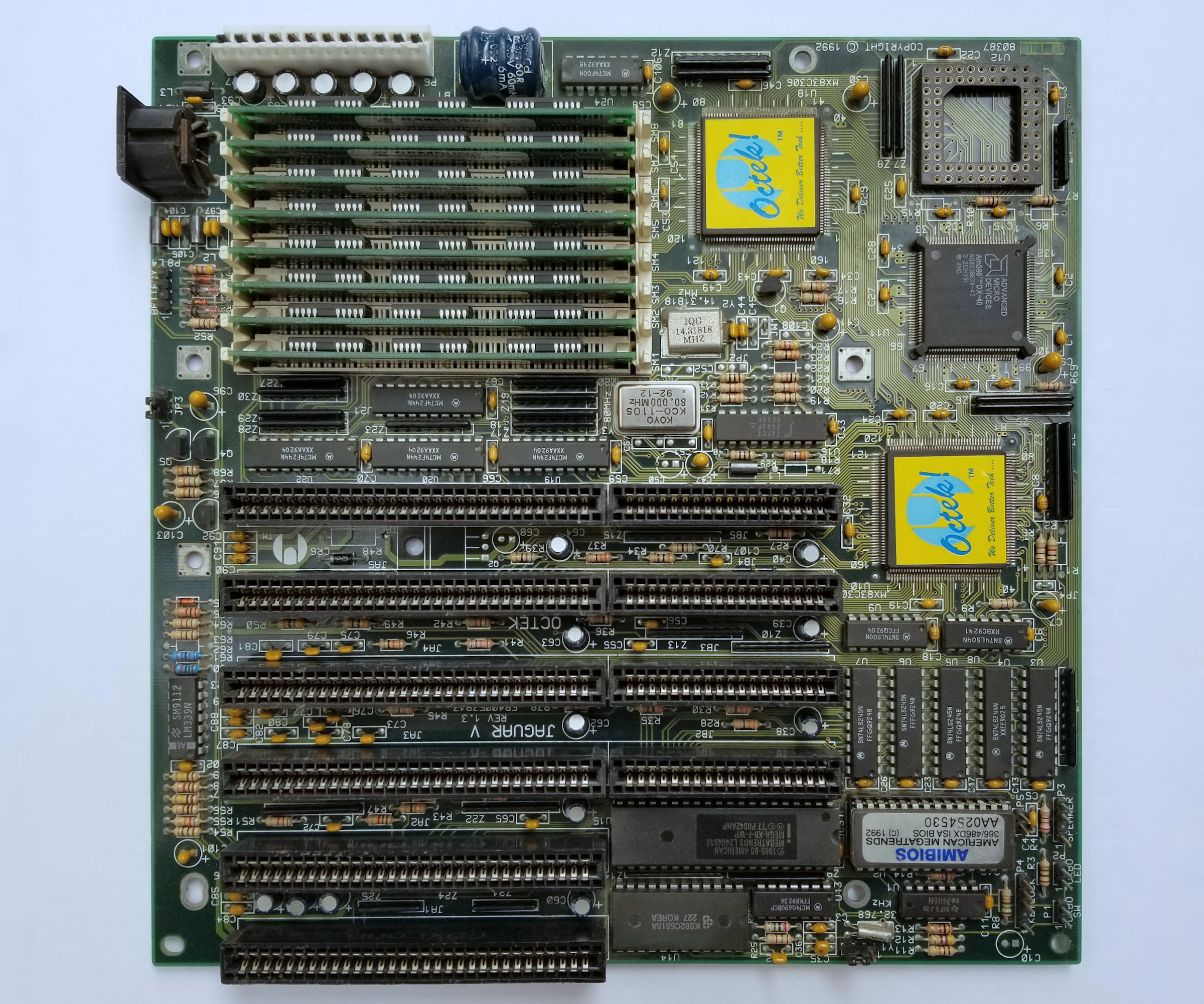

Octek Jaguar V rev.1.3 based on Macronix MX83C305FC, MX83C306FC chipset.
An interesting 386 motherboard with potential, hampered by wacky Mr.Bios.
An interesting board.
On par (clock-to-clock) with some of the best performers out there.
There is only 8Kb cache installed with no options for upgrade. This hurts memory intensive tasks.
Very stable, takes 100MHz crystal oscillator with ease.
The hardware feels capable but the installed Mr.BIOS lacks sophistication - very few wait-state parameters exposed.
There is a later revision 2.0 of the motherboard with higher level of integration, but it replaces the crystal oscillator with clock generator which limits base frequency to 40MHz. Not good. 1.x is the better place.
For 50MHz FSB had to lower "system wait state" which affected IDE performance negatively compared to 40MHz system.
Used ET4000AX video card for DOS interactive graphics and Cirrus Logic GD-5434 card for Windows accelerated GUI tests.
Didn't bother with SCSI controllers. They get unstable at high ISA bus frequencies.
benchmark results
Performance is above average at best.
System is very stable. Just works.
Mr.BIOS is snappy between restarts as usual. Gets to DOS prompt in about a second.
The whole package works really well.

Reply 54 of 2161, by pshipkov
I have been searching for the right 386 motherboard for quite some time.
Went through a lot of them (partially documented in this thread), but never found one that fully satisfies my requirements for speed and stability.
Well, until now.
DTK PEM-4036Y based on Symphony 'Haydn II' SL82C465, SL82C461, SL82C362
256Kb cache, 12ns
32Mb RAM, 60ns, Micron
This motherboard is a real beast.
EDIT (few years later):
Well, all good things eventually come to an end.
Turns-out that MSI MS-3124 version 2.1 is even faster - stable overclock with IBM BL3 processor running at 110MHz (2x55) and ISA bus at 27.5MHz.
But, that does not diminish the qualities of the DTK assembly at all. It is still impressive.
1. The fastest (clock-to-clock) 386 hardware i have seen so far.
2. Overclocks to 55MHz without FPU and more importantly - overclocks to 50MHz with FPU with the tightest BIOS timings (* small exception for 3D rendering - noted below).
- A 40MHz FasMath FPU core and 12ns SRAM are needed to operate at this frequency.
- The slightly faster (clock-to-clock) 33MHz marked FastMath FPU core hangs the system.
3. Impressive IDE performance (3.5Mb/s) and even more impressive SCSI performance in 10Mb/s DMA speed mode (5.2Mb/s read and 3.2Mb/s write).
4. Fully maxed-out system (ram, cache, fpu, scsi, sound, lan, etc.).
5. Very stable !
And the best part yet:
Usually getting 386 hardware to perform at 45Mhz or higher involves significant effort.
Not this time - the thing just works.
In addition to that:
Clean and easy to work with layout.
Not a fan of the RTC Dallas modules, but once socketed they are ok.
There is something to be said about the SIMM RAM sockets - the metal clips are so convenient and with just the right grip, so i caught myself messing around with them more than i should, it's kind of addictive in a retro-nerdy-way. Whoever built that board really put the extra effort back then.
As a side note:
I happen to have another version of this motherboard: DTK-PEM-4036YB (notice the B at the end).
In pristine condition with warranty labels all over the place.
Removed the RAM and CPU it came with for the photo (imagine more warranty labels).
In its original plastic wrap (yellowed from the years) with written on it Toshiba Corporation (in Mandarin).
This leads me to think that at least the YB version of the motherboard was produced for some industrial purpose.
Perhaps both versions were for industrial needs since these items are very rare now-a-days.
In fact i had 2 of them, but sold one years ago.
It has proprietary and unusual DTK BIOS.
Does not overclock well.
The board layout and chip types suggest later version, but the keyboard controller is older than in PEM-4036Y.
The serial numbers of the Symphony chips are different between the two mobos.
The SIMM slots are entirely plastic, including the clips, which makes it hard to insert or remove memory modules (this actually prompted me to notice how nice the memory slots on the other board are).
Anyway.

Until now i relied on CL-5426 based Genoa video card with Diamond BIOS for my 386 activities, but it refused to operate reliably at 50MHz FSB. So i switched to ET4000/W32i for good. It is on par with CL-5426 and ET4000AX in DOS, but does so much better in Windows. At 24bit color it approaches the performance of Artist Graphics's WinSprint accelerator, which operates at 8bit colors only (limited by it's Win3.1 driver - i am playing period correct at all times, so everything has to be that way - for 386 - year 1993 is the upper limit for hardware and software).
While 3D Studio works fine with the tightest timings, for LightWave3D the DRAM wait state has to be increased to 2.
Still, for those who are not into retro 3D rendering (who really is ?), the motherboard will operate completely stable at 50MHz with the tightest BIOS timings at all times.
The "DOOM" 386 build (running at 55MHz with no FPU) showcased in this thread (DooM) achieves 39.5fps and 9.7fps in the Doom test. This mobo outdoes it at 50MHz (25MHz ISA bus). Will try to post results for 55MHz and no FPU at some point later.
benchmark results

Some conversations with Feipoa and Anonymous Coward prompted me to test Texas Instruments 486 SXL2-50 CPU on this motherboard.
All BIOS settings are set to their optimal values for best performance, except DRAM WAIT STATE.
It has to be set to 2 for complete stability in the very sensitive Lightwave3D rendering test.
For everything else it can be set to 1.
This is how i use the PC at the moment.
The below metrics reflect that.
For reference: when using standard 386 processor, if the frequency is below 40MHz - wait state can be set to 0, if 40MHz or higher - wait state has to be 1.
After short experimentation with different configurations, such as clock doubling, register values, etc., best performance was achieved by running the CPU natively (meaning - no clock-doubling) at 50MHz and 25MHz for the ISA bus.
It can operate (natively) at 55MHz as well, but without FPU and not fully stable.
The black top Cyrix 40MHz rated FPU caused stability issues from time to time and after testing several different FPUs the stable configuration was achieved with 40MHz rated ULSI. It is a tiny bit slower than the Cyrix, but stable, which is what matters here.
One big minus is the fact that with SXL2 in the CPU socket CF cards are no go with SCSI controllers, so switched to IDE adapter instead.
IDE+CF >> SCSI+HDD.
Video recording from one of the initial test runs
Few notes:
Video got too long, so cut it here and there.
Phone camera blows-up monitor picture, otherwise the ET4000/W32i produces really nice balanced colors.
Typing with one hand. Made a mistake in the Doom low-res FPS calculation. The result is 59.13, but not 59.35.
After i took the video, i made few more tweaks which resulted in even higher score, as reflected in the chart below.
As you can see - performance is pretty good for a 386 system.
Best results were achieved using: cyrix.exe -e -r -i1 -i2.
benchmark results

ABit AB-FA3 / Lucky Star LS 386DXA, based on ALI-1419 chipset.
Everything started great - pretty agile and nimble mobo. Overclocked to 45Mhz with no problem.
Performed faster than FX-3000 in the basic DOS tests, but then completely failed WinTune2 and the 3D rendering.
Speedsys:
benchmark results
Kaimei ALI 386DX / LuckyStar LS-386 ALI, based on ALI-M1429 chipset.
Obviously very late 386 motherboard. Probably 1994. Very stable. Works as advertized. 128Kb cache only.
Does not use crystal oscillator and i don't feel like figuring out if using another clock generator is possible, so capped at 40MHz.
Speedsys:

Biostar MB-1333/40AEA-Q
Neither good or bad board - from the middle of the pack.
Does not overclock at all. Pretty stable. Does what is supposed to do.
Trying to think of anything unique about it but nothing comes to mind.
benchmark results

With on-board memory chips i was not able to get beyond the 20 MHz. Tried few different 70ms and 80ms sets - but no-go.
So i had to choose between 5 Mb of RAM at 20 MHz, or 4 Mb at 27.5 MHz.
4 Mb of RAM is plenty for 286 hardware, so i went with the higher frequency.
One of the SIMM sockets had its clips chipped-off - replaced it with fresh one.
Didn't have black colored socket, so this section is not color coordinated, but who cares.
The usual set of stats and benchmarks:
benchmark results
Conclusion:
An interesting board, considering its BIOS and memory options.
Overclocks pretty well.
There is no control over wait-states.
Not the fastest piece of 286 hardware.
