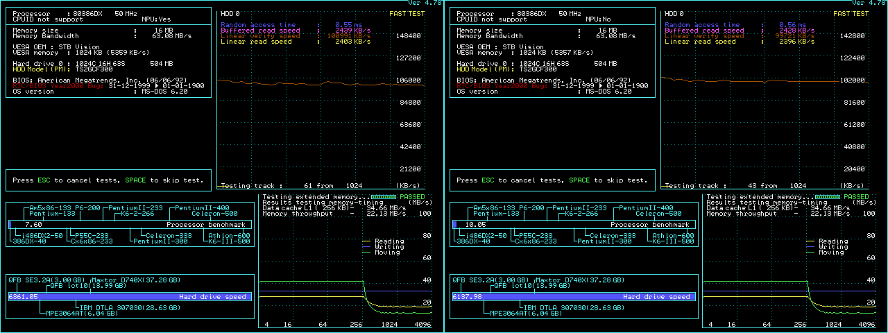

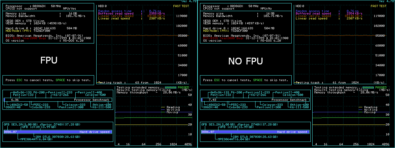

On the weekend i try to built the fastest 386SX computer. Its based on quite rare (Acer) ALi M1386SX processor. 128K L1 cache and Vesa Local Bus also can be found on the motherboard. Its built with a Cyrix coprocessor and 16MB 60ns RAM. The videocard is a S3 Trio64 based 2MB-s STB Powergraph 64VL, the hard drive controller is a CMD one which can handle 4 HDDs (the BIOS also can handle 4 HDDs and LBA), and a Seagate 4.3GB drive. I choose a Chinon dual floppy drive, a Sony CDU701 and Sound Blaster soundcard. Here is some benchmarks:
https://www.youtube.com/watch?v=T0FWZevKlUY
Reply 1862 of 2482, by pshipkov
very nice.
thanks for sharing.
what is the exact motherboard, cpu, fpu ?
do you have sound and lan cards in the mix ?
it will be good to post the exact specs.
retro bits and bytes | DOS media library
Reply 1863 of 2482, by iPonRMA
I think the motherboard is Alaris one with OPTi 295 chipset, CPU is ALi M1386SX, the FPU is "Cyrix 387SX" this is the only printing. Sound card is a Creative Sound Blaster 2.0. No LAN card yet.

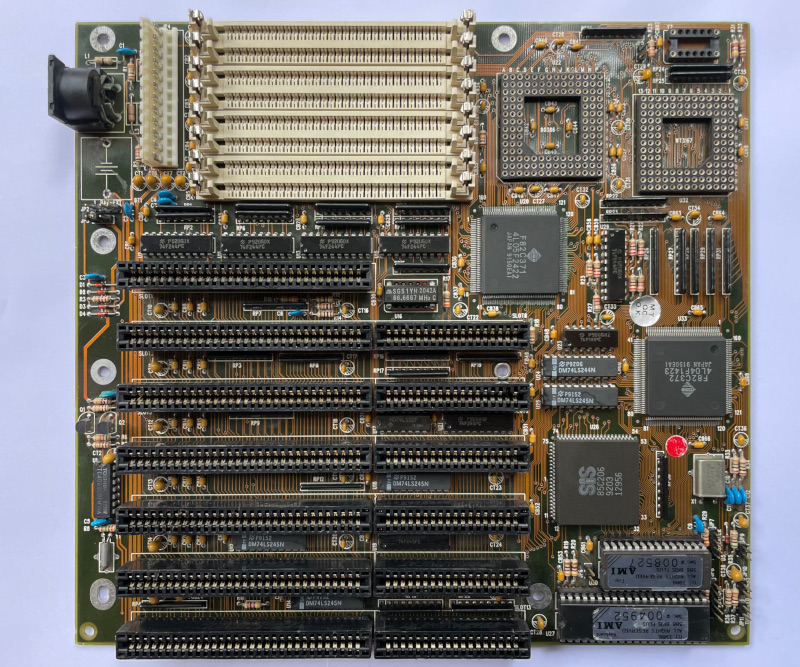

Reply 1867 of 2482, by pshipkov
386 class motherboard, unknown brand/model, based on CGS F82C371/F82C372 chipset.
Assembly is still in very good shape despite the few small stains of what appears to be a battery leak around the east side of the F82C371 chip.
Cleaned them after taking the photos.
Was not able to find any references about the motherboard and chipset. Had no idea what to expect, but the lack of level 2 cache kept my hopes very low.
Still, wanted to see what the chipset does with 386DX, SXL2 and BL3 CPUs.
BIOS offers 10 or so standard parameters for tweaking memory and ISA bus wait states.
Used STB Nitro (Cirrus Logic GD-5434 2Mb) video card and standard IDE controller.
4x4Mb 50ns RAM.
With 60ns rated chips the system is not completely stable in Quake 1, 3D Studio, also Windows 3.11 hangs during startup.
--- 386DX at 40MHz, ISA bus at 11.25MHz
All BIOS settings on max, except:
DIVIDED DOWN CLK2 = CLK2/4 (best is /3)
DRAM READ WAIT STATE = 2 (best is 0)
System is completely stable, but very slow, which was to be expected.
Nothing more to say really.
--- TI 486SXL2 at 45MHz, ISA bus at 11.25MHz
Same BIOS settings from above.
Stable, but very slow system.
Speedsys hangs.
--- IBM BL3 at 90MHz (2x45), ISA bus at 11.25MHz
Surprisingly the system preforms quite well for the level 2 cache-less assembly it is.
While performance is intermediate when compared to all other inspected so far systems, it actually beats Alaris Cougar II in some of the tests.
Several times already i noticed that BL3 silicon can extract surprising capabilities from humble looking motherboards that underperform with 386DX and DLC/SXL2 CPUs.
benchmarks results
Look for "Unknown CGS".
Overall unexciting motherboard which was to be expected.
At least there is empirical data about this CGS chipset.
