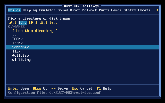

In the meantime I have another (maybe dumb) question
Assume I'm here, top lever of the R: drive, and I need to choose something located on the T: drive, how I'm supposed to change the drive?
Norton Commander & clones have Alt + F1/F2.... here?
Reply 50 of 54, by Dividebysandwich
Heh... Well you can type T: and then press browse.
But yeah, drive buttons would be more convenient. Can you tell I don't use Windows? 😉
BTW I found a bug with Duke3d and the Gravis Ultrasound. If you hear weird midi notes on the left speaker, that bug will be fixed in the next version.
Reply 51 of 54, by The Solutor
Dividebysandwich wrote on Yesterday, 22:30:
I know, but still my QC senses start tickling when I find a UX inconsistence. 😉
Yes, another option could be to start from an imaginary root \ and show the drive letters as if they were subfolders of that not really existent root directory.
A bit "unixy", but if you think, "My PC" in windows was an attempt of MS to do the same thing in Win95, a single starting point to access any folder no matter the drive.
Yes, being used to use MC on Linux, I have always to think twice when I have to change drive on WinDOS, so I perfectly understand what you mean.
Good to know, but I wasn't a special lover of Duke at the time, and I'm not today (Doom, Quake, TombRaider 1/2/3, Unreal, Half Life.... were my things...), so that bug has not big impact on me 😀

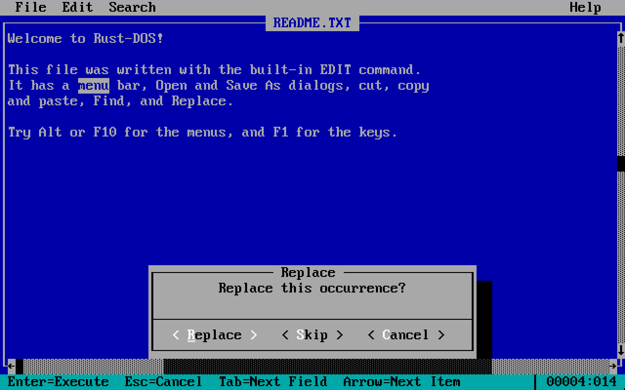

Built-in editor!
This is a pure rust implementation, provided for convenience.

Drive selection buttons for Windows

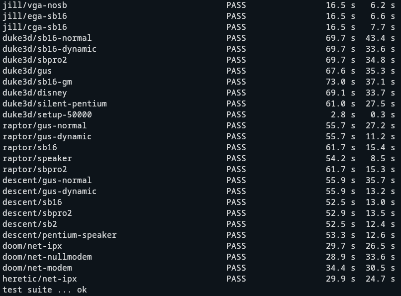

Automated Game Regression Test Suite
This suite downloads approx. 19 MB of shareware and freeware and runs a test suite with various scenarios and configurations.
Each scenario takes picture and sound hashes at fixed points and compares them against "golden" masters.
When a hash changes, the run saves the new picture or sound next to the previously recorded one in target/game_suite/, and writes report.md.
If changes are desired/expected, run with
GAME_SUITE_BLESS=1
to re-record new hashes.
Games tested:
Early PC games: Alley Cat, Digger, Sopwith, Rogue, Scorched Earth.
Real-mode games: Keen 1, Wolf3D, Jill (in CGA, EGA and VGA modes), Cosmo, Duke Nukum.
Protected-mode games: Doom, Heretic, Duke3D, Descent, Raptor.
How to run
cargo test --release --test game_suite -- --ignored --nocapture
Bugfixes
  • Fixed auto cycles failing to select sensible values in WASM
  • Fixed GUS audio problems in Duke3D
