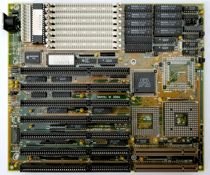

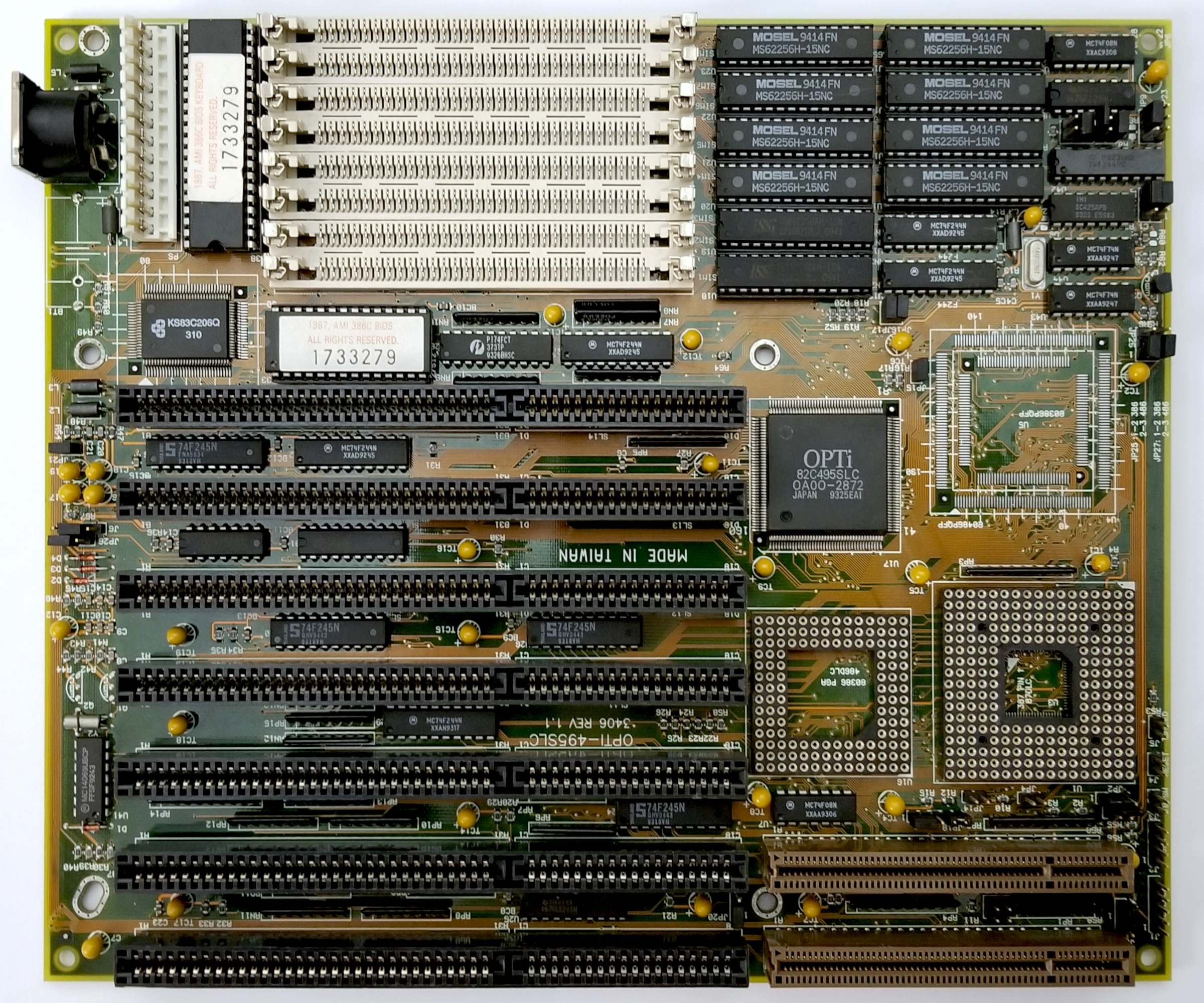

DataExpert EXP3406 rev 1.1 based on OPTi 82C495SLC.
Board is a looker with promising features:
- late/hybrid 386/486 chipset
- VLB slots
- write-back level 2 cache (10 cache banks)
Jumpers are scattered around and a bit illogical to follow. Had to consistently check reference manual, which was annoying.
Expected to be able to run 386 class CPU at higher than specification speeds, but unfortunately the board hard prohibits it.
Set of jumpers differentiates between CPU classes.
Each class is associated with its own set of base frequencies.
The 386 one is limited to 40MHz.
Bummer.
Board is picky about SRAM chips, but not too picky.
BIOS is full of options.
Used Ark1000 VLB in DOS, S3 Trio64 VLB in Windows, DTC2278E VLB EIDE controller.
--- AMD 386DX @40MHz
All BIOS settings on max, except FAST DECODE = DISABLED.
Small exception for rendering tests. Had to increase some wait states, otherwise the system hangs.
Not a visible issue for gaming and casual computing. Standard stability tests like CheckIt, etc. are happy too with tightest BIOS timings.
--- TI 486SXL2 @40MHz
Had to increase some of the BIOS timings to get through successful rendering tests:
DRAM read/write = 1 (from 0)
RAM timings = 3-1-1-1 (from 2-1-1-1)
DOOM test stutters during disk access. Not sure why. Using smartdrive minimizes the impact a lot.
--- IBM BL3
Ark1000VL
Promise EIDE 2300Plus. Turbo mode can occasionally hang the system during POST/BOOT. Fast mode works great.
16Mb RAM
256Kb L2 cache
Cyrix FasMath FPUs are unstable with BL3 processors.
Used ULSI DX/DLC 40MHz instead. Works great.
All BIOS settings on max.
Speedsys hangs.
benchmark results
All in all - not a bad motherboard.
Potential is there, but the 40MHz limit for 386 class CPUs is a limiting factor. Too bad.

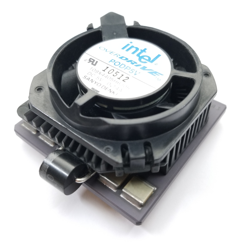

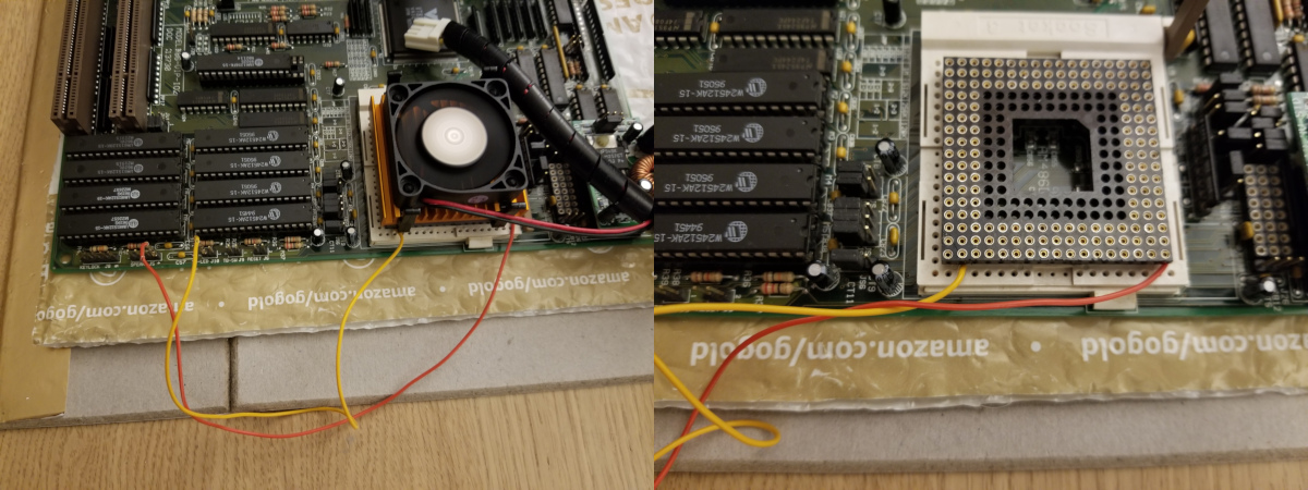

Applied @feipoa's mod to the CPU. With few small improvements.
Didn't cut the pin, but only unsoldered and bent it upwards, making sure it does not touch the heatsink.
Inserted a piece of insulator to form a bed for one of the diode legs.
Precisely bent the diode wires to fit exactly where i wanted them to be.
Used long and tin soldering hot end to ... well ... solder them in place, with minimal collateral damage.
Replaced the original fan with bigger one, was not sure at the time if the standard one will be enough when running heavy computation tasks.
Basically, made sure that the mod is easily reversible.
Here is the result:

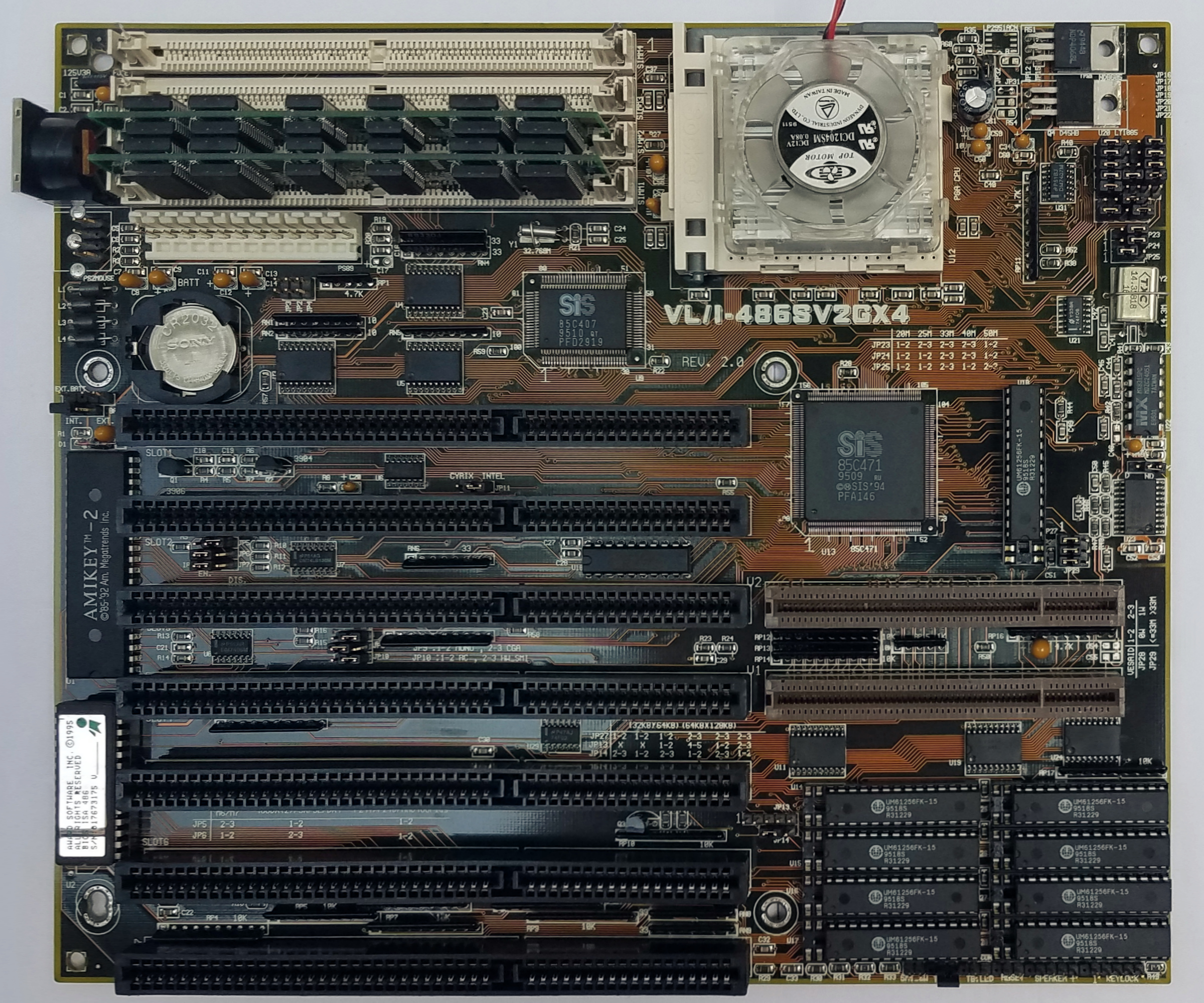

Asus VLI-486SV2GX4 (picture shows 256Kb cache and 32Mb RAM, but is used with maxed-out to 1024Kb cache and 64Mb RAM)

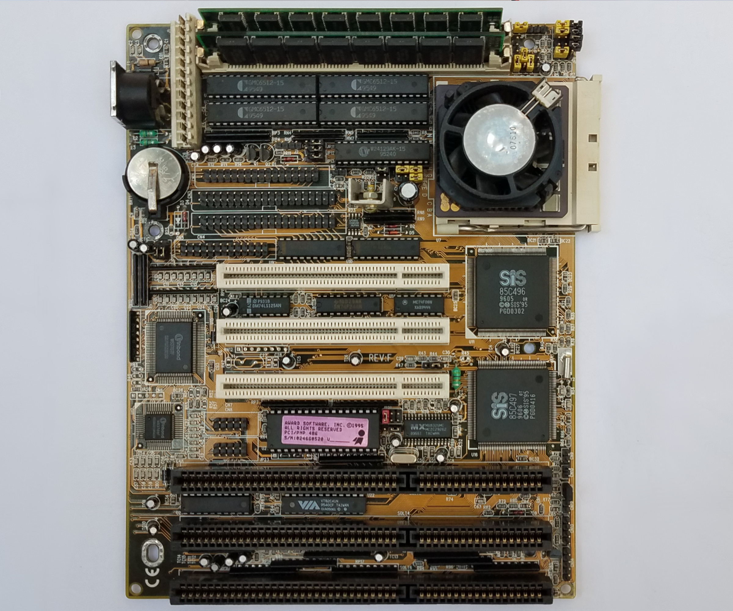

Biostar MB-8433UUD-A (picture shows it with 512Kb, but is used with 256Kb)

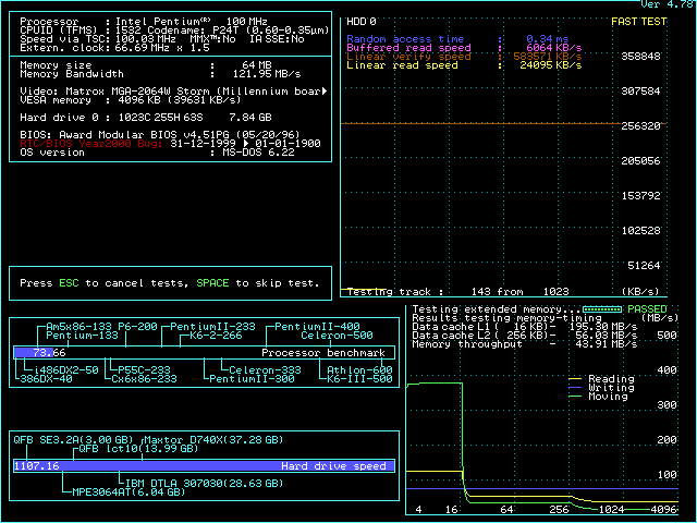

Asus VLI in SpeedSys with all settings on max:
L1 cache in WB mode, Ark1000VL and Promise EISA 2300 Plus.
L1/L2 caches set in WB mode deliver peak performance. Most other 486 boards need L2 in WT mode with POD100 cpu.
If L1 cache is set to WB mode any configuration with more than one memory module (in the first slot) can be unstable in some situations. The motherboard cannot recognize modules bigger than 32Mb, so this is the limit.
Tested carefully with trusted 4, 8, 16 and 32 Mb ones that can handle up to 180MHz (3x60) and even 200MHz (3x66).
1x4, 1x8, 1x16, 1x32 - stable. Nx4, Nx8, Nx16, Nx32 - unstable.
At 83MHz (2.5x33) the issue is not present, only at 2.5x40MHz.

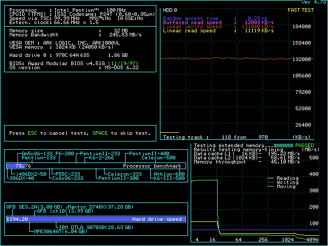

8433UUD in SpeedSys:
L1/L2 caches in WB mode for best performance.
EDIT:
The original post talked about the board operating with L2 cache disabled because of instabilities.
Comments by Feipoa below provided hints and confirmed that it can run stably with L2 enabled and tightest timings (*).
Turned out that the board is *extremely* picky about SRAM chips.
Had to find that specific permutation of 9 (UMC, 15ns) ones to make it happen. Will save the details, but I will not be going through the same exercise again for sure.
(*)All settings are on max, except IBC DEVSEL# DECODING, which had to be set to "medium" (down from "fast"), otherwise IDE controllers (on-board or external) do not recognize the CF card.

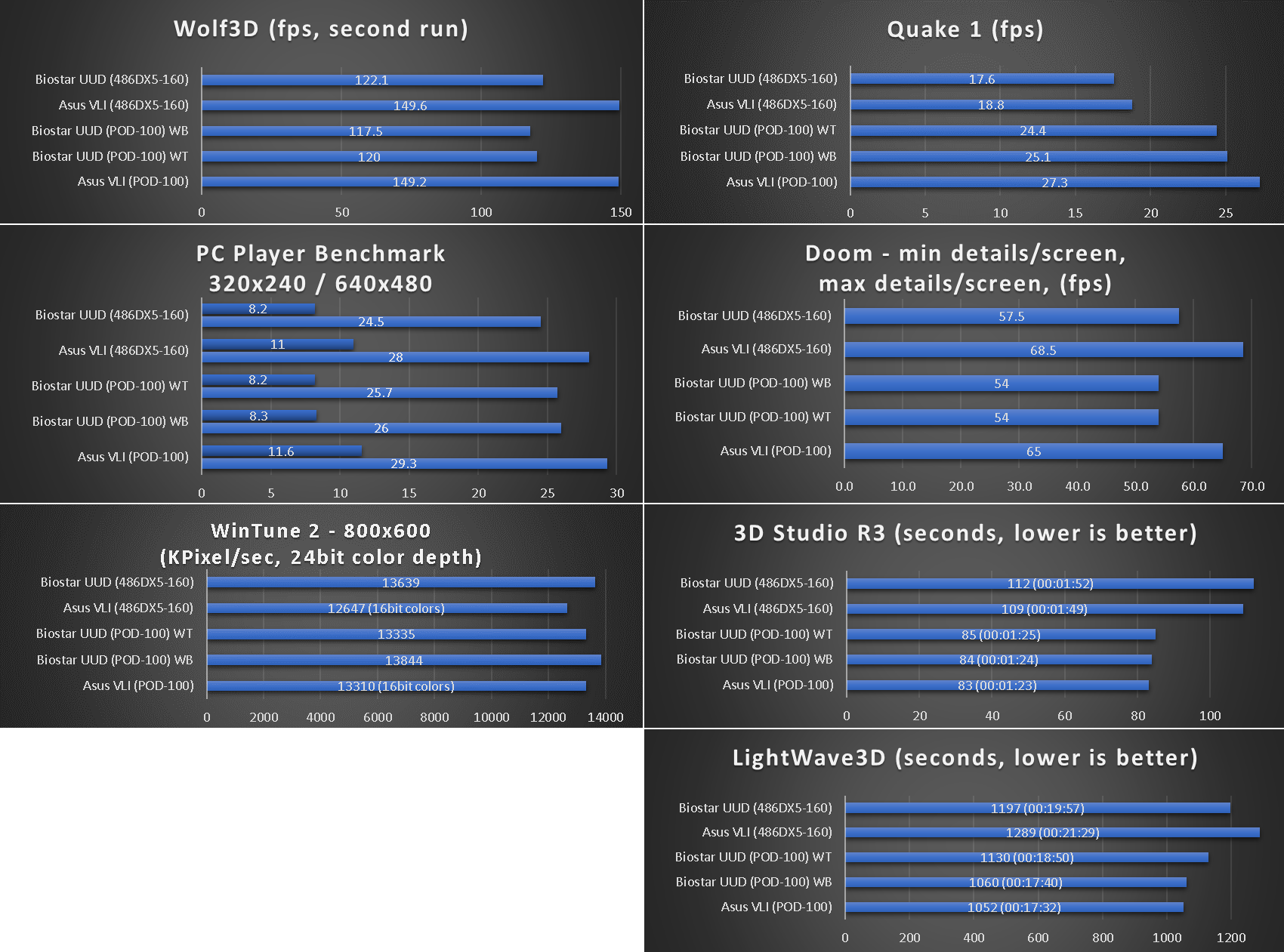

The standard set of benchmarks.
PVI and UUD were tested with Matrox Millennium PCI video adapter.
VLI was tested with Ark1000VL in DOS and S3 Trio64 (16-bit per pixel) in Windows.
POD100 > AMD 5x86 at 160MHz.
Matrox cards are way faster in Win GUI than anything else released in the mid 90ies, still S3 Trio64 VLB manages to catch-up but only when in 16 bits per pixel, otherwise perf is much lower.
Tested the Biostar UUD board withseveral other graphics cards. MGA was same or better, so it was used.

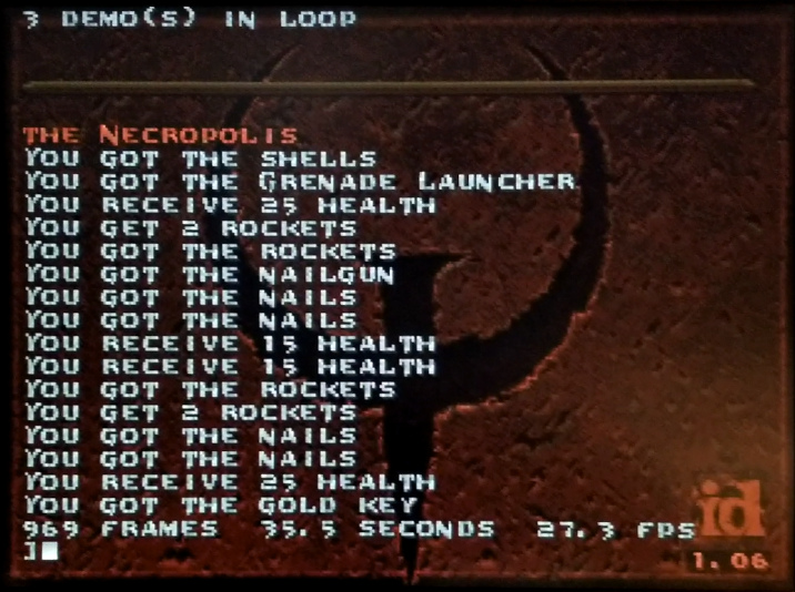

Quake 1 running on VLI + POD100 (L1/WB) + Ark1000VL = 27.3 fps. Pretty good. Probably the highest Quake 1 number on socket 3 hardware.

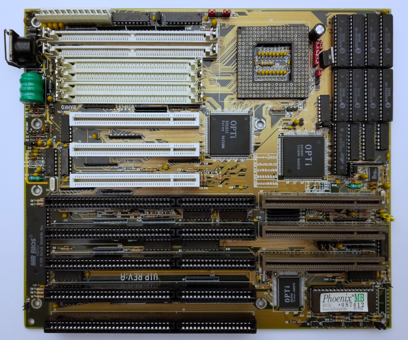

Edom International Corporation 486VL3 (MP032F ?) based on OPTi 82C895/82C822/82C602 chipset.
Checked this board a while ago.
Cannot remember details anymore.
Going by the few notes i kept.
Notice how the VRM is (not) integrated in the PCB.
Very flimsy. Broke it twice by just tweaking the jumpers next to it.
Had to spend time to fix that.
Legs were already short and couldn't be soldered well enough, so sanded the bottom of the package carefully - effectively increasing the length of the legs which allowed me to solder them properly.
With that problem out of the way it was business as usual.
Board didn't want to run the AMD DX5 CPU at 4x40Mhz, so used the simple interposer from few posts above to force that behavior.
160MHz worked fine, but L1 cache refused to operate in WB mode.
Tested with 72pin SIMMs only.
Mr.BIOS on board - does not seem to offer anything special.
System was stable with all settings on max. Two exceptions below.
Used DTC2278E EIDE VLB controller.
Speedsys:
benchmark results
Favors VLB in DOS graphics - performance is pretty good. The best Wolf3D numbers with 160MHz CPU so far !
Failed the Doom test. Increased wait states didn't help. Looks like specific incompatibility with the Ark1000VL video card. Tested with two more VLB VGAs - S3 Tro64 and WD90C33-ZZ - worked fine. Didn't investigate in depth if there is a bigger VLB VGA compatibility issues, didn't feel that way.
Favors PCI in accelerated Windows graphics - performance is top notch. On par with some of the best 486 boards out there.
Computation tests are contradicting. Disappointing results in 3DS (DOS), but pretty good in LW3D (Windows).
Most OPTi based motherboards (well, at least the ones i had the chance to try so far) show mediocre performance, but this implementation is pretty good.
Board may look like your average citizen, but there is strength within. 😀

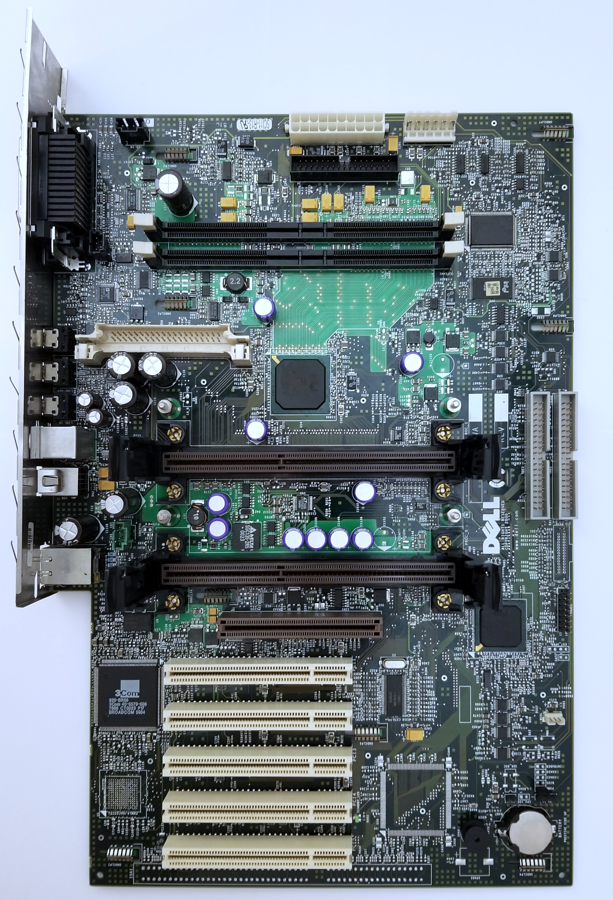

Not far ago in this post i talked about assembling a top-notch dual slot1/2 Pentium 3 based graphics workstation from year 2000-2001, using standard ATX/AGP motherboards.
That post is big and perhaps hard to follow. It was even bigger initially and completely out of hand, so trimmed it down to focus on 3 candidates only.
I already completed the PC and it is a done deal (will share the end result later), but figured it will be good to post the collected information for 3 more of the examined motherboards - one OR840 and two OR820.
Here is the first one:

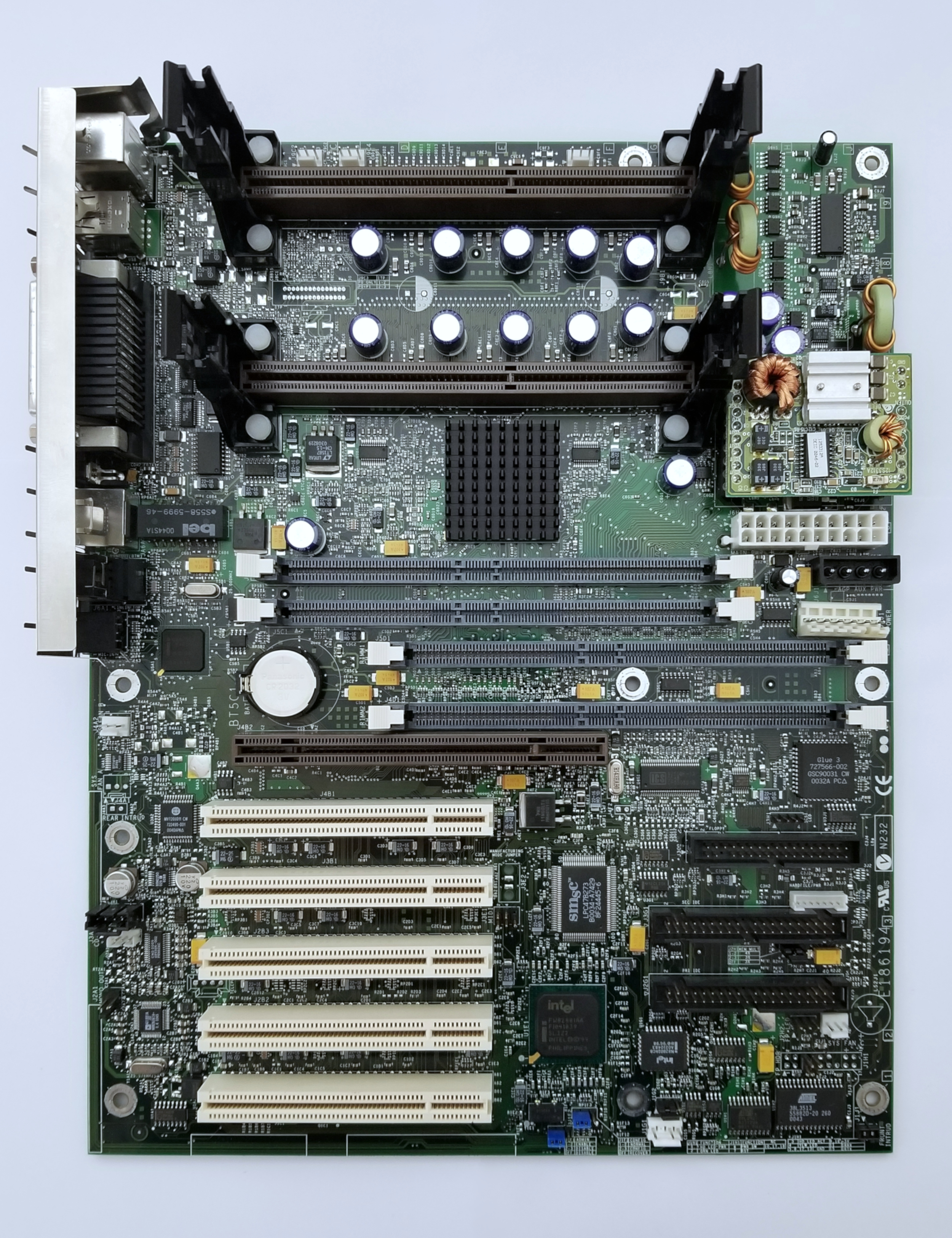

Intel OR840 - IBM Intellistation M Pro (Type 6868), in mint condition
Majority of the computer hardware i have seen from companies like IBM, HP, Dell, Compaq, etc. tend to be too customized, restricted and quirky for my taste, so i avoid it in general, but this particular motherboard is pretty much vanilla Intel implementation with good IBM BIOS (updated to the latest version).
It lacks the magic touch of the Taiwanese manufacturers, which means limited/no options for tweaking and overclocking.

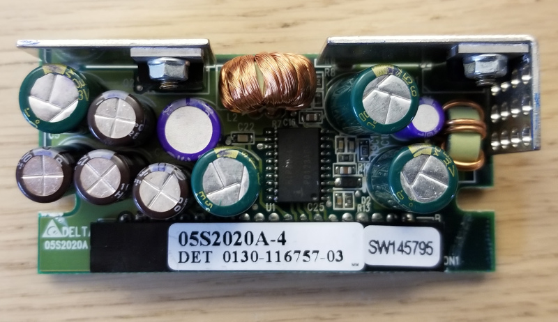

Requires custom PSU, which is inconvenient.
But other than that it checked all boxes, for me at least, so it was considered as a contender.
Clock generator is ICS9250BF-12, limited to 133MHz, so no dice for overclocking.
Boot times are a bit on the long side, but still within the reasonable limit.
IBM fully populated it with chips and other gear, compared to the Intel version. Integrated LAN, Sound and so on.
Swapped the coin cell battery socket. It was of non-standard type. The battery was less of a coin, but more of a satellite dish size and completely depleted. Soldered a standard one.
Also, added couple of jumpers that were missing in favor of proprietary IBM front panel.

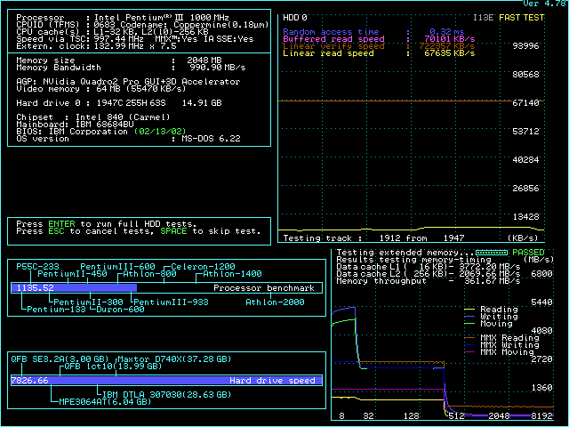

Hit an interesting issue initially - boot process was unstable in a completely random way. 8 out of 10 tries led to no POST.
