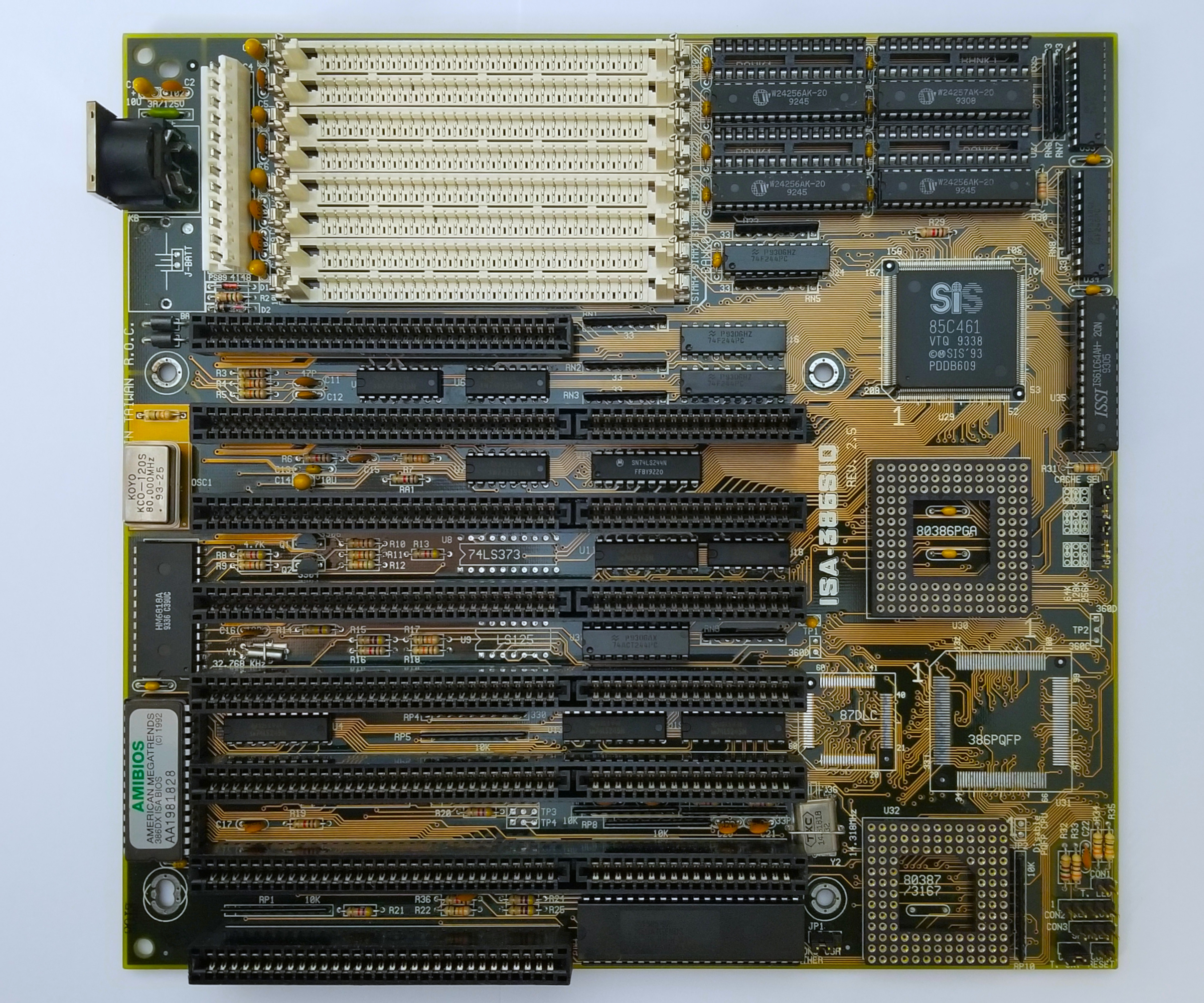

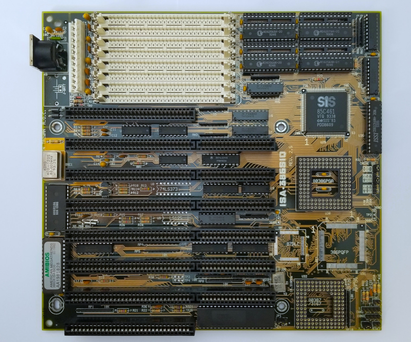

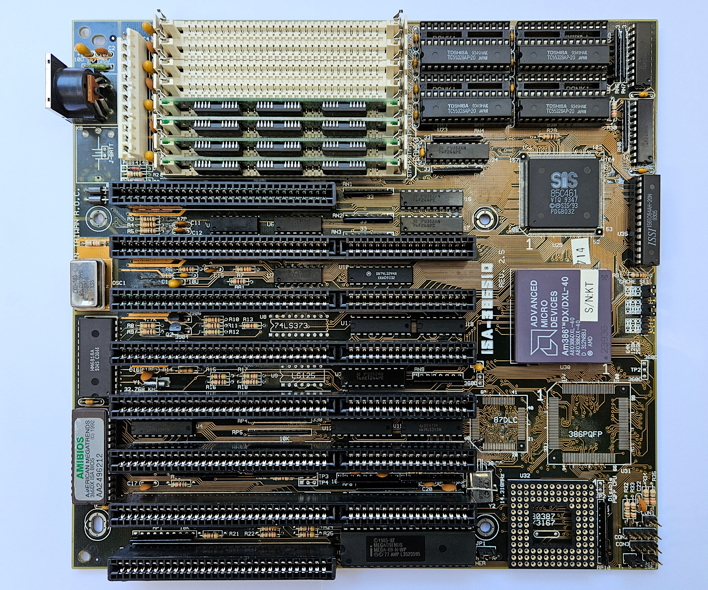

Reply 204 of 2351, by pshipkov
Asus ISA-386SIQ
A classic late model 386 motherboard, based on 486 class chipset SiS 461 - made me curious how this will work.
SiS 461 is pretty decent early 486 chipset - not too fast, not too slow - should be a good high-end fit for 386 system.
The board is basically jumper-less.
Supports up to 32Mb RAM and 256Kb SRAM.
Very stable.
Takes any components with ease. Maxed it out right away.
Used TI SXL2-50 CPU, Cyrix FasMath FPU (black top) and Cirrus Logic 5434 ISA VGA (Diamond) - pictures of them in previous posts.
BIOS is similar (same) as of 486 motherboards with this chipset.
It has very few options for adjusting timings.
Set to their optimum performance values.
Overclocks pretty well to 55MHz with FPU !
Looks like there were different production runs - some small differences in silkscreen printing, chips, etc.
Behavior is identical.
SpeedSys does not like SXL2 CPUs - text is all jumbled.
So going with just benchmarks today.
benchmark results
Performance is disappointing.
Didn't bother running 3D rendering tests. They take a while but won't reveal anything interesting. Picture is pretty clear already.
Tried swapping the BIOS with one from ASUS SV2 486 board - while it worked - perf stayed same.
This is not the first 386 motherboard from ASUS that passed through here and was lacking.
Apparently they were still sharpening their pencils at the time. 😀
UPDATE: It looks like the level 2 cache may be in always dirty state. User @jakethompson1 provided a work around in this post that may improve performance significantly. To be tested soon.
There is also a BIOS from Soyo SY-019J motherboard based on SiS 460 that has more robust control over SRAM/DRAM wait states than the standard ASUS one.
With it performance jumps between 20 to 30 percent in the different test cases. This is enough to move the board from being one of the slowest to intermediate performer.
Also, with the tighter wait states 55MHz FSB cannot be stable.
Didn't bother updating the consolidated performance charts - it is not worth it.
Maybe later ...
One last note, IBM BL3 processors don't work with this motherboard.
