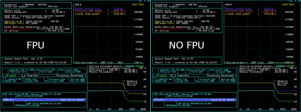

There is something weird with the level 1 cache support of the BL3 processor.
First clue is a discrepancy between what SpeedSys and CCT report.
Notice how SpeedSys does not show the expected higher throughput from level 1 cache but flat lines for the entire level 2 cache range.
At the same time CCT shows the peak.
EDIT: Forgot to retake the CCT screenshot with working 256Kb level 2 cache.
This seems to be the reason for low test results from PC Player Benchmark (4.1 fps), Doom (7 fps - ouch), Quake 1 (2.1 fps), WinTune2 (~1000 KPixel/sec). Some of these are worse than bare 386DX running at 40MHz.
REVTO486.SYS hangs no matter what but LIGHT486.SYS seems to be working. This is unusual.
Not sure what to think about this but the BL3 support is clearly lacking.

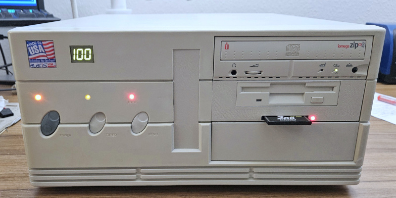

Throughout this thread, I've been documenting my pursuit of what I've dubbed "the fastest 386 in the west".
My exploration began with the initial post examining a relatively modest PC-Chips M321. Since then, i went through basically every significant motherboard and chipset available for the 386 platform. This methodical process has been driven by my desire to identify the absolute pinnacle of 386 performance.
From all tested assemblies, two distinguished themselves as exceptional:
DTK PEM-4036Y paired with IBM BL3 processor running at 100MHz (2x50).
And MicroStar MS-3124 with IBM BL3 processor running at 110MHz (2x55).
Among the rest were two Alaris Cougar II (Cobalt-AT 486BL) boards that showed potential but were not able go past their standard specs of 3x25MHz (or 2x40MHz) to be of interest. This made me form a negative opinion about the Cougars which i expressed in some posts. Nevertheless, the potential i sensed in them pushed me to continue my experiments. Eventually, I acquired two more Cougar boards, which led to a very satisfying result that I will document in this post.
As they say - third time is the charm (third major attempt at the fastest 386) and the right place to set the record straight about the Cougars.
Several years ago, I acquired a complete PC system featuring an Alaris Cougar motherboard, Cirrus Logic GD-5429 video card, Sound Blaster AWE32, CD-ROM drive, floppy drive, hard disk drive, power supply unit, and a computer case.
The original owner, based in the UK, had set out to build the fastest 386 rig possible; however, the project extended beyond his expectations, and he eventually lost motivation. He offered me a generous discount and entrusted me with the task of completing the build, which I accepted. Finally, i reached the point of fulfilling that commitment.
While discussing history, i will briefly touch on the Alaris Cougar story for additional context.
Back in 1993-1994 the home and office computer markets were rapidly evolving.

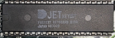

The keyboard controllers these Cougar motherboards come with are inadequate when operating at such overclocked frequencies. They must be replaced with Jetkey-branded ones, which are conveniently labeled for what they are. However, even with them, the soft reset function (CTRL+ALT+DEL) causes the system to hang, requiring hard reset instead. While not an ideal situation it is not a blocker in any way.

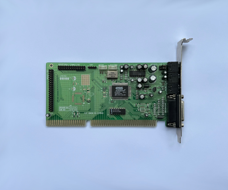

sound - Union UTD76C (ESS1869F):
I started with the SoundBlaster AWE32 CT3980 that came with the purchased computer but immediately encountered resource conflicts with the Cougar motherboard's onboard game port. After deactivating the sound card's game port, I was able to get past that issue, only to discover additional conflicts preventing digitized sound reproduction in DOS.
Tested and several different SoundBlaster 16 models, but encountered identical issues. Despite investing considerable time troubleshooting these conflicts, I was unable to resolve them. Rather than allowing this to become a roadblock, I switched to a Sound Blaster Pro 2, which functioned flawlessly. Go figure.
However, another consideration (which I'll detail below) led me towards a generic ESS1869F audio card that includes a standard IDE interface for CD-ROM connectivity. Despite their unassuming appearance, these ESS cards are excellent in every way. At the end, the experienced problems guided me toward the better overall audio solution.
Interestingly enough all sound cards worked just fine with the 33.33MHz ISA bus, contrary to my expectations.

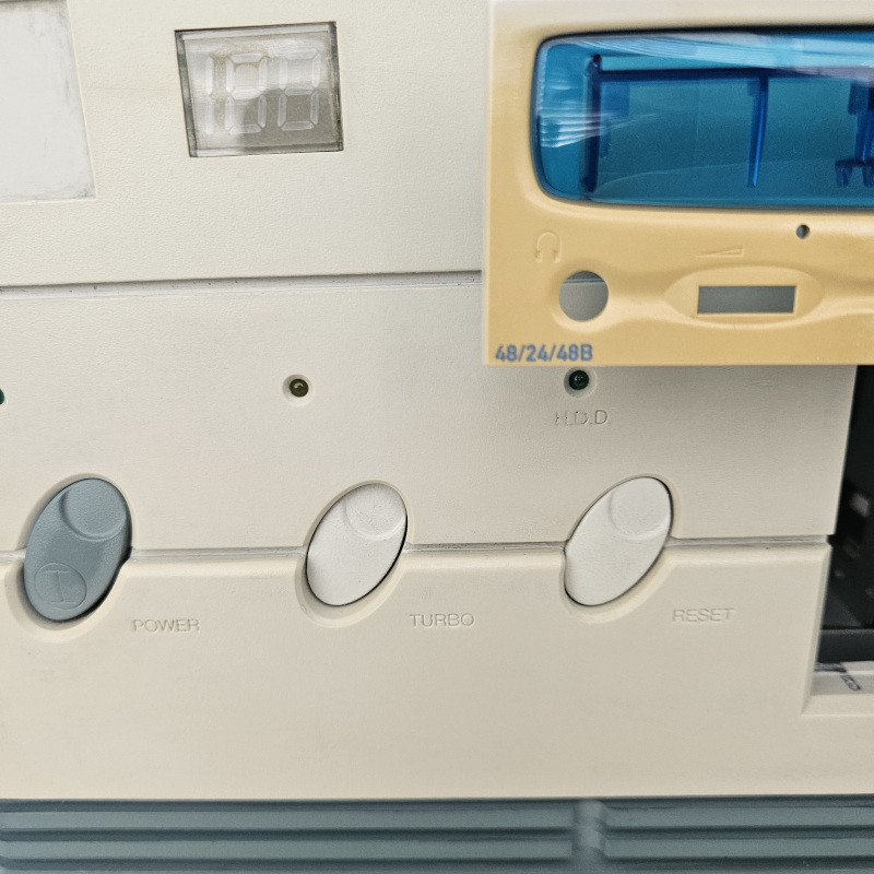

case - unknown brand/model:
The computer case I acquired from the UK seller bears a notable resemblance to the original Alaris Cougar case shown in the photograph at the beginning of this post. This similarity isn't particularly remarkable, considering the relatively standardized design of desktop cases from this era.
The case had developed significant yellowing-comparable to the color of Swiss cheese-and required restoration. My first attempt involved applying acrylic paint, which ended up looking horrible. Scrubbed it and opted for the traditional retrobrighting.
This involved submerging the front panel in a bath of hydrogen peroxide with powerful UV lights positioned above for approximately 36 hours. The outcome proved quite satisfactory. For reference - the CD-ROM drive panel has the same color of the case front panel before the retrobrighting.
After addressing that major aesthetic concern, I rigged the LED speed display with dynamic jumpering, allowing it to properly display the 50/100MHz frequencies the system can run on, depending on the selected TURBO mode.
Oiled the 3 buttons with W4 lubricant as they were qaite sticky.
Then onto the badge. Every beige PC case has to have a badge after all.
Prepared two different designs. Carefully photoshopped and printed on glossy photo paper. Clear epoxy stickers on the front and double-sided tape on the back.
Selected the design on the right side for the case as it is better fit for it. The design on the left is more appropriate for the motherboard itself.
3D Printed the 3.5" floppy bay cover.
Color matched at Home Depot the front case color. Selected a paint with "egg shell" shine and painted the 3D printed elements.
And here is the end result:
Spent quite a bit of time contemplating about the color and intensity of the LED lights. This is what i ended up with. Disco!
Upon multiple consultations with my spiritual adviser Feipoa about the exterior appearance of the computer i am going to rearrange the looks by moving the CF-IDE adapter on the back and the 3.5" floppy drive to the corresponding bay. Leaving this task for the near future. Will update the post once done.
This represents the latest chapter in my ongoing "fastest 386 in the west" quest. In terms of raw performance, this system can be challenged only by the 110MHz MSI MS-3124, which maintains a slight edge in certain FPU-intensive benchmarks where its additional 10MHz to CPU and 5MHz to FPU give it an edge.

Speedsys:
A test run captured on video.
(notice the repetitive test for writing into a file - no write-access issues with CF-IDE adapters - finally!)
The system feels and behaves great. Fully stable, fully functional, very responsive, yet not overly responsive to feel like a post-386 machine.
Extensive testing has been conducted to confirm complete stability. The sole issue encountered thus far, aside from the previously noted soft-reset problem, involves Mortal Kombat 1. Specifically, if sound is initialized via UNISOUND or ESS initialization utilities and CTCHIP34.EXE is activated, the game will freeze at startup. The workaround is to avoid running CTCHIP34.EXE.
BENCHMARK RESULTS

Is it only that particular JET KEY can work with these boards at 0 ws? Will JET KEY v3 and v4 work? Which other keyboard controllers did you try? Unfortunately, all versions of the JET KEY I have experimented with are without PS/2 functionality.

You mentioned that you painted the plastic case, then stripped it. Painted cases look terrible, in my opinion. Are the 3D printed slot covers painted or bare?

You might find that the oiled buttons get sticky again within a year or two. On some of my cases, I've had to remove the button cover and sand the edges down.
I have 6-7 spare keyboard controllers for that purpose. Only this particular JetKey worked properly. The rest either hung during POST or caused auto progression issues as if the Enter key is pressed all the time. I am sure other controllers can work too, but from the ones i have only the JetKey did it.
For example - this JetKey chip does not work in the 30MHz zero wait states 286 machine. So it truly is a trial and error.

Yes, they are painted. 3 coats. The PLC plastic actually looks much better/tolerable when painted compared to the acrylic ABS panels of these beige PC cases.
If the beige PC case starts giving me any troubles it will meet the trashcan, and a lean/mean 3D printed one will replace it. Hah!

Your JET KEY is without a version printed on the surface. If you use a different JET KEY without a version, are you still able to maintain 0 ws? Or is it just this lucky JET KEY chip, kind of like binning SRAM of the same brand/speed?
If you have the system handy, could you software switch to 1x mode and try to soft-reset? Did it work?

It is a binning thing for the kbc chip as it didnt work well in other overclocking systems. So it is on a case by case basis.

Checked the hanging soft reset.
It is not related to CPU speed multiplier.
Entirely dependent to base frequency.
I bet that another KBC can be found that handles things properly, but that will be a patience taxing exercise.
I have the Cougars KBC socketed, so one day ...
