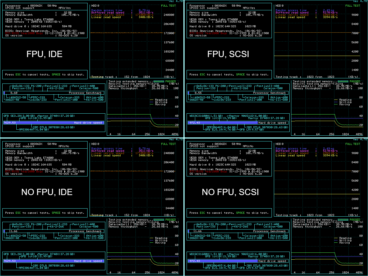

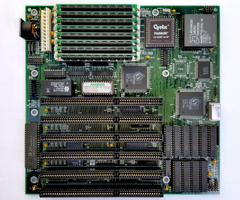

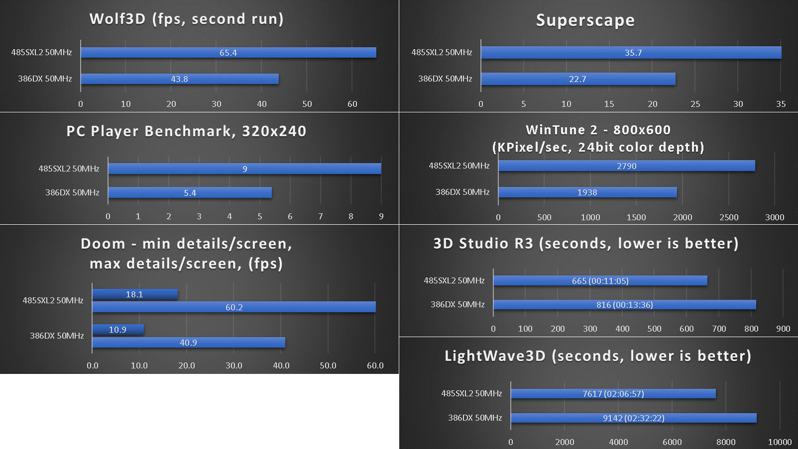

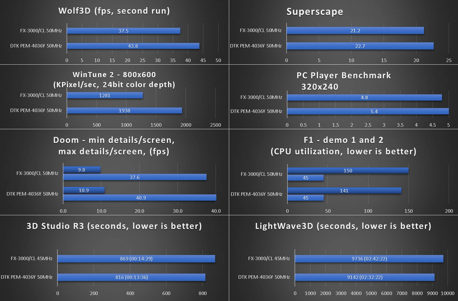

Another weekend - another motherboard examined - Elitegroup US 3486, although FX-3000 rev 1.0 is printed on the PCB.
Actually the examination happened a while ago, only sharing the findings today.
Motherboard is fully stable at 45MHz with all system timings at their lowest (fastest) available values. Also, fully maxed out system - 32Mb RAM, 256Mb SRAM, etc.
The mobo is fully stable at 50MHz with lowest timings, but without FPU. If FPU is present (a 40MHz rated FasMath, for example) some compromises need to be made for things to stay stable - relaxing some timings and enable caching for the first 16Mb RAM only. Obviously this is a no-go for me, so i don't consider it as an option.
The board works at 55Mhz as well, but timings have to be relaxed which leads to lower performance than 50MHz and even 45MHz.
Surprisingly at 50MHz the Adaptec AHA-1542CF SCSI controller can operate at 10Mb/s which is a real boost for the disk performance. You really feel the 5Mb/s read speed ...
At 45MHz i can get it to work at 6.7Mb/s max.
FX-3000 didn't like 12ns ISSI SRAM chips. Not sure why, because they work just fine in other systems, so i went with 15ns UMC ones, which nicely match the chipset brand of the board.
All tests were performed with the same Genoa CirrusLogic GD-5426 video card with latest (for 1993) Diamond BIOS (great performance), that i use in my main 386 build.
AMD 386DX at 45MHz
AMD 386DX at 50MHz
benchmark results
Not the fastest clock-to-clock chipset and assembly, but very steady beyond the standard 40MHz.
For stable 50MHz ULSI or black-top FasMath FPUs are required.
